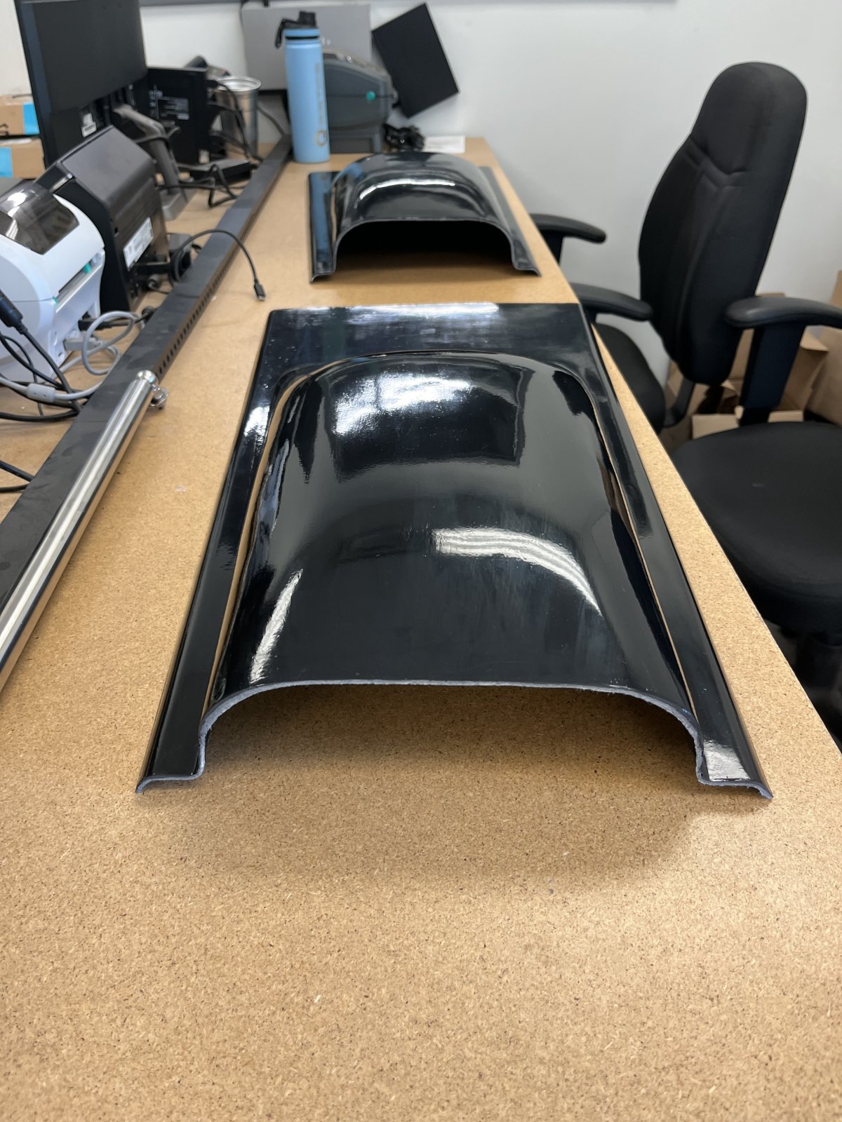

Painted the turn signal brackets. Almost looks like they came that way.
Metal Mech
Are these custom or did you buy them from a retailer? Those look like the perfect size. Can you post a photo of how they fit?
They are made by a fellow Goblin owner. I will post some photos when I get a chance. They do have to be trimmed to fit, like cutting out spot for the rear brake lines and some other spots.
And just to restate so there is no confusion. They are made to be side pods.
Not that someone creative couldn’t do something else with them.

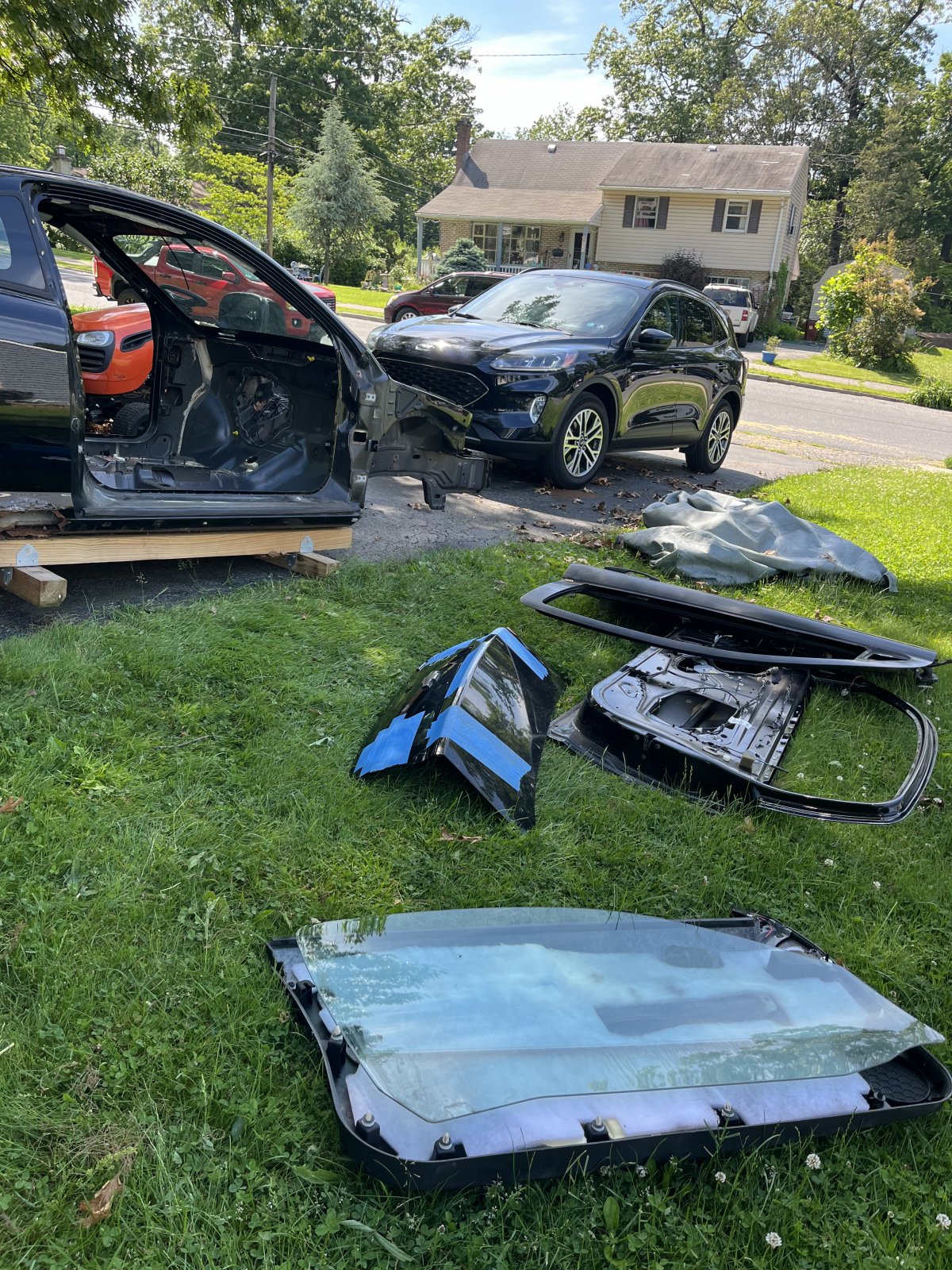

Stripping down the rest of the donor today. Gotta get the tank off and probably take some parts to scrap this week.

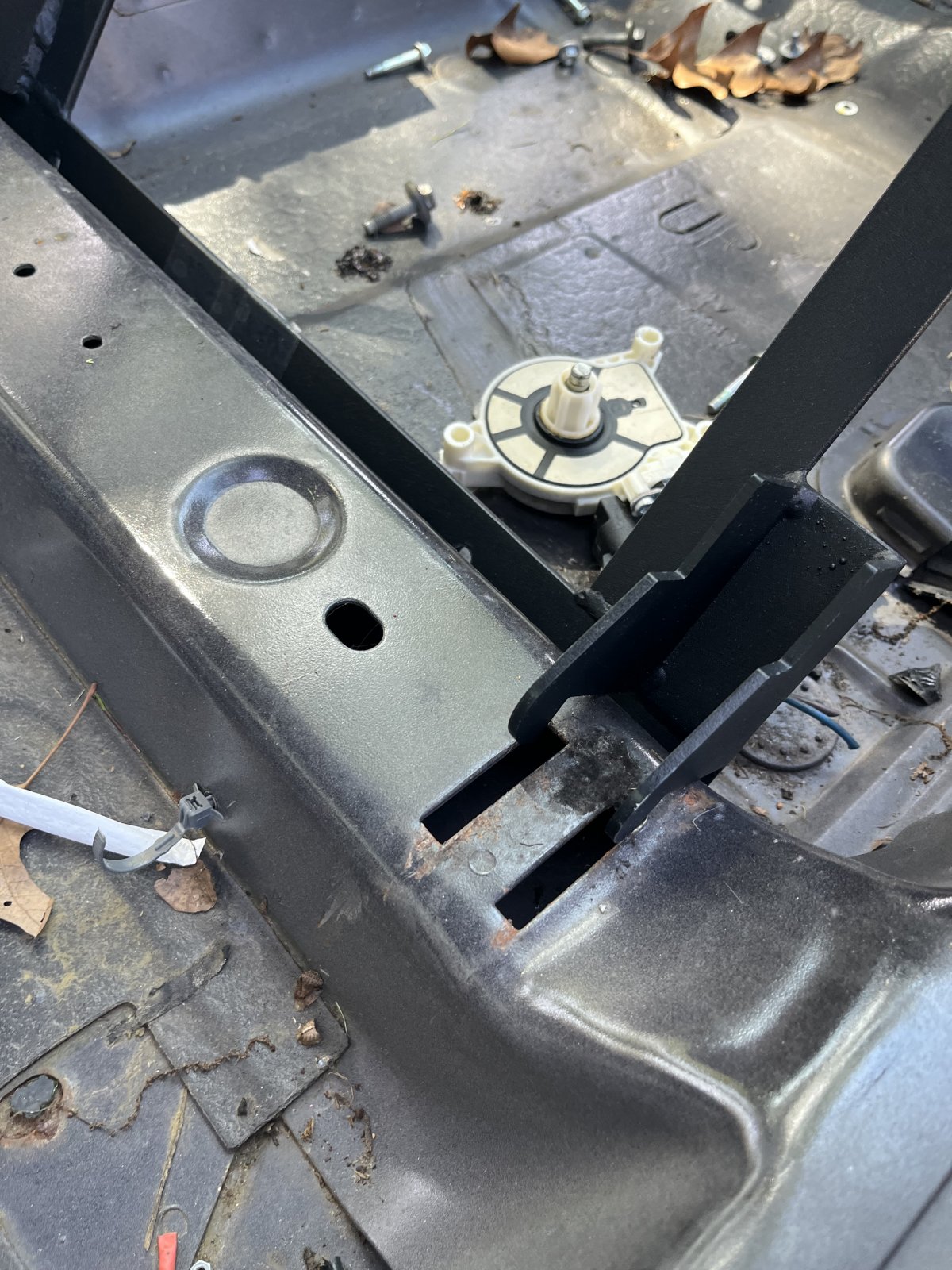

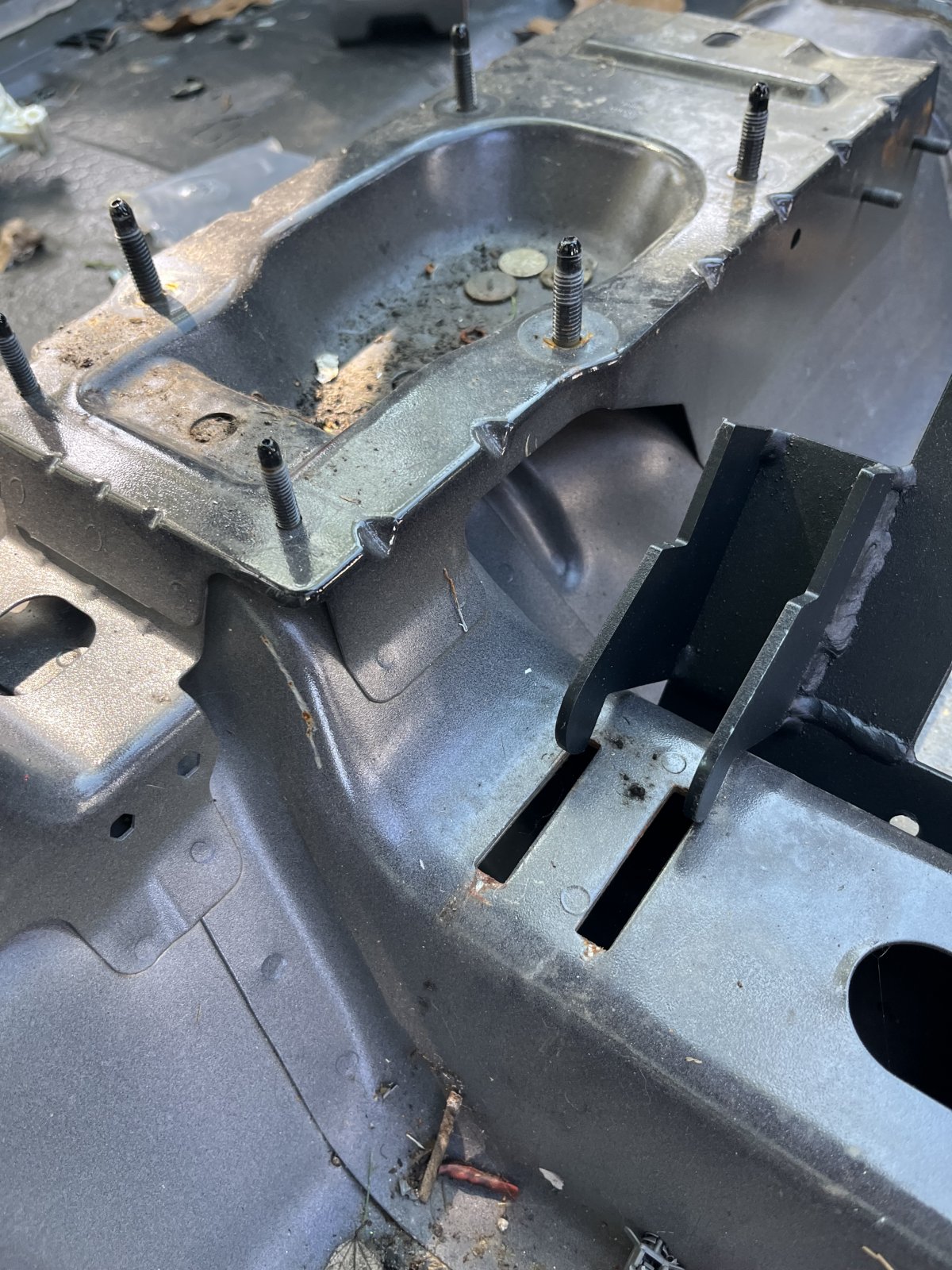

Also just test fitted the seat sliders. They are two wide. So it’s a Corbeau problem not a DF Goblin problems. Gonna see if I can squeeze them in to fit before trying to cut on the floor pans.
