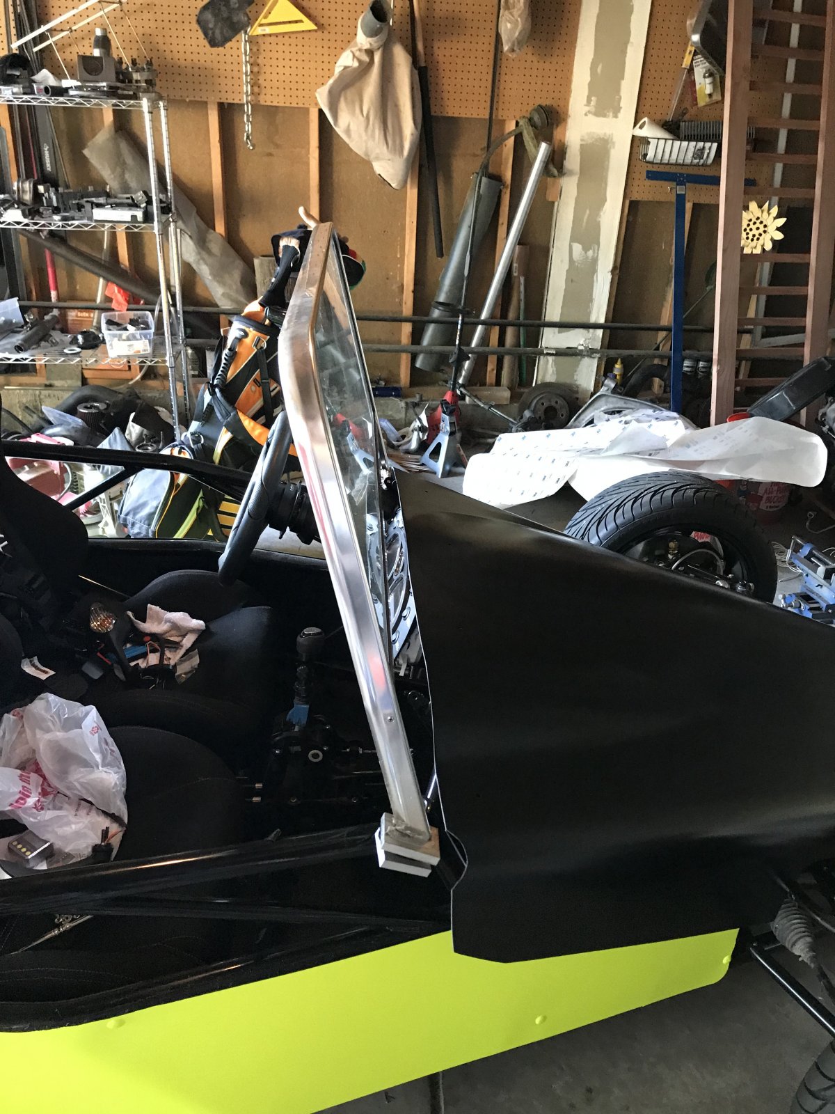

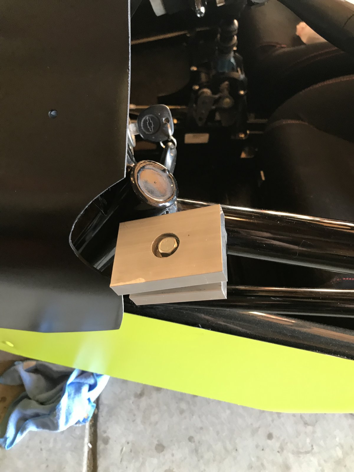

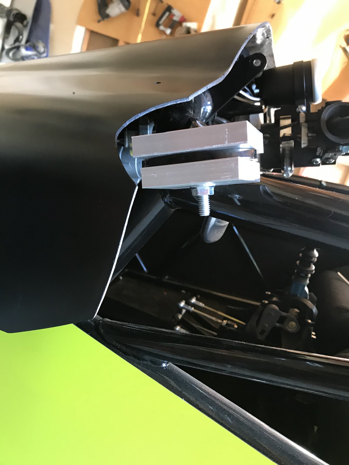

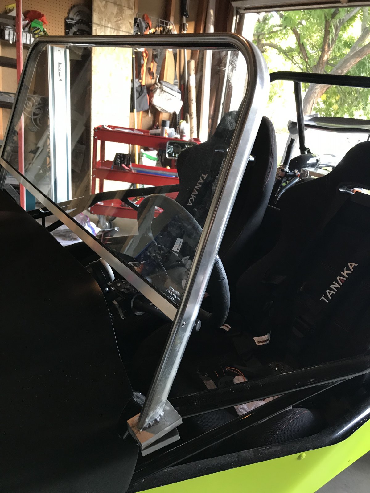

I’m still in my busy season at work and getting hard to find time to work on the car. I was able to mount the windshield and very happy so far how it turned out. I just took two 1/2” blocks of aluminum for each side, recessed a bolt in the top piece, aluminum welded the windshield to the top piece as well, then sandwiched the mirror mounts to the aluminum mounts with a bottom bolt. I now have to make a top brace and we are in business. To mount the windshield wiper motor I’m just going to mount a plate to the bottom of the windshield and mount the motor to the plate.

Not the prettiest job but should pass my inspection.

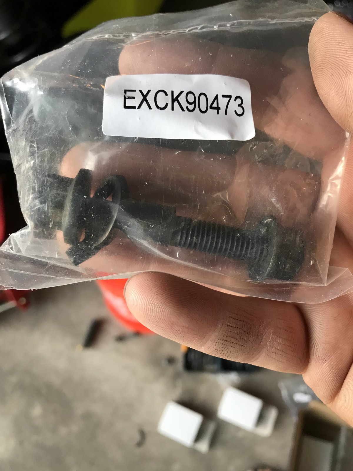

I got all my supplies to do alignment this weekend as well and and to say how amazing these camber bolts are for the rear struts. I feel like I was at a negative 3 degrees of camber and just messing around with one bolt in the top mount and one in the bottom mount was able to get positive camber.....pretty cool

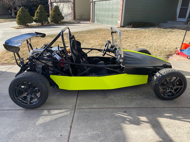

Anyone looking at going through the process with Colorado this is what they looked at with my car
-AS1 safety glass windshield
-electric windshield wiper
- rear view mirror
-horn
-signals, tail lights, and headlights need DOT stamp
- and show them everything works
I do not have the e-brake, bumpers, wheel fenders as they were not required in Colorado if that helps anyone here
also kit cars here do not require a catalytic converter
hopefully only a couple more weeks and I’ll be legal.

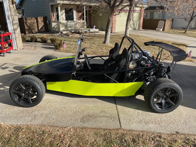

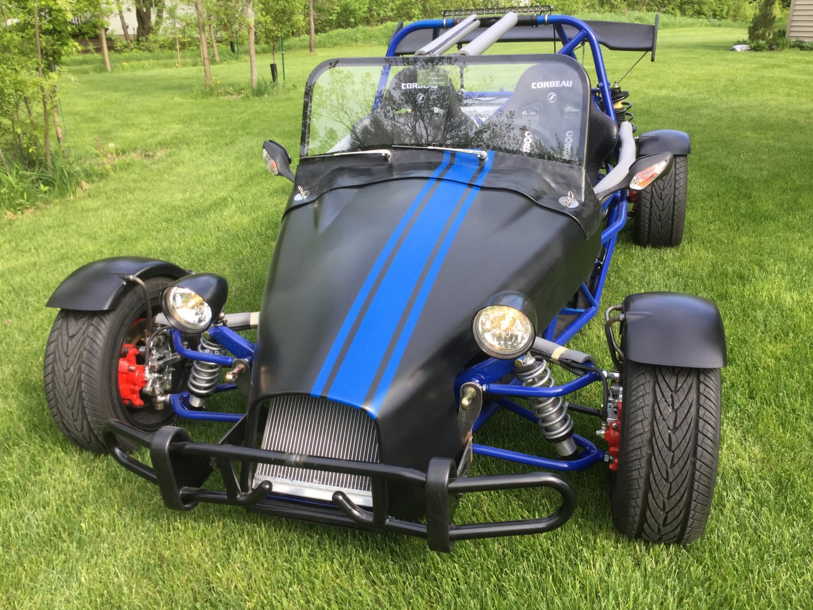

Looks amazing!
Your tire and wheel setup looks great.
Can we get the wheel and tire specs?
I have looked at the tire and wheel sheet in the forum section, but it not completely up to date.
Thanks!
