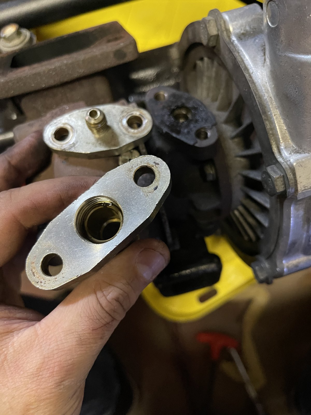

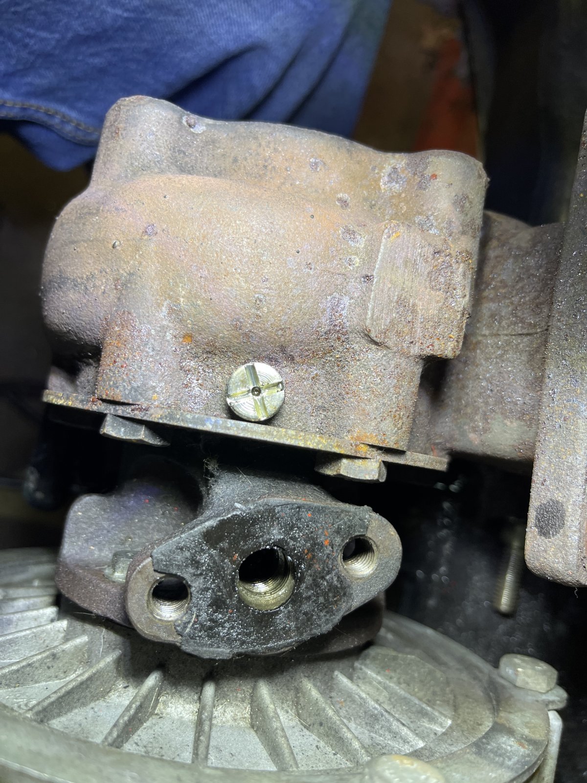

Group I had some help identifying an issue. I have an aftermarket turbo on a L61 2.2 this engine is a fresh build with Forged Rods and Pistons. New Bearings. When I run the car the engine is very smooth and running fine. Once I get the RPM up to start building boost I get a noticeable knocking and all boost lost. Runs like crap and the knocking stays for a bit then stops and the engine runs smoothly again. I took the Turbo intake tube off the intake to check and the Engine is running perfectly fine even at high rpm. I did out of caution pull the plugs and Valve cover and the Engine is looking fine. I also took the intake and turbo off
Couple findings.
1. There is oil in the intake - Honestly this could have been there for a while I did not clean it.
2. This is an external Wastegate. Turbo and Wastegate are Ebay specials!!

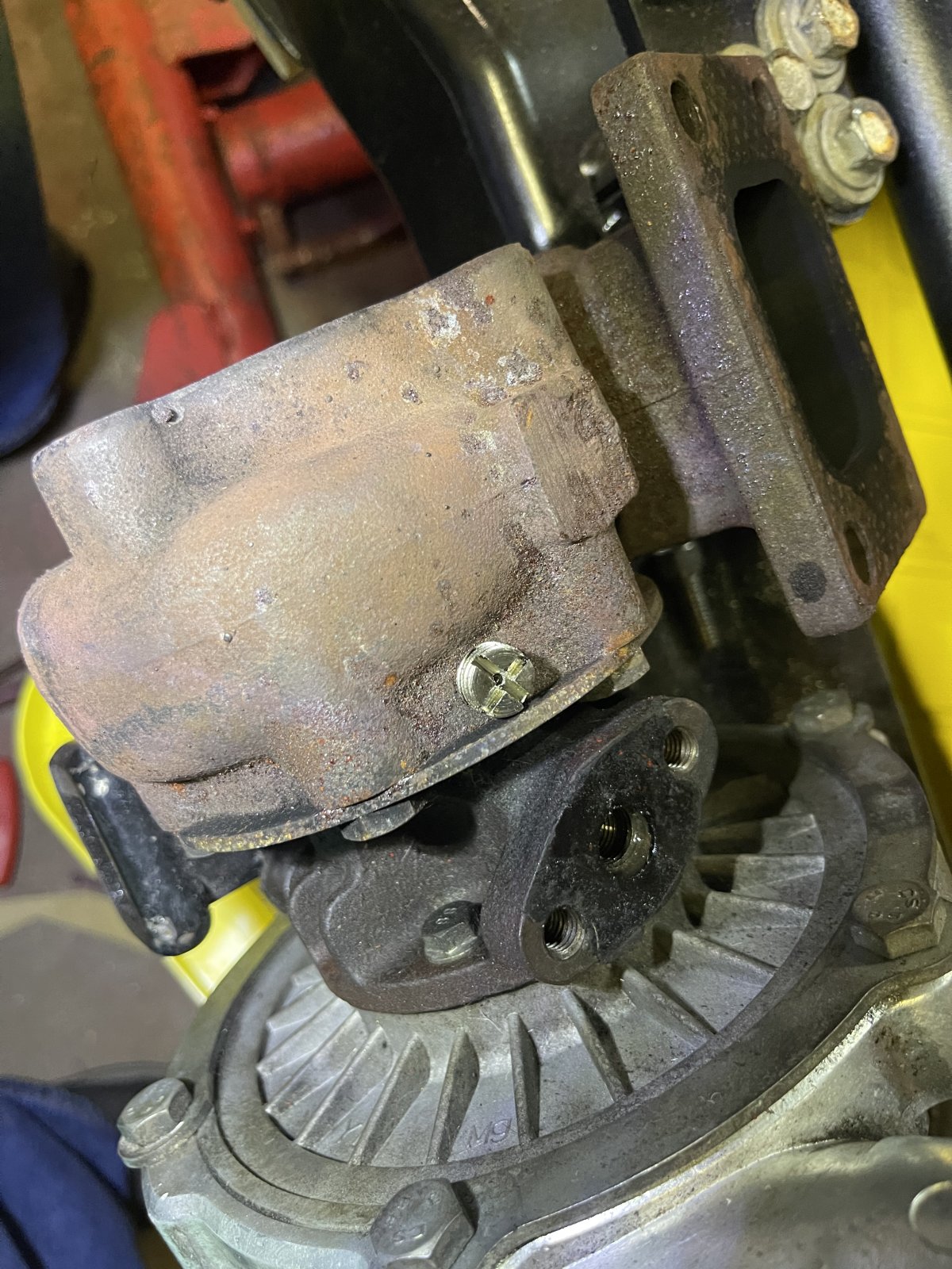

3. The Turbo has NO play and spins smooth. I dont see anything obvious
4. I do think the oil Outlet is on the smaller side this is a 10AN fitting but the ID of the Adapters is 5/16 seems small.

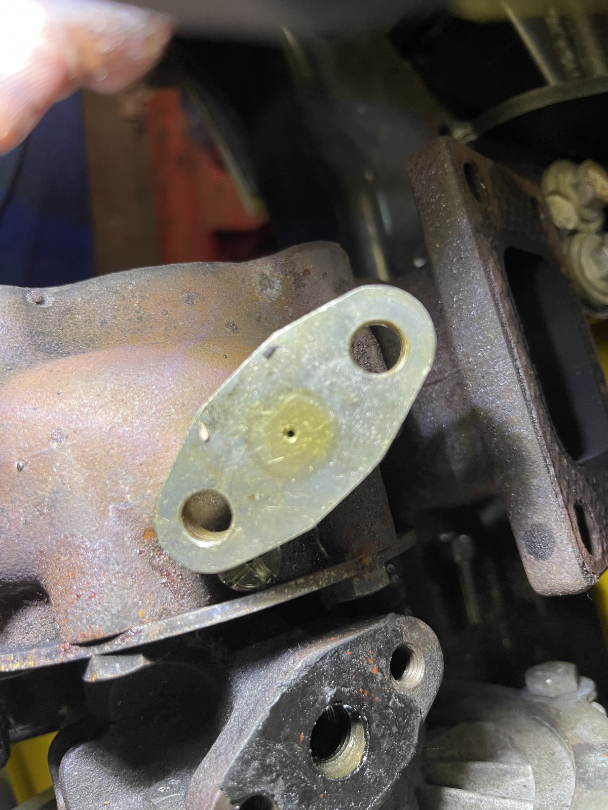

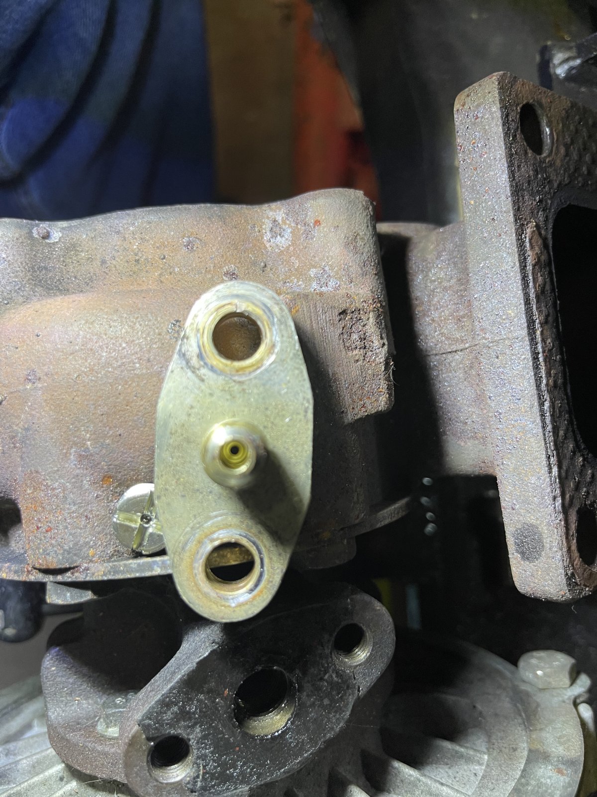

5. I found a Oil restrictor underneath the Turbo Oil Inlet. The inlet flange itself has a very small hole and I believe this is an oil restriction hole in the flange so not sure why there is also another one under it. PICS attached
My Suspects
1. maybe the wastegate is not working properly and building to much boost then it flys open and dumps everything.... My boost gauge showing -21 boost I am not sure why it is showing negative reading.
I am thinking maybe the wastegate because the knocking sound goes away after a bit when the engine is idling. I did not get a chance to look at the wastegate pipe to see if it was exhausting during the knock.
2. Maybe a hidden turbo issue? The oil in the intake to me means the oil is not draining from the outlet fast enough.
Options I can think of
1. remove the manual boost controller and connect the Turbo to the wastegate direct and put a small PSI spring in the wastegate.
2. Replace the turbo and wastegate.

Has your engine been tuned after the turbo was added? (I am thinking not, as the problems occur when boost starts)
A lot of detailed information is available inside of HP Tuners.
The L61 engine is either 9.5:1 or 10:1 compression ratio, it will not take much boost to get to the maximum cylinder pressure this engine can handle. Creating boost, if the ECU is not programmed correctly as Ross indicated, will likely cause a pre-ignition detonation situation that will be detected by the knock sensors and the ECU will pull timing out of the engine to compensate. If the waste gate has been set up to create lots of boost at low RPM, it will not dump much of it - if any - until the engine returns to idle, which may be causing the knocking sound to persist. Having oil in the intake does not help this situation and will exacerbate the detonation. This has been confirmed by pulling the charge pipe and running the engine as a NA, where it is running ok. Sounds like the ECU needs to be programmed for boost.
If this isn't tuned, stop driving it in boost until it's tuned and you get a functioning boost and AFR gauge. If this is "tuned", stop driving it until you get a functioning boost and AFR gauge. At this point you have a unknown turbo/wastegate that might be producing who knows how much boost at unknown AFR. That is a good way to blow even a forged motor.
Was the turbo used? Is it a K04? Even a K04 is able to produce enough boost while also generating heat to damage am improperly tuned motor. It sounds to me like you are getting a lean misfire. Hopefully it's going lean enough to not make any real power and didn't damage anything.
