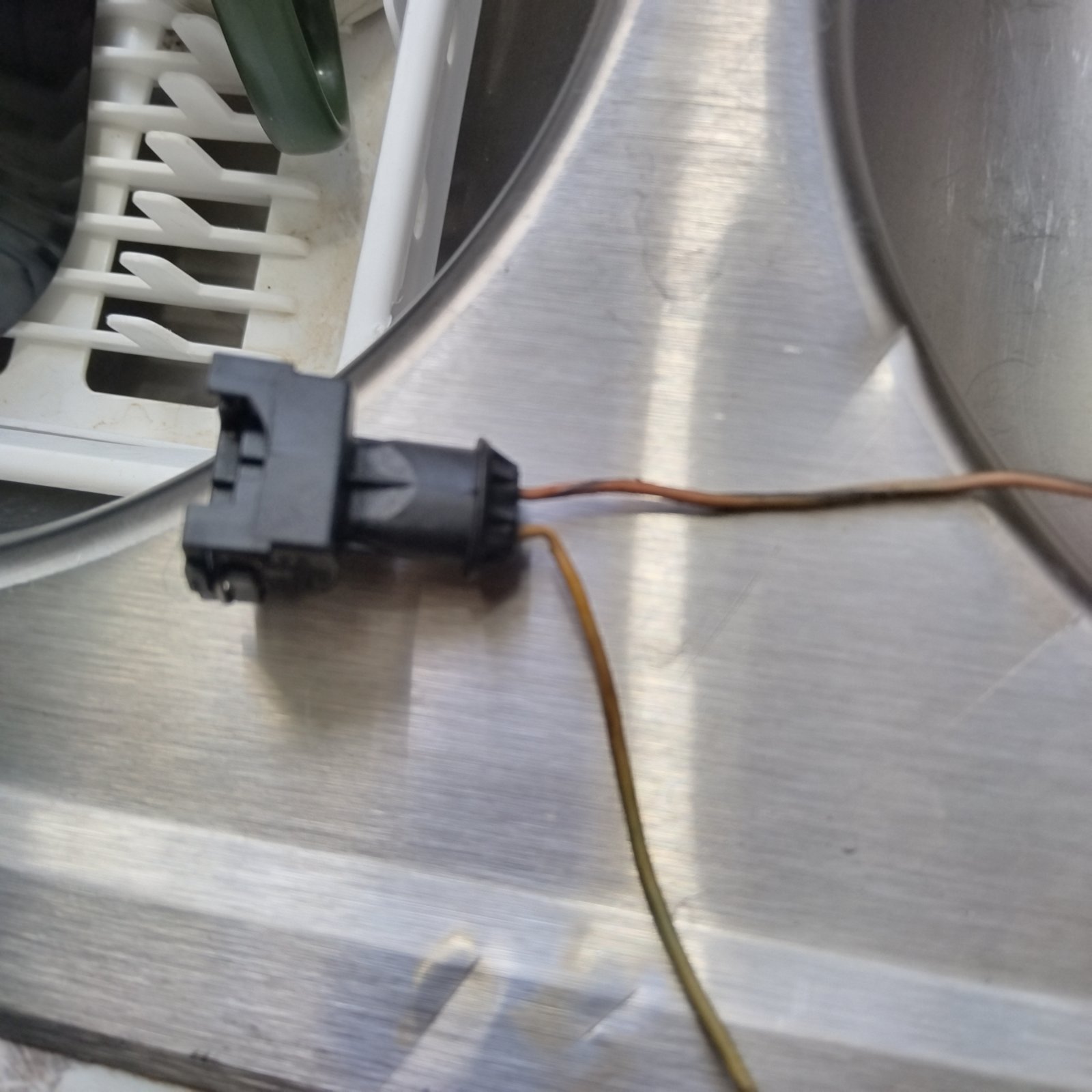

I have been unable to get above 5psi boost on my turbo, found a broken wire in the connector for the wastegate solenoid.
I am about to disconnect it to see if I can get more boost on wastegate spring pressure.
I need to replace this connector...anyone know where I can find one?
plan b is taking it apart and reconnecting the pins to new wires

getting very annoyed I just spent $1,000 in parts to replace the entire top end and timing parts and still not able to get over 5psi. i think its the wastegate. I am WOT in 2nd gear and max boost was only 5 I can hear the turbo full spool. it has to be either the wastegate or BPV
Goblinfanclub1234
i got that amazon generic one coming tomorrow will test it out tomorrow night. I still have never felt what 22psi on an engine with full compression feels like. my comp went from 85-110 up to 145 on all cylinders at 5,600ft altitude
