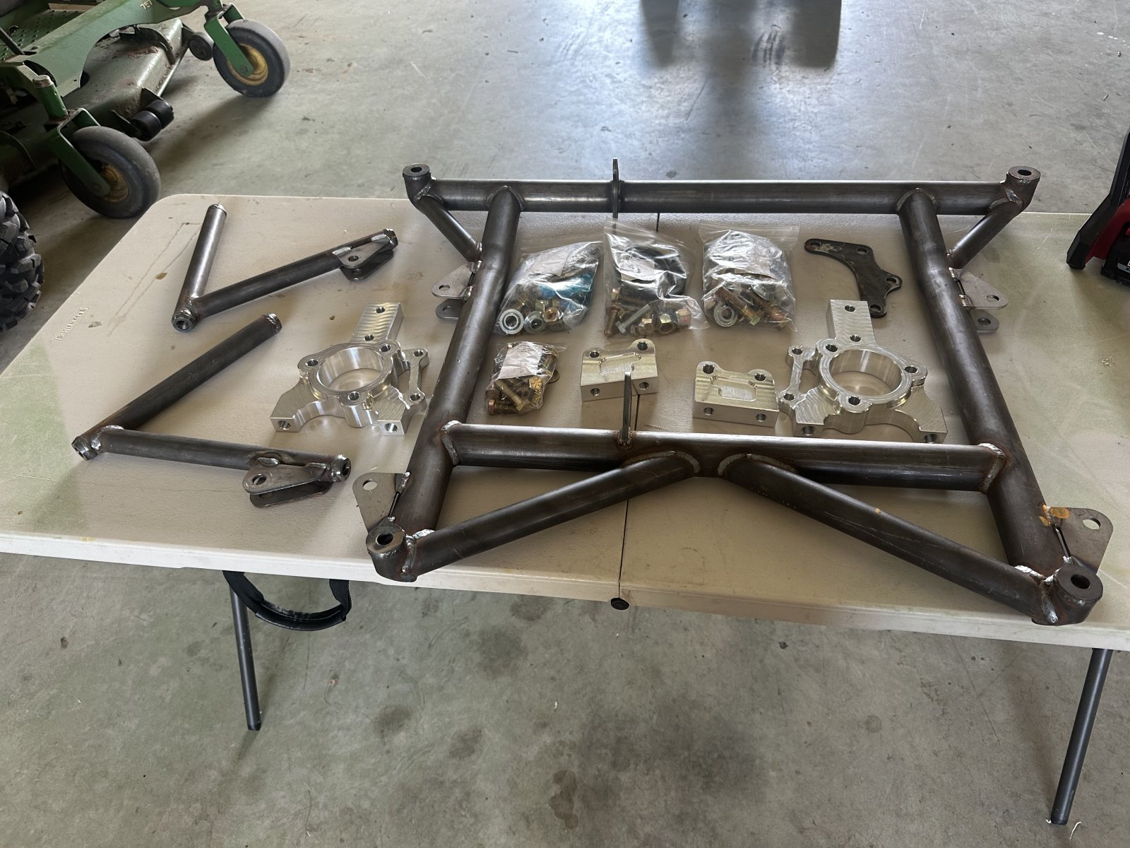

Got mine today. :cool:

I got mine a week and a half ago. I had it powdercoated and it's installed. I'm currently anodizing the spindle and strut mounts so I haven't installed those yet. I have the SC model so I had to cut the old intercooler pump mounting flange off to mount the pump higher using 2 of the supplied coated clamps to clear the front cross tube. Other than that it is a bit fiddly getting all of the mounting holes to lign up right but with a ratchet strap and dome patience it's a 1 man job.
