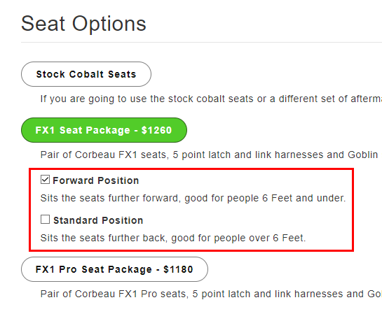

I am fairly certain this selection didn't exist when I ordered my kit:
42112
Does anyone know if this choice affects the seat brackets and/or the frame tube placement? If it is only the brackets, that might make a great retrofit for shorter drivers (not me) or taller drivers who like to be very close to the wheel (me). Also, how much is the fore/aft difference in the position?

My understating is this is only different seat brackets.
My personal experience is that you want to get the forward position ones unless you are crazy tall. Getting those pedals all the way down can be difficult with the standard position brackets. At least for my 5'9" body it was.

I'm 6'3" but most of that is torso so I actually would prefer a more forward bracket too. Plus more space behind the seats for stowage, and I will have the quick disconnect steering wheel eventually to mitigate some of the getting in and out difficulty.

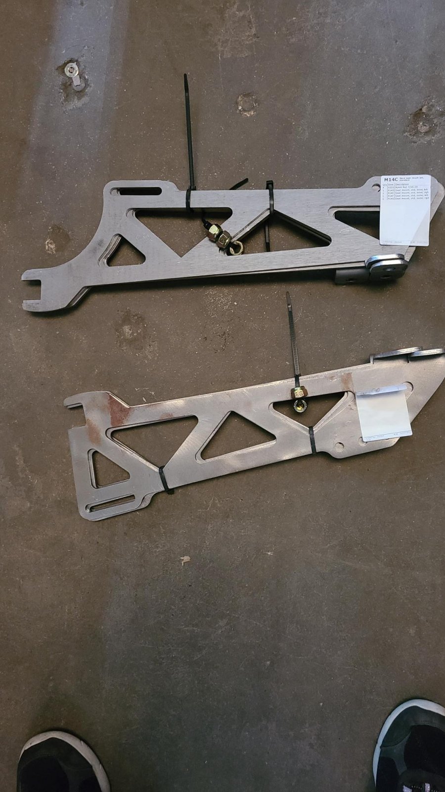

I didn't have that option when ordering and didn't realize I had an issue until I installed my seats.
Here is a pic DF sent me showing the difference between the brackets when I called to ask about seat bracket options. I assume they haven't changed these in the past year:
42118
You can see how much closer the front mounting slot is to the frame tube notch on the bracket. Same with the rear mounting holes compared to the rear mount ear.
Here is a pic DF sent me showing the difference between the brackets when I called to ask about seat bracket options. I assume they haven't changed these int her past year:
This is exactly what I was hoping to see, thanks! Difference looks like maybe 4". That plus lowering ~1.5" would be my perfect position. I might have to buy these from DF and get a sheet metal guy to trace the shape and lower the mount points in some new brackets. Eventually. Cold Weather Projects™.

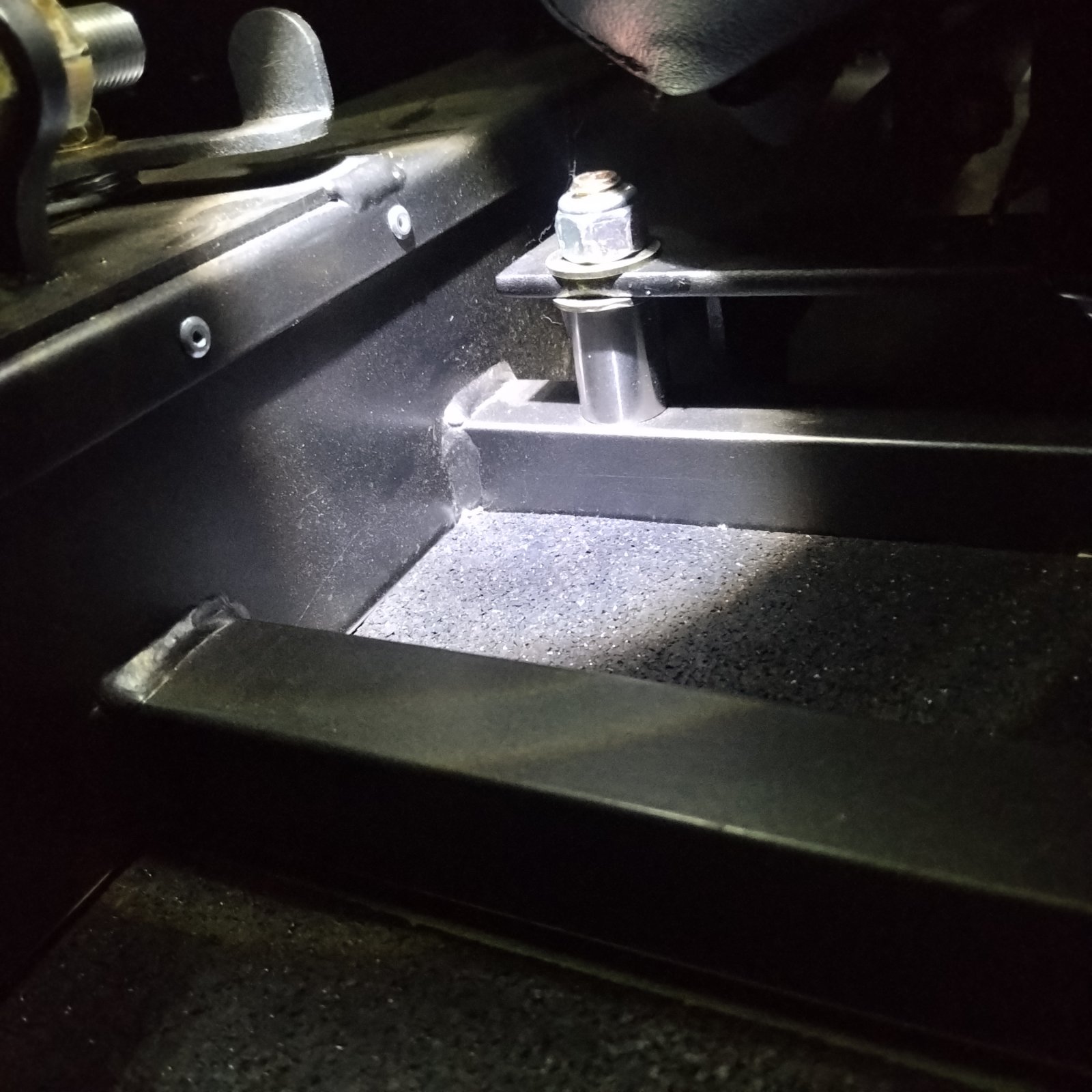

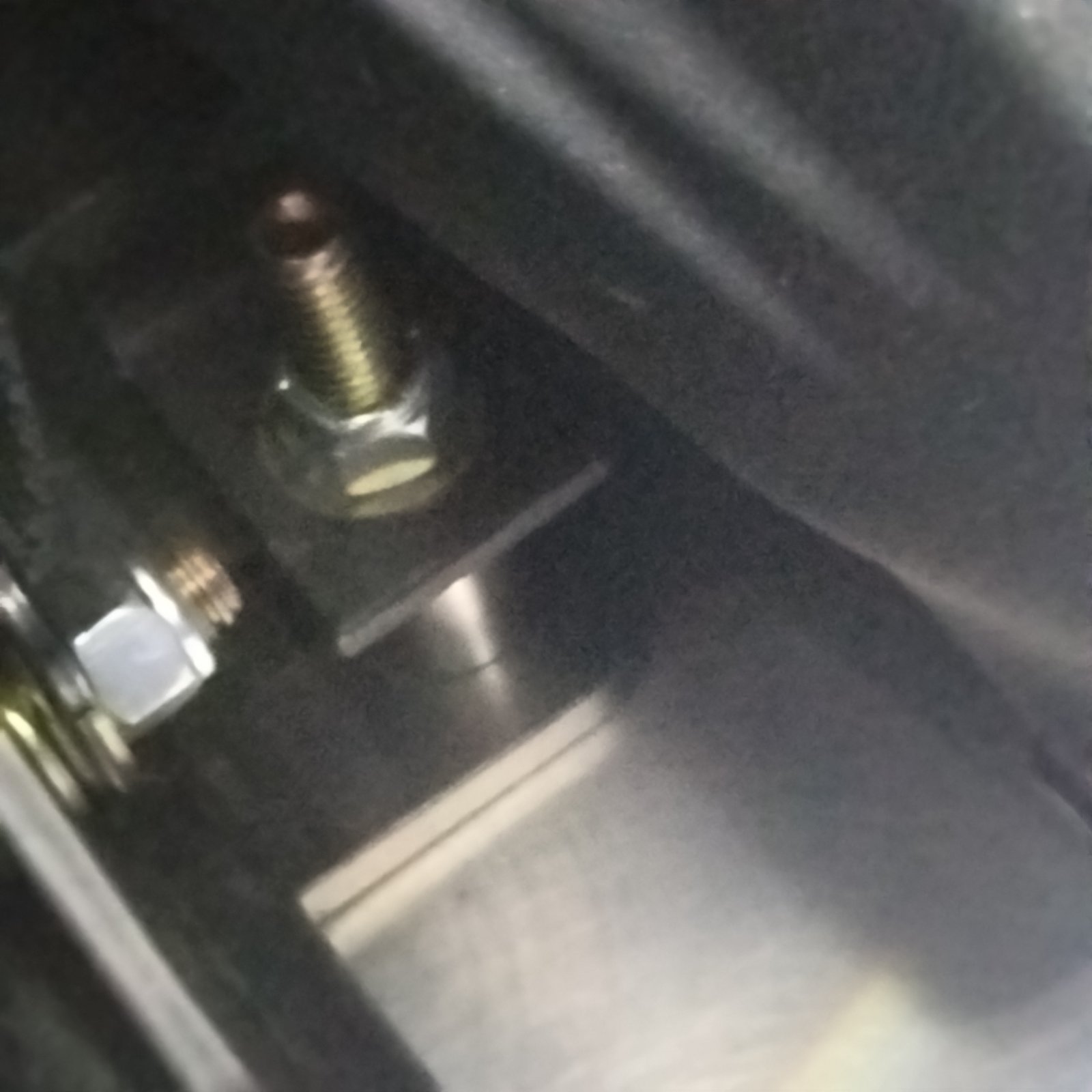

Goblinfanclub1234
It actually sits pretty high up I have these 7/16" ID x 3/4" OD x 1" thick stainless steel spacers in there I got from www.extsw.com
You can see I drilled the square tube in the floor to add bolts to keep everything secure. The hooks on the brackets now sit tight against the bottom of the floor pan.
I do not think that the square tube will crush down, but I am going to keep an eye on it.
