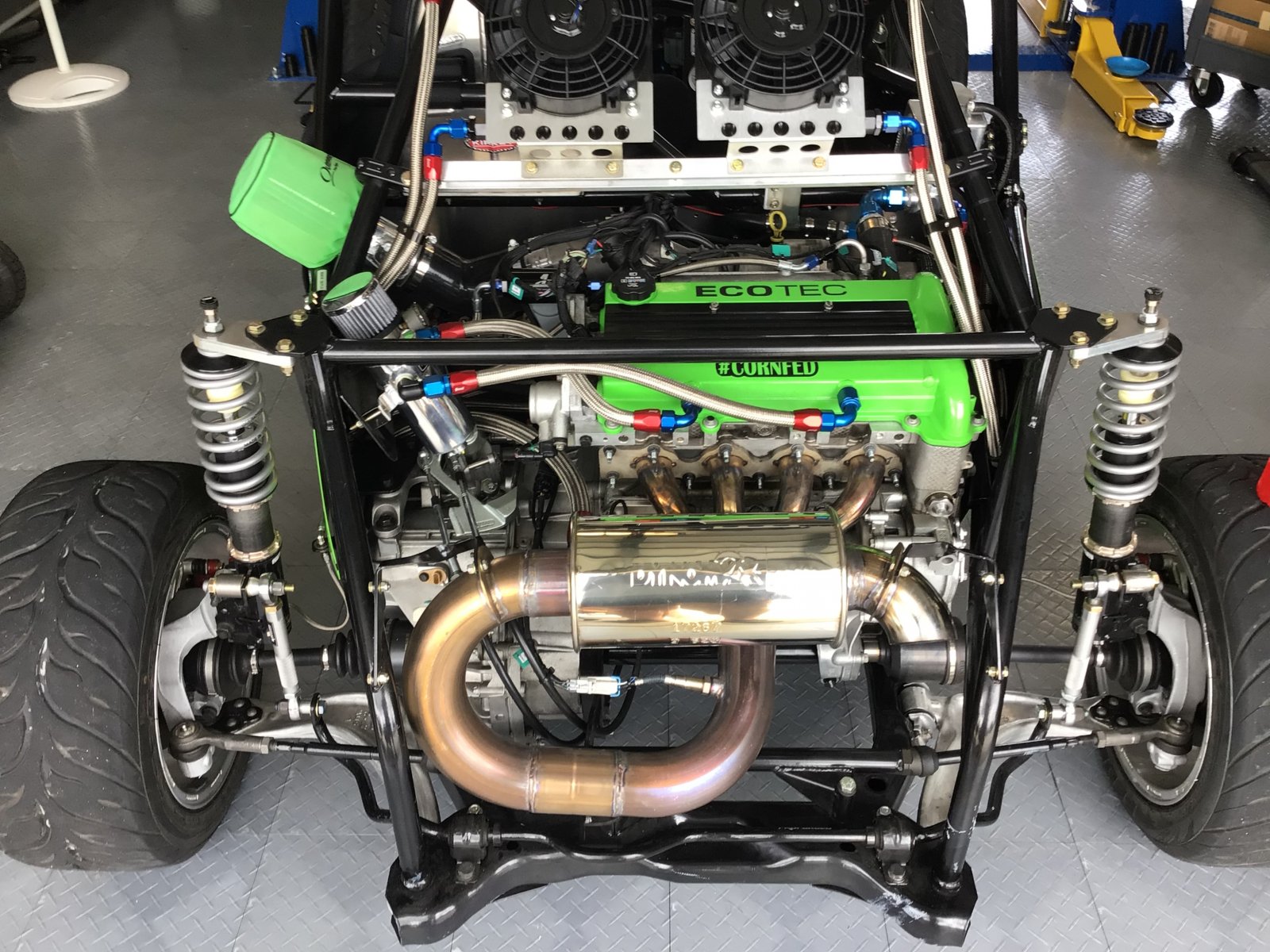

I’m using NGK BKR7E plug , Gap 30
E 85 CORNFED
