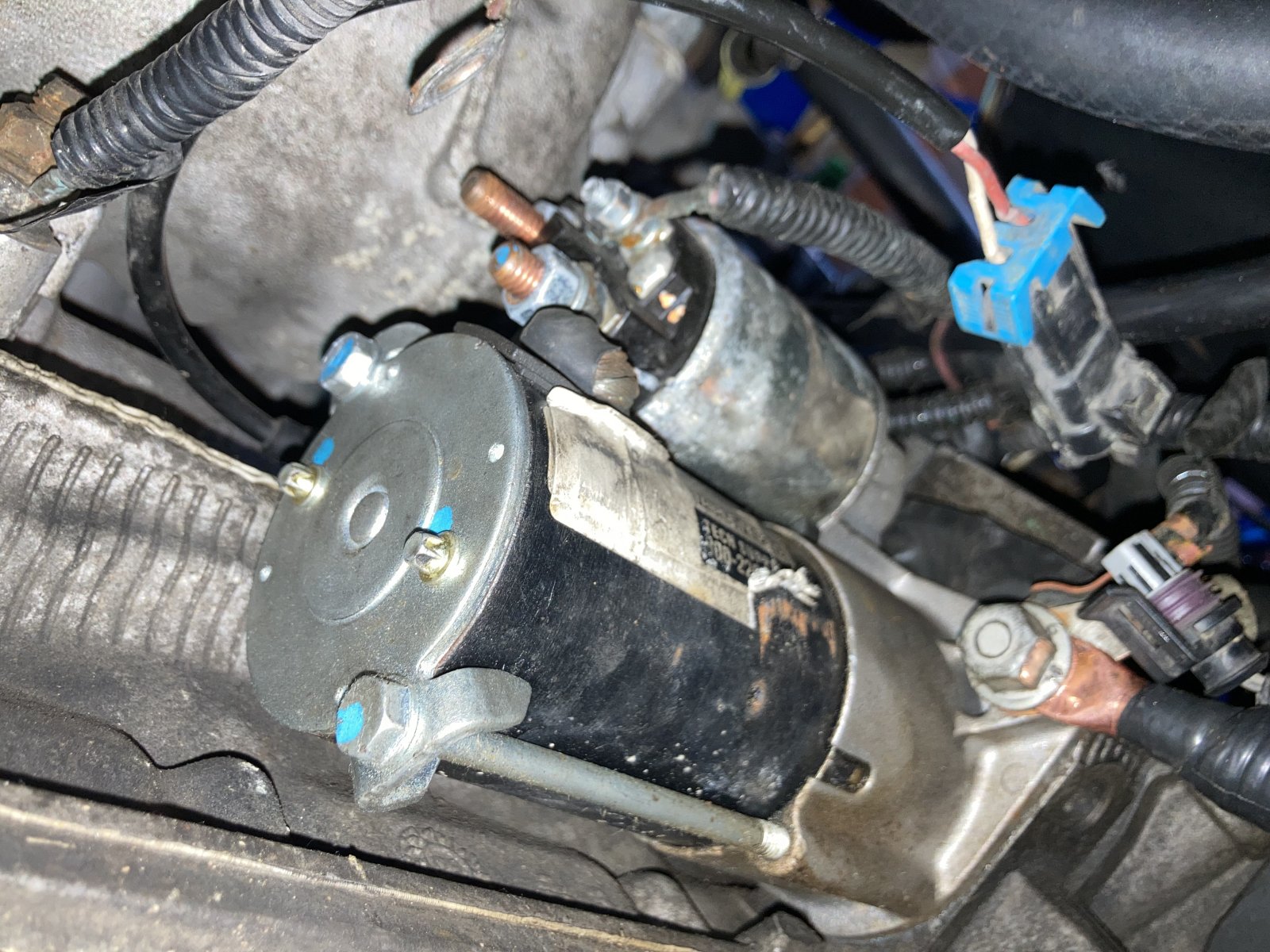

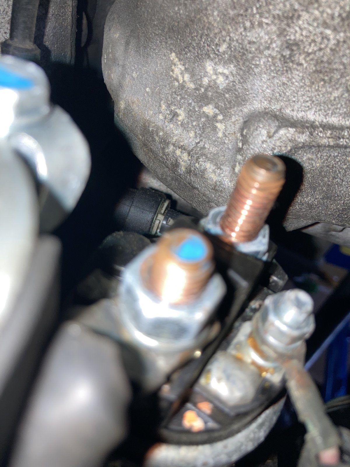

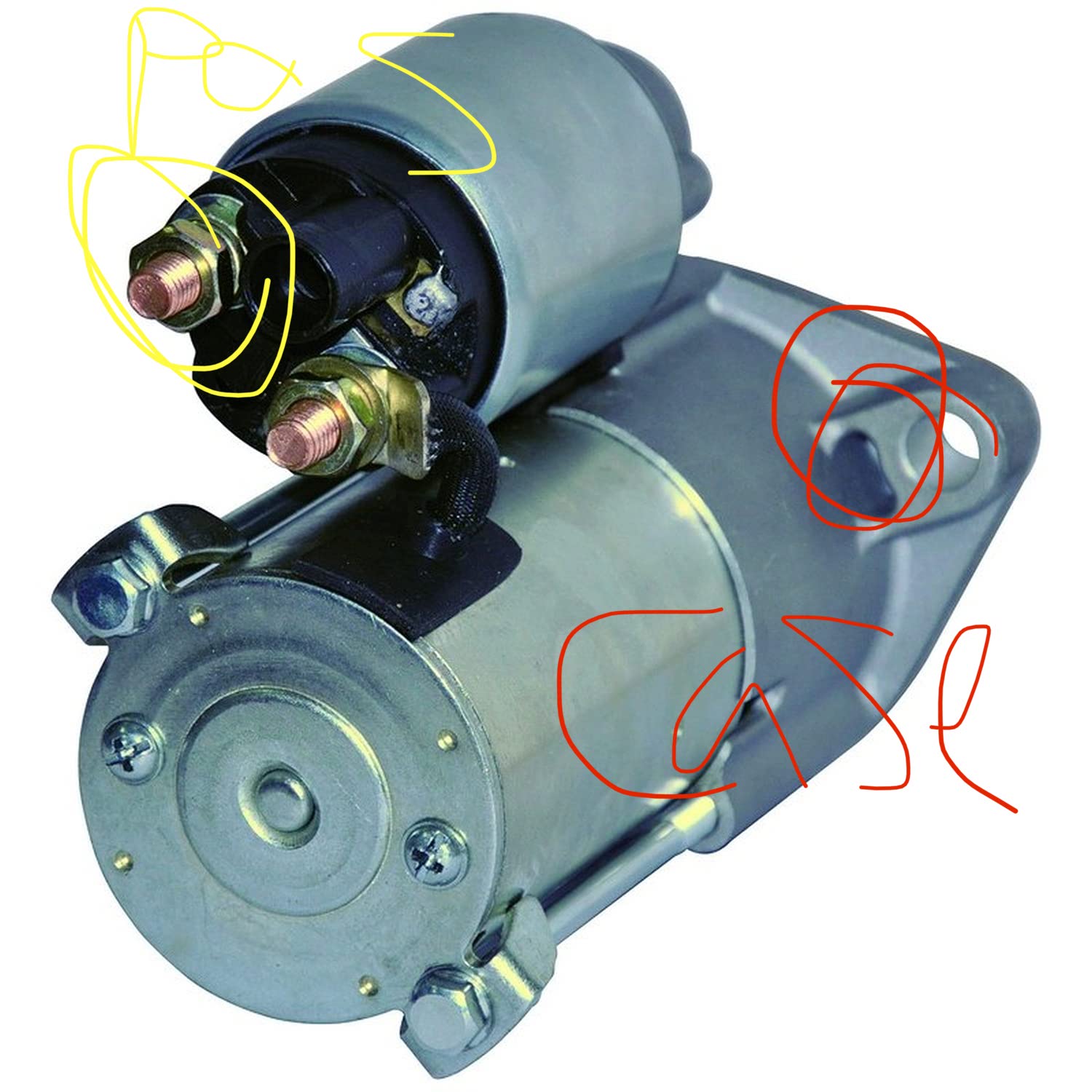

Where does this wire go? That’s probably hot from the battery that goes on the starter positive terminal not starter case. Nothing goes off starter case that I can remember.

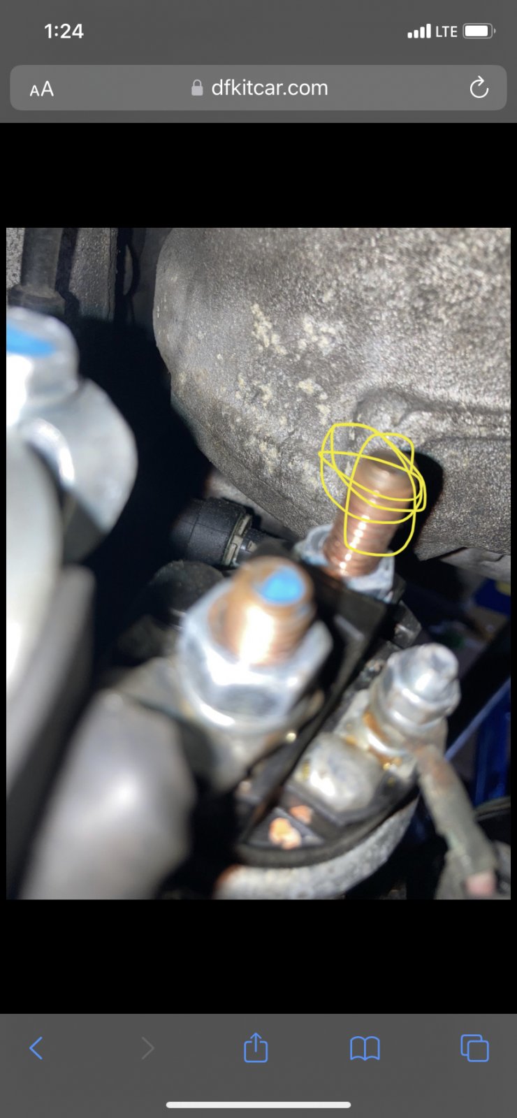

Where is the starter positive stud? There was a wire coming off the starter case before but I suppose it could have been a ground. Is the stud on the end of the starter or the thing that is above it?
Here’s the starter positive and case. Case is ground. It gets its ground through the block that’s grounded to the chassis. Sometimes they will ground the starter case to frame for good measure. I don’t remember if a cobalt did that.
Yep. This is where the cable from the battery positive goes.

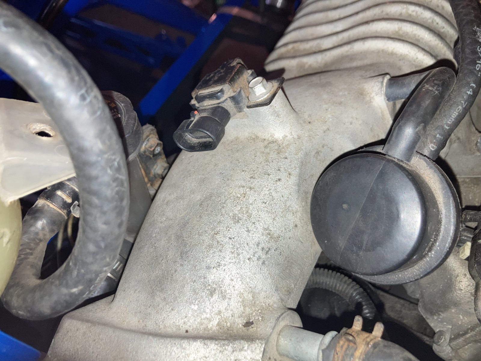

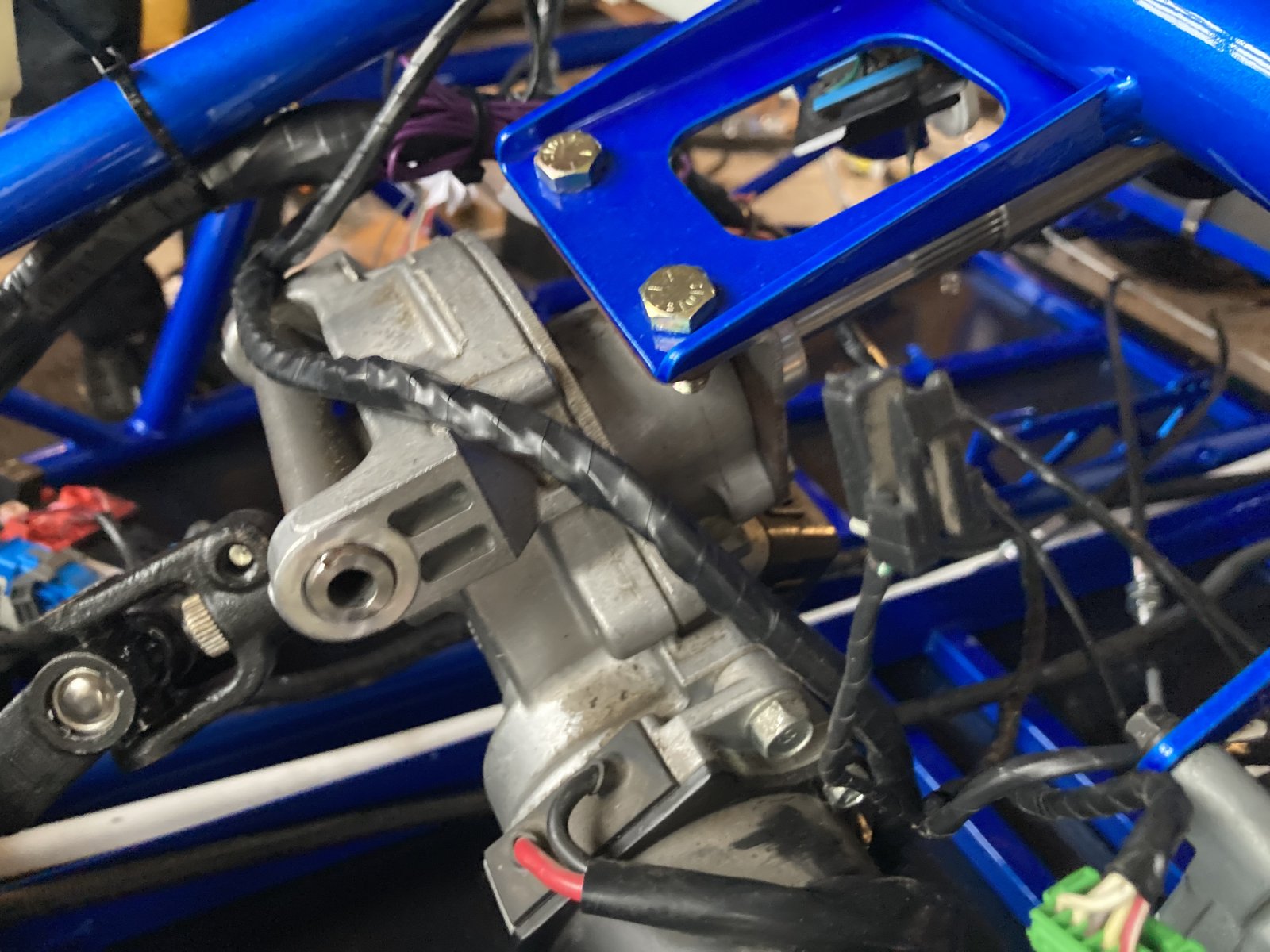

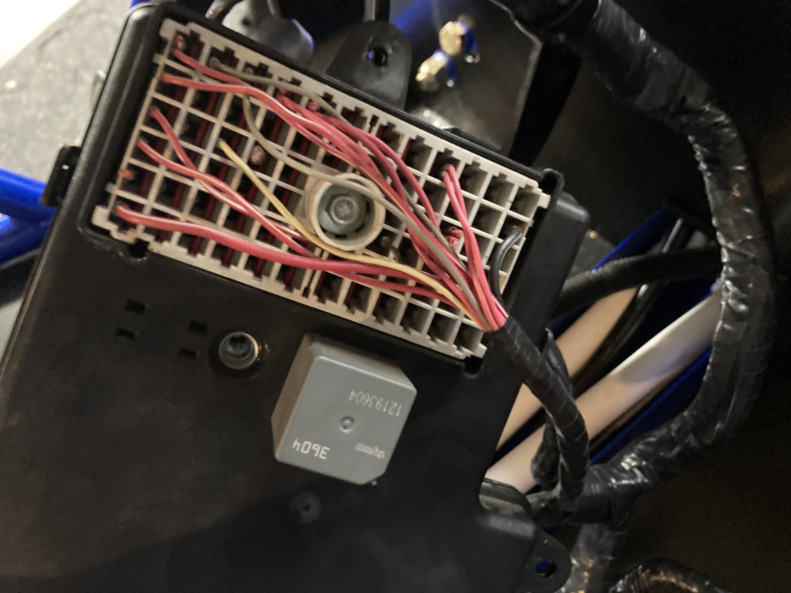

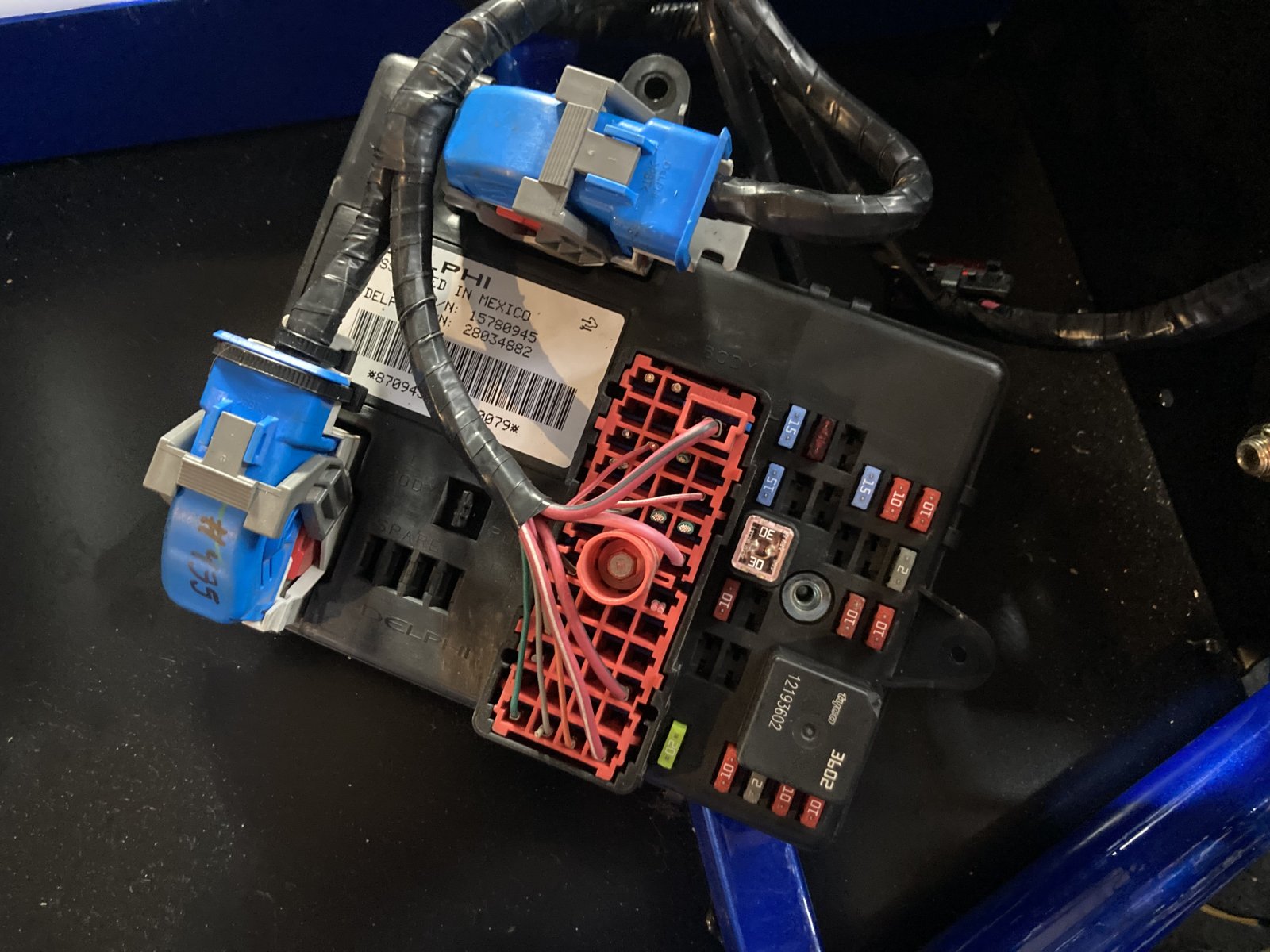

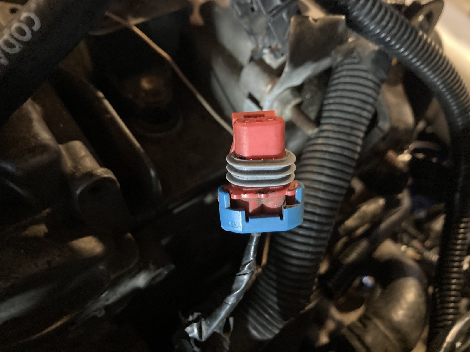

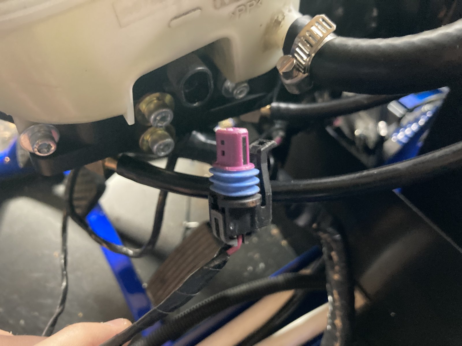

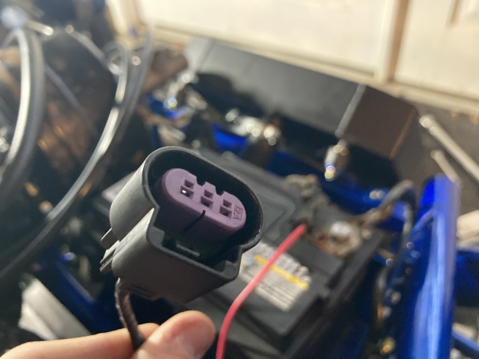

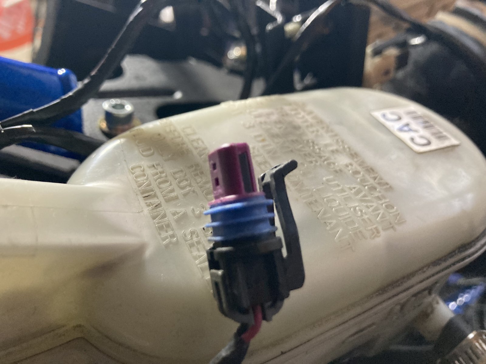

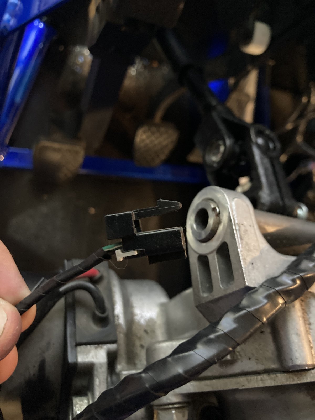

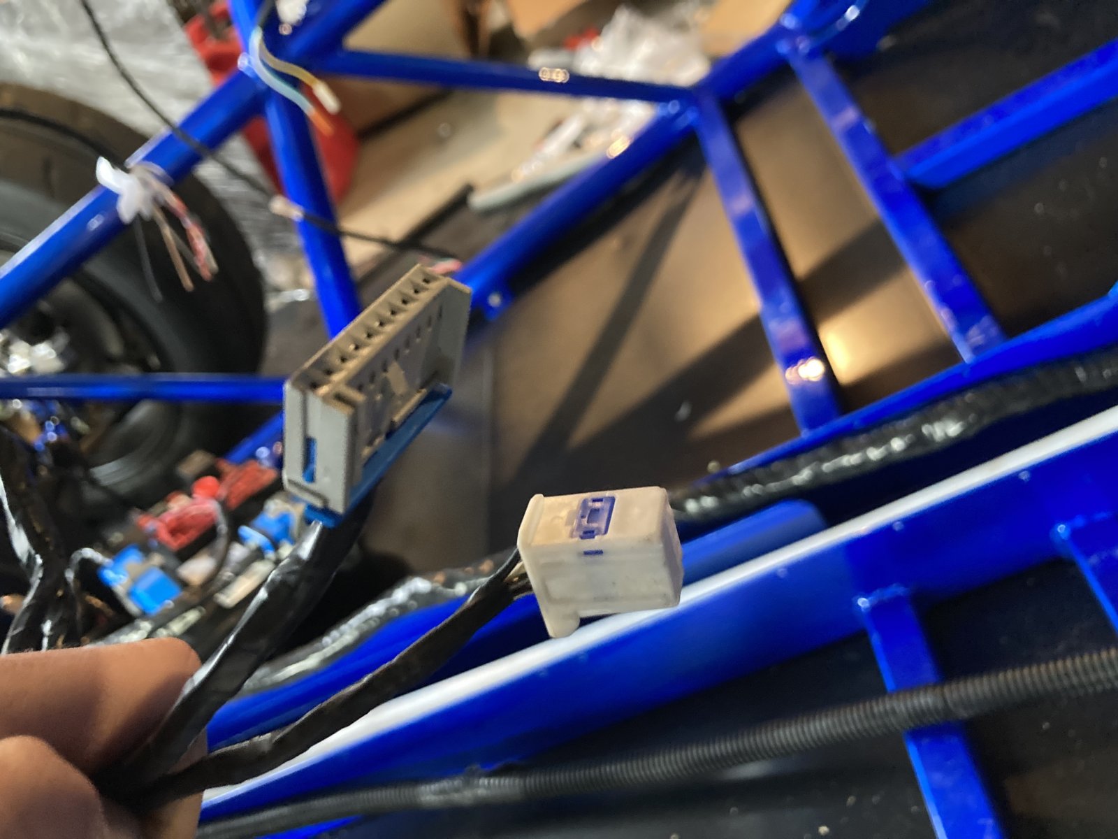

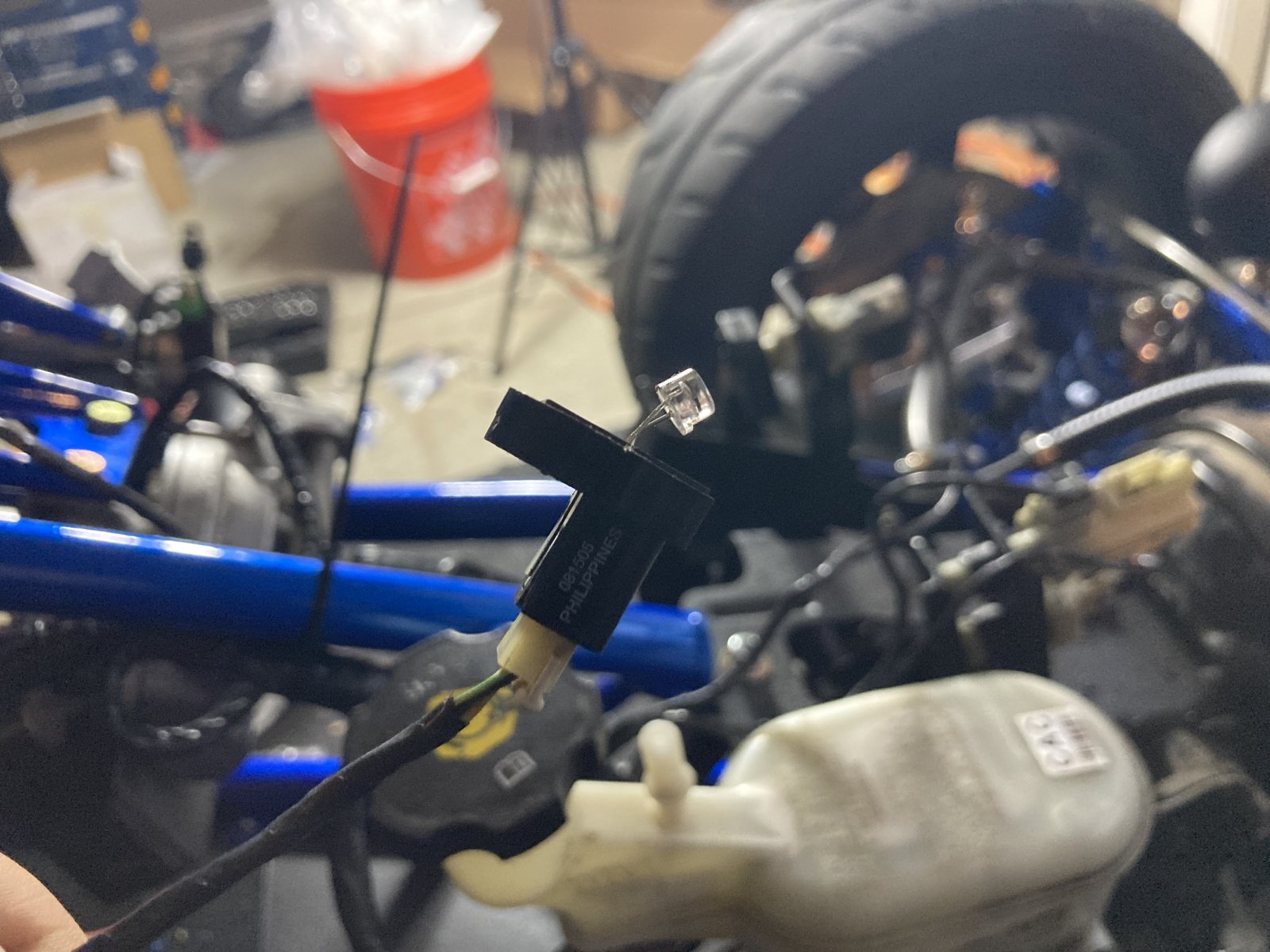

Ok so just went through the videos checking things and from what I can see everything looks normal besides some of the things that aren’t plugged in. At this point we are just trying to get a readout from the display so we are only turning the key one click. I’ll attach some photos of the connectors we don’t have a place for or at least we dont think we have a place for. What is critical for the dash to turn on? I would assume it’s power and the bcm stuff so maybe check stuff around there?

Make sure that the power steering is plugged in as well. In fact, it is a great idea to plug everything in and have all the grounds installed before the first start. Many problems are averted if completing a bit more on the electrical build before first start attempts.

Got it, I will go through and plug everything in that did not seem as critical. Will see if that fixes the issue or not.

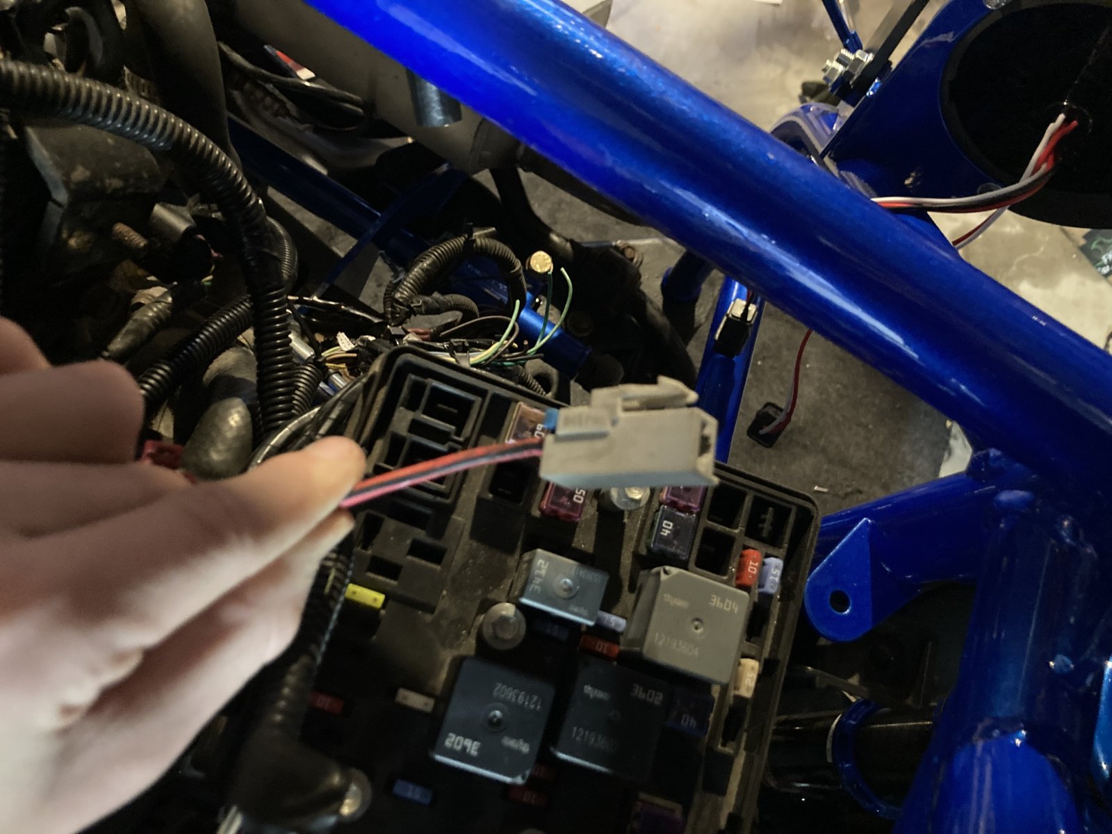

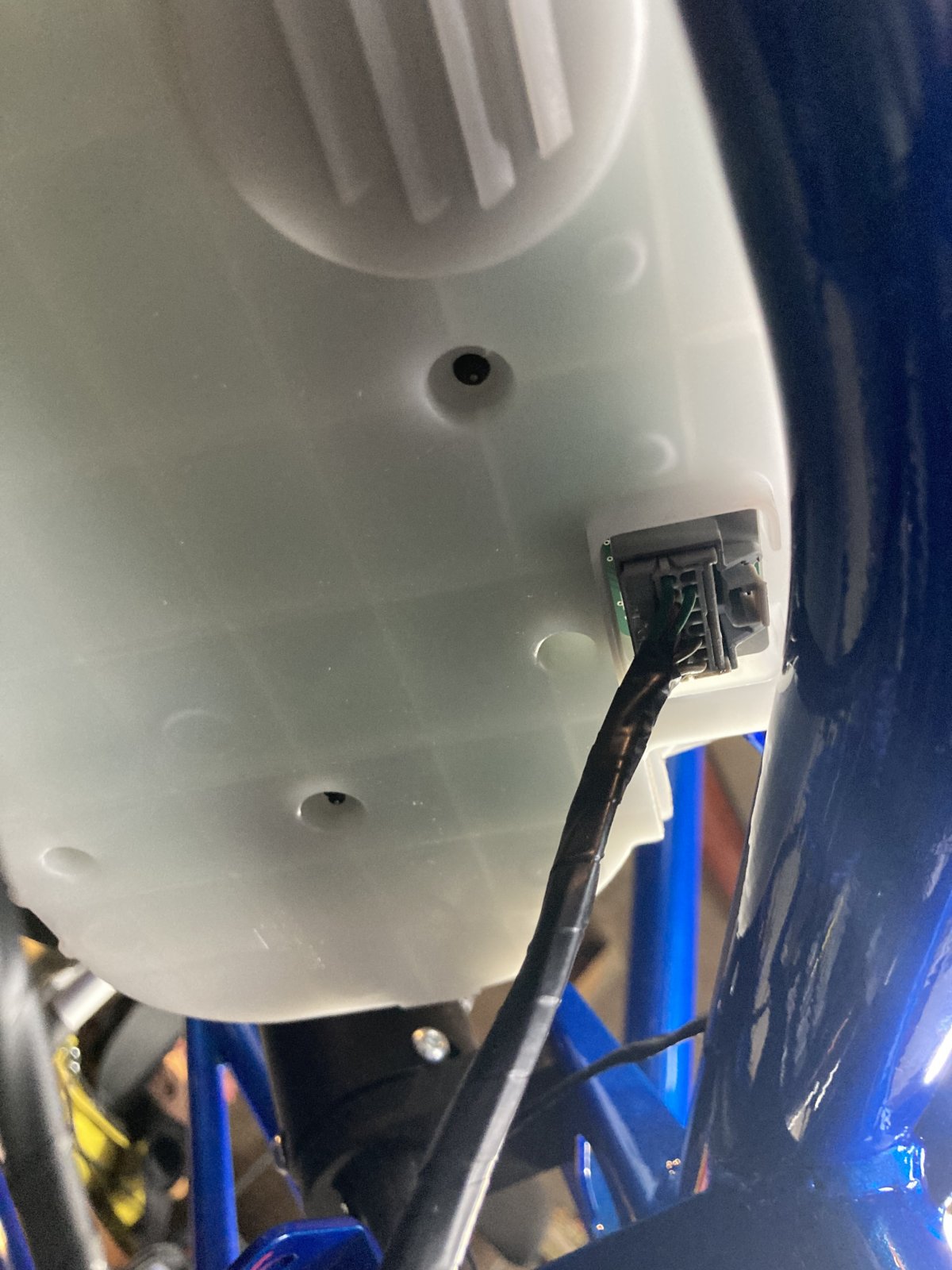

Just connected all the wires and still nothing. There are some that are still unconnected but I don’t think that would affect the starting of the dash. Any other ideas? Maybe measure voltage coming into the dash? I don’t know much about this so really any ideas help!

Checked again and couldn't really figure much out. The third wire seems to me like the one that would go onto the top of the ignition but in the video that says it is only for automatic cars and not for manual ones. The first wire I looked all around the fuse box area goes, if anyone could identify them that would help a lot I think.
