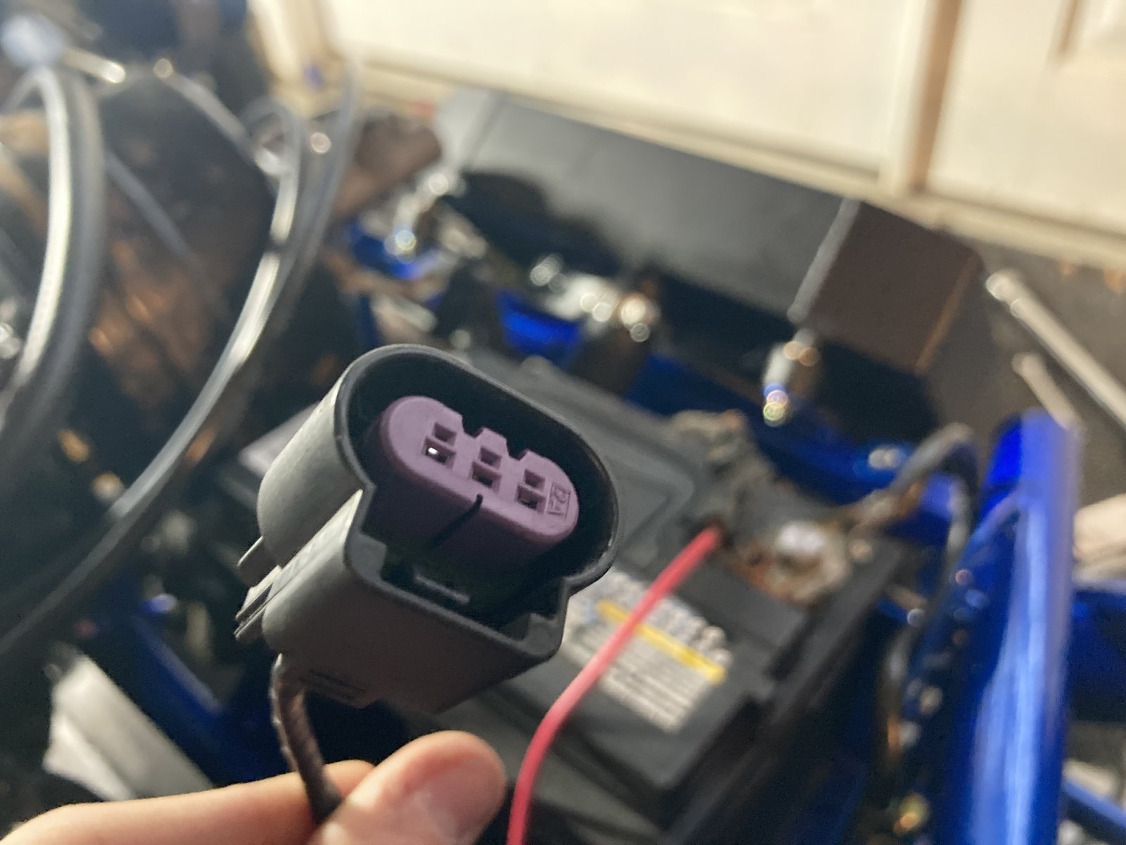

plugs into top left of fuse box when looking towards the back of the car

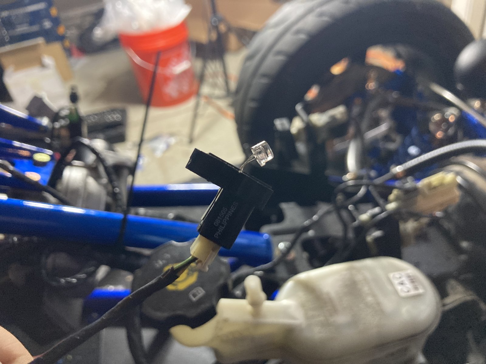

light sensor for the headlights and the dimming dash...
36820
judging on the fact that it is near the front of the car it looks like the throttle pedal connector
36821

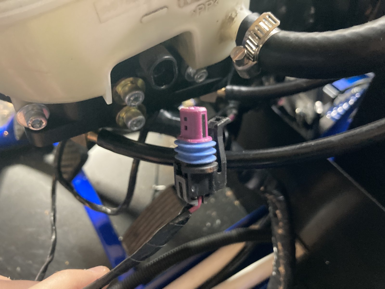

coolant level sensor plug?? the sensor is right there in the picture.
K
Thanks so much, meant to not post that bottom one as I did find that one went into the brake reservoir. I will try plugging that one into the fuse box tomorrow but the fact that it goes into the fuse box gives me some hope, it could be the culprit.

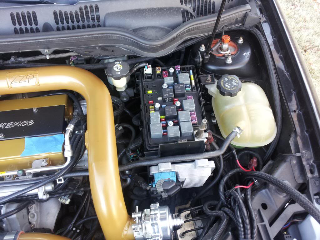

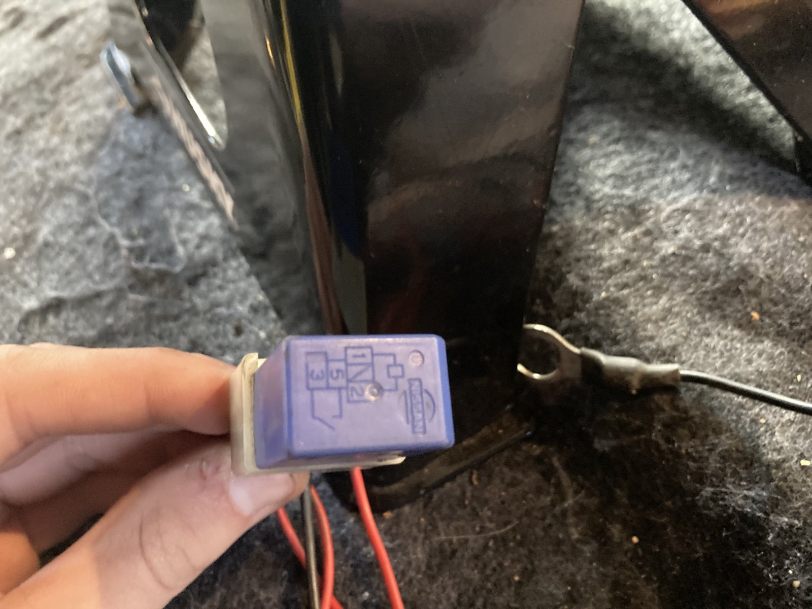

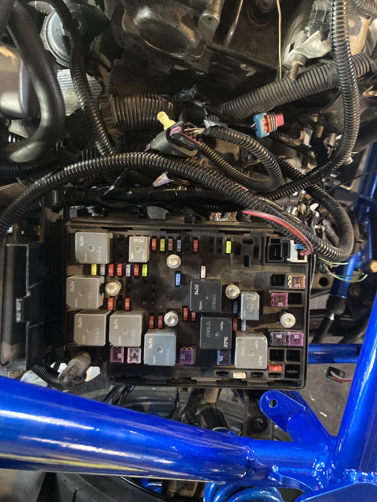

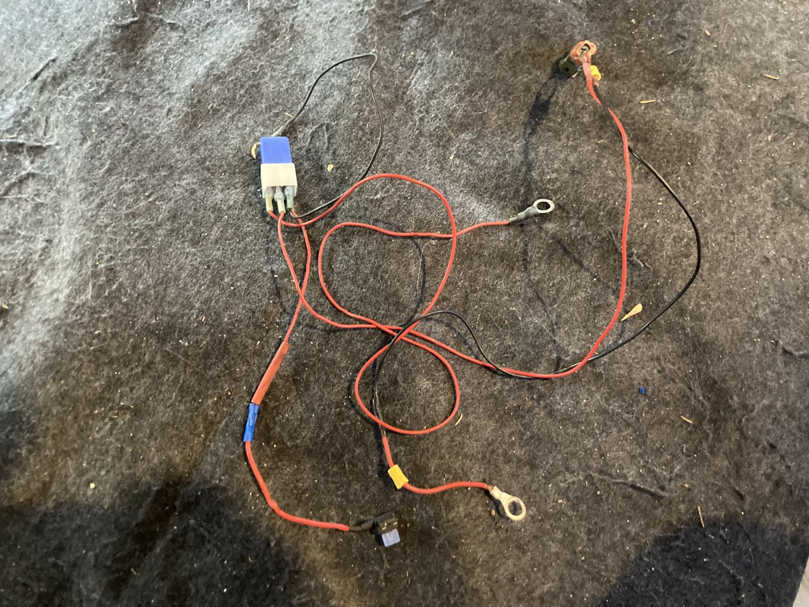

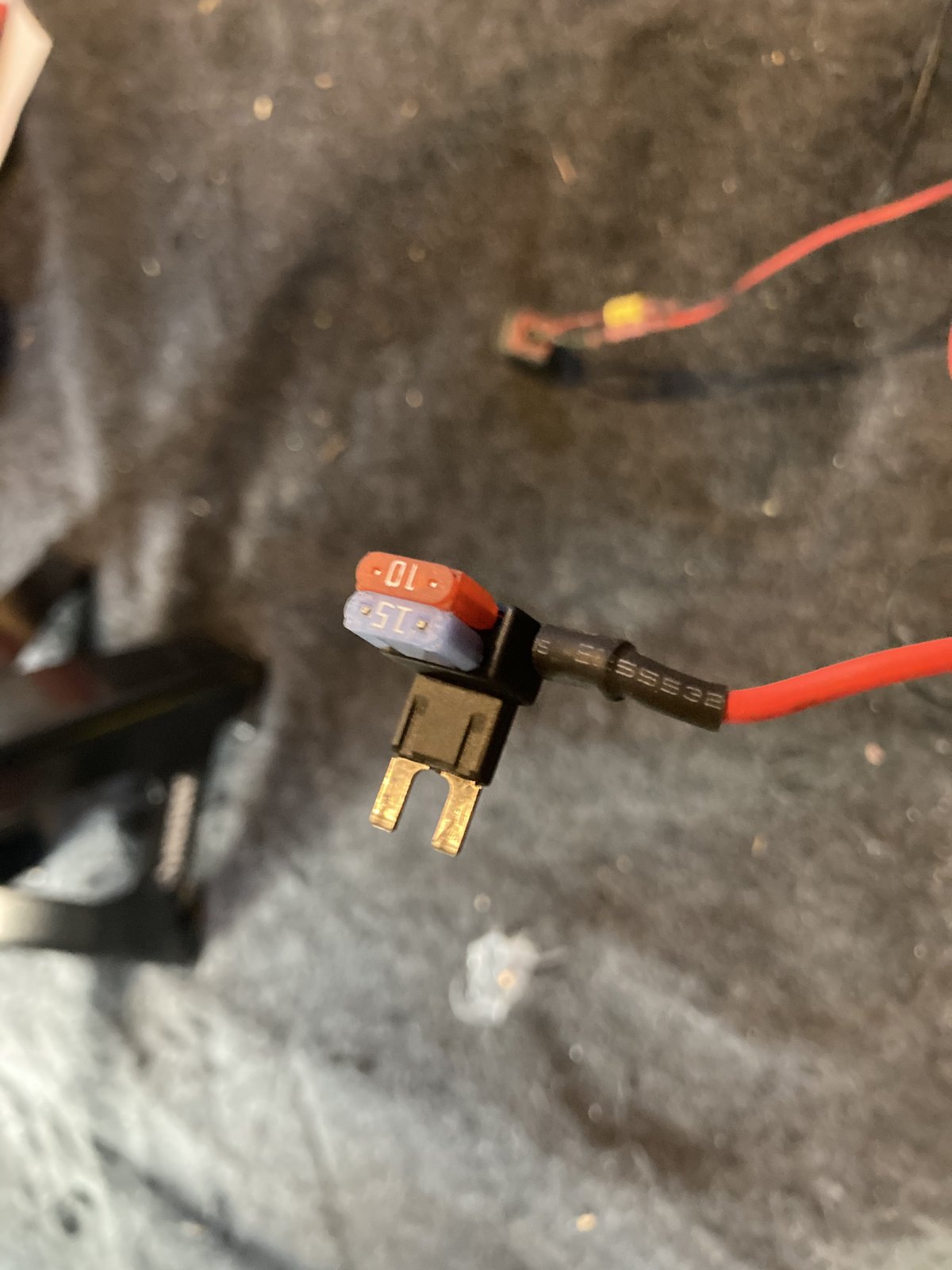

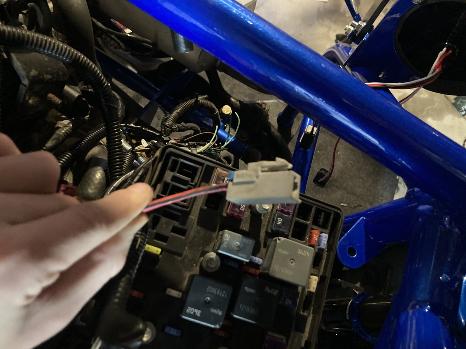

This morning I tried plugging in the power steering wire into the fuse box and still no luck. I realized that we also have another makeshift little harness that the previous owner used to install the supercharger to it, I also realized there were 2 fuses attached and looked at the fuse box diagram to see where they might go (couldn’t find a picture my donor fuse box unfortunately). I found that the ecm fuse wasn’t there and tried putting a 15 amp fuse and still nothing. The first three photos are of the harness, I know it goes to the heat exchanger pump but I don’t know where the other connector goes. Last photo is of my fuse box and I took out the 15 amp fuse that goes to ecm power and put it back into the double fuse from the other harness. I just wanted to know if I’m checking my grounds correct, I am putting one of the leads of the multimeter onto the metal part of the wire and the other lead onto the stud itself. The multimeter then reads .5 ohms.
