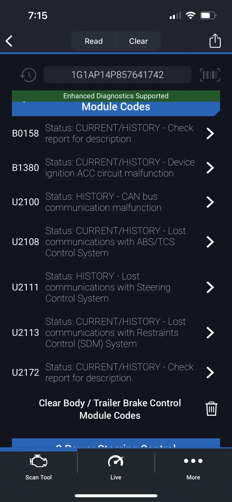

My BlueDriver is giving me all of these errors all of a sudden. I can’t seem to find out what’s causing this or if it’s related to not having spark. Any ideas?
The codes that only state “history” are non active codes.
History: your car wasn't communicating on the GM high speed LAN.
ABS has been removed, so it won't be communicating.
SDM has been removed, so it won't be communicating.
B1380 seems like a big clue. Accessory circuit short? The key circuit is shown in the first image here.

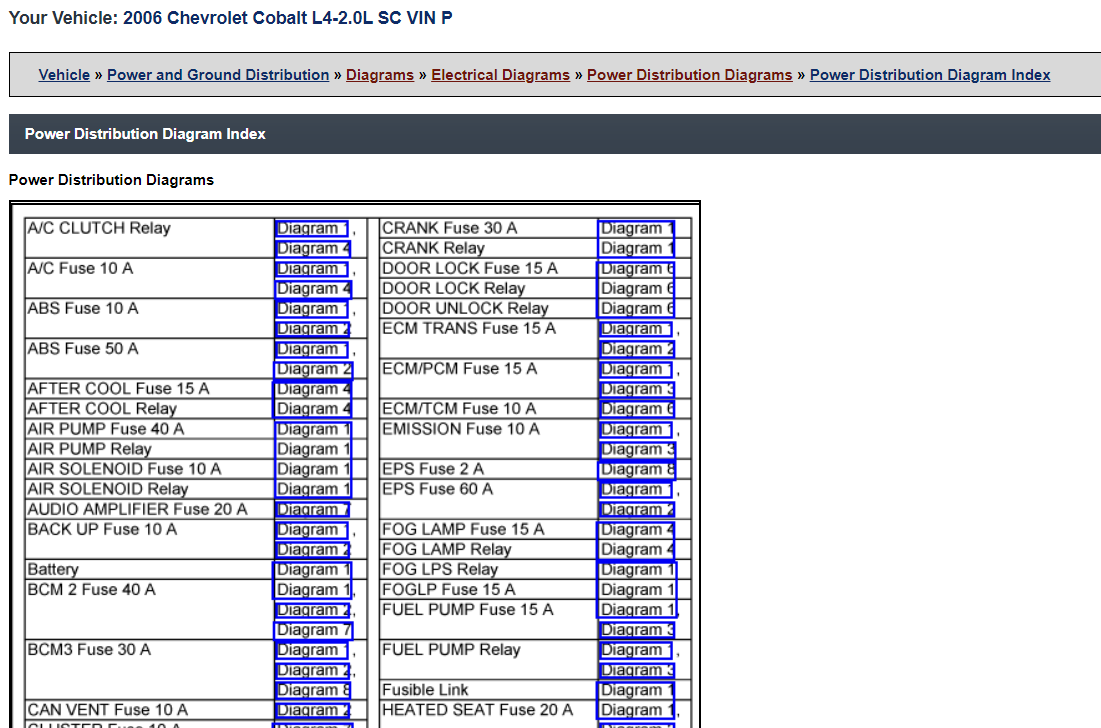

The ignition key circuit is the first image here.
The BCM C4 connector, D1 wire is listed there, and 2 fuses need to be working for it to get 12V+.

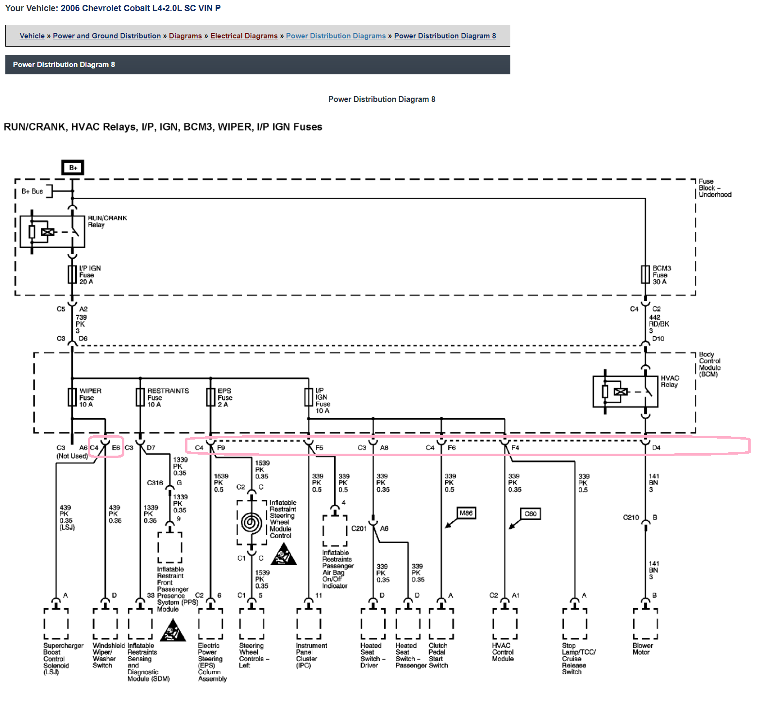

The Run/Crank relay coil gets power from BCM2 40A fuse in the fusebox, then the IGN SW 2A fuse in the BCM
Then it should connect to the ignition switch.
It is probably faster to test the BCM C4 connector when it is installed in the car, and just probe the pins with an electrical meter.
All the pink wires are RUN/CRANK wires, so if they have 12V when the key is in RUN position, and have 0V when the key is off, I would say they are good and move on.
Red wires with a white stripe are all Battery Positive Voltage. So they should have 12V+ all the time.
Grey are all instrument panel lamp supply voltage. so 12V+ when the lights are on.
That is almost all the pins in the BCM C4.

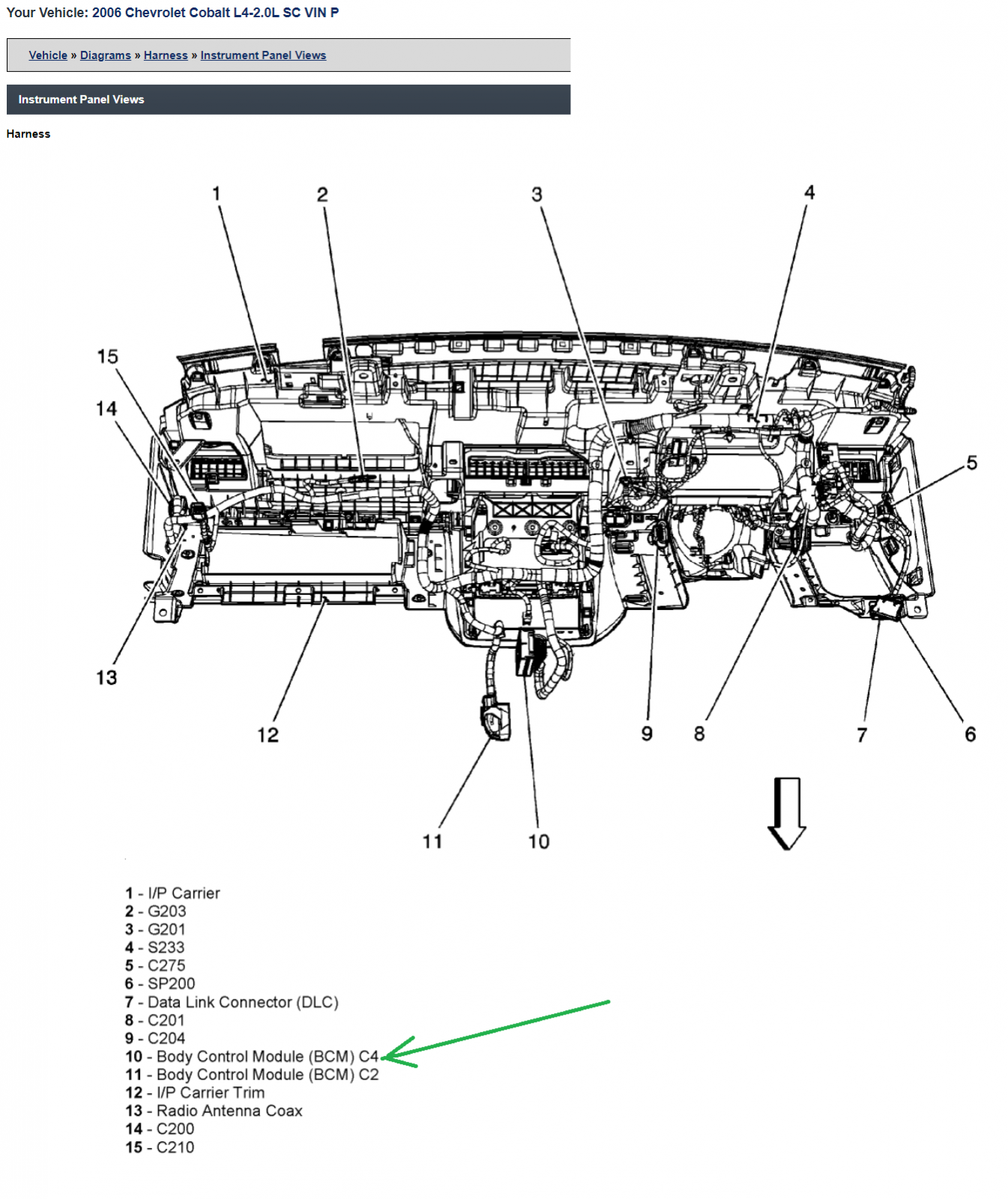

I found that BCM C4 is part of the instrument panel harness. (I/P Harness)

A lot of red/white wires, 12V power distribution information is here. Just log into AllDataDIY, and follow the grey header.
37078
The pink ignition wires are here
