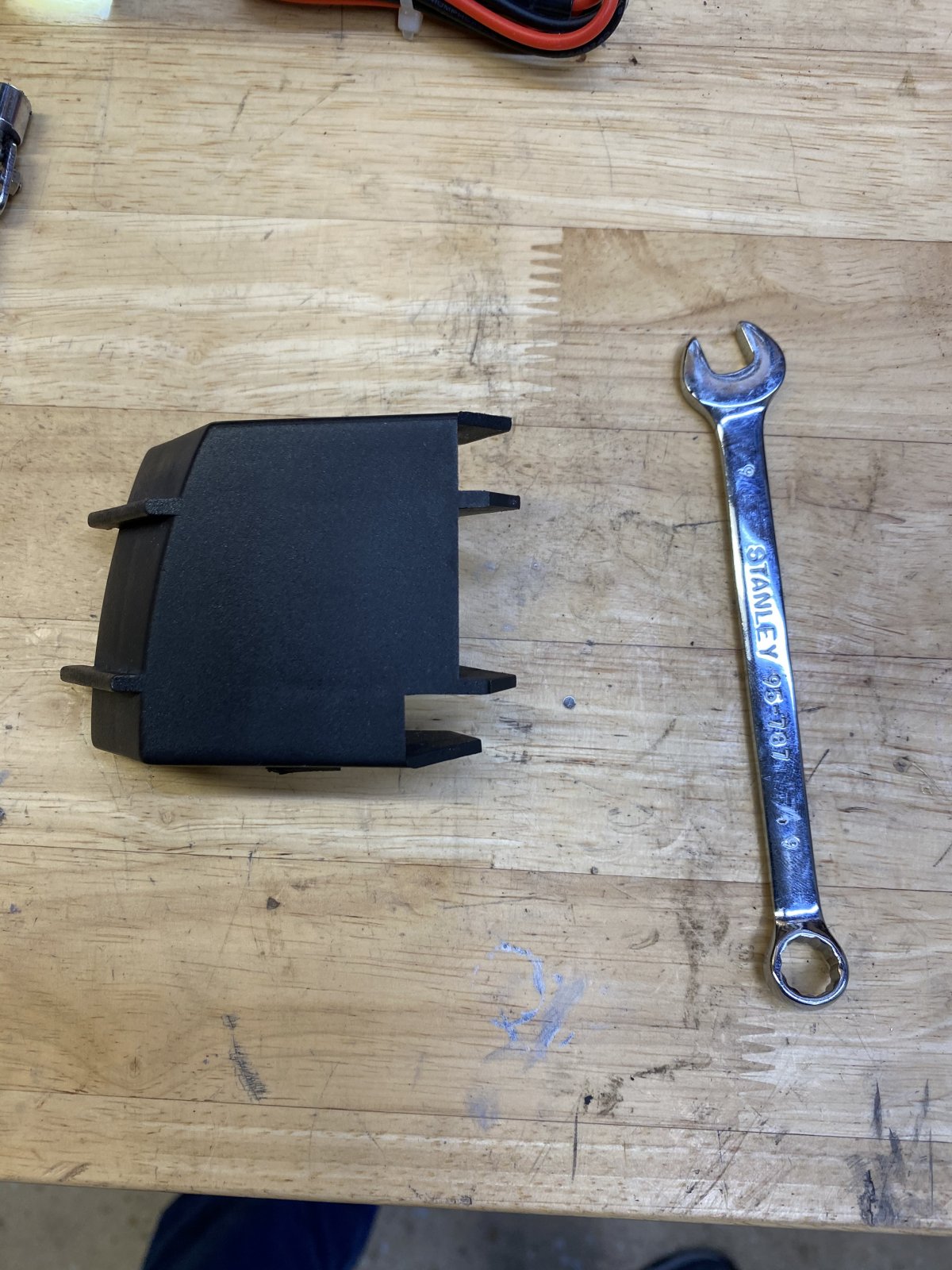

I discovered it’s best to have this cover in place before bleeding the clutch line. A 9mm wrench can easily drop into the transmission bell housing. By pure luck, I was able to locate it with an inspection camera and retrieve it with a small telescoping retrieval magnet.
