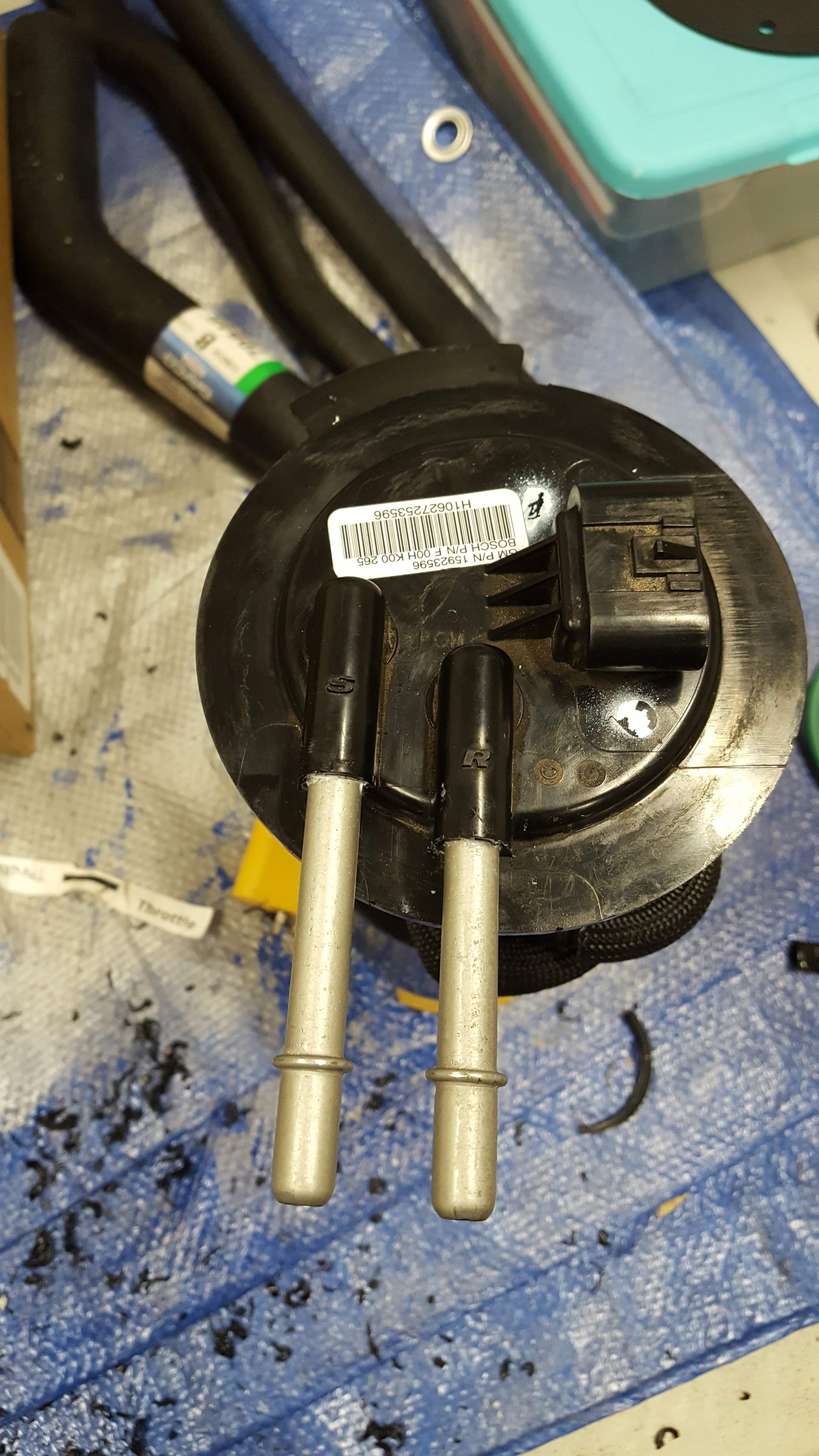

Playing around in the garage, I noticed that there was enough material to drill out to 3/8".
Looking at the DF-supplied fitting that mates to the fuel filter, I realized metal SAE push-on 5/16" and 3/8" flared tube is this diameter.
What if we drilled out these FP hats to accept metal tube?

Dorman 800-082 Fuel Line Fitting
Dorman 800-155 Double Bead Fuel Line

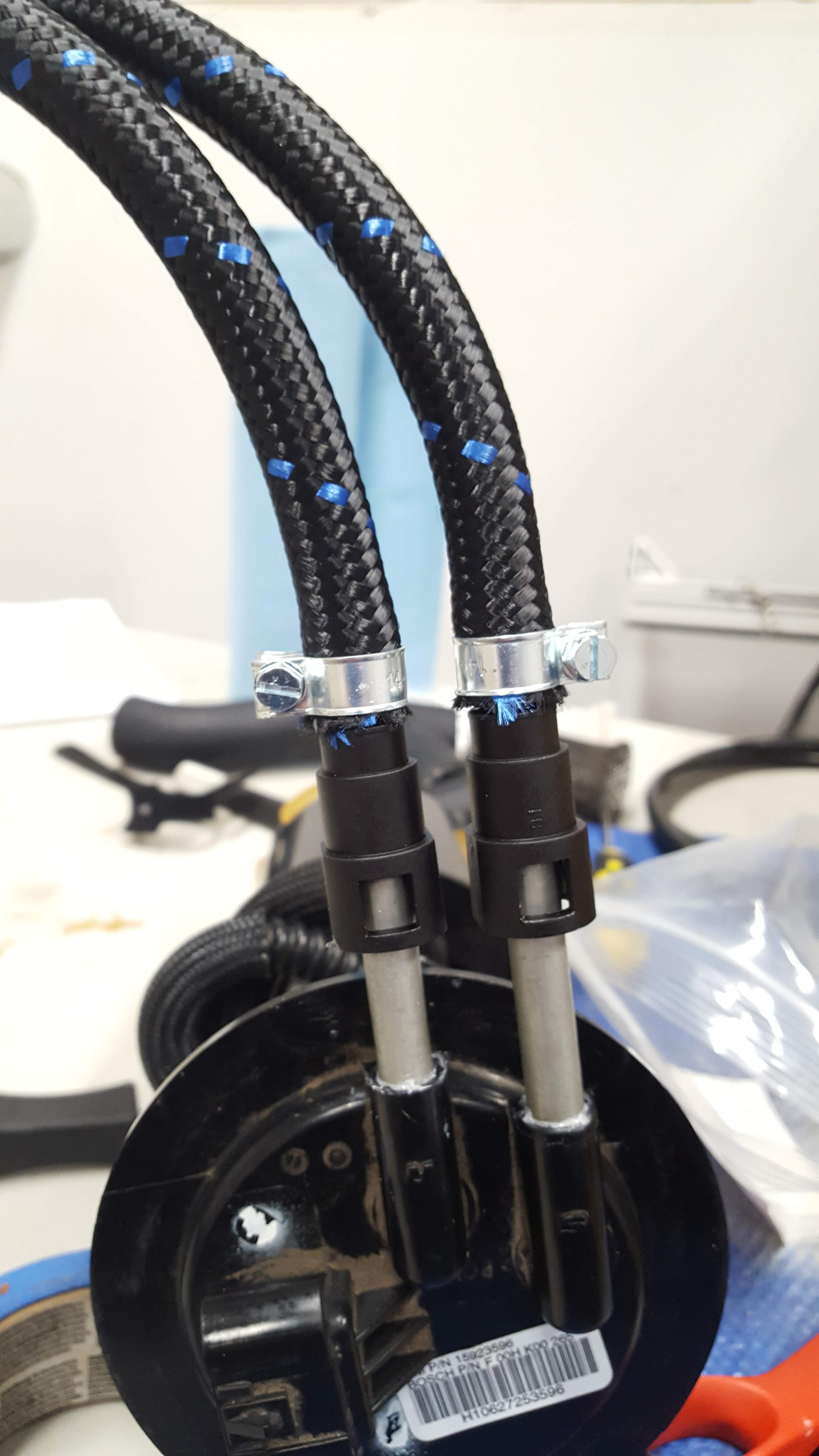

Installed metal line

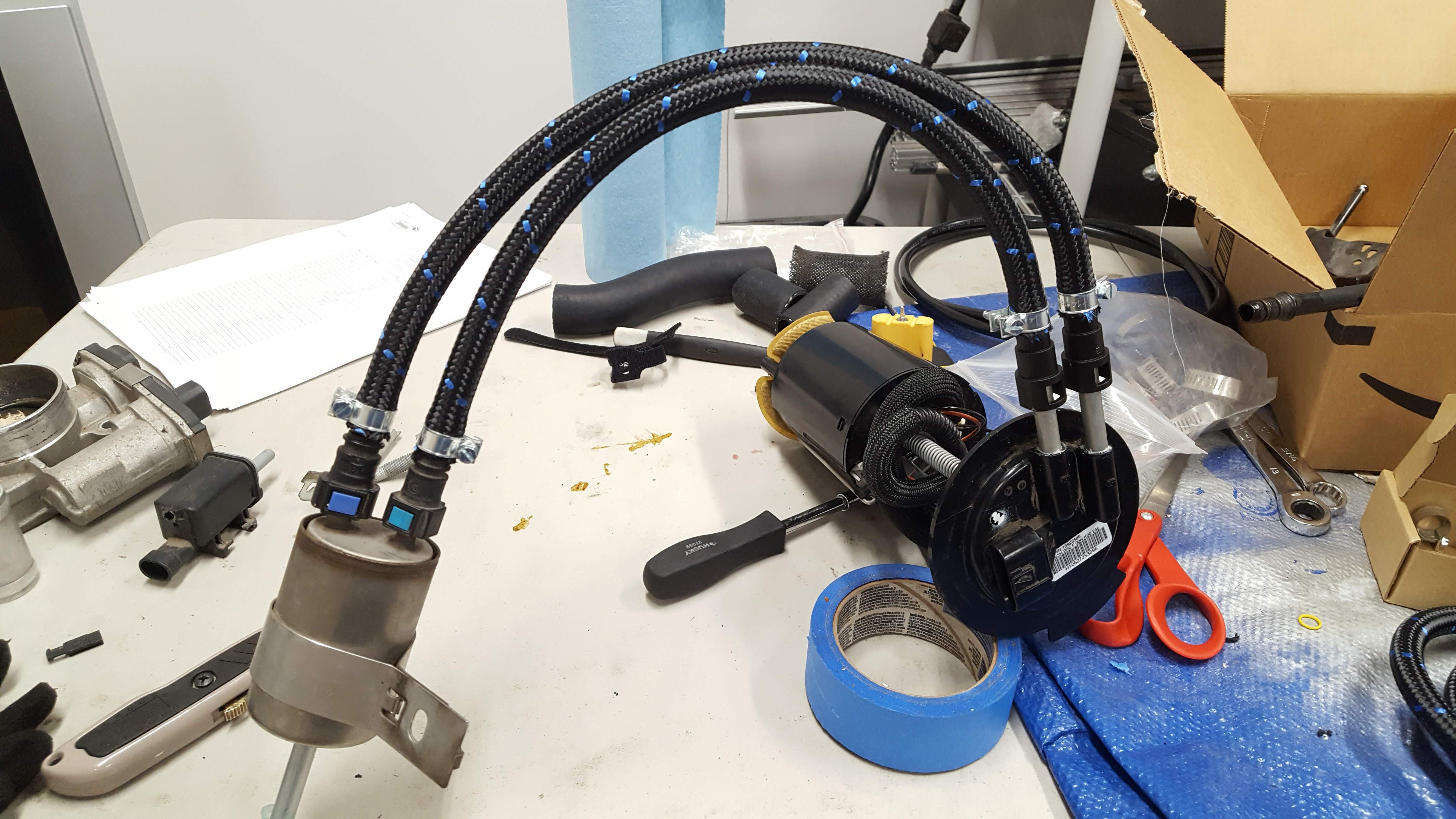

Fuel line assembly
Standard stuff, making hoses. I tried WD-40 and silicone (tire wet). Both worked rather well.
3/8" FI fittings work well. They are different from worm clamps.
Measure your lines before cutting. You may not want them the same length.
Routing & placement
The zip-ties aren't permanent ...or are they?
