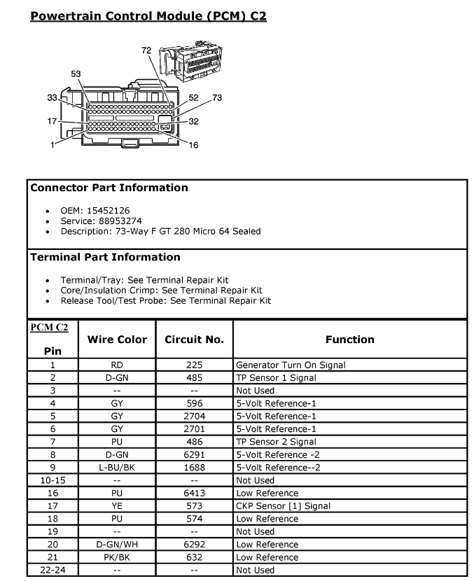

Storing for later, need to check PCM C2#17 and #18

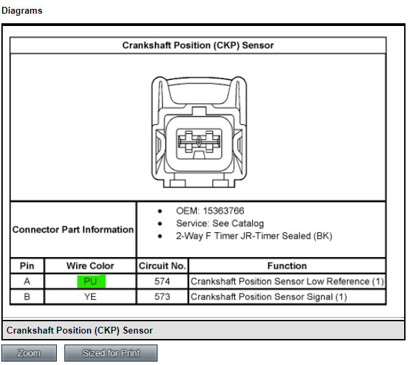

So yours is different from mine. Mine is a 3 wire Hall effect sensor. Yours is a 2 wire inductive sensor.
You really need to dig out the actual wiring diagram, but it probably just runs from the sensor to the ECM.
You should be able to check the function of the sensor itself with a voltmeter to check for voltage when the engine is turning over.
Yes, PU is purple.

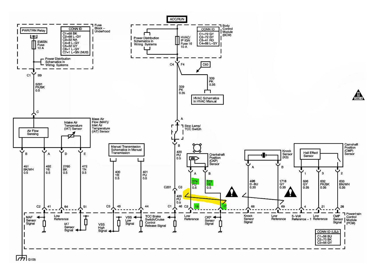

I did pull the wiring diagram. The route goes directly from the sensor to the C2 connector on the PCM. In the diagram, what does the yellow highlighted 'z' line mean? And the black triangle with exclamation point symbol next to the CPK view, what does that mean?

I think the "Z" indicates a shielded wire, either as a twisted pair or actual foil barrier around the wires.

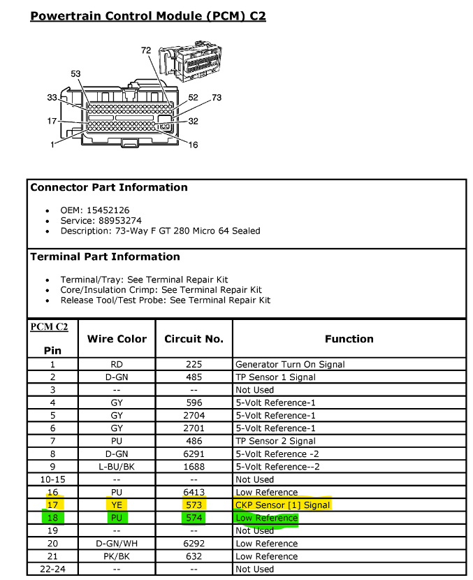

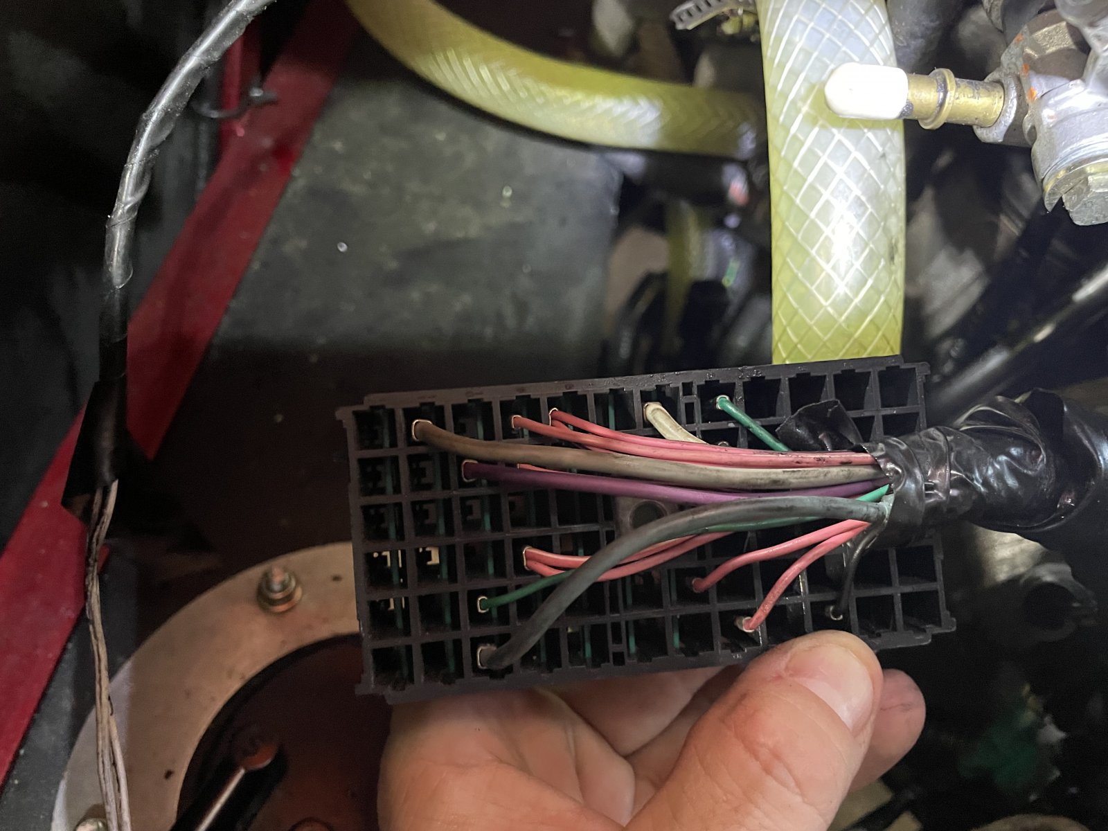

Ok, got a little further along in the process but nothing points to anything suspect. I have continuity across the the wires from PCM C1 to the two end of the harness at the CPK sensor. #17 Purple and #18 Yellow test ok to their corresponding points at the end of the harness. Also, go the CPK out of the vehicle. On the 20k Ohms I get 0.92. Also, when checking the voltage when placing a metal (plyers ends) near the sensor head it gives a bit of voltage. When I pull the metal away, the reading drops to 0 volts. Next up is to put it all back together and see if I get voltage when the engine turns over to work the magnet in the CPK.
One miscellaneous thing, on the Fuse Block - Underhood C1 at position F3 (Circuit 150), this ground does not give continuity when attached to a know good ground point. The other 2 in this C1 do.... Not sure if this is related
Need to find that ground in the wiring diagrams and see what it goes with. There are several grounds not needed. Or you can just ground it since I’m unaware of anything it will hurt, assuming you never removed and reinstalled any of the individual wires. Everything I’ve seen on any of the fuse box connectors that is black is a ground.
I’ve been concentrating on your p0315 code and just troubleshooting shooting it. I’m not sure that that code is the problem for you no start problem. I think it should still start and run with that code active.
I did find an injector wire that pulled out of those stupid solder connectors. I pulled them all off and soldered them the correct way then with heat shrink tubes and electrical tape. It’s possible this was the culprit or just pulled out from messing around in the area.
Future builders, just solder the right way. While the heat shrink solder tubes are quicker, they are a pain in the end.
And….. Drago fires now! I believe the culprit to be the fuel injector harness connector (previously mentioned) to be the source. P0315 is still in the fault codes but the car starts. Loogle searches say that driving the car for a bit will potentially erase the code once the car learns the sensor again. Either that or I have to do some magic in a Tech2.
We should have checked to see if it was firing at the beginning. If it was firing it was getting a crank signal. Lesson for next time.
I can bring my scanner over for the relearn or you can bring the car to me me if you need to force the relearn, if you don’t have the tech2 already. And HPT can possibly do it.
I've heard HPT will do it but I may just have to work out a tie to swing by and see what your device can do. I'm just happy it's running right now as I was a little worried that GoblinFest was getting scrapped. I drove it to work today and the code is still there. I'm going to give it a few cycles to see if it learns the CPK again.
So strange it gave me a P0315 and not a Fuel Injector code.
