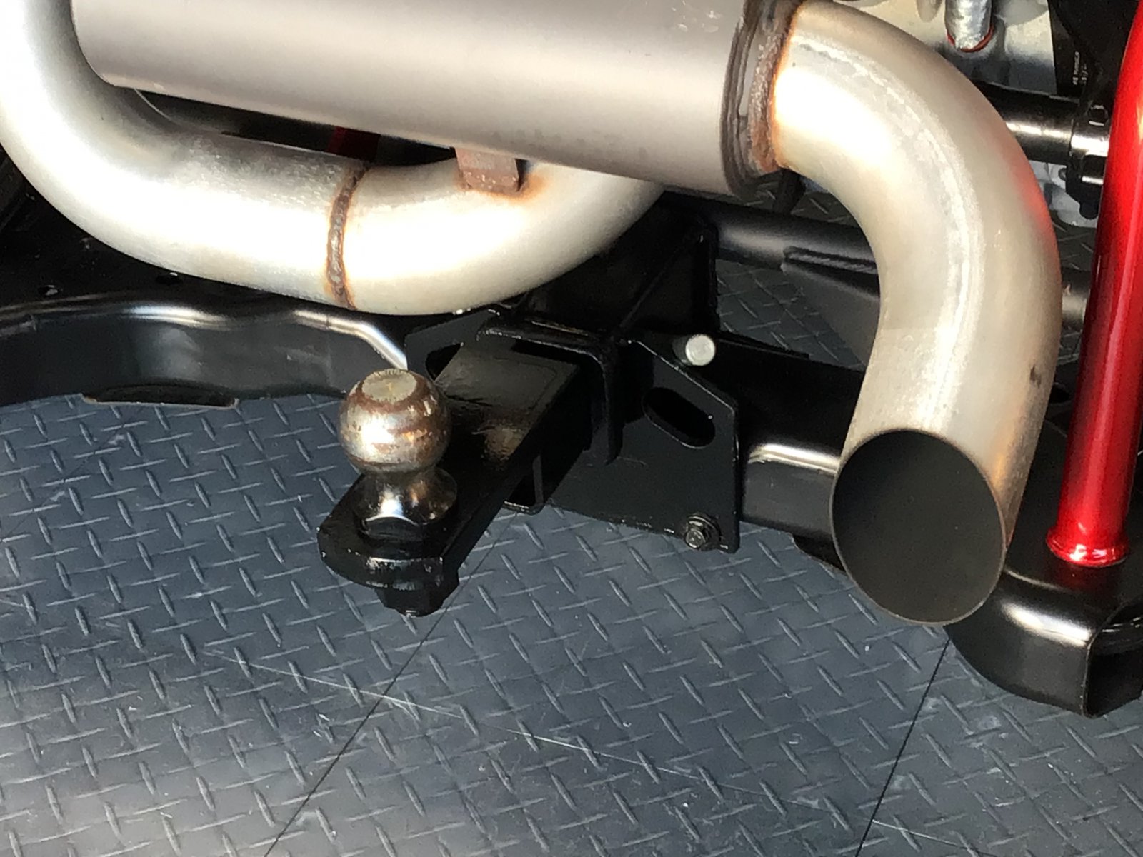

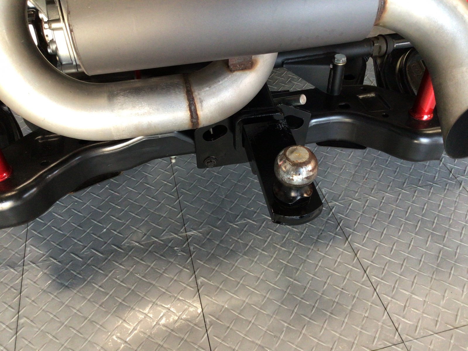

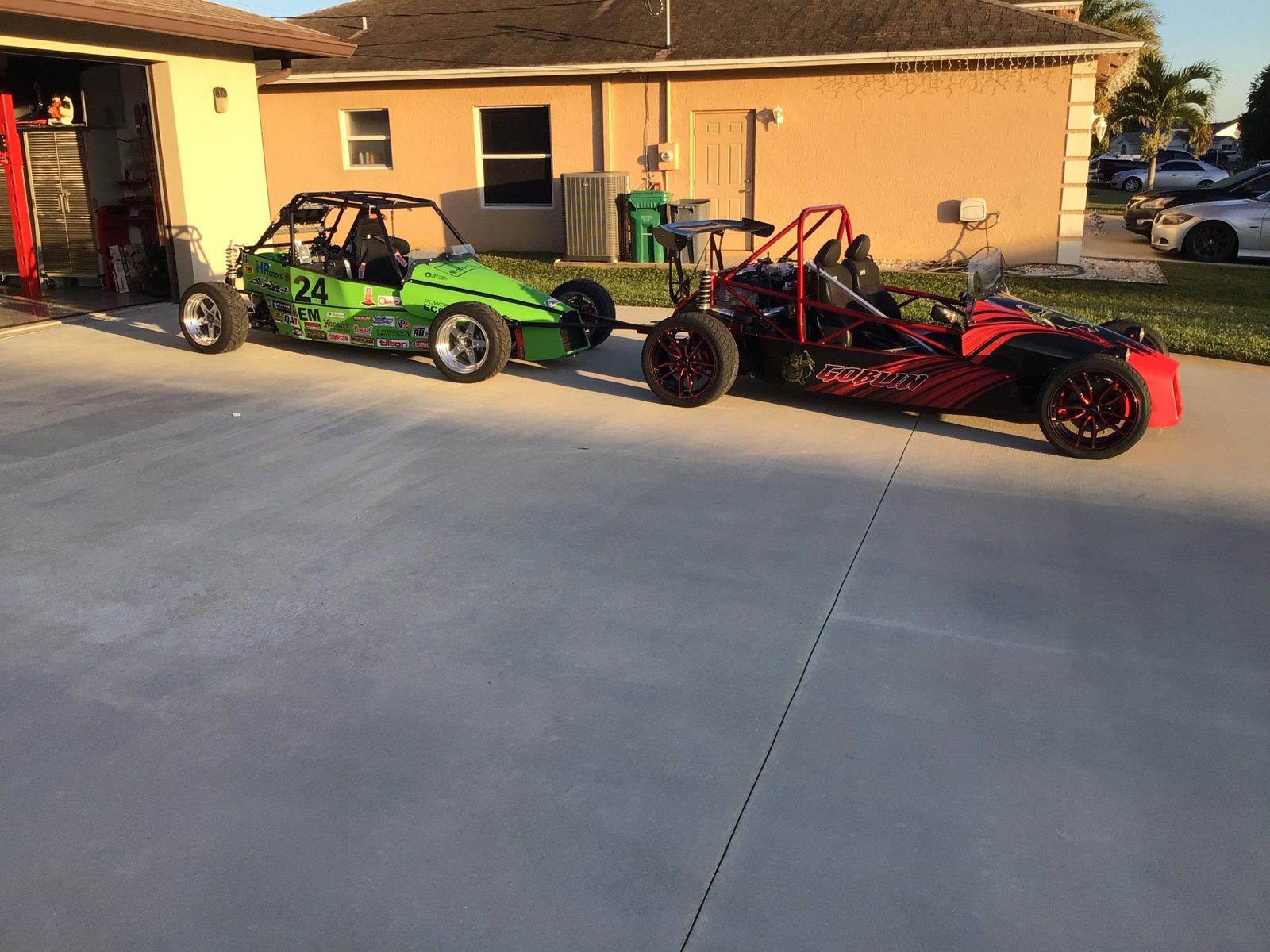

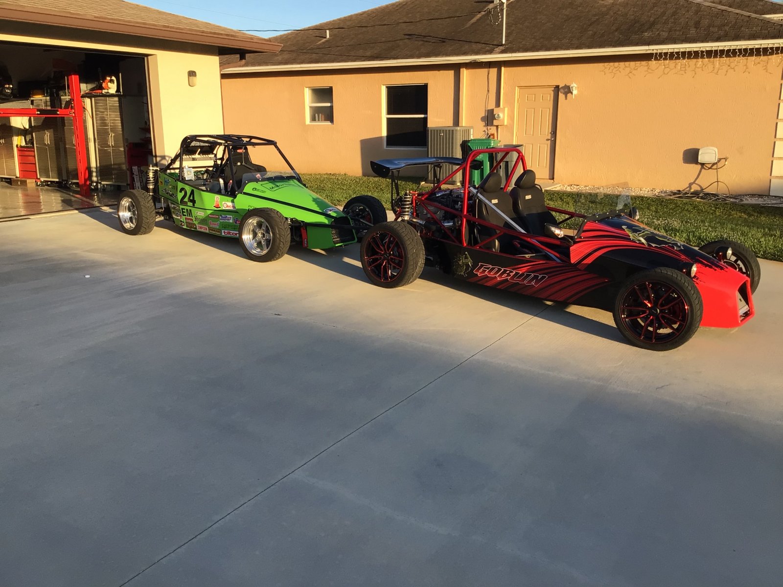

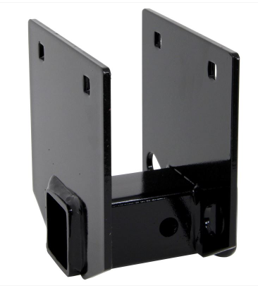

Well I didn’t have time to weld one on so I took the one of my fifth wheel bumper that I use to haul my kayak and chopped it up to fit , Then I had to take the tow adapters off of the red goblin and put on the green one. I was in a hurry because I wanted to tow the cars to cars and coffee this morning and I just found out about 3 days ago. So when I took the tow hooks off the red to green one I put them on the shock mounts instead of the A arm so I had to redo it all. Now I need to get another set of tow hook up and bolts to put back on the red goblin. I have a 15 before I need to leave for cars and coffee.
Would you be willing to provide more details on this? I would love to be able to hook up a light trailer to my Goblin and this looks like it might be a great option.

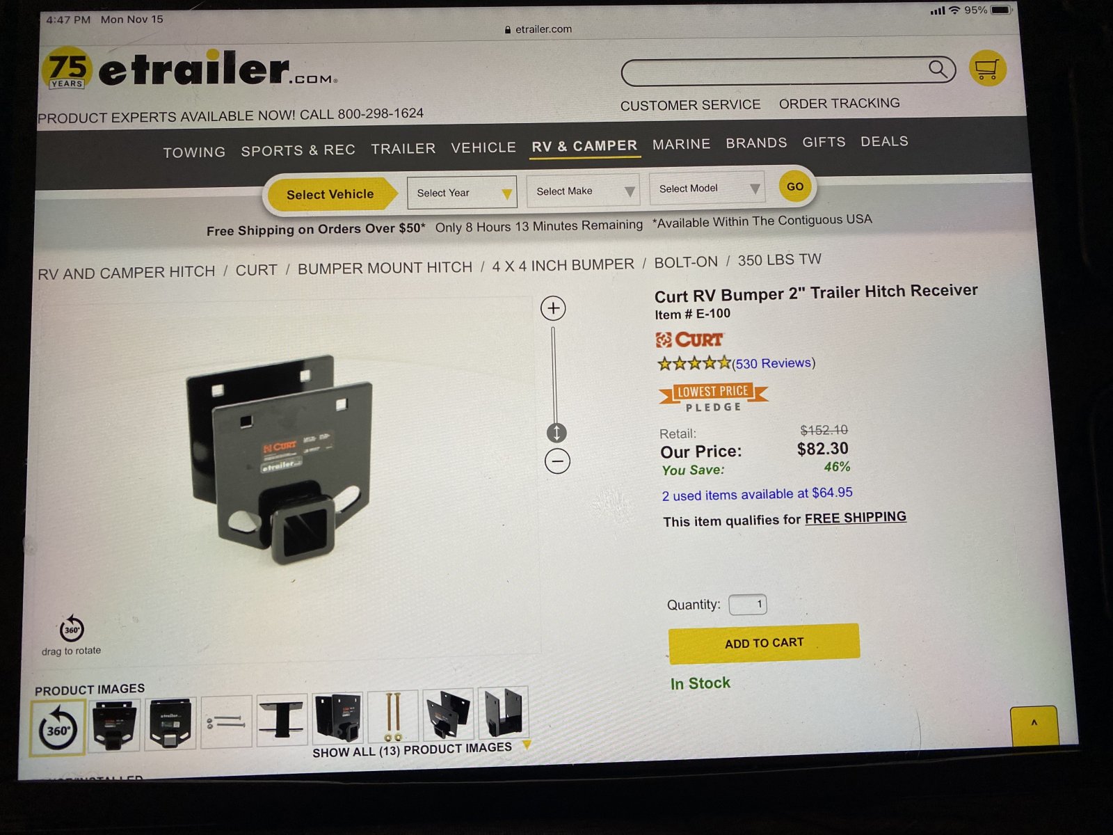

I got the hitch from E-trailer for my fifth wheel bumper 4X4 SIZE and needed it for my goblin so off it come and I cut about 2 “ off and had to grind the back off the Reece hitch down quite a bit so it wouldn’t hit the tie rod stabilizer bar that it backs up to .
Then just drilled a couple new holes and tighten it down . Make sure to get the 4X4 one not the 4X2 one it’s not wide enough !
In the picture you just mount it the opposite the hitch up top or it will be to low like they have it .
I can see the part of the rear bracket was cut off, but did you have to remove material from the receiver tube as well on the rear?
