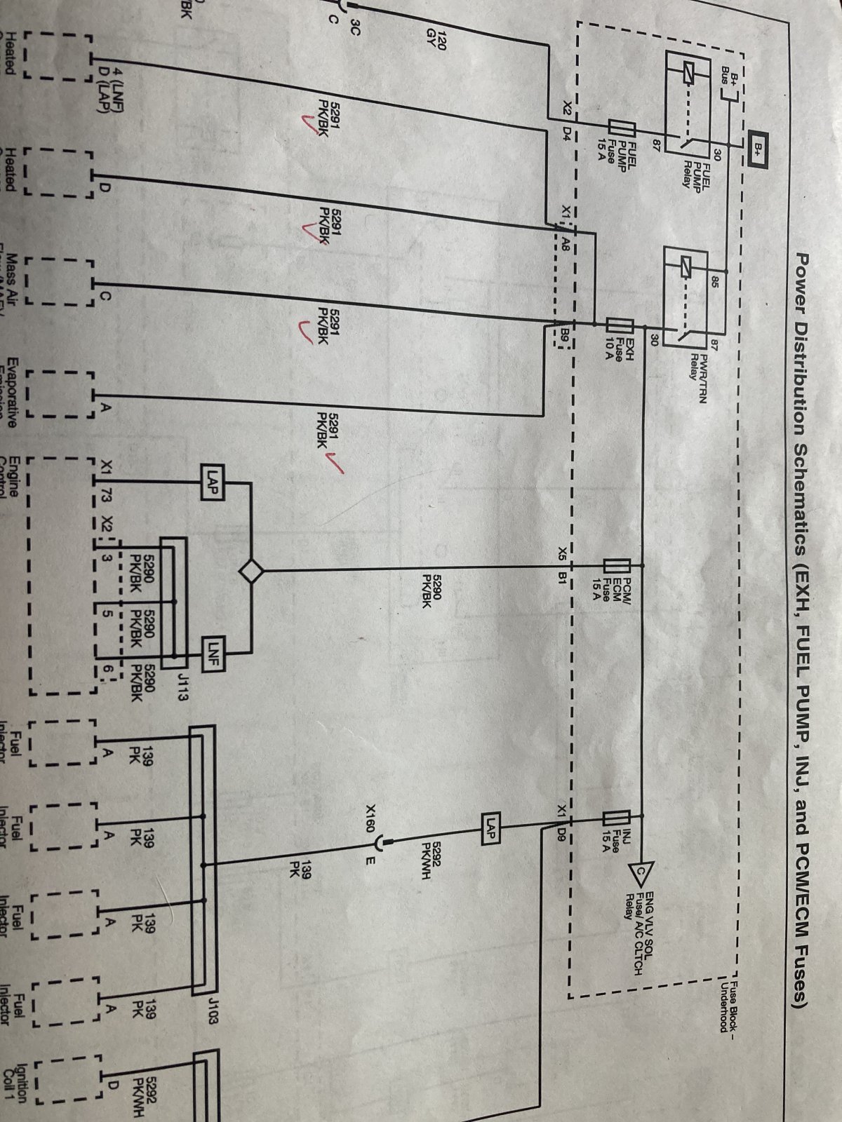

Wiring diagram is pretty simple for that circuit.

Start with unplugging the X2 connector from the ECM and see if it still shoots the fuse. And no more putting in a 30amp fuse to see what happens. You could smoke the entire wiring harness. If anything put in a smaller fuse to test with. And it looks like it should be 15Amp fuse to start with if this is actually the PCM/ECM fuse.

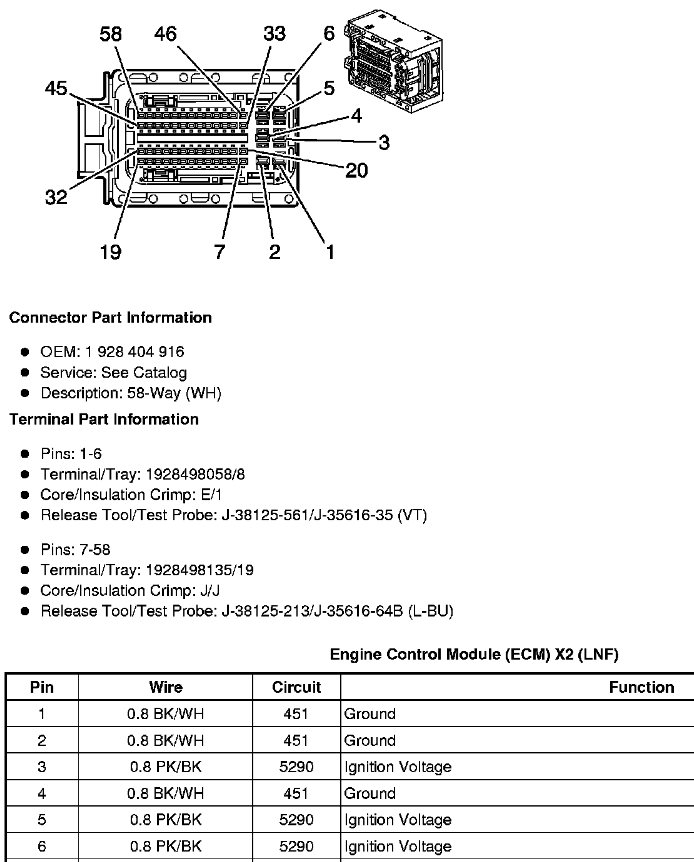

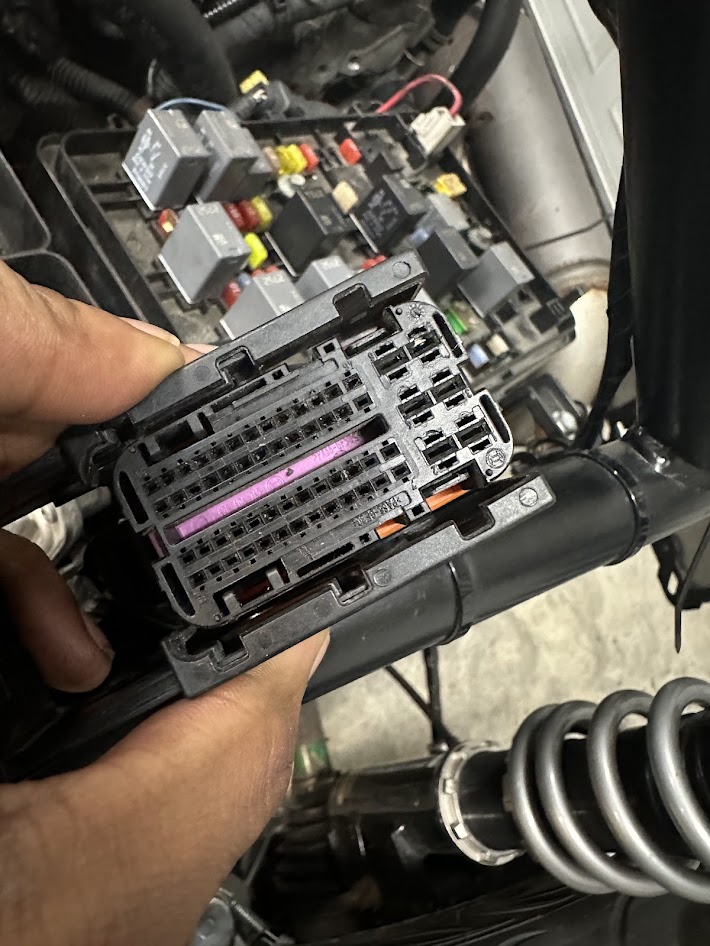

Disconnected the x2 connectors from the PCM and the 20A stays in tact when attempting to start. Noticed one of the pins (top right) looks off but that's the only oddity I can see when investigating. No other pins on the PCM appear to be bent.
47687
Below, 1, 2, and 4 should have continuity to ground, and 3, 5, and 6 should have continuity to the 15a PCM fuse. Can you verify continuity for each, and verify that the grounds don't have continuity to the ignition fuse and vice versa?

I have a spare PCM/ECU that I picked up a few days ago but I'm afraid to plug it in, fearing there may be something in the line that may have damaged the original. I'll see if I can get it to pop the fuse without the PCM connected but if not, I'm not sure what's needed to swap the spare over. I'll double check the wiring to make sure nothing is damaged
I might even unwrap the harness from the X2 connector to the fuse block for a visual inspection, but I don't remember the actual routing to see how much work this is.
Before replacing the ECM I would try and visually inspect as much of the entire wiring harness that I can for damage. But again, the ECM does a pretty good job of protecting itself from downstream overloads.
