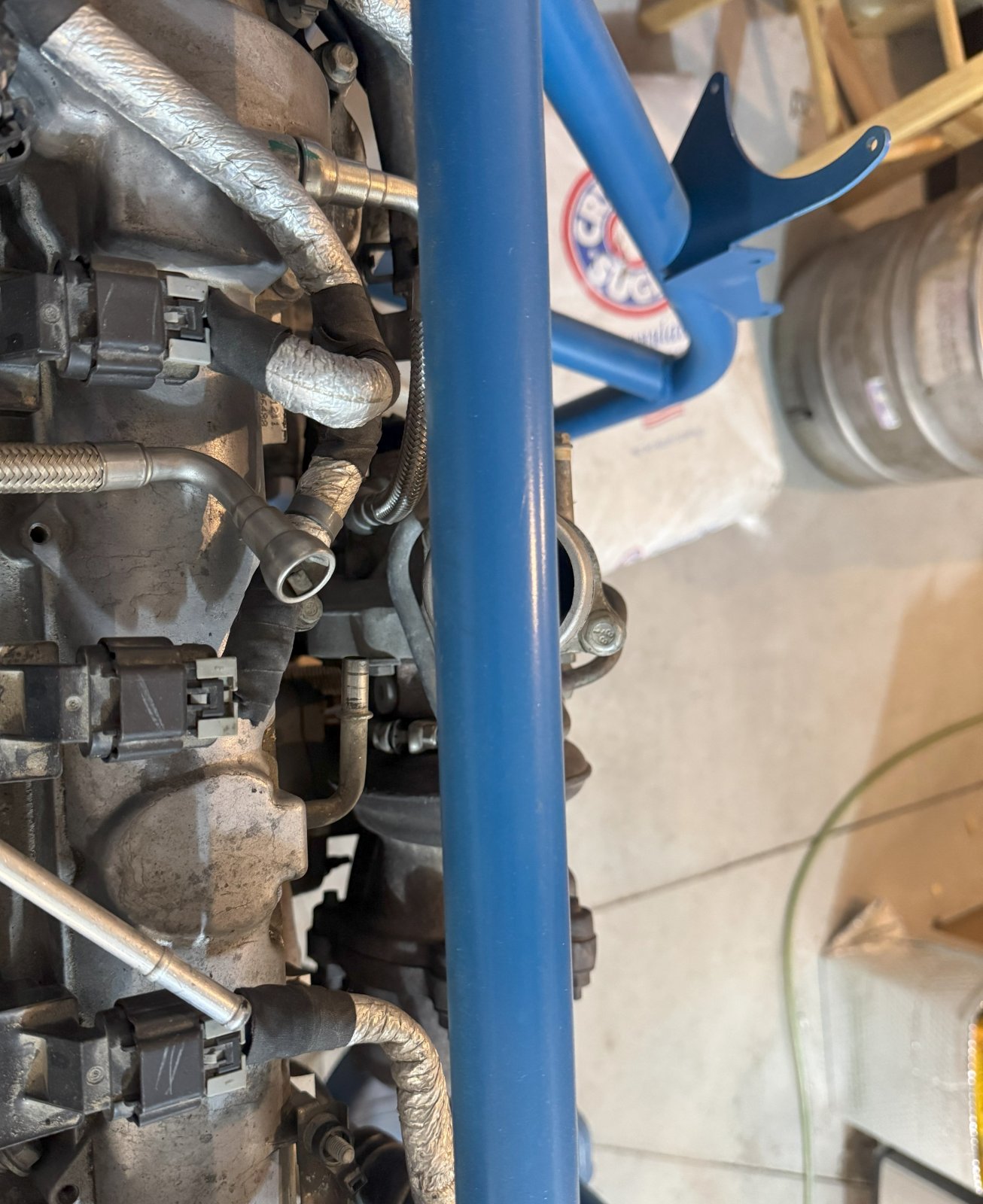

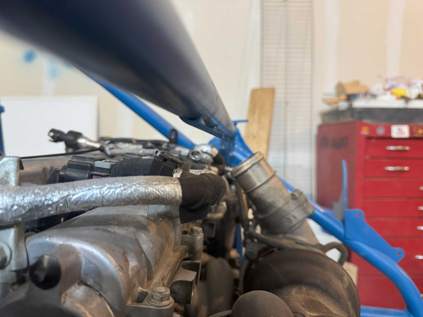

I remember this being discussed before and have searched the forums with no luck.
What do I do here?
comegetjoe

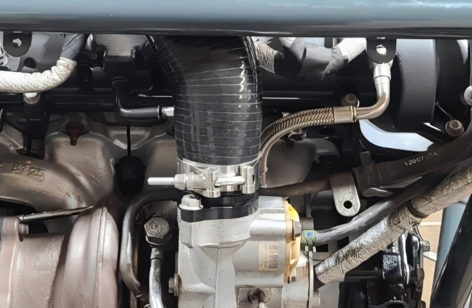

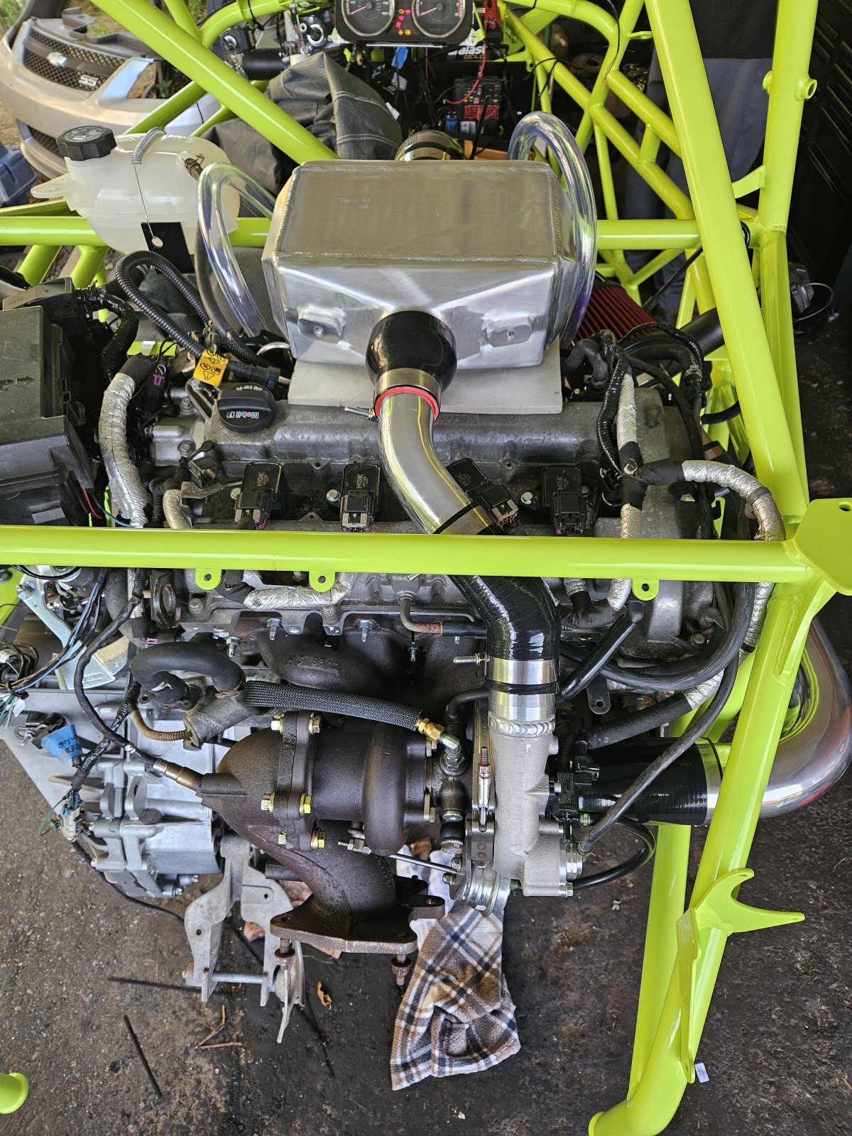

I think there is a shorter outlet tip sent with the kit and then modify the 45* bend pipe and bit, add some couplers.adter you've mounted your factory intercooler to get your location and itll look something like this.
Mahkoi
Its been a couple of years, but the shorter piece that came with the kit was packaged weird so I overlooked it a dozen times. I can't remember if it was in a bag or stuffed in with some other part.
pisco
Ok that's what I vaguely remembered was a replacement outlet, I looked everywhere!
Maybe I will dig through all the boxes again...
I really want to get 1st start done!

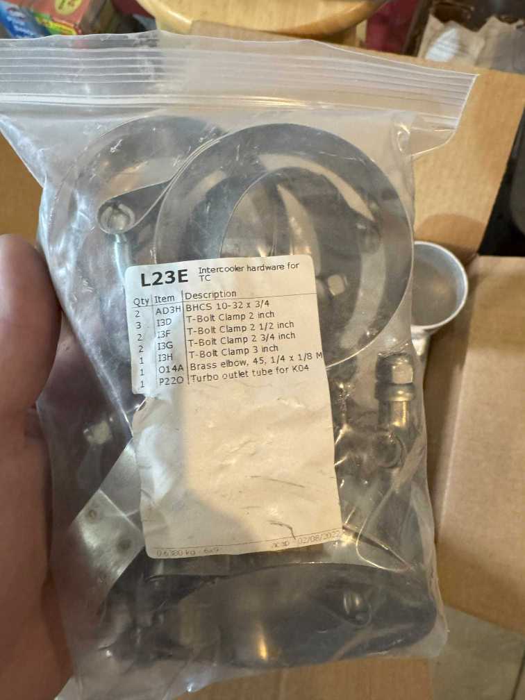

pisco

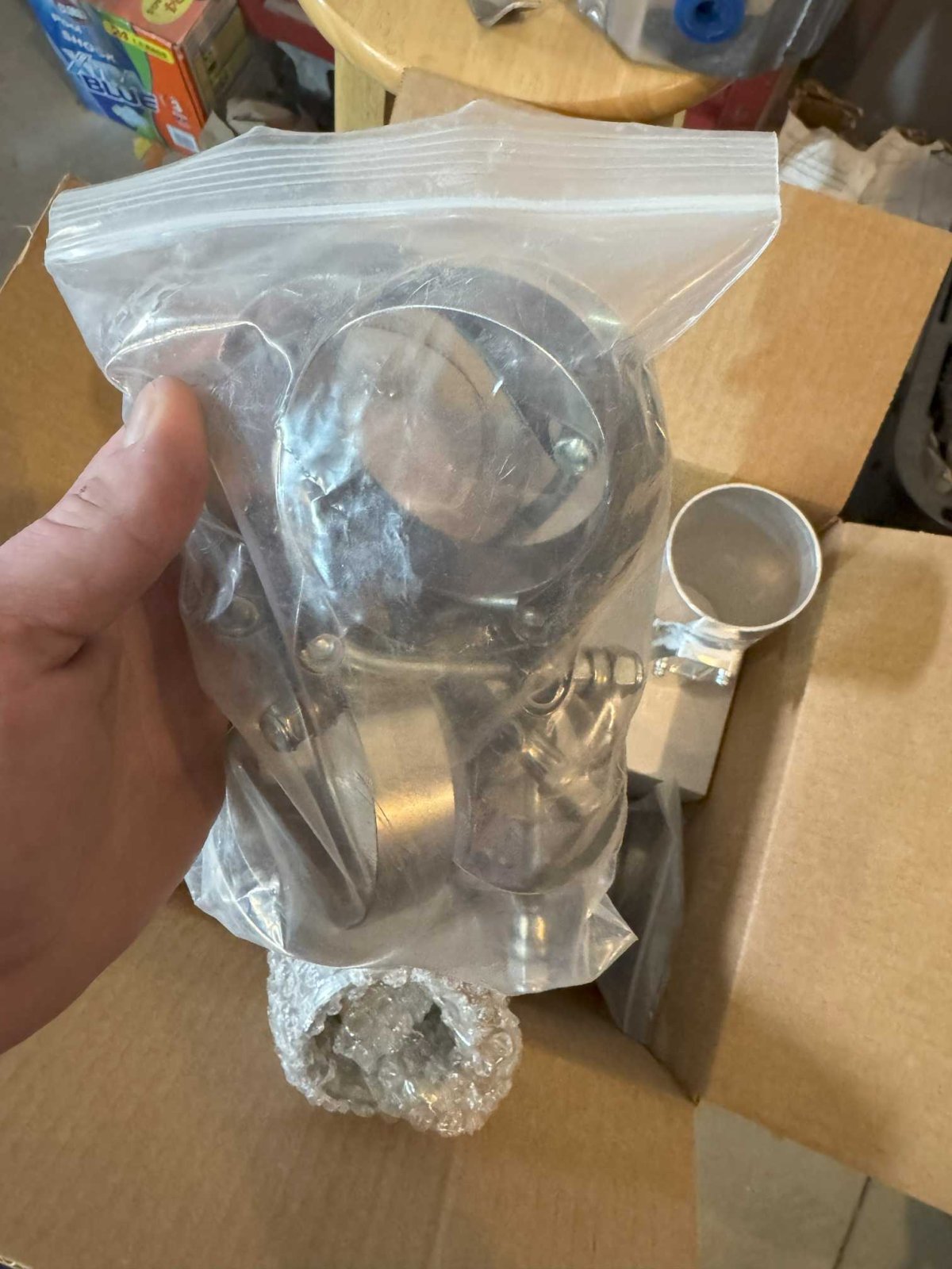

Is it supposed to be in this bag?
I'll contact DF next week, hopefully they know where to look and as stated above I'm simply overlooking it. I also wanted to ask Adam about some hardware specs, If he has time to answer I know he has been very busy.
comegetjoe
Looks like it at the bottom of the label.

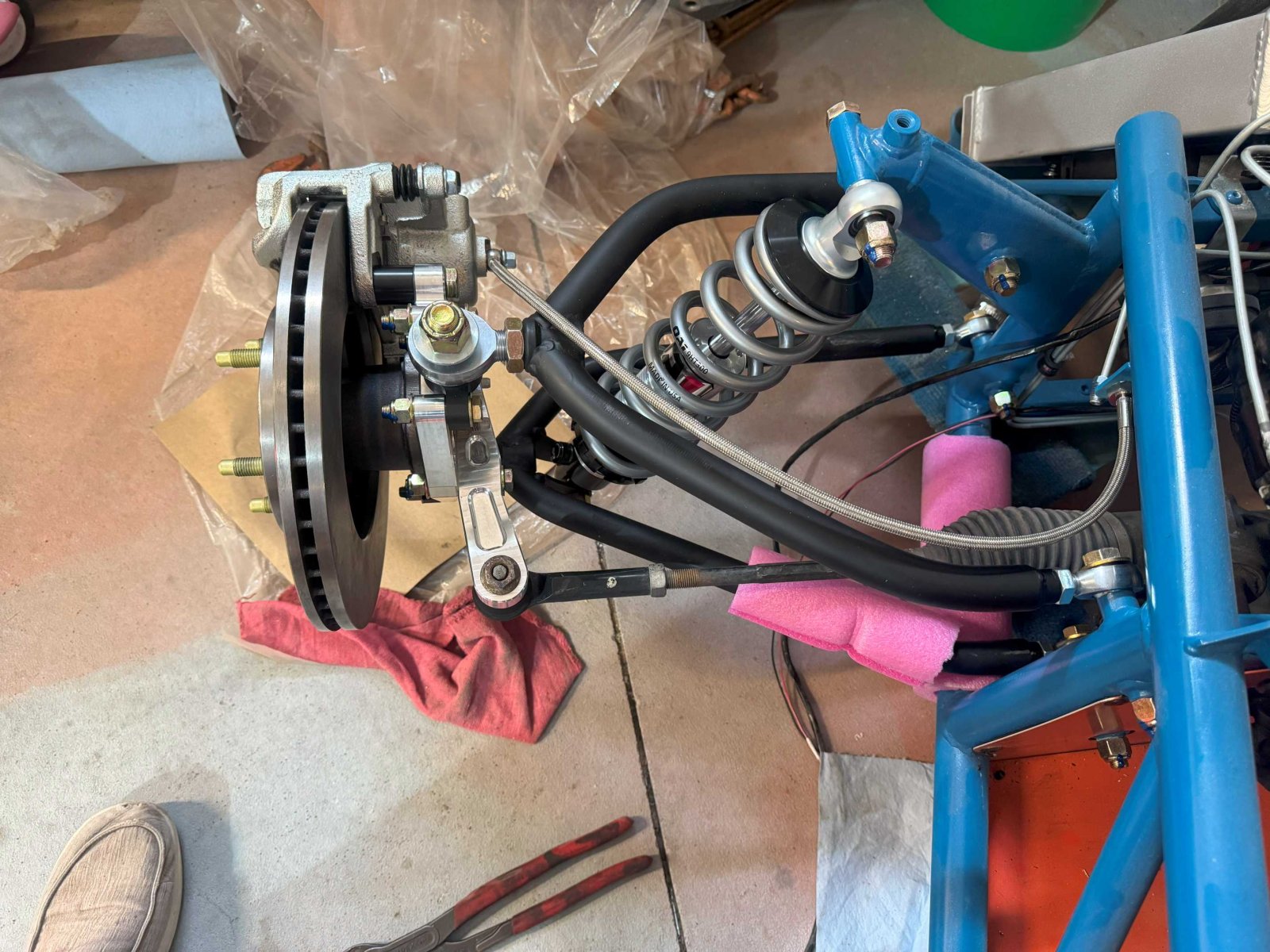

A little more progress on the front suspension, engine wiring and figuring out hose and wire routing in the engine compartment and up front including brake res relocation.
I will be securing wires and hoses soon then mounting the he and duct kit. As I look through other build logs at pics I noticed the toe link bar that I am missing..... I think soon I will be held up waiting on parts again.

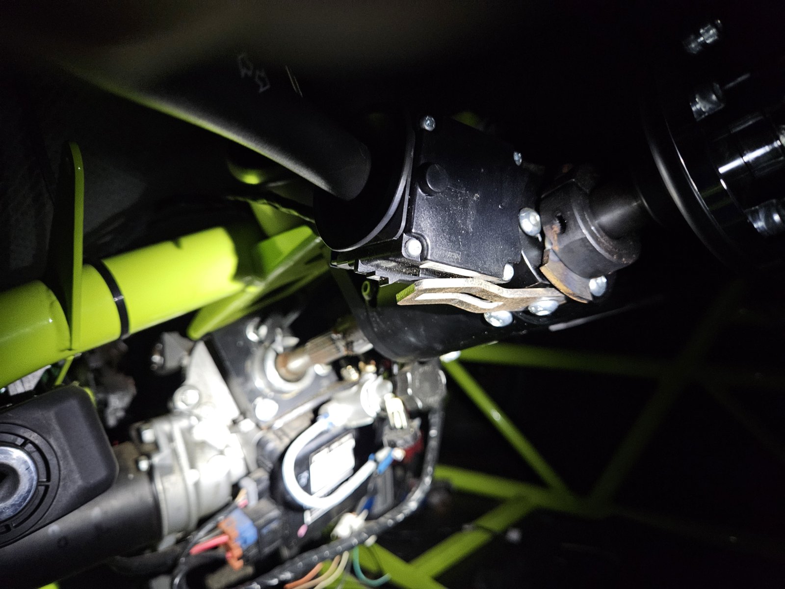

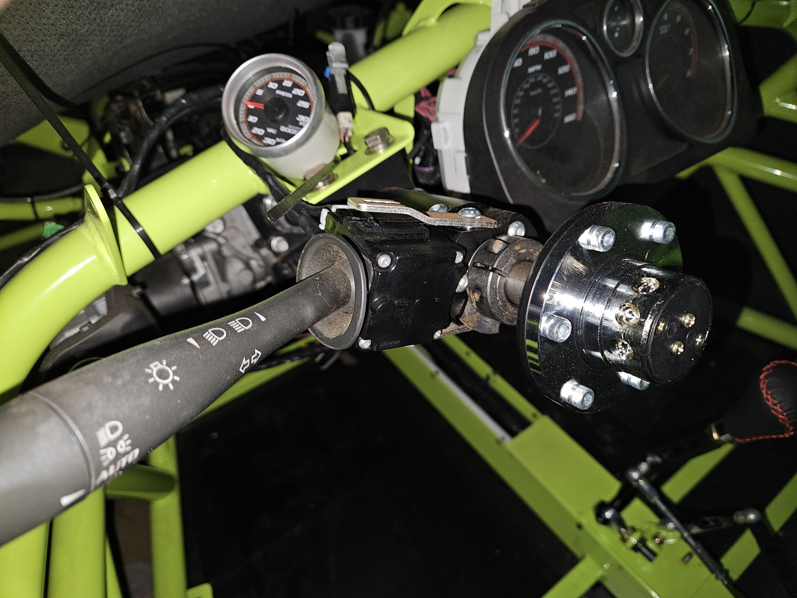

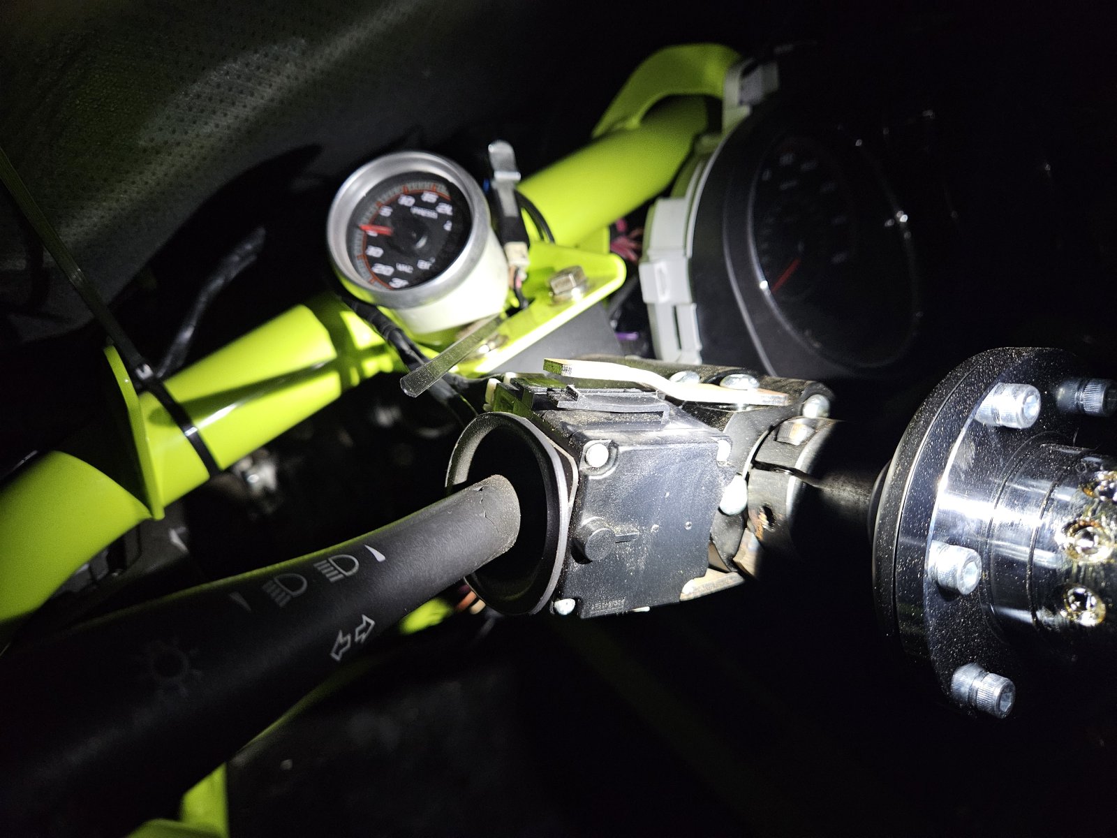

I'm also a bit confused about the turn signal switch. There seems to be several mounting methods and I don't think I have any hardware for that.
Does anyone know the current mount design so I know for sure what I am looking for?
comegetjoe
Took these just for you... in the dark.
Those bent tabs bolt on to the black piece on the steering wheel mount, then the turn signal stalk is sandwiched/clipped inbetween the upper and lower bent tabs. Mine is not fully locked in, but I think you can see the point.
pisco
Thanks, I had just found it (in the steering wheel box) just before reading your post. I hadn't planned on using the DF steering wheel and was surprised to see the box with my kit. I bought an NRG flat wheel and quick release adapter years ago when I started my build
Maybe a second quick release hub for when I don't want to use my "nice" wheel.
