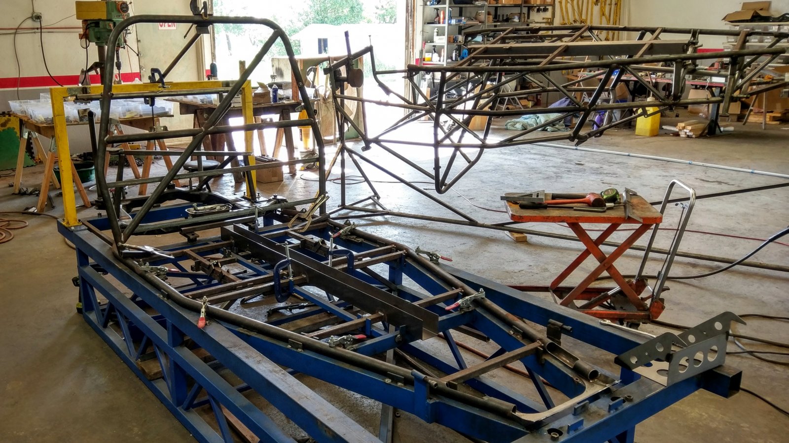

Adam
Chassis #16

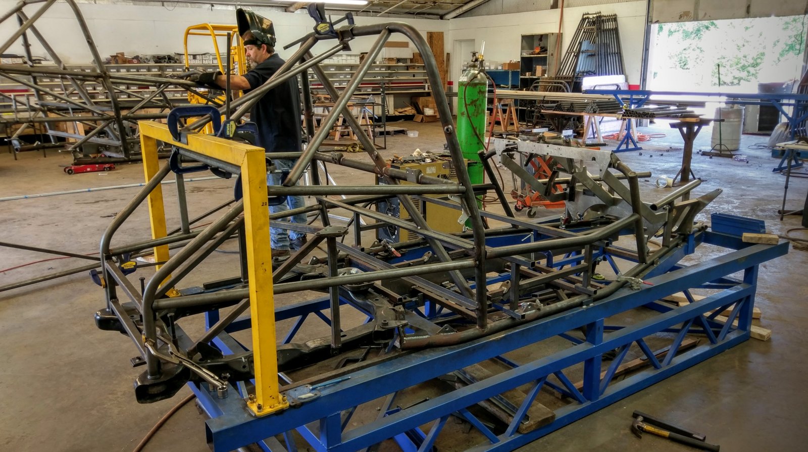

Yesterday we finished the build up of the frame on the frame jig and then put it on the rotisserie so that we could weld the hard to reach areas. The last welds will be finished this morning and we will do the final inspection.
Johvans
Love the list and progress pictures. Any idea of how long it takes you guys to do a frame? If I wanted some additional tabs/brackets welded into the frame is that something that is possible?

Adam
Chassis #16 - City Goblin
The last of the mounts, tabs and other features have been attached and the chassis is fully welded. Now it will be inspected with our Rotisserie Inspection Checklist. After that we will temporarily install the floor, front bulkhead and firewall so that we can drill the holes for the rivets so that the customer doesn't have to do that.

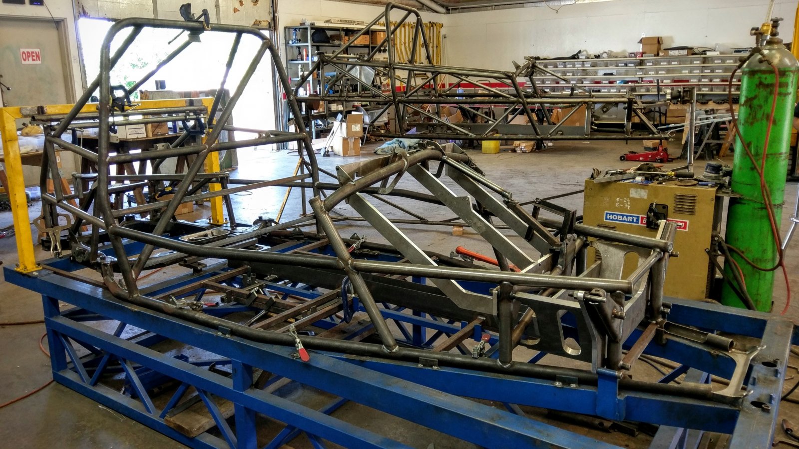

Chassis #17 - Swift06's Extended City Goblin

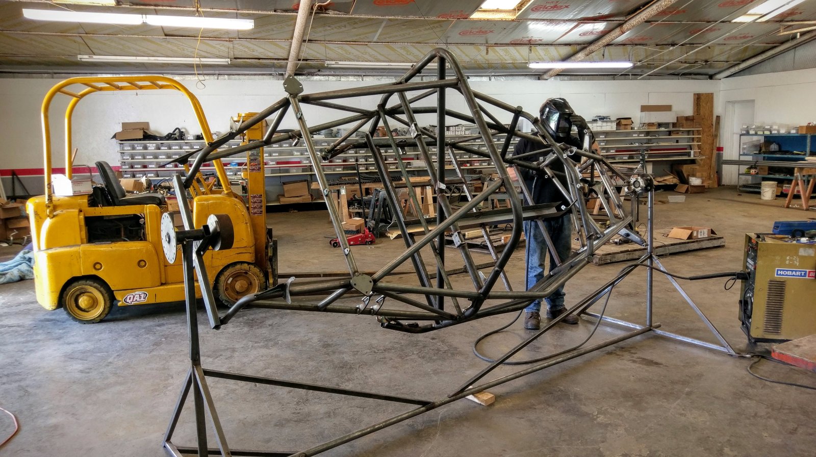

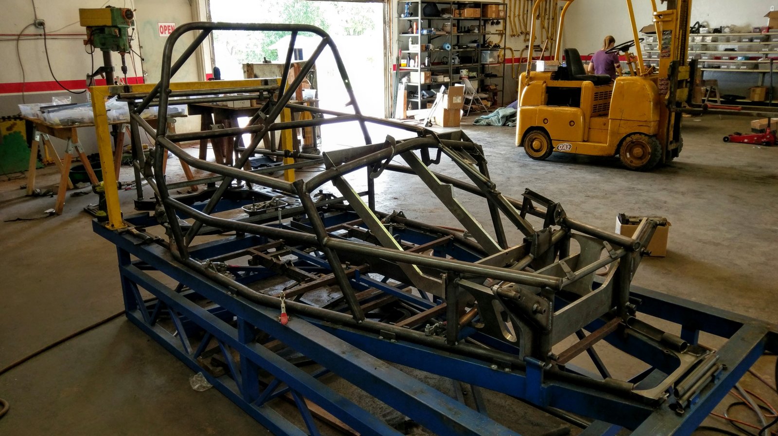

Swift's frame is going together now. At about 10 AM yesterday I changed the jig to the extended frame configuration and started loading pieces starting with the floor assembly, then the main hoop and finally the rear bars of the rear cage. You can see Chassis #16 being welded in the background.
By noon the rear cage had been tacked together and the front section of the frame was starting to be jigged up.
By the end of the day we had finished welding Chassis #16. Chassis #17 was starting to look whole. We still need to weld in the upper door bars (we've never made extended length upper door bars so we will be making programs to cut and bend these pieces) and all of the 1 inch diagonal tubes.
Thanks,
John
When we have all of the tubes cut, bent and ready to go, welding it all together is very fast. Bouncing between Chassis #16 and #17, we were still able to go from tubes to most of a frame in about half a day. There is still quite a bit left on #17 but nothing difficult.
As for custom tabs, it does take extra time and resources to coordinate the location and design of the tabs with the customer so this isn't something we want to offer at this time.

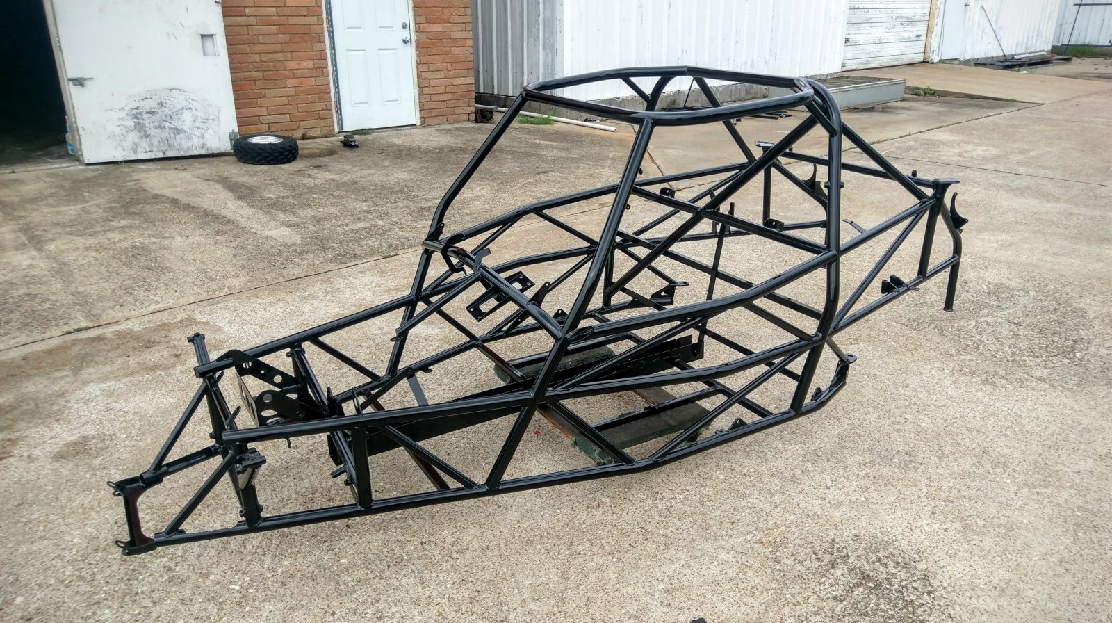

As for your question about powder coating, it is about 1 week turn around time. We recently picked up RichN's frame (goblin green metallic). Next we will be taking PHerder's (Kawasaki green - RAL 6018) and then TheNuker's (gloss black).

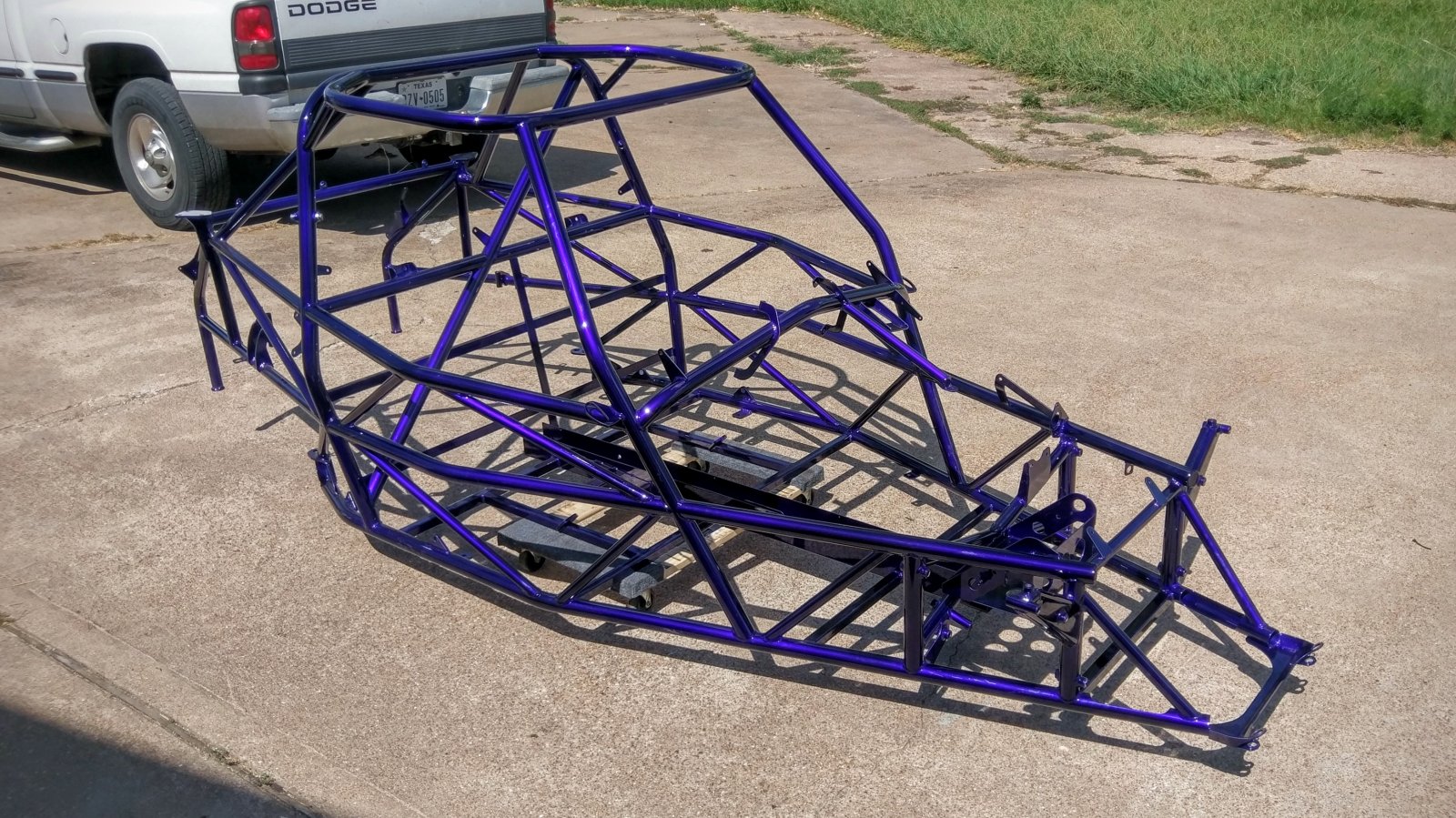

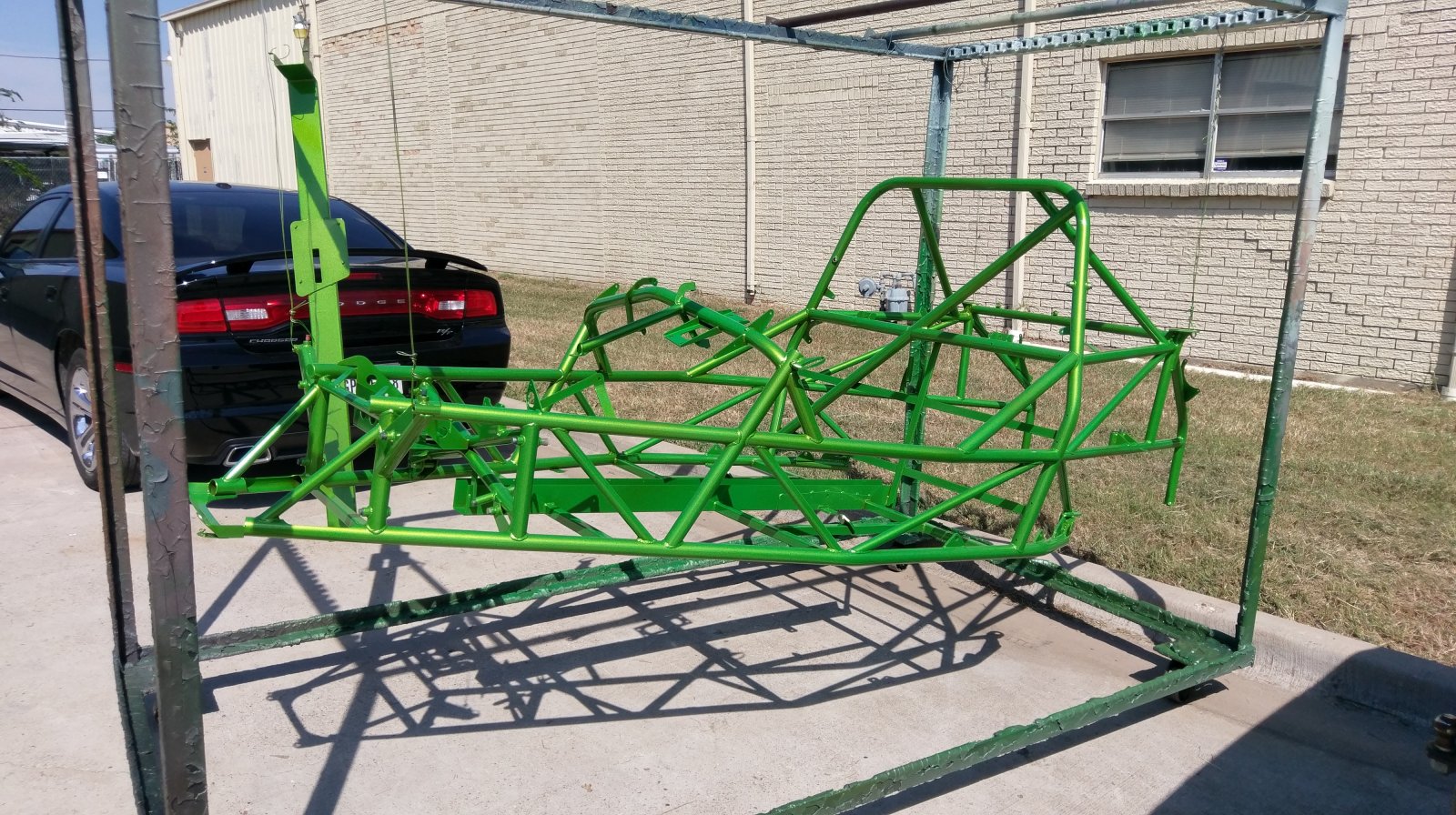

Here are a few we've had coated in this batch.
ErrorUnknown's Illusion Blue Track Frame:
JustinReed7's Gloss Black track frame:
RichN's Goblin Green Metallic City Frame with easy entry door bars:
