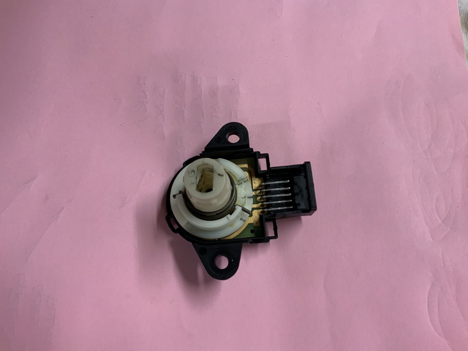

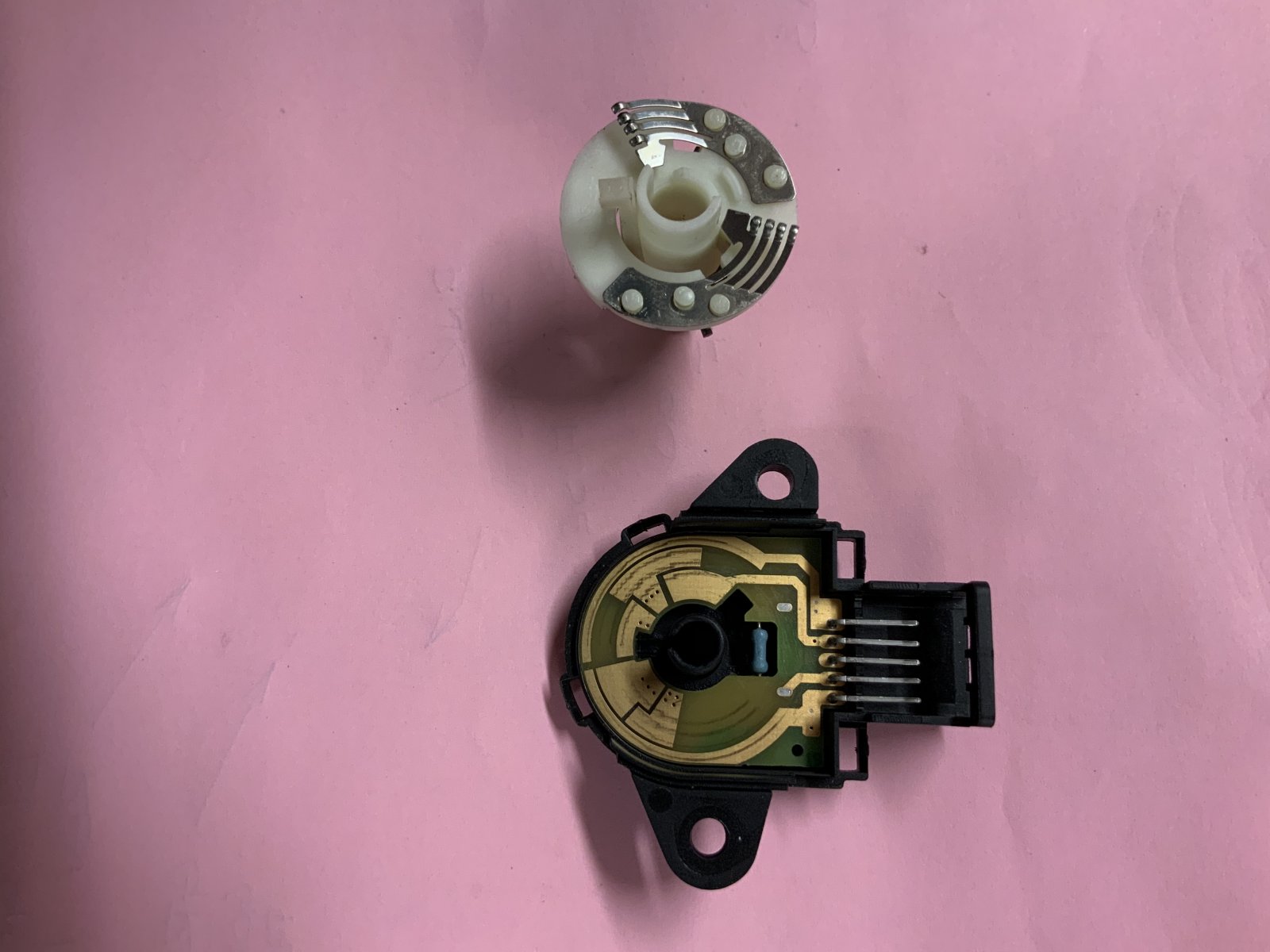

Disassembled the anti theft on the back of the ignition switch. Seeing that you have the power routing could this be setup as a simple switch? (Probably two switches an accessory power and an ON/START power)... It seems as if once you power the start sequence the ECU? Runs the starter. Not like in the older cars were you could grind the starter if you were to engaged the key after it started. Or am I looking at this wrong?
THX,
Bruce
