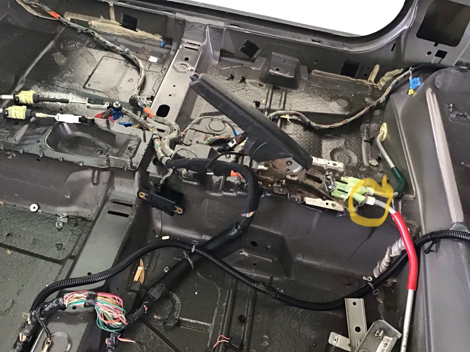

Got the rest of the donor body stripped over the weekend. Just have the dash left.

Don't forget to grab your e-brake cables, e-brake tubes and e-brake handle assembly if you are going with DFG's e-brake solution. I noticed your cables were still there. I didn't know I had to keep the tubes or cables when I stripped my donor, so I had to source them again!

Did you buy the little plastic tips some where, mine fell apart when I took them out
Got them when I stripped the rear. Thanks.
