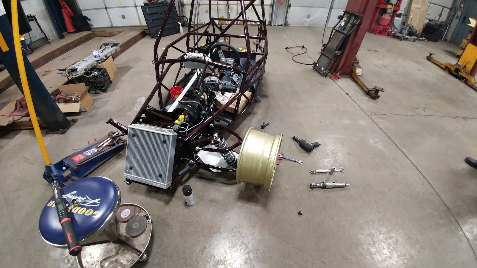

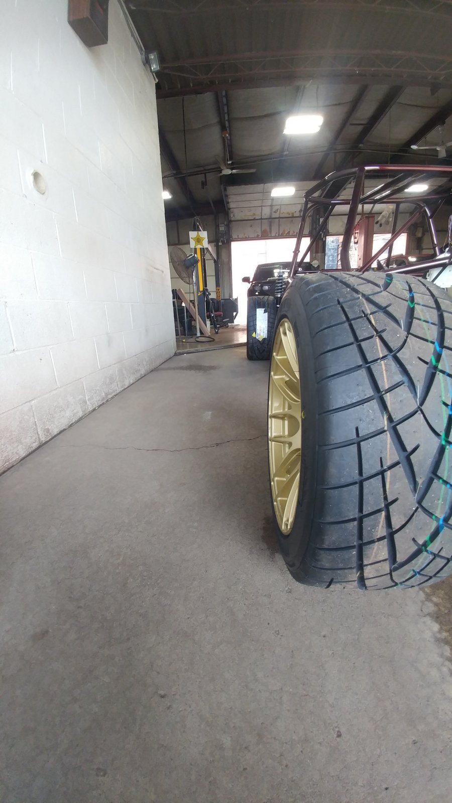

Here is a 16x8.25 xxr 530 with 0 offset. I'll have tires on somtime next week for a better idea.

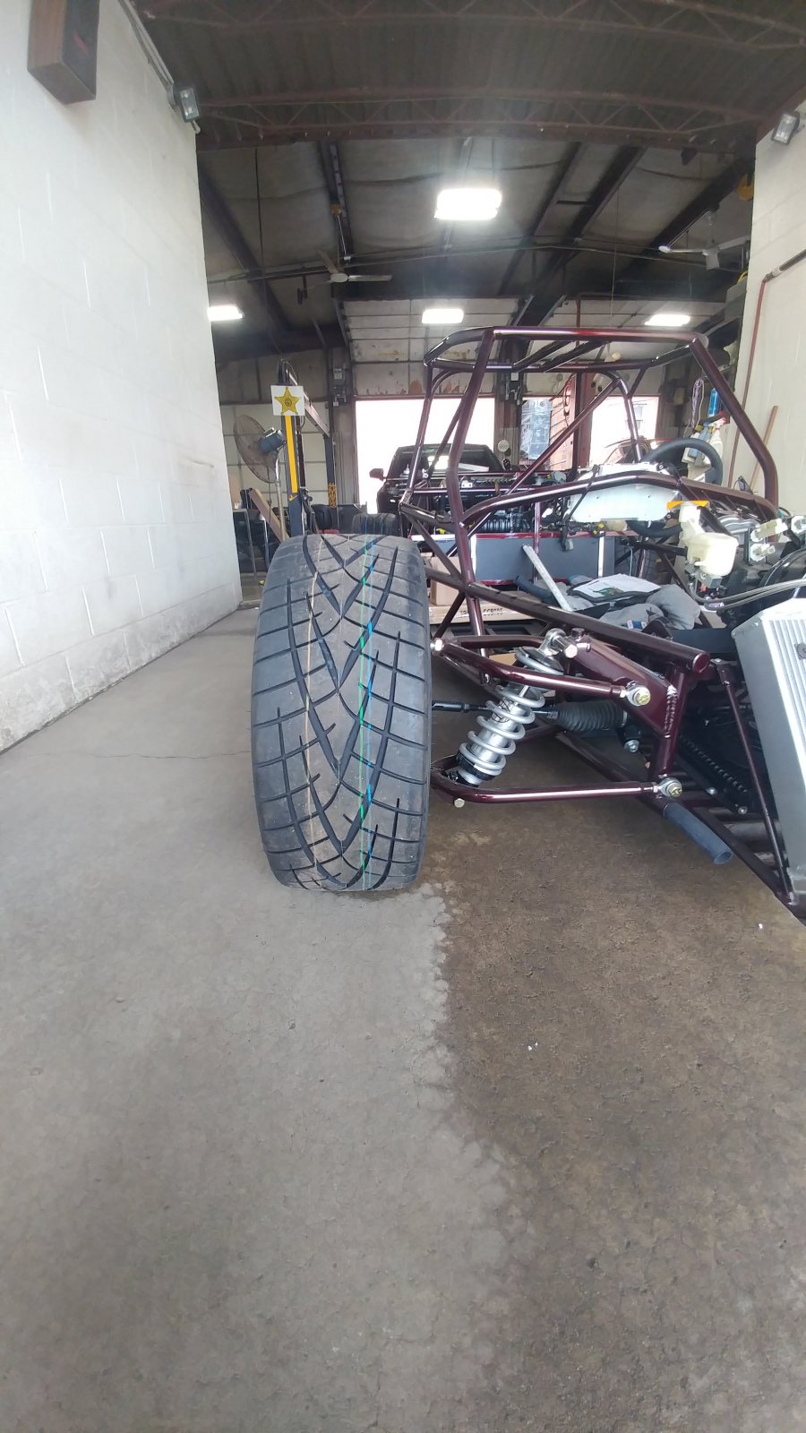

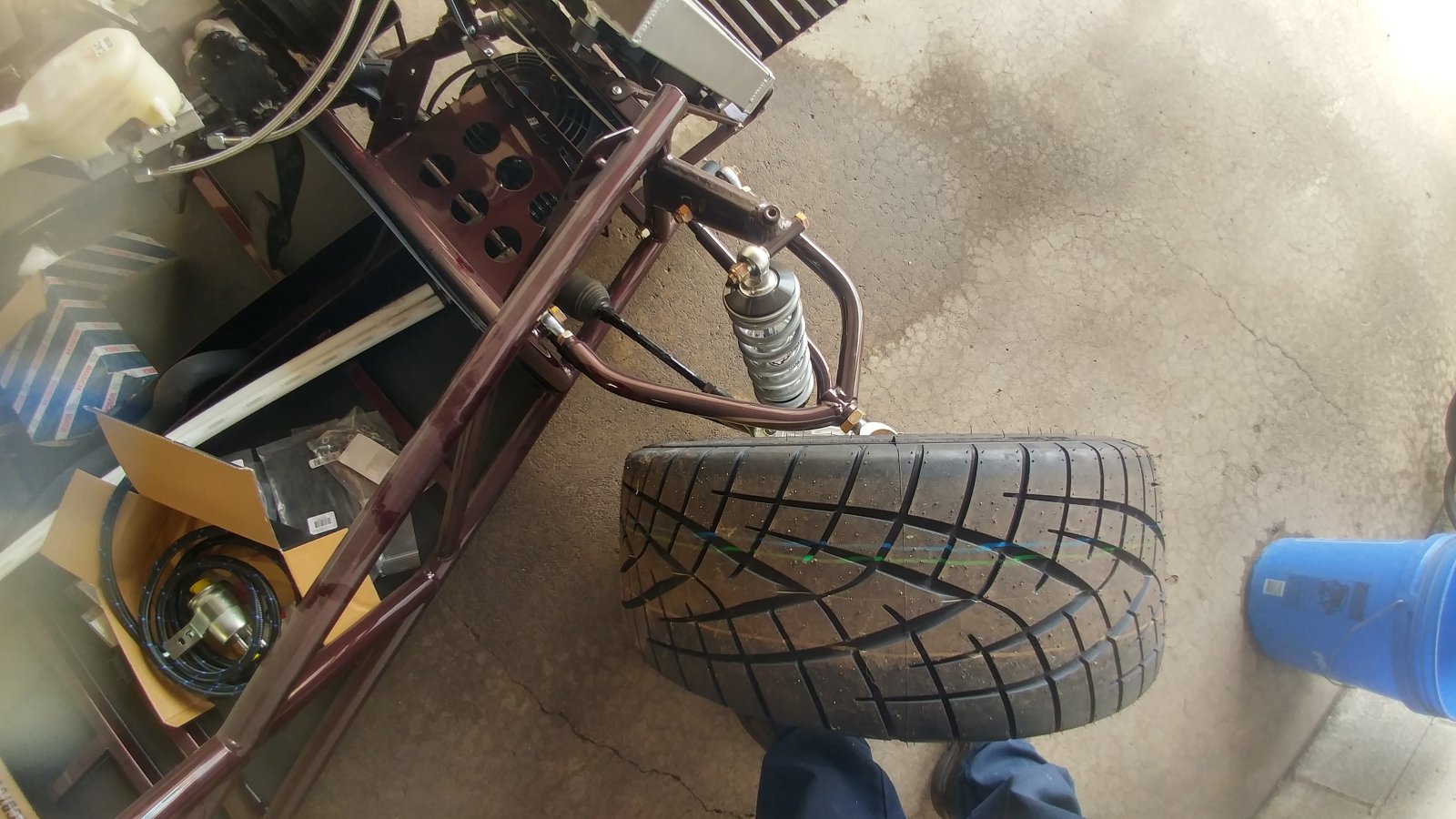

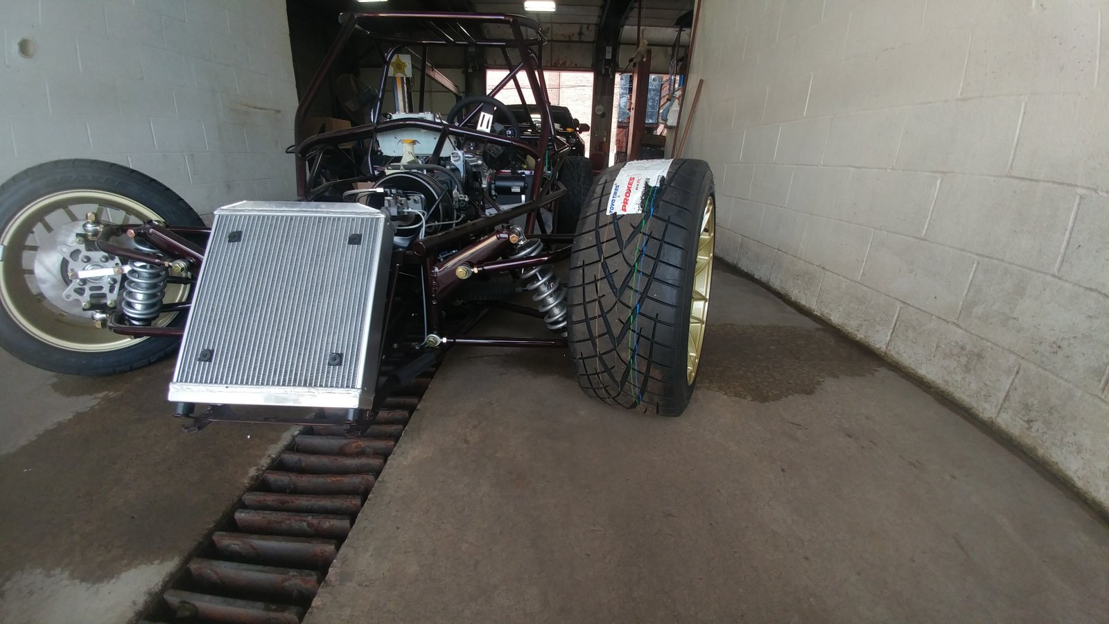

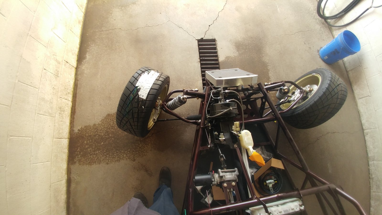

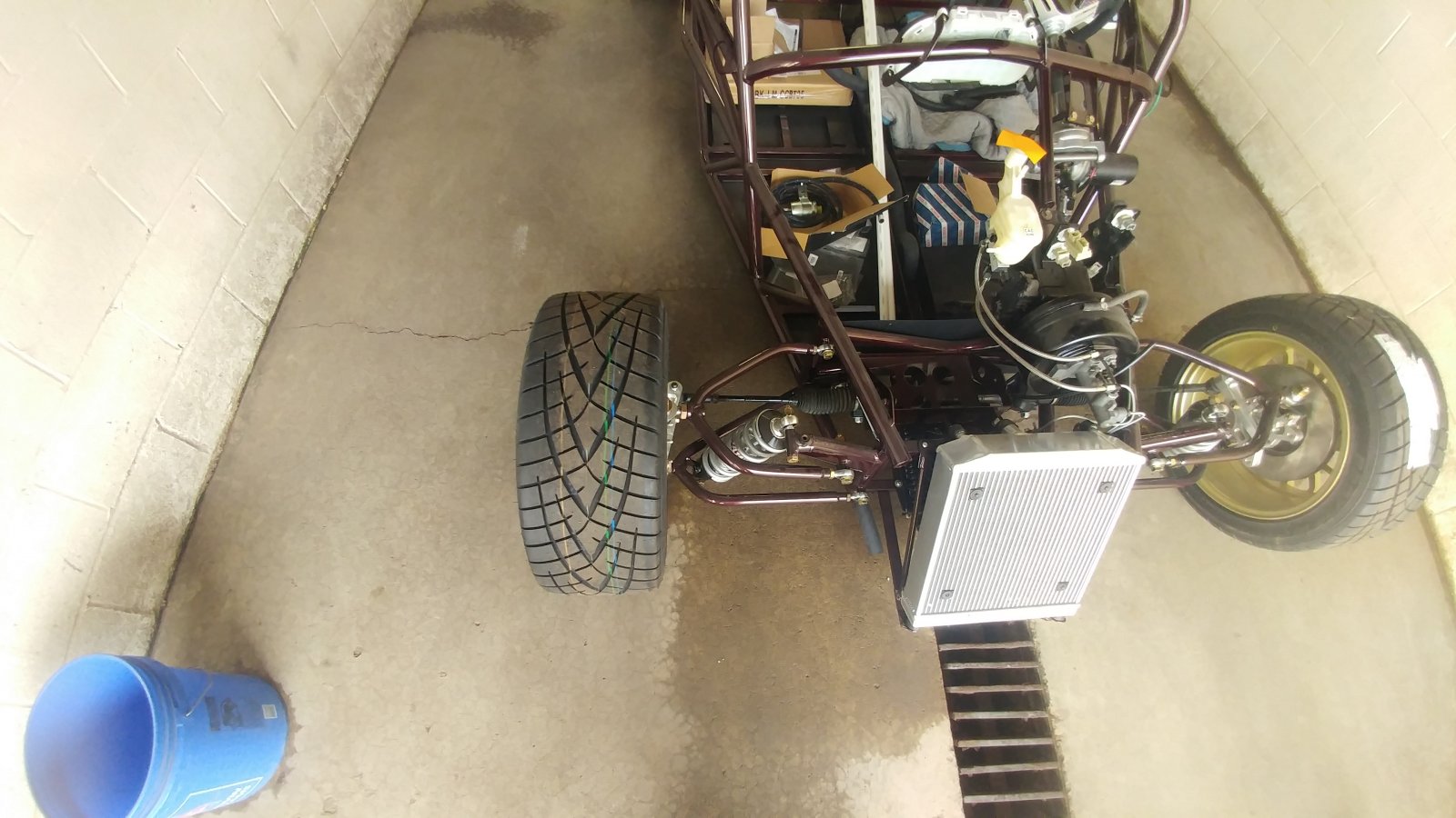

Vwsaabvt

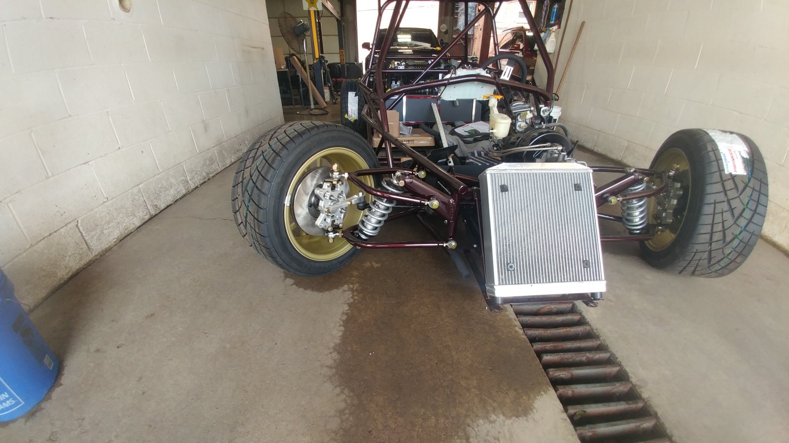

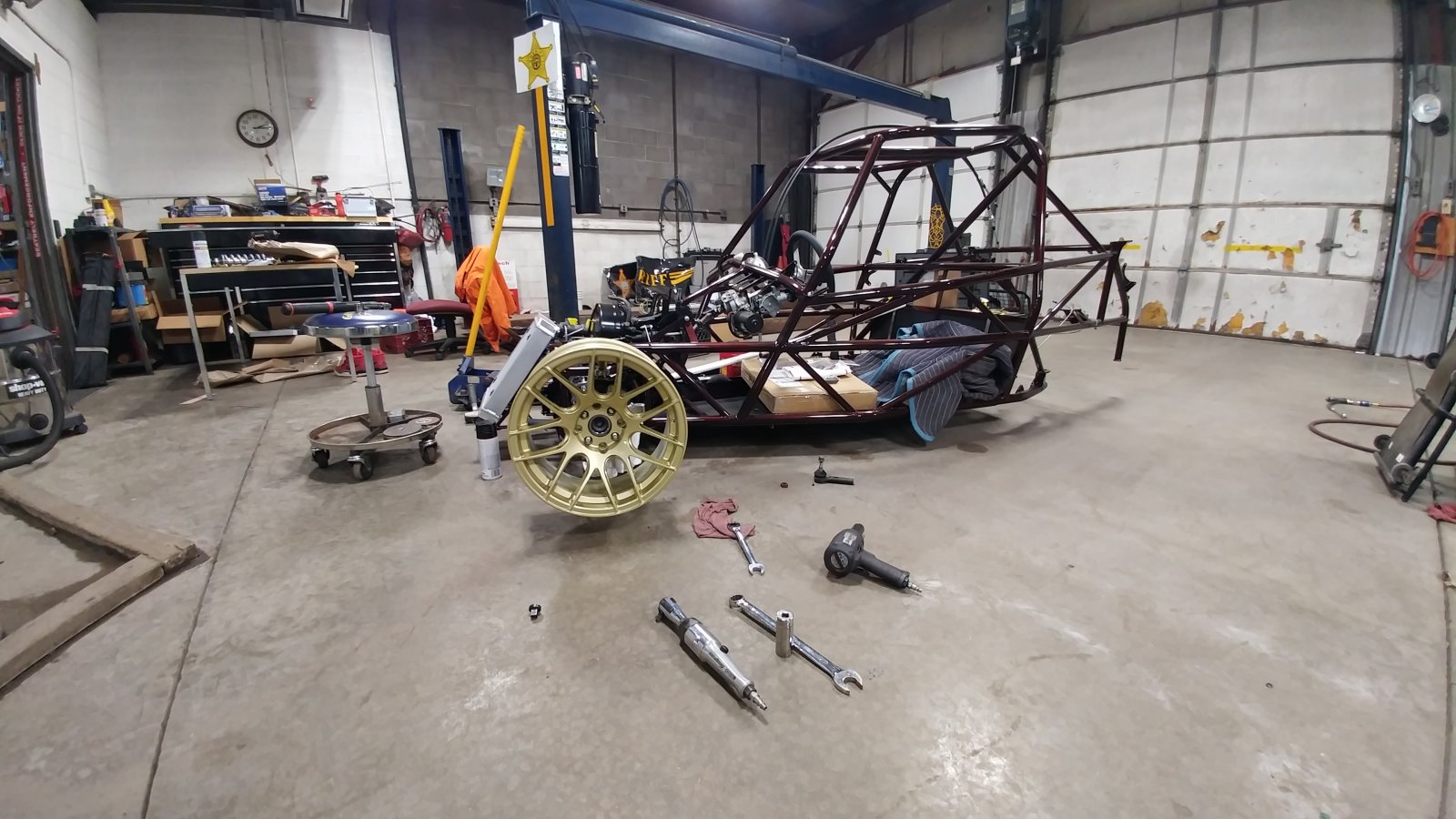

Don't mind the lack of brakes, we don't need those yet
