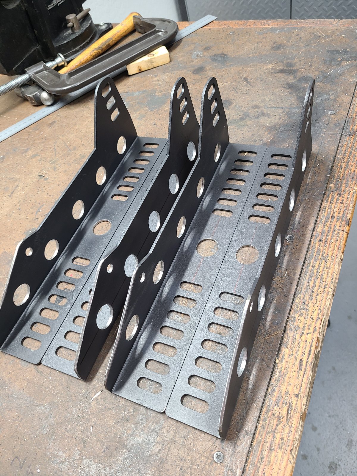

L-brackets like these?
They mount to the side of your (assuming) aluminum seats and bolt to the frame.
If using the DF supplied seats, the brackets are designed to bolt to frame without any modification. If you are using aftermarket seats, the brackets may need to be modified to fit properly and additional set rail mount locations may need to be added to the frame.

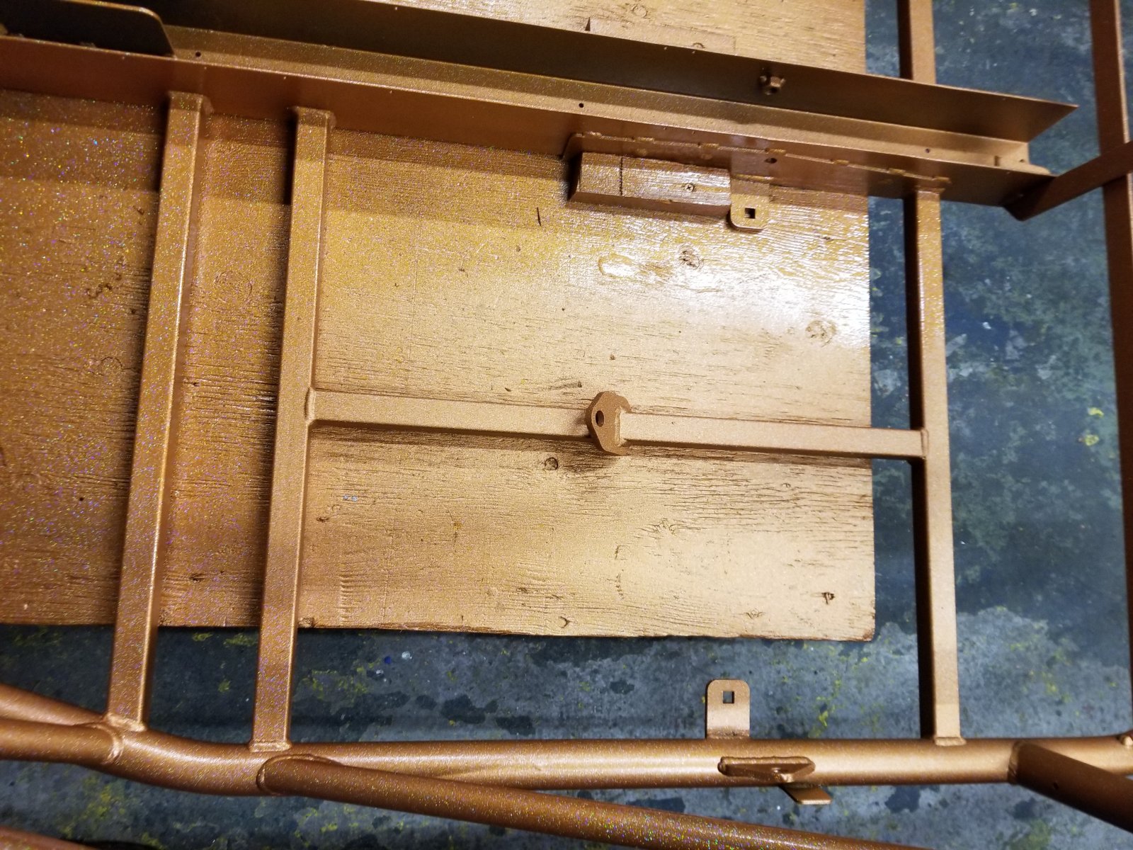

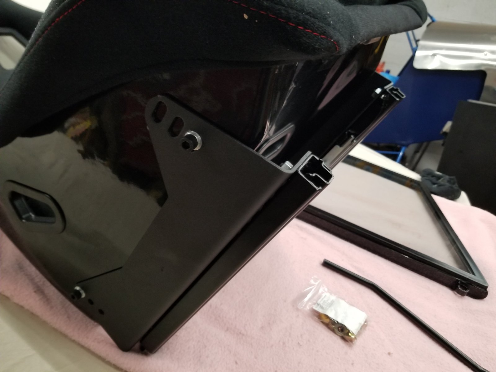

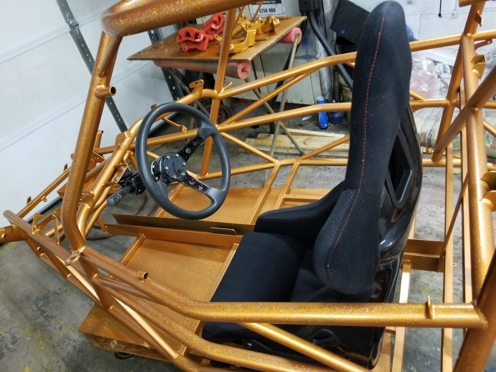

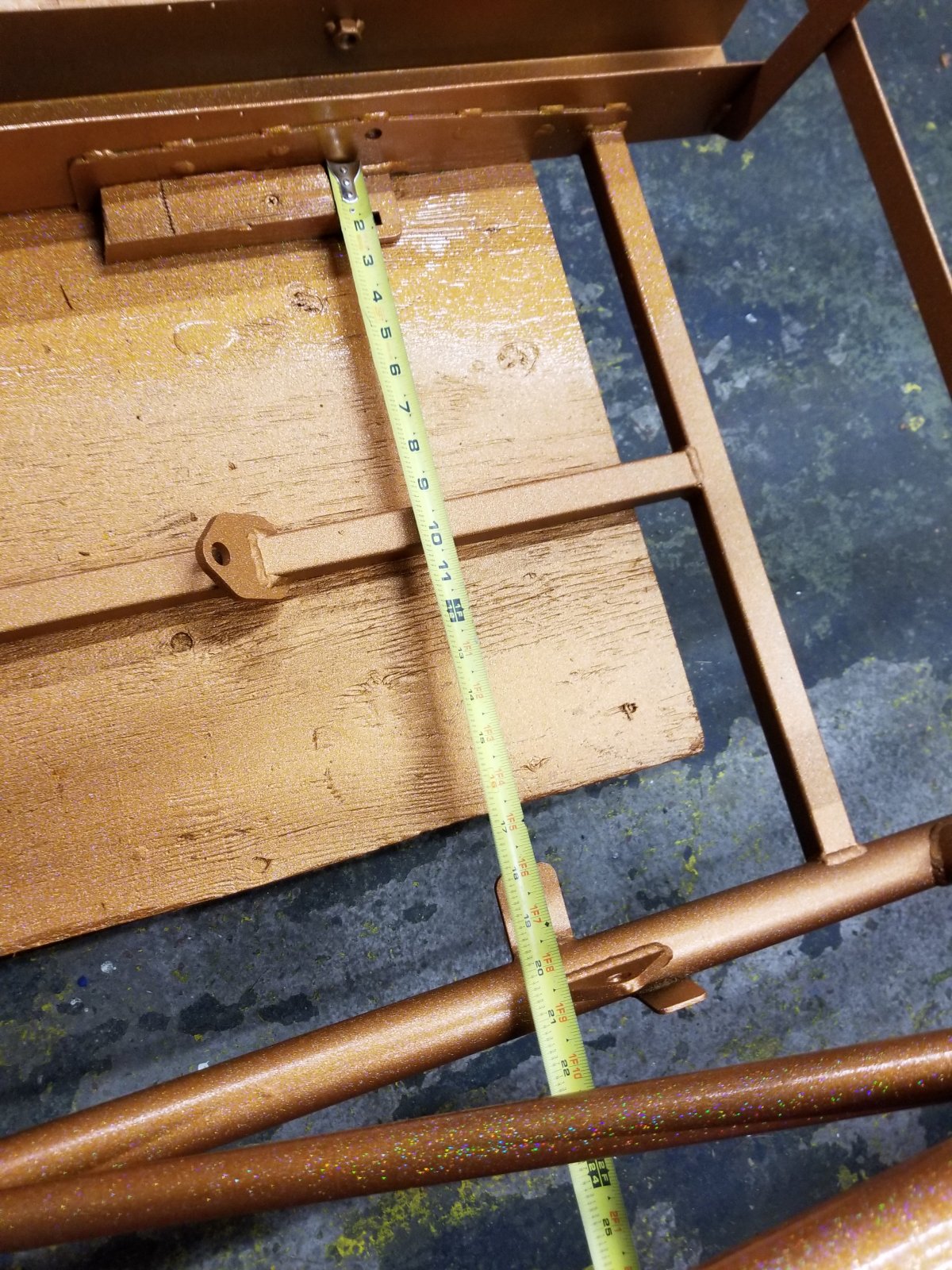

Here are some pictures
Thanks Spague !

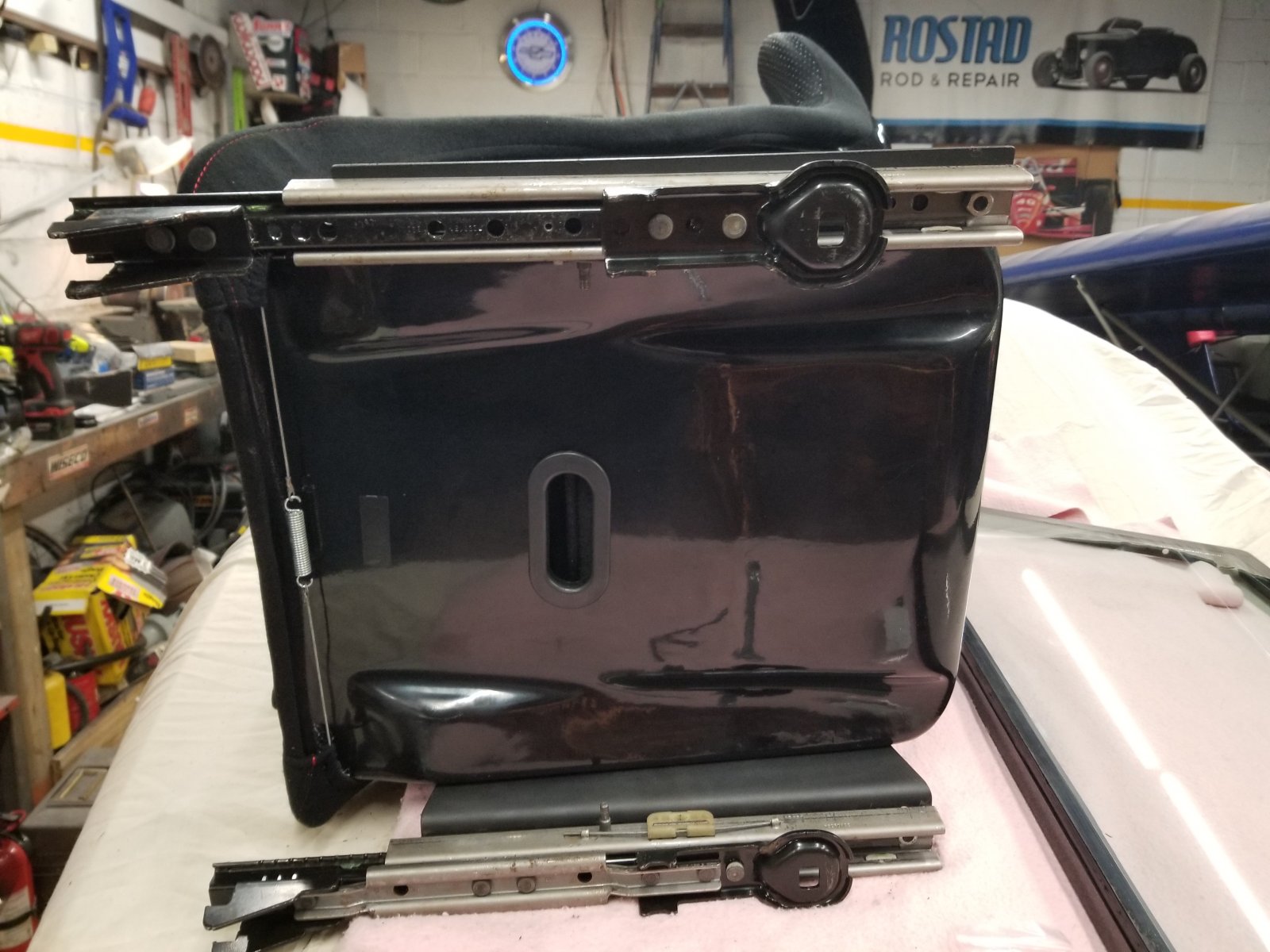

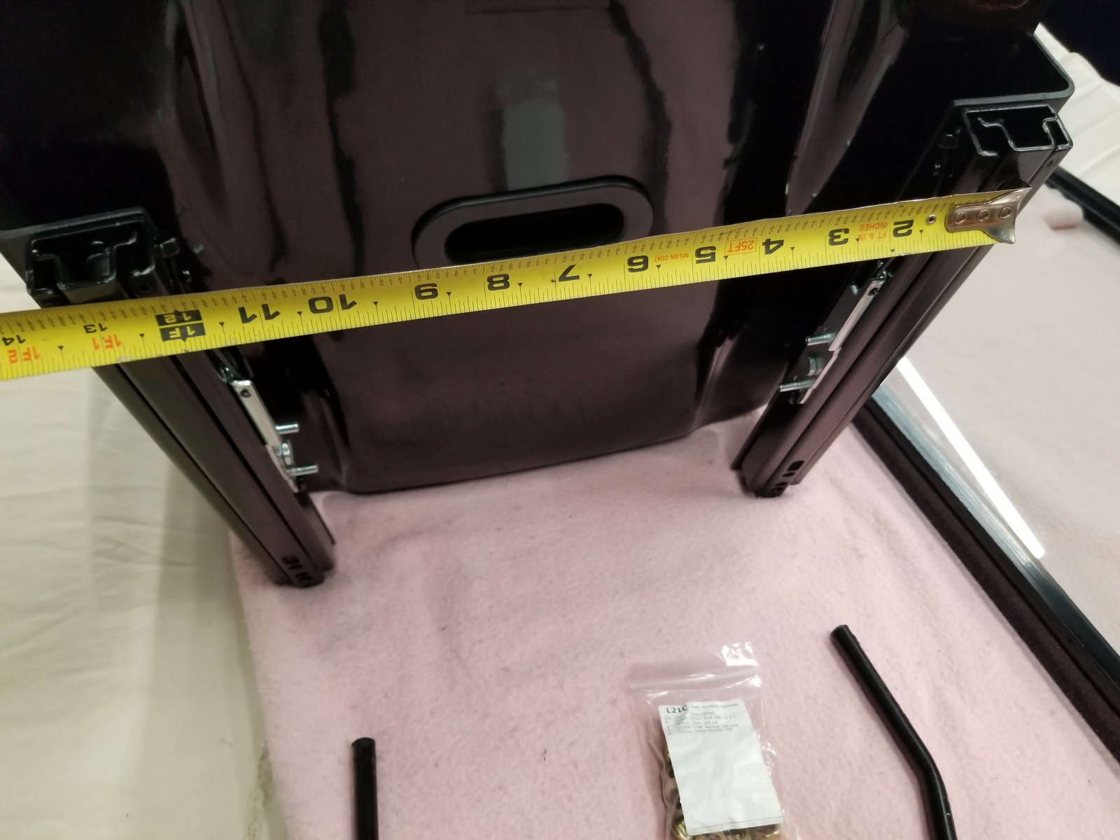

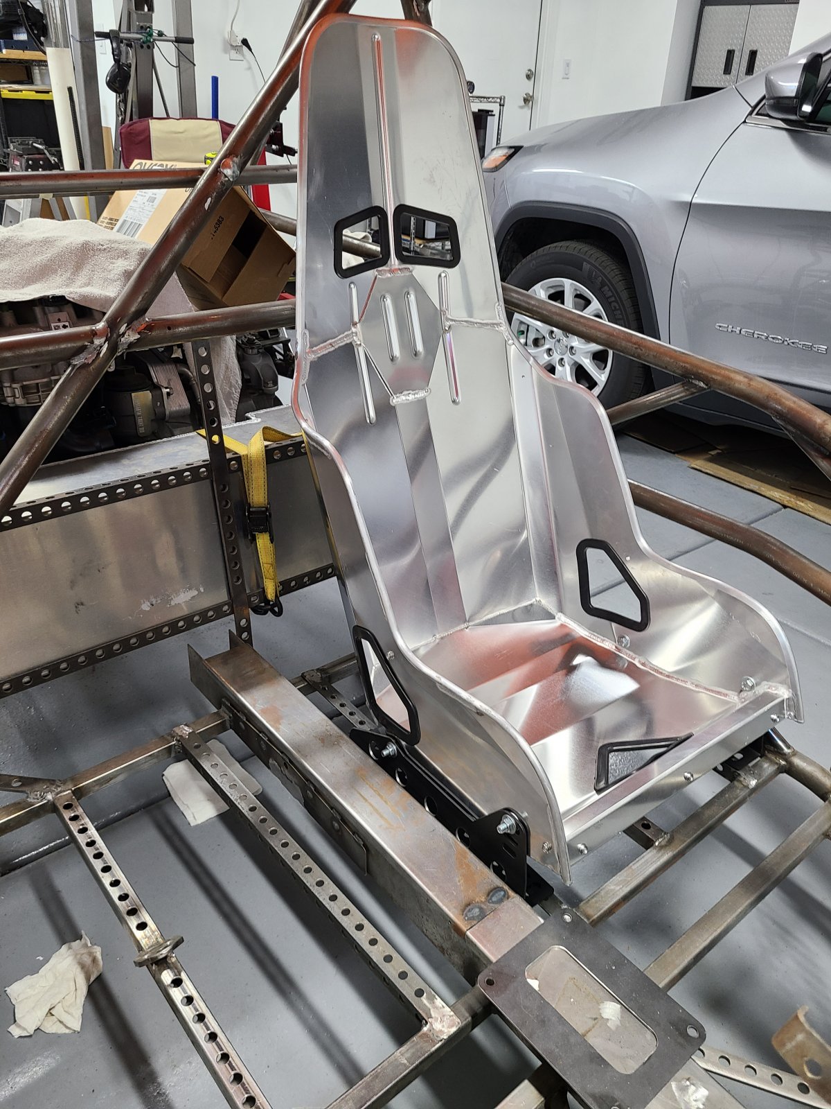

So,,,, after 5.5 hours. I have the driver seat mounted in the car !!! I utilized the Cobalt sliders. Let me tell you , there was a lot of drilling and grinding out the factory rivets! I turned the "L" Brackets around and bolted the Cobalt sliders on them. Ended up being the exact distance!
I did something similar and love how it worked out.
