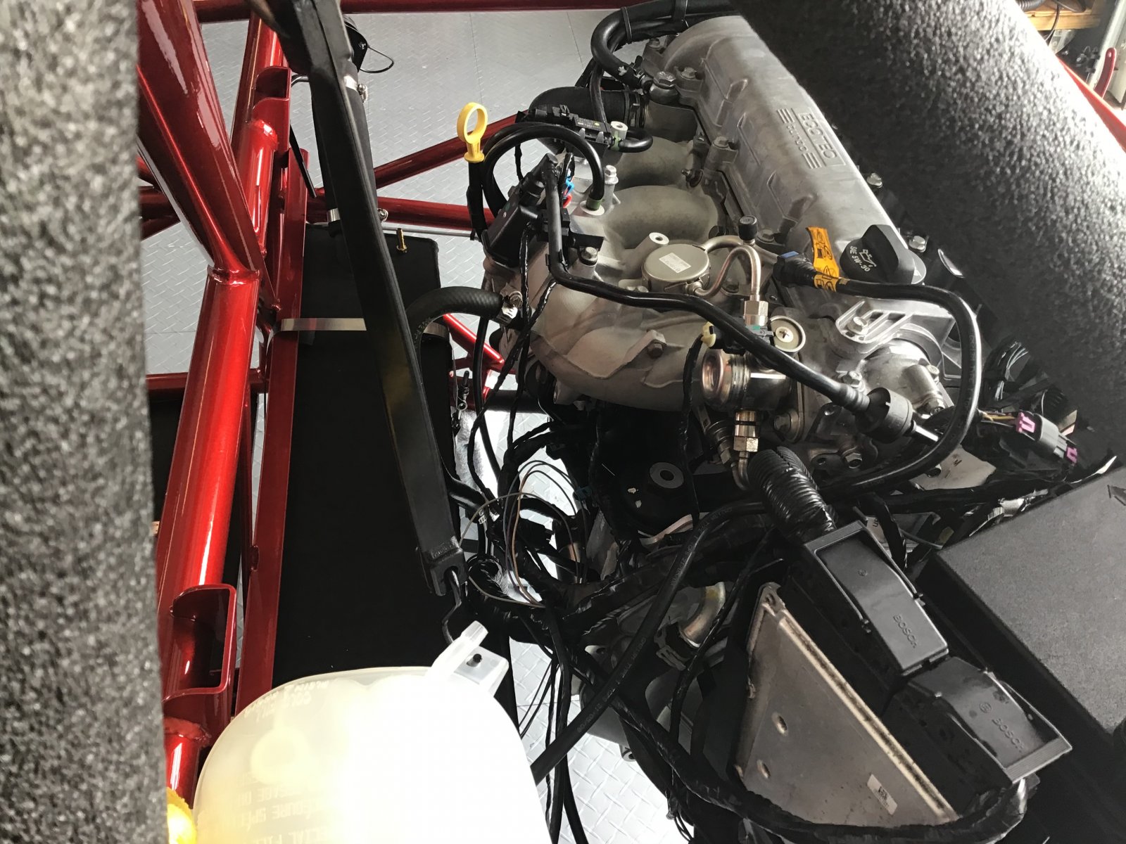

Where does the little tube on the over flow tank hook to I don’t see anything it can connect to,
Thanks as always for the

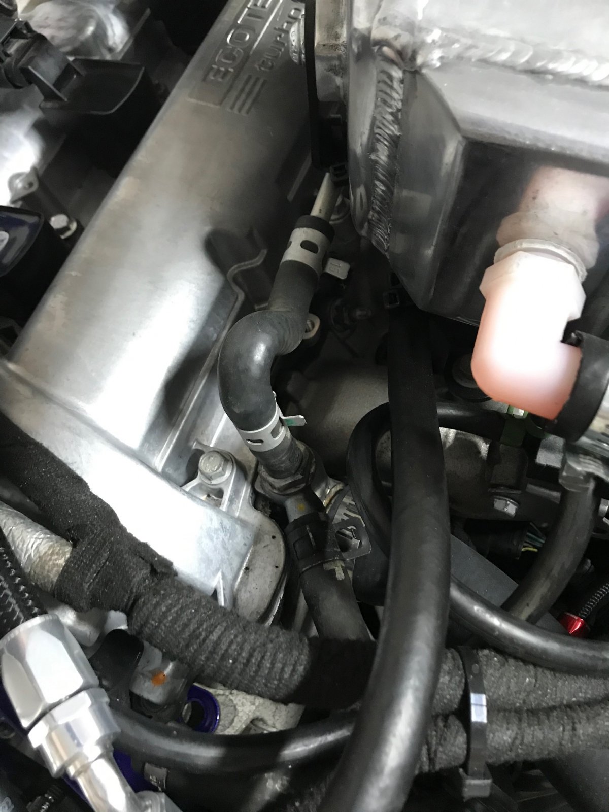

OptimizePrime
Hope this helps - the coolant overflow comes from the passenger side water neck which it doesn't look like the bolt on yours supports. Also, you can remove the intake manifold evap pipe by the map sensor and just put a cap over the nipple.

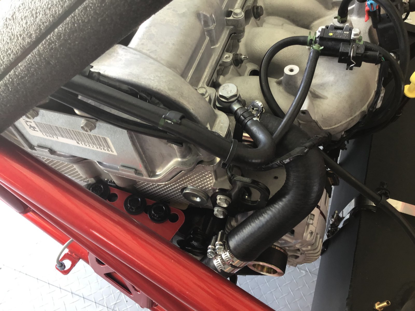

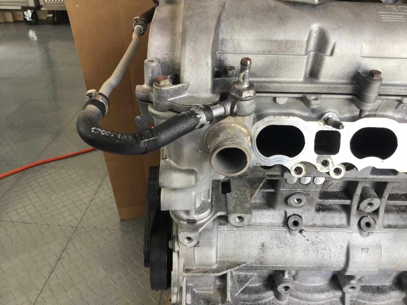

No wander I couldn’t find it . It’s not on the new engine I guess I will have to take off old engine
