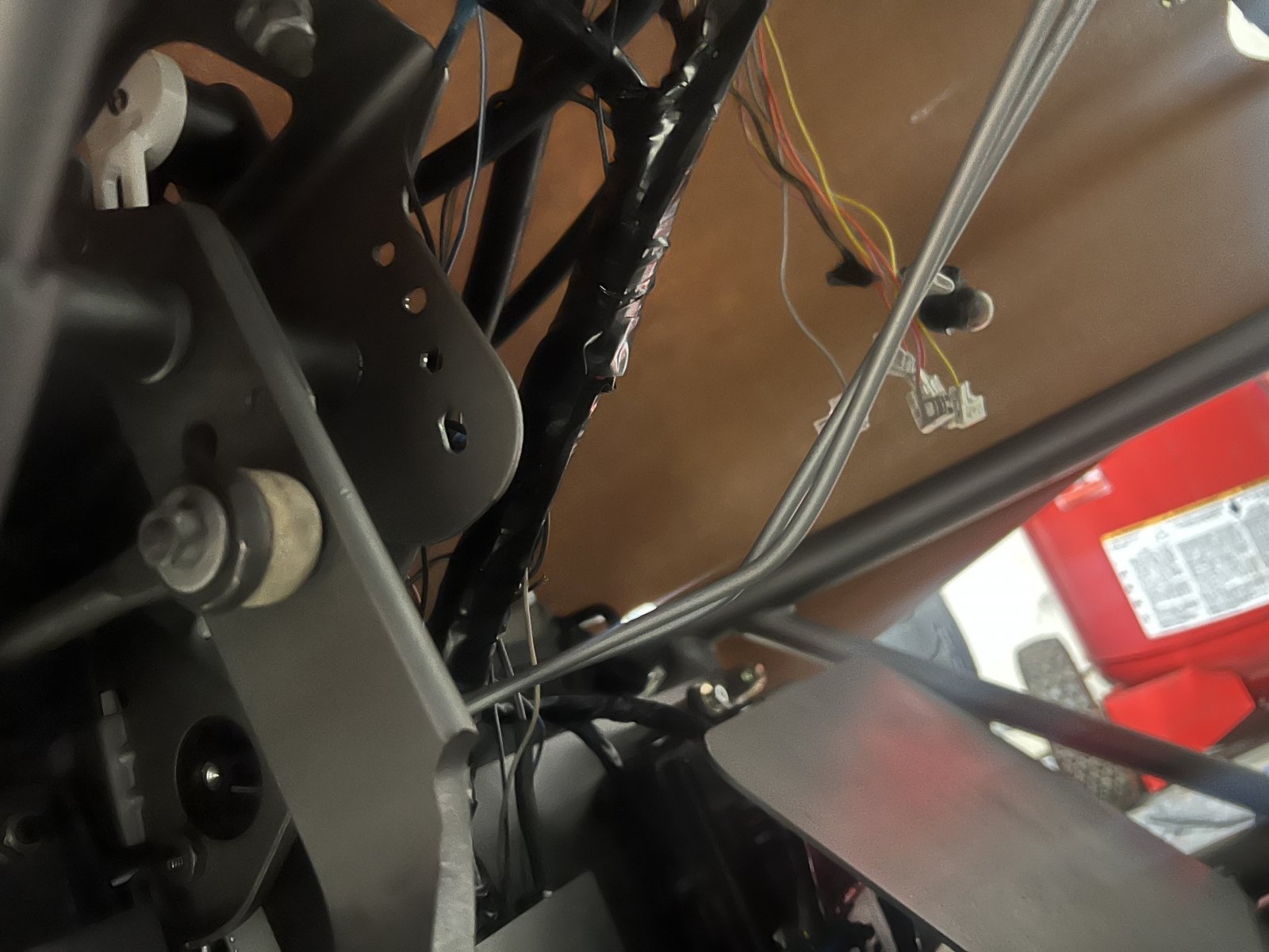

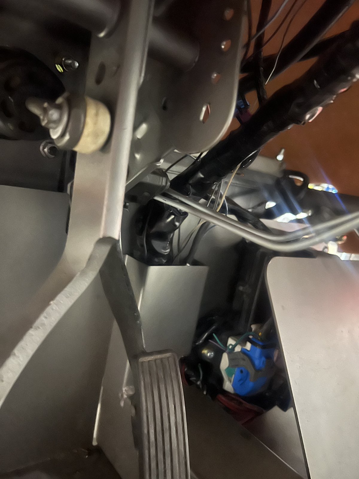

Low and behold thanks Ross I adjusted the pushrod bushing misaligned. I’ll check tomorrow fingers crossed.

D&dgoblin69
I adjusted brake booster push rod to master cylinder so that it’s not cocked. Test drove about 5 miles brakes starting to drag lock up. So now Iam going to brake system flush. Then I’ll rebuild calipers. If that don’t fix it Iam calling df.
Your park brake cables are not hooked up, but make sure the park brake levers are fully retracted. I have had them stick before after setting them.
Also, pull up on the brake pedal just to make sure it is fully retracted. my clutch pedal will stick just a hair every now and then. I got into a habit to kick it and the brake pedal up with my foot while driving, just in case.
