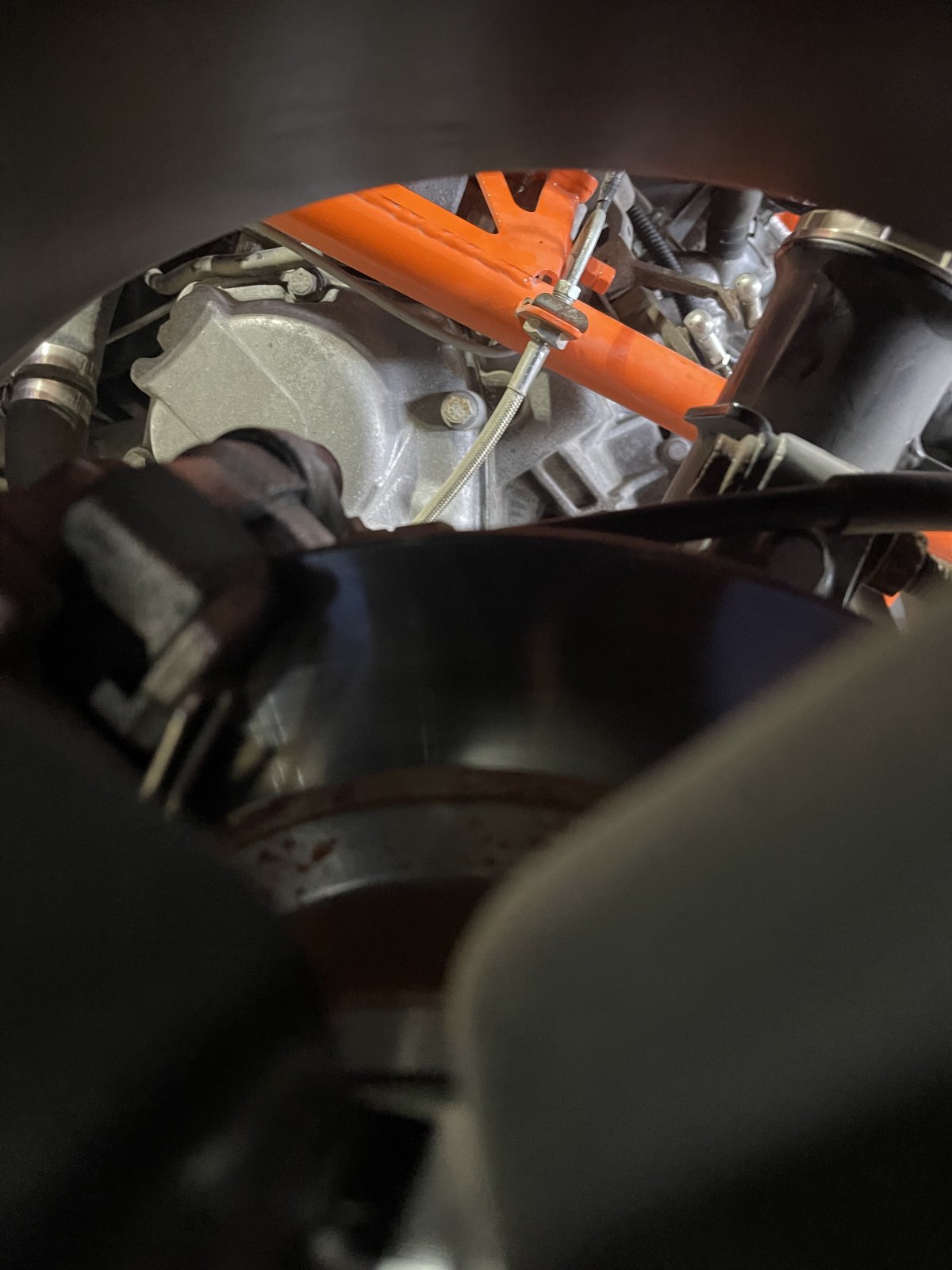

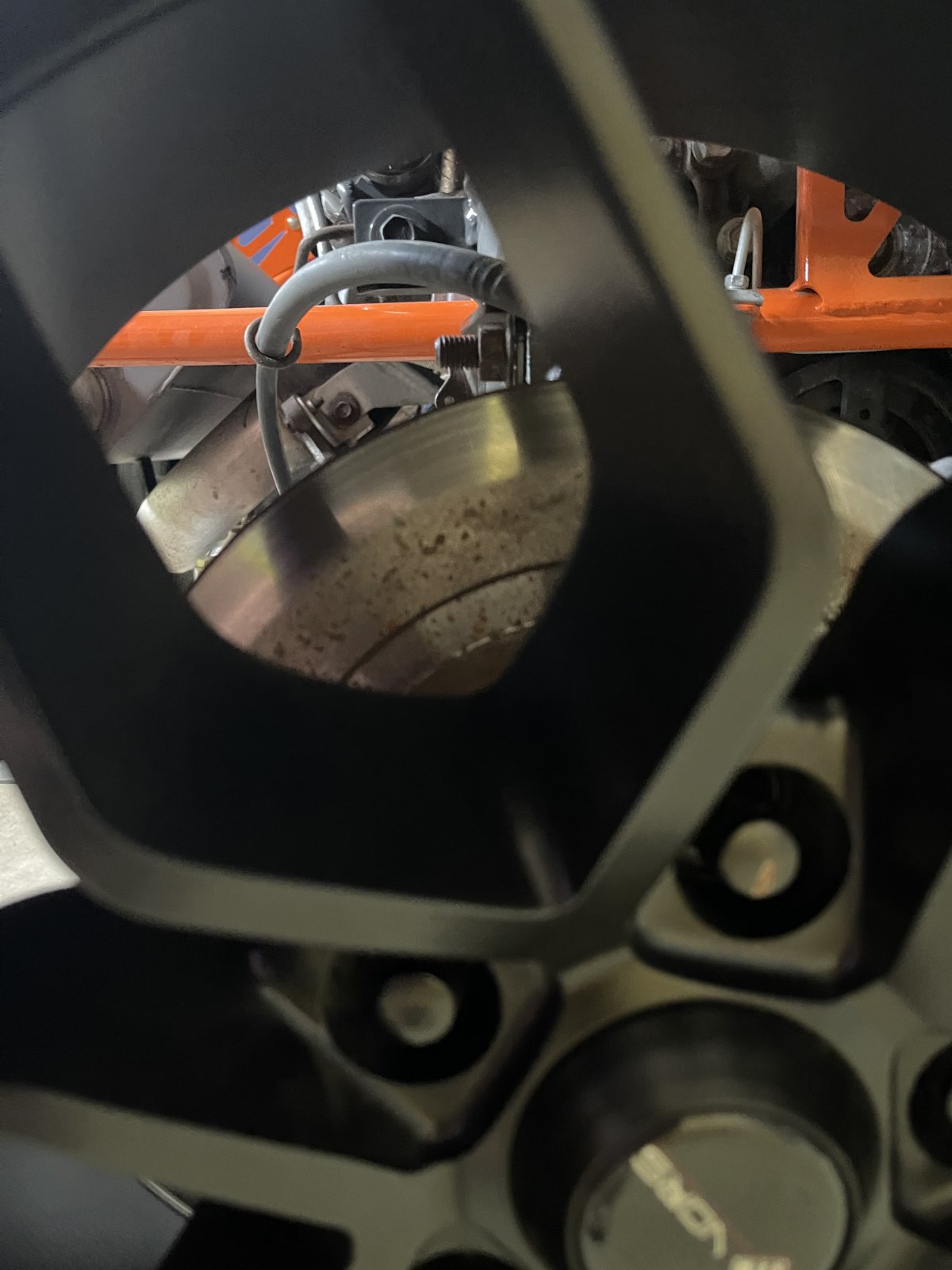

So my right rear outer pad only contact the upper half of the rotor. I’ve don’t brake thousands of times and can’t figure this one out. I’ve taken everything apart and check to make sure everything is sitting flush yet it keeps only contacting the upper half of the rotor. Any ideas
I'm pretty sure the spring-loaded pad goes on the inside of the caliper, is that the way you have it set up? And do you have the external caliper spring installed? Have you run the car at all? I got some funny pad wear as well and was told it was because my rear brakes were hardly used, so I'm adding a proportioning valve.
SmsDetroit
Dove it all last summer. Worked on them this winter. Same problem. I’ll double check the pads but I think they can only go in one position. I do have the external caliper spring installed as well
Not that this means you got it wrong but I just installed them backwards which was real fun after fighting that external spring lol. Fortunately I realized it before I put the wheels back on.

Here is a comparison drivers vs passengers
It should be equal, but to be honest I’m surprised the dr side one is touching all of the rotor. Most only ouch a little bit of the rotor because there’s not much brake pressure back there and the pads are tapered, until seated in fully.

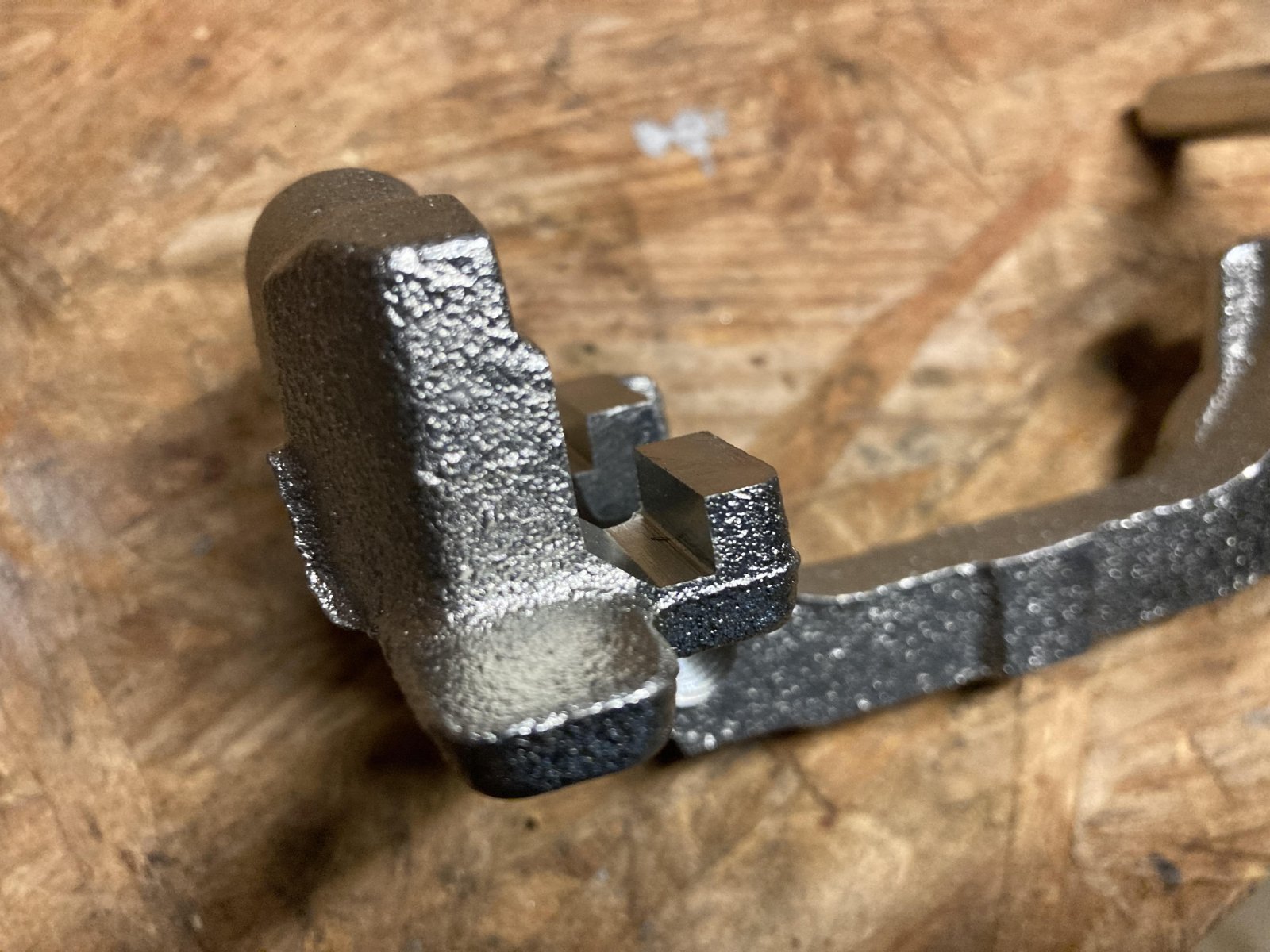

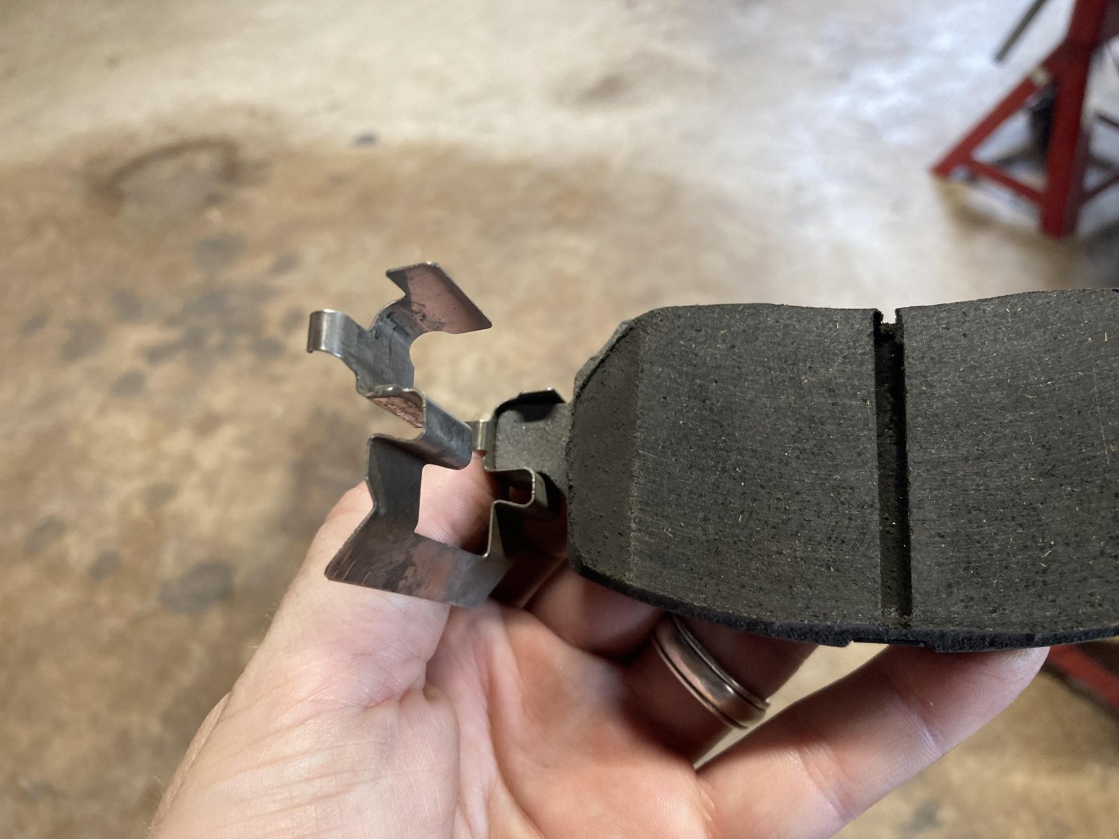

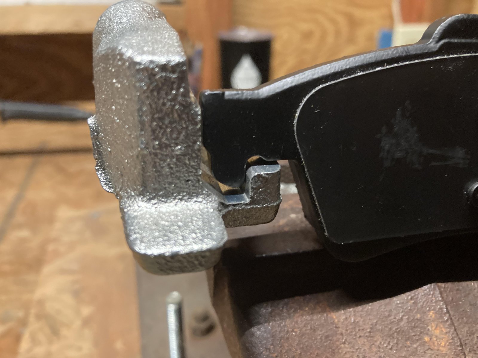

I've been test fitting my parking brake rotors/calipers/pads all weekend and I cannot get the outer pads to contact the rotor flat. With everything mounted and the spring clips in place, the pads are bound up and have no ability to slide inboard/outboard or settle flat against the rotors. I thought I had a solution by rounding off some sharp caliper corners that were digging into the pads. It seemed to help some but they still bind on a tab at the top of the pad. The previous setup had clips that allowed good lateral movement. I see some folks advising brake proportioning but I don't see how that ensures flat contact. Should there be some kind of lubricant applied to the channels the pads rest in? Put it together, send it and wait for the pads to wear themselves into shape? Probably overthinking but it doesn't give me that warm fuzzy feeling.

It kinda varies based on when I put the clips on. That’s when the pads bind up in whatever position they settled in, usually slightly angled compared to the rotor. Maybe things will square up once they’ve been bled and the full force of the brake system has been put on them.
Mine were a little wonky until I bled them. One side was really tight and the other side was really loose. They bolted together easily though, is this not the case for you? When you get ready to bleed them and the clutch is to use this kit. It was sooooo easy to use. I'll never bleed brakes the old way again.

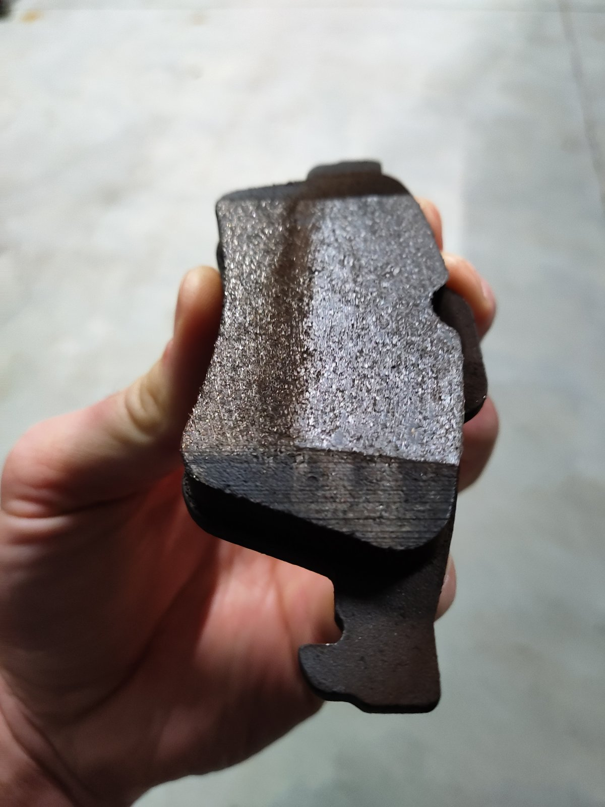

This was my wear pattern after a thousand miles of driving:
36861
Installed the proportioning valve and it cleared right up, and stops significantly better than it did before (which was already very well).
