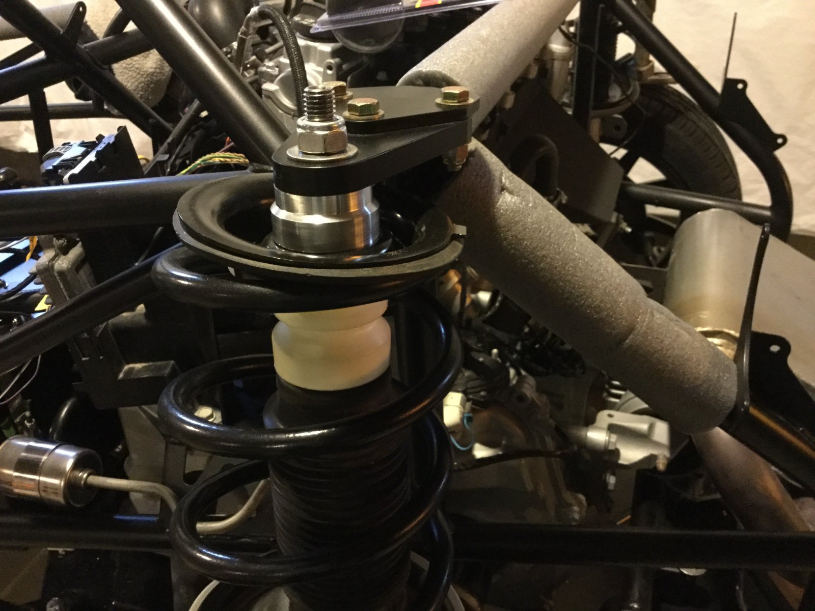

Check your rear strut bolts???
This is what they should look like.... with about this much thread sticking out.

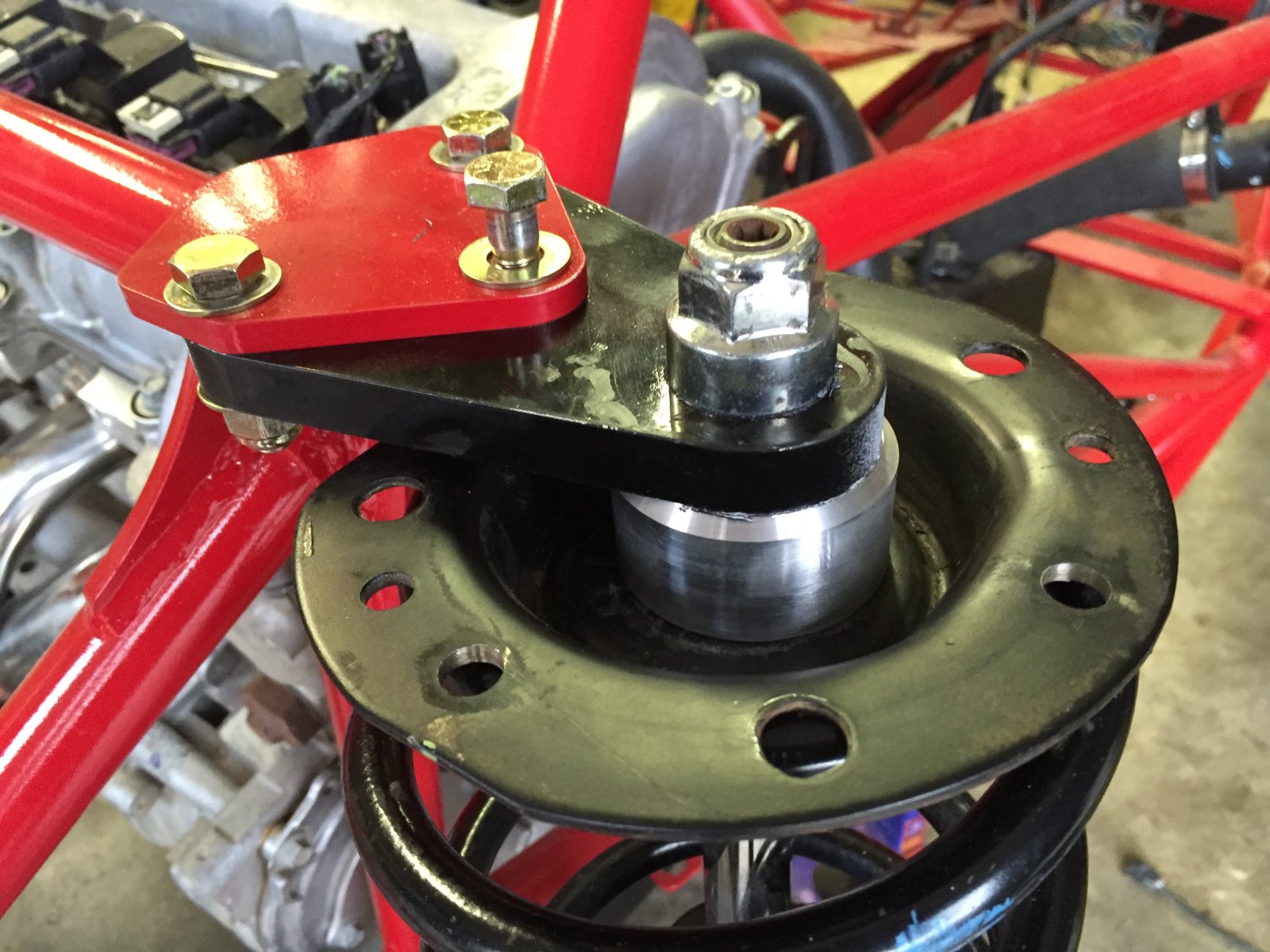

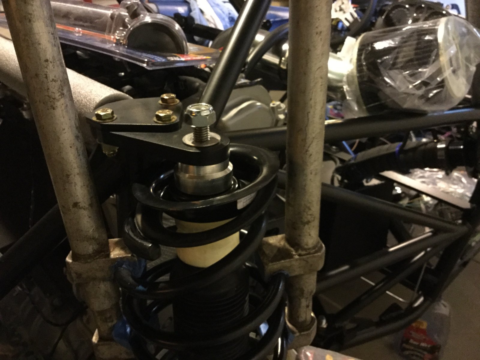

This one here is not correct (you really have to play with it so that the upper spacer (aluminum supplied with kit) slides onto the strut piston. Never liked the limited amount of thread on “BLUE” (BARAIR’s build) ends up even after driving it was not all the way on the spacer???

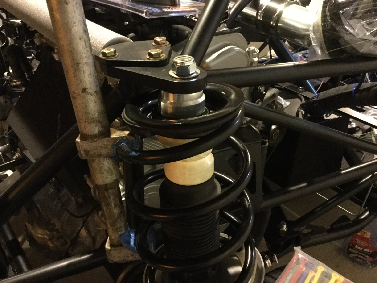

Here it is with the spring compressed and the spacer seated correctly...
