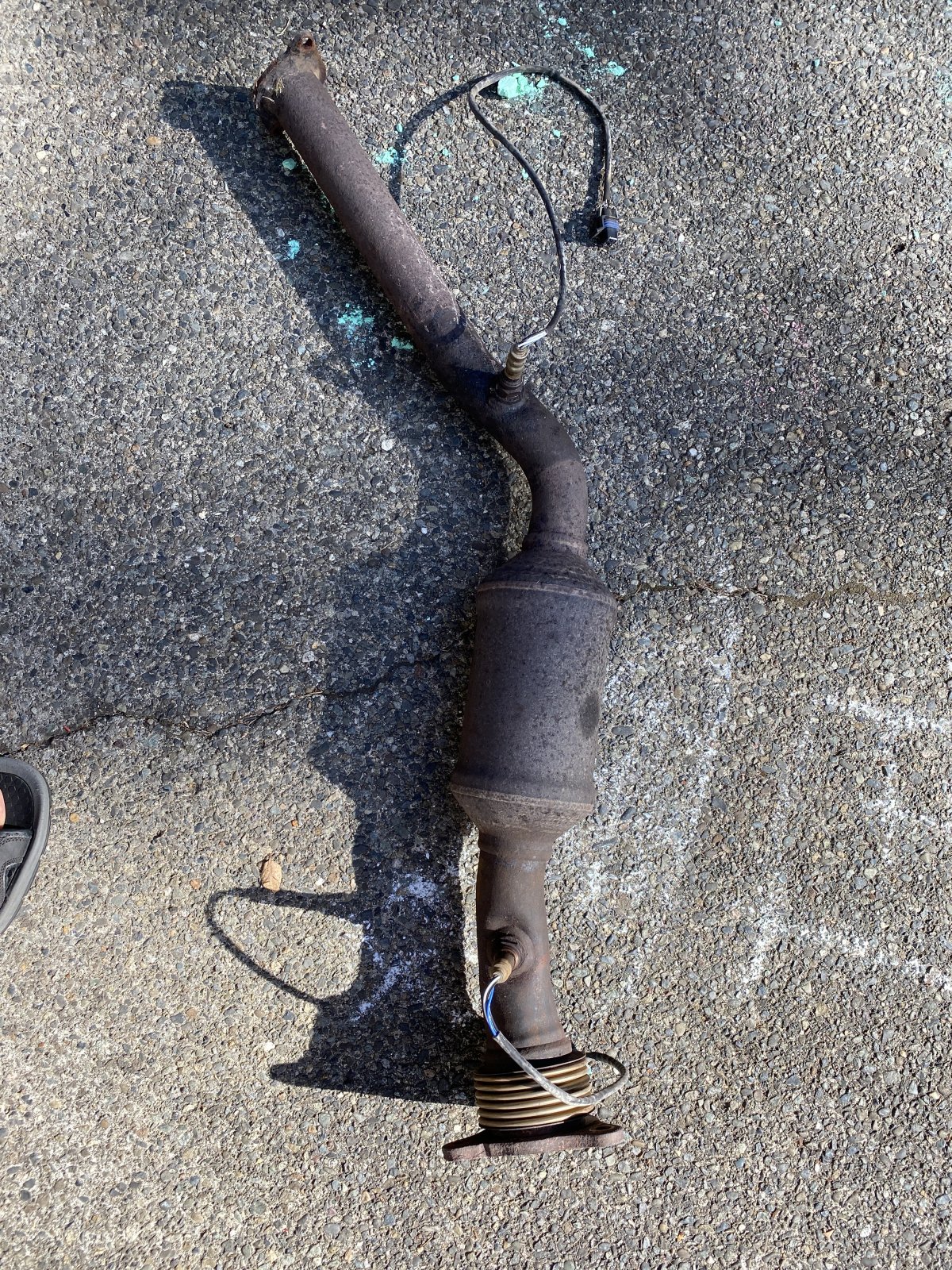

That's what I thought... My original downpipe looks the same. So, with this setup, would I replace the narrowband O2 in the DF supplied exhaust with a wideband for the tuning process and then swap back the narrowband when I'm done?
16981
Oh, I didn't know that. Guess you can have a new bung welded in, or buy a header with one in it.
Guess you could swap O2 sensors too. The wideband tuning doesn't need the narrowband. But I like the wideband gauge working after the tuning is done.
