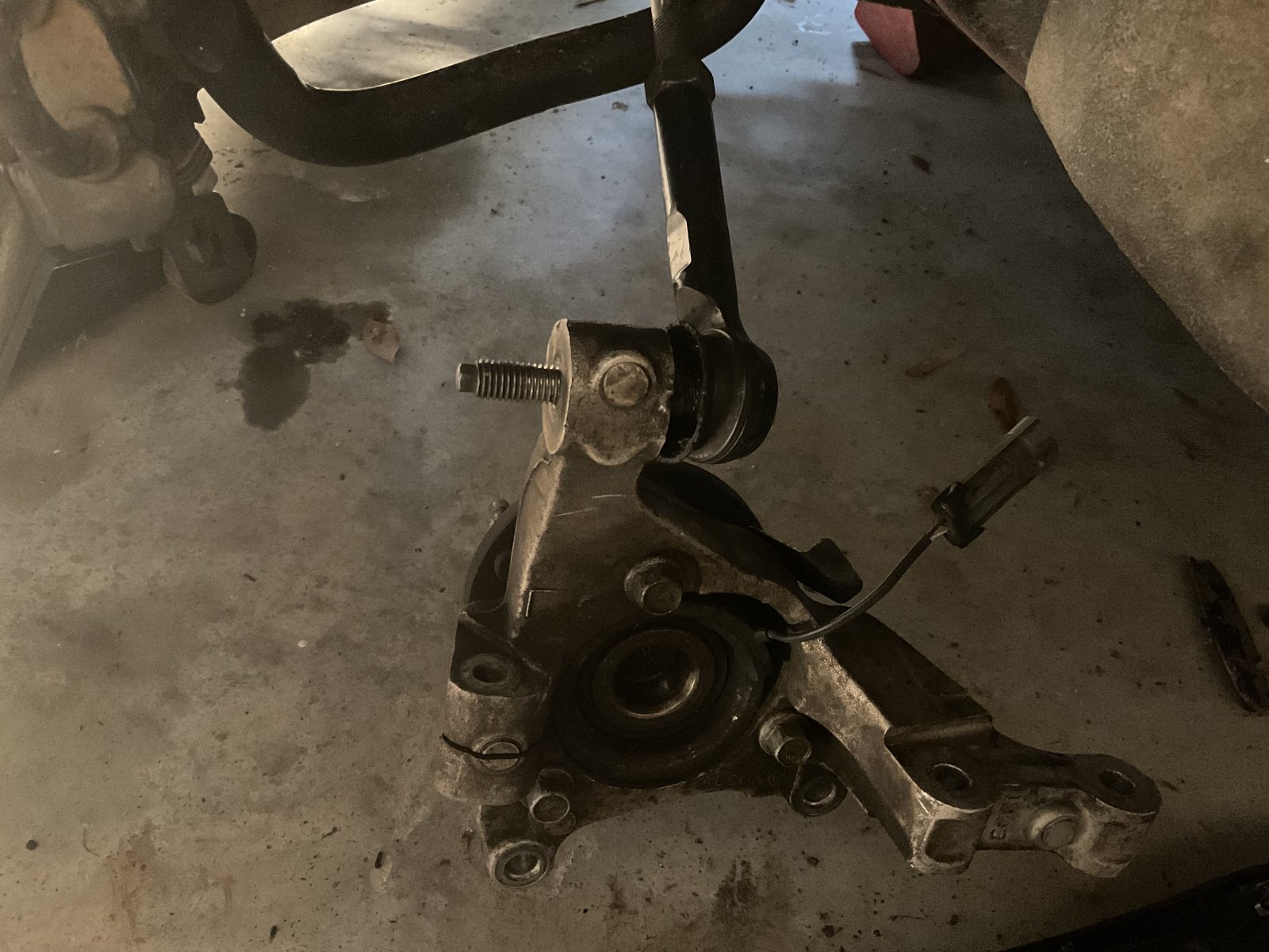

Can anyone explain how to get this control arm off the knuckle? I didn’t see it in video 3.
26107
Dale E
Pickle fork or two big hammers hold one to one side of the hub part and hit the other side a few times to loosen up the through bolt. Hammer ot the bolt put a nut back on it first .
You can also unscrew the tie rod end from the tie rod (right next to the jam nut) and then deal with removing the tie rod end from the knuckle in a more convenient location/orientation. I think I picked up a loaner tie rod end tool from Advance which is recommended if you're going to reuse this tie rod end (it will go on the back, the new ones supplied with the kit go on the front).
