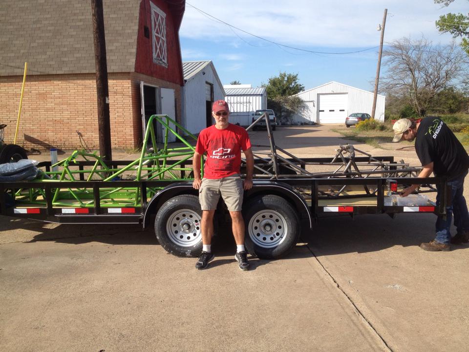

We picked up my frame and also picked up Frank’s frame. It was fun answering all the questions we got every time we stopped for gas. We handed out a few brochures Adam gave us. I think my brother will buy one in a couple of years. My oldest daughter Tabitha, Ben and I dropped Frank’s frame and stage 1 part kit earlier today. He is just as excited as I am to begin. He saw mine and is thinking of powder coating his Goblin green metallic also. We decided we are going to keep in touch and share tips and stuff.

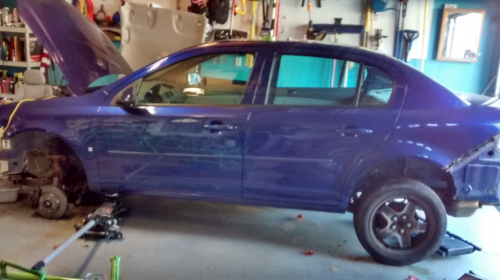

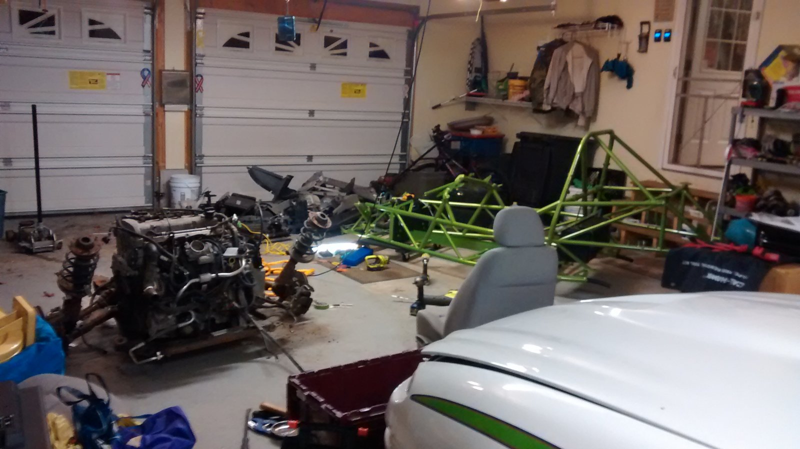

Started disassembling the donor Saturday morning, worked on and off with my girls all weekend. By Sunday night, the body was on the trailer with half of the dashboard and harness left. Virginia (my younger daughter) had a blast. She loved pushing the car off the engine out the door by herself. I will post that picture later.
Its hard to see, but there is a tire under the subframe. The rotors are about 1/4" off the floor.

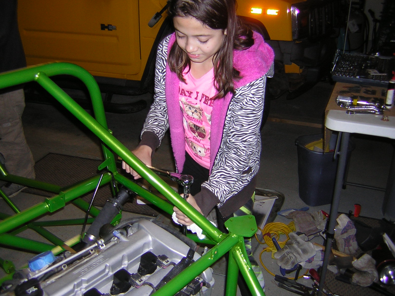

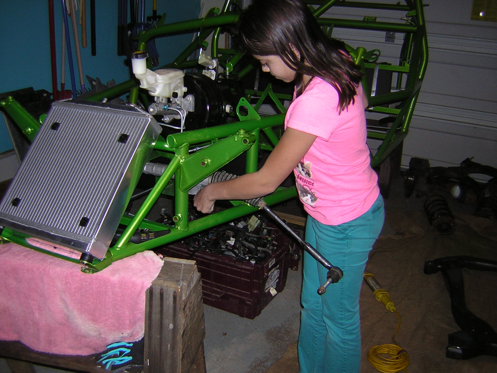

Worked on the car this week with Virginia. She installed the pedals, master cylinder, booster, radiator (with my help), fan, front hoses, fuel filler neck, and steering rack.

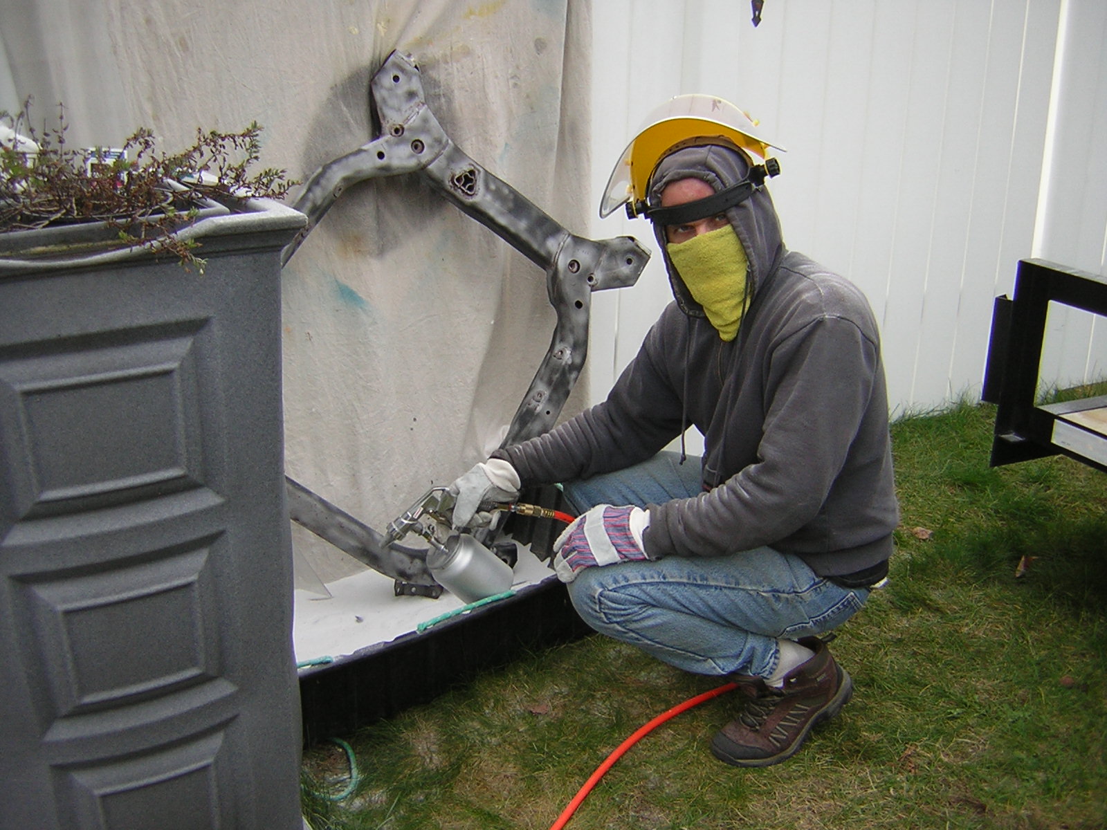

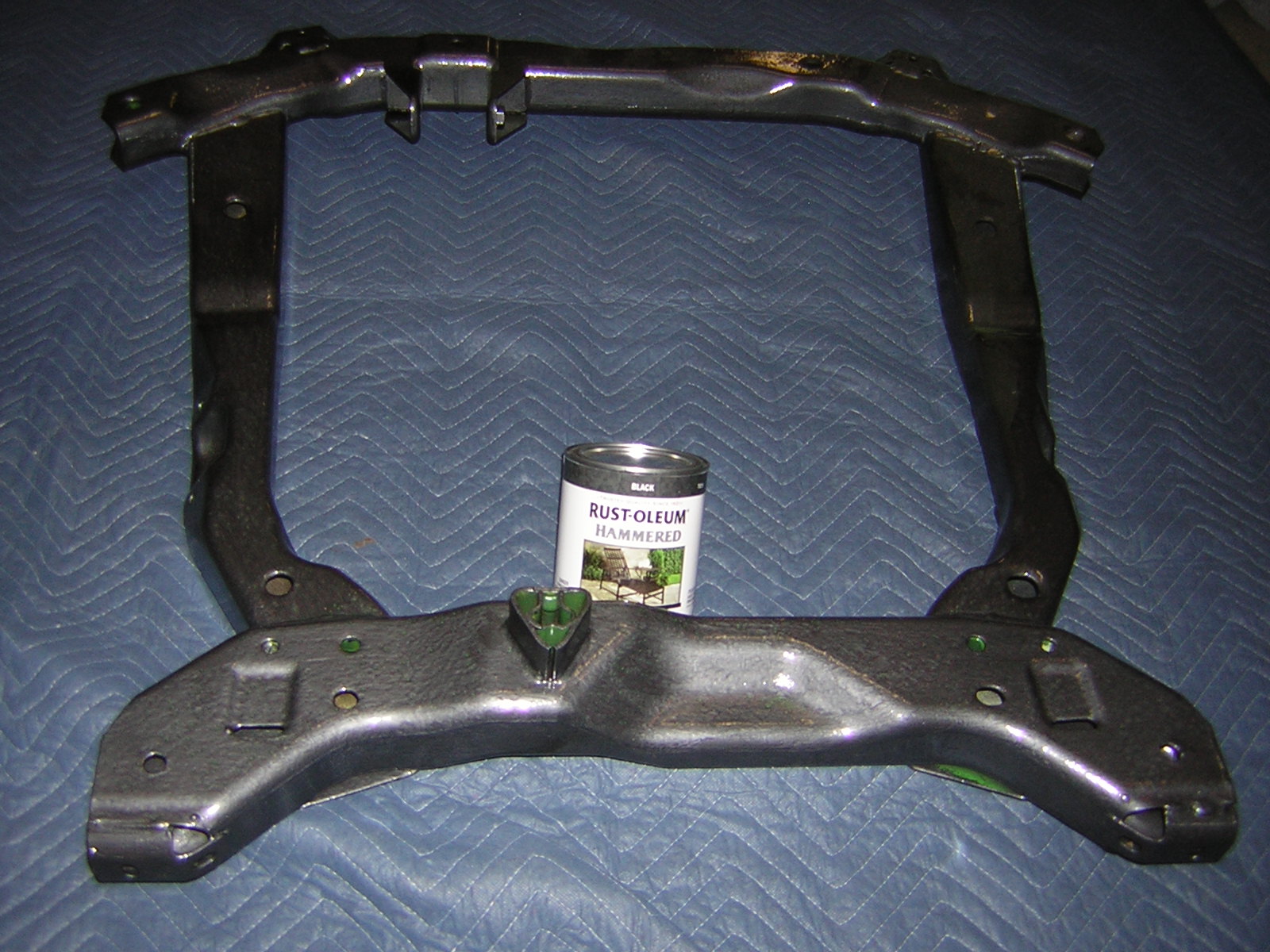

Sand blasted the frame a couple of days ago.
Painted it hammered black to help hide the scrapes and scratches. Painted other parts like the filler neck, rusty bolts and the brackets supplied in stage 1.

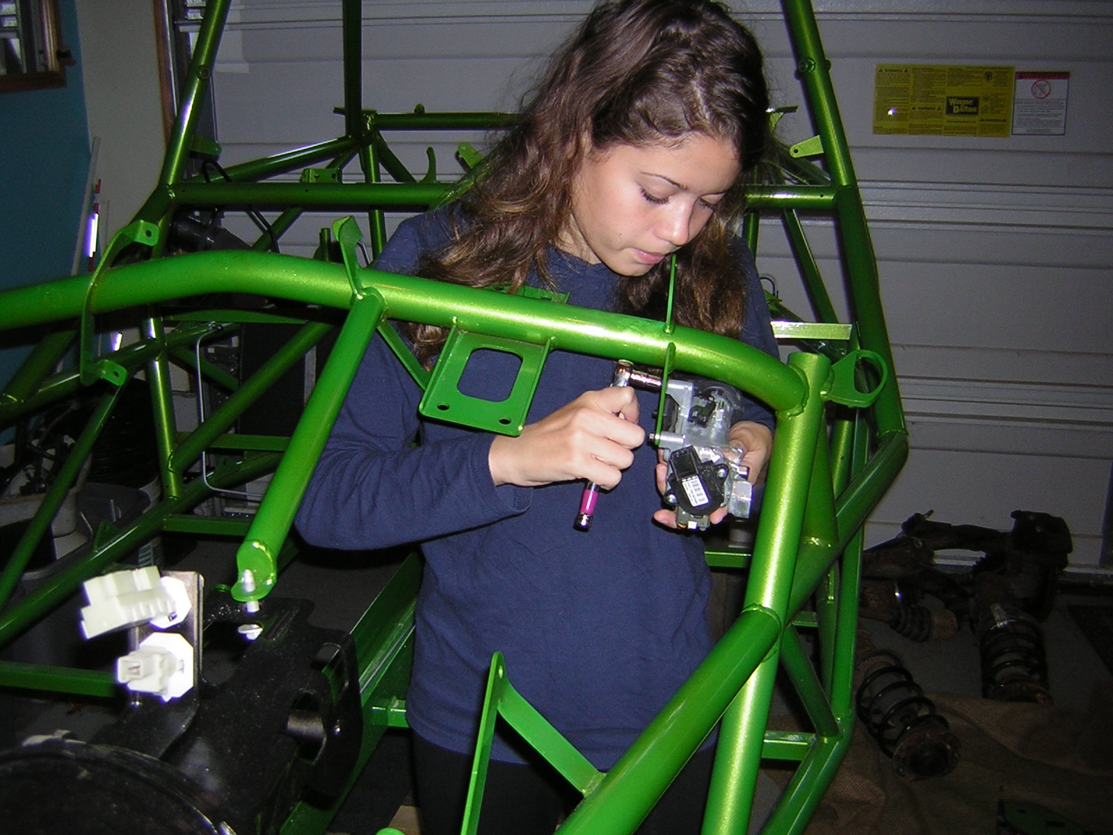

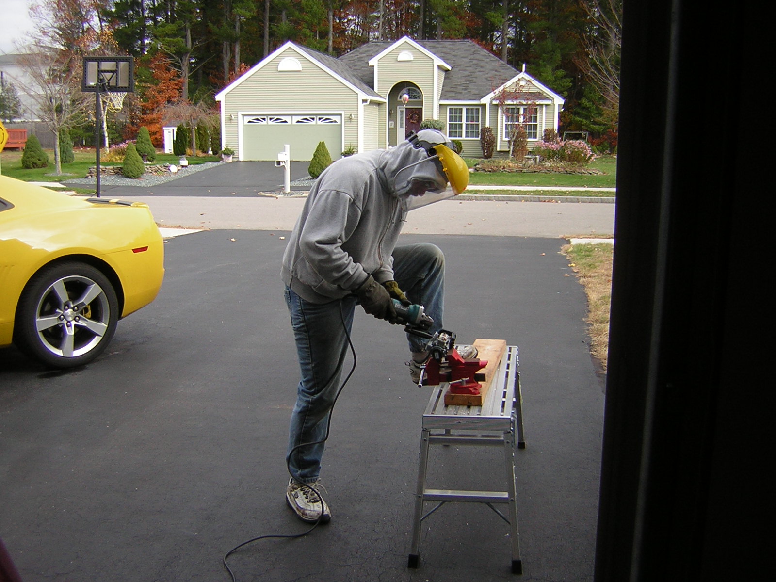

Grinding down the ignition switch.
Tabby installing it.

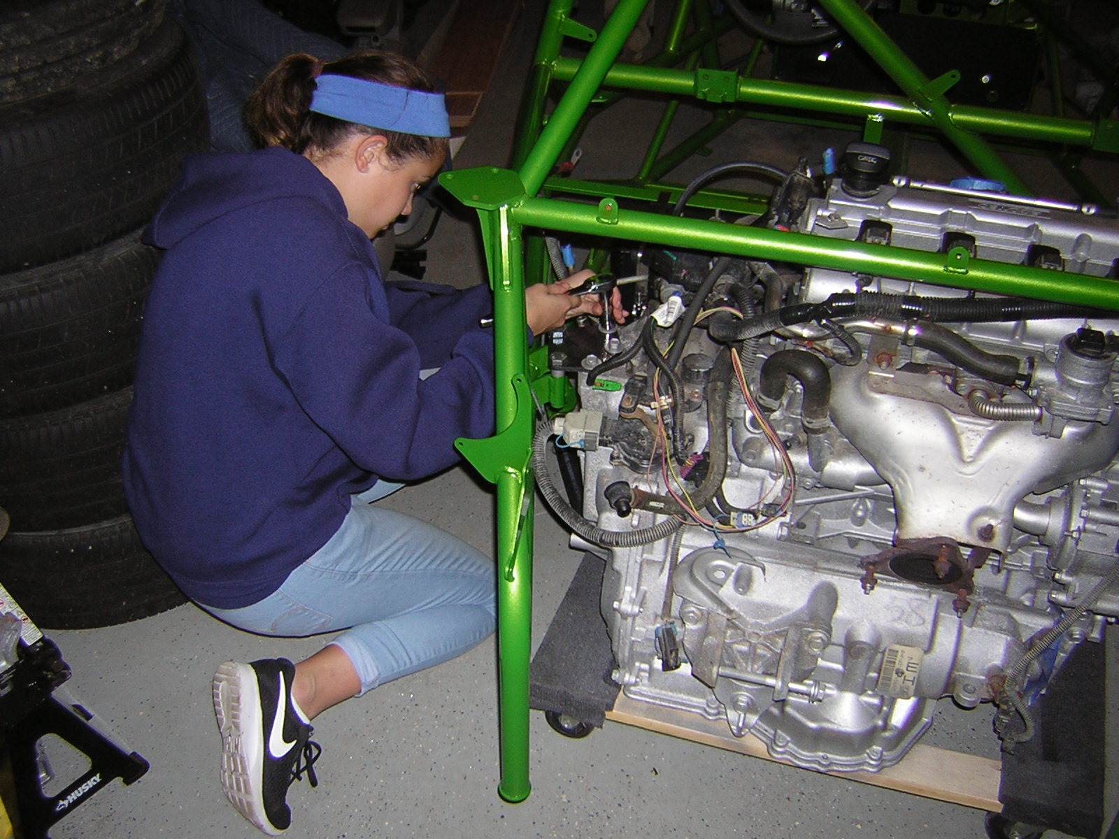

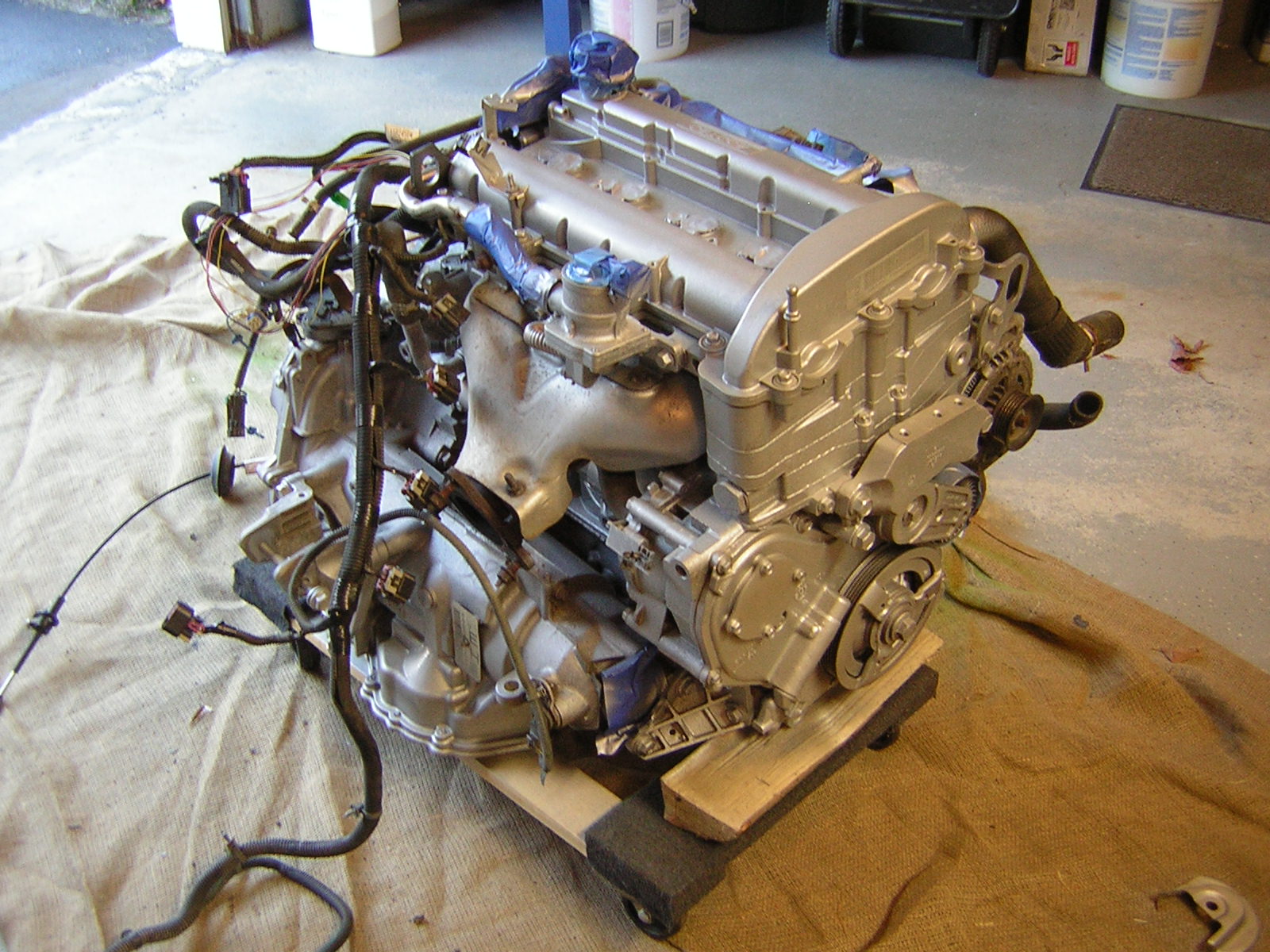

I did not disconnect the entire harness from the engine. It wasn't in bad shape and the tape wasn't dried out. I only undid the part where you pull back the MAF sensor to the large splice (the 5 loose wires on the left). I then taped the harness and put the looms back on. I did pull the 4 coils, taped the bolt holes and shoved a paper towel down the spark plug hole so there was some support for the tape over those holes. I know the front of the engine won't be seen behind the gas tank and seats so I didn't try too hard painting the front. I used Armor All on the hoses and wire looms before I painted which made it easy to wipe the over-spray off before the paint dried. I used a microfiber rag to wrap parts I didn't want painted and to help pull the wire harness away as I sprayed a section. I did tape off some parts as you can see in the photo like the oil cap, cv shaft seals, fuel rail and tensioner pulley. I will get the bottom of the oil and tranny pans when I install the engine on the frame. I did 2 thin coats, after the first coat, I could still see some dark areas, second coat is what you see above.
RichN

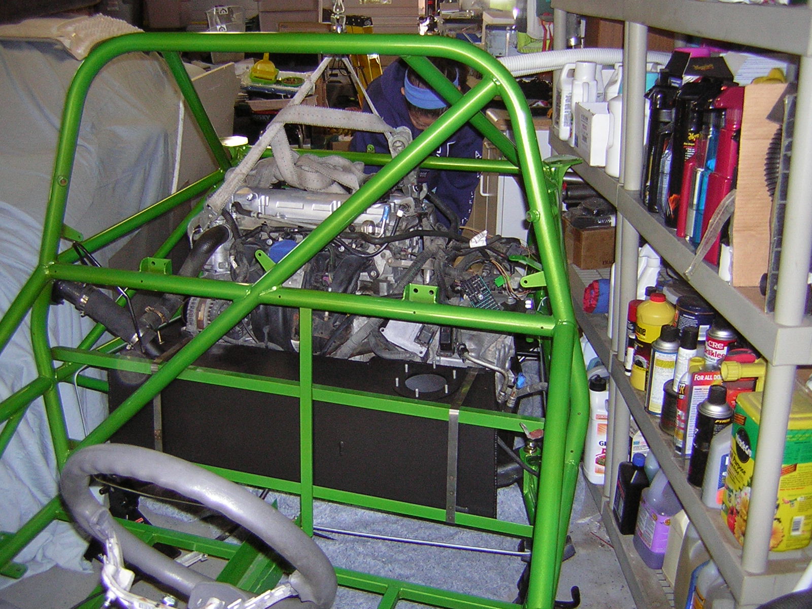

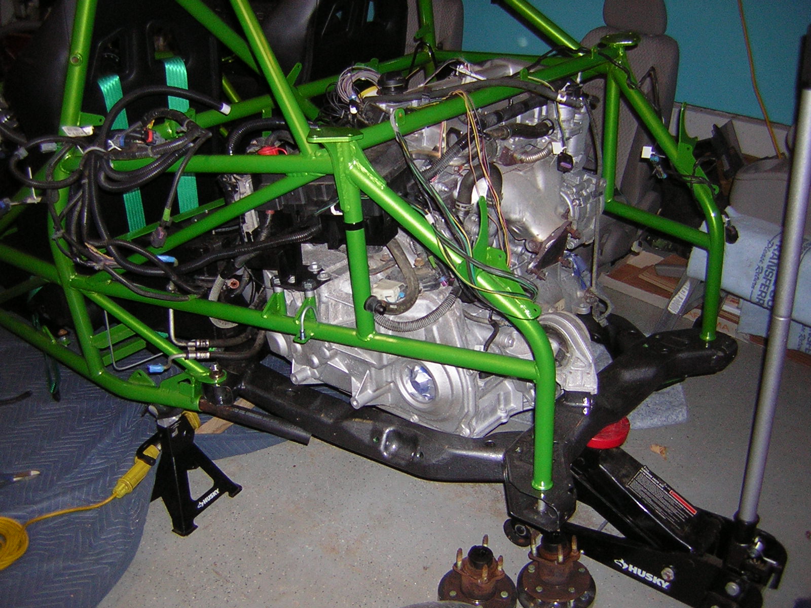

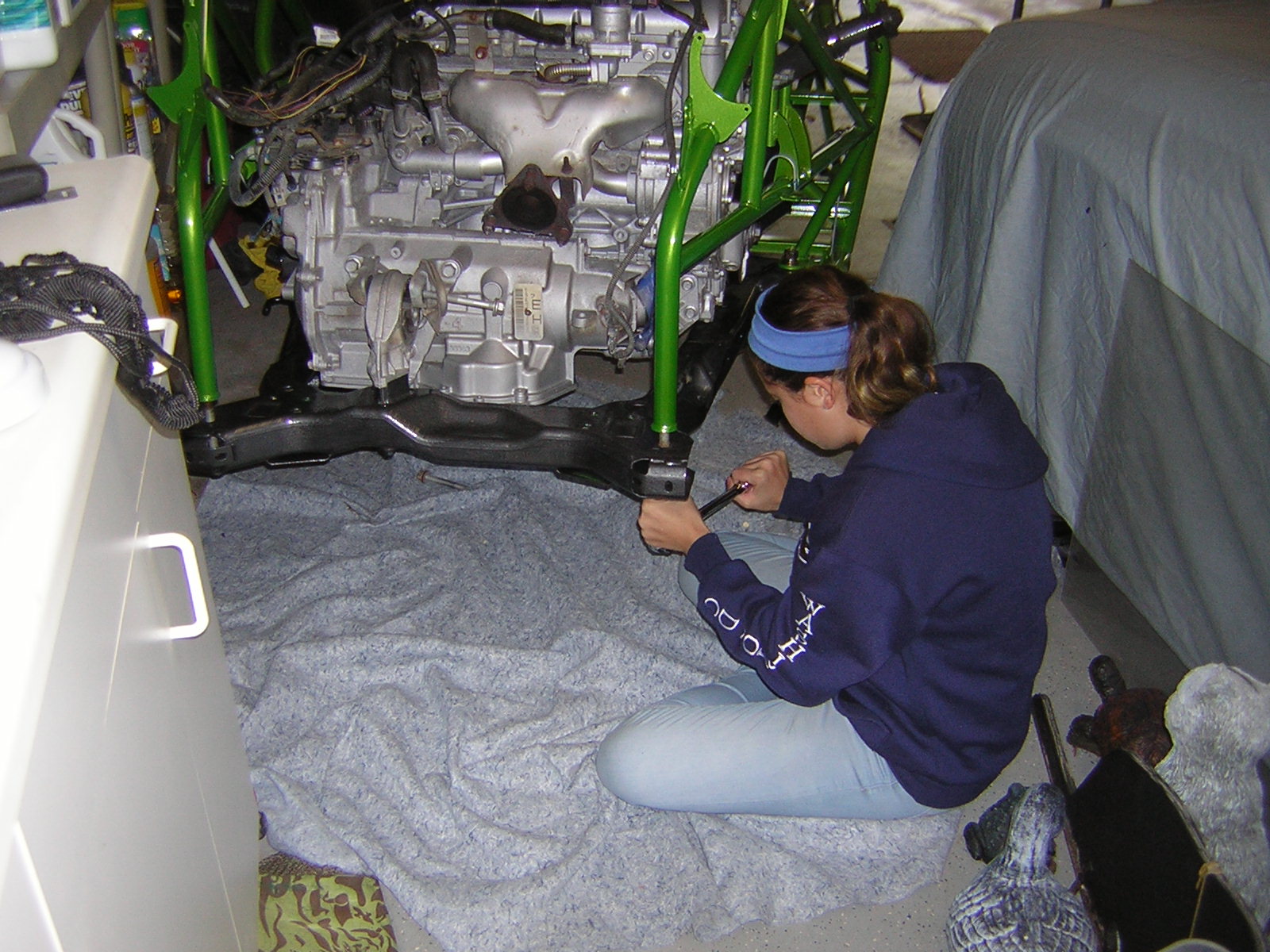

Engine is in! :) I found it was pretty easy doing it this way even though Adam recommended using an engine hoist. I don't have a hoist but I do have a come-along and an I beam in the garage ceiling. First, I zip-tied the front of the frame to a moving dolly so it wouldn't scrape. I then lifted the frame up over the engine and rested it on the jackstands. . Then we attached the mounting plates to the frame. I lowered the frame onto the engine while the girls pulled the stands out. Then we attached the 6 bolts on the engine and tranny. When we bolted on the subframe, we lifted the whole thing up as shown in the picture and rested it on the jackstands.

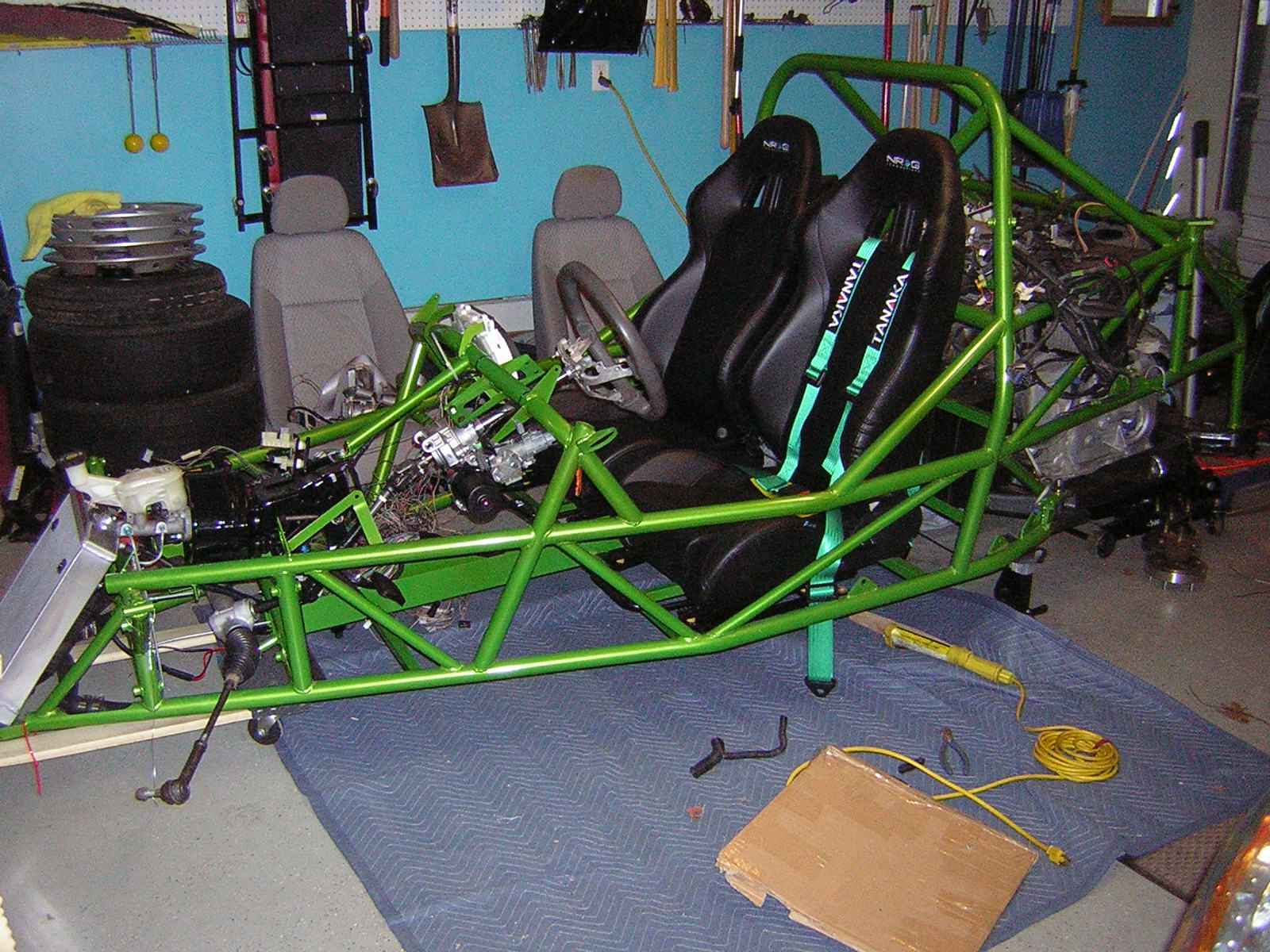

Seats came in; they are loosely bolted in place.

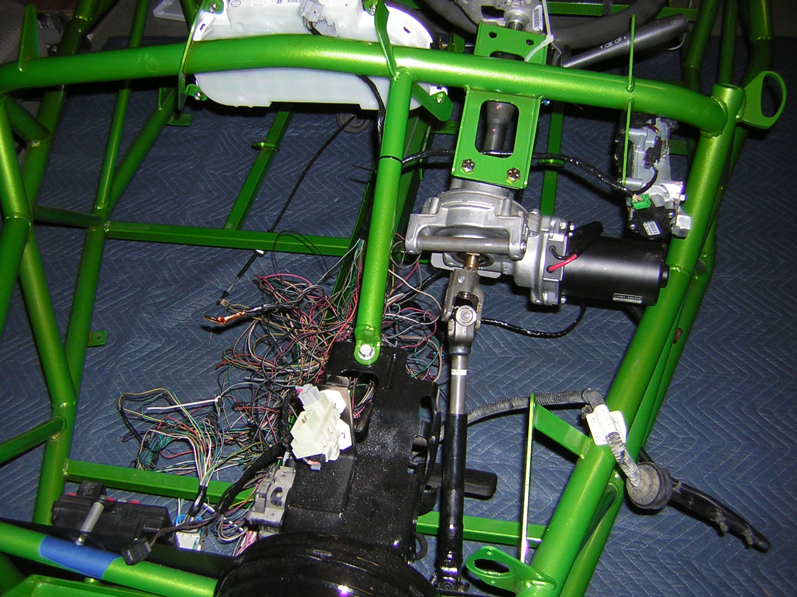

Most of the electrical is done; fan wires (used a 2 wire trailer plug so it can be disconnected), shortened starter wire, grounds, battery wires.
I will have to leave the rats nest of a front harness until after the car is running. I didn't do a good job keeping the harness taped up when we started stripping wires out.

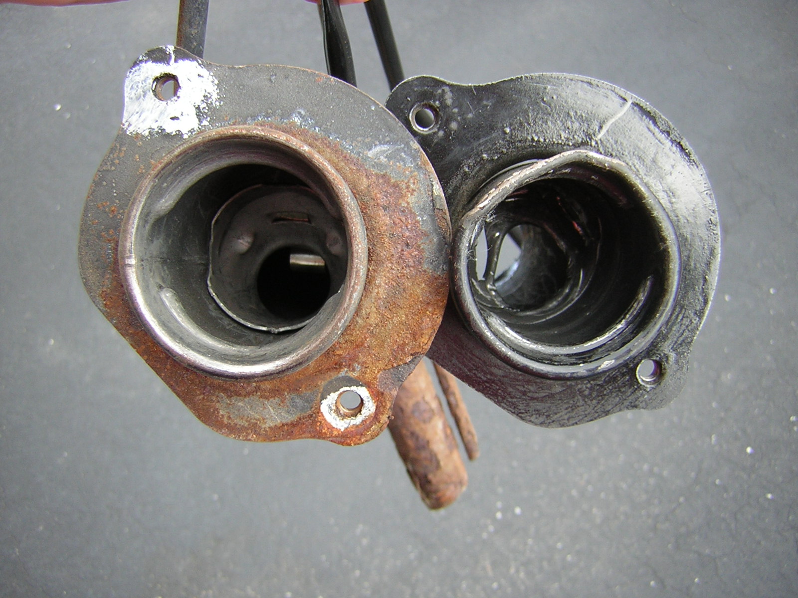

Meant to post this sooner. My donor's fuel filler neck (on the right) has a different type of baffle that can't be knocked out. I beat on it and ended up deforming the threads for the cap. I went to the junk yard (left) and that type pops right out.

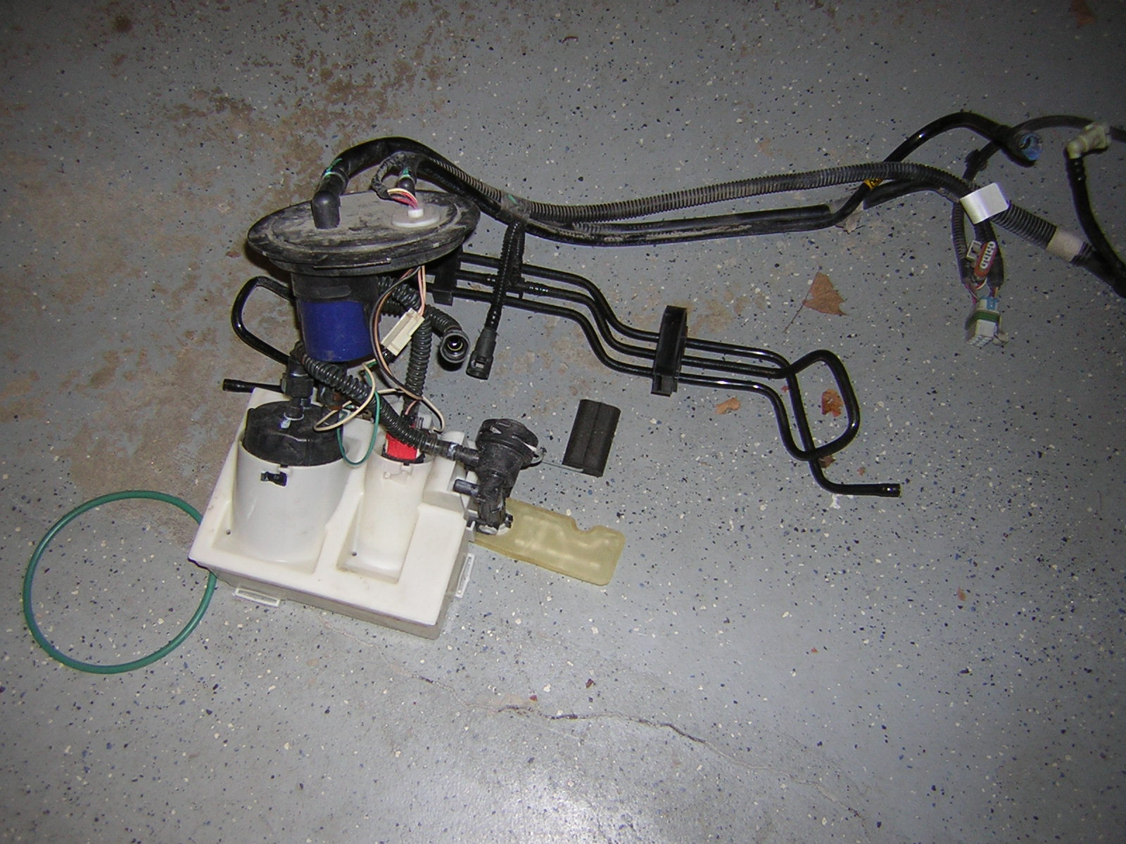

Do I need to buy a new fuel pump? This is the one from my donor. I had to cut up the tank to get it out.
EDIT= I just noticed the assembly instructions; I do have NU6 on the trunk label.
I clicked on the Rock Auto link; it brings up 6 different ones for 2010.
If I change it to 2007 2.2 one of the pumps is SPECTRA PREMIUM/COOLING DEPOT SP6015M for $130. It's lists Alternate/OEM Part Number(s): 19152750, 19152752, 19168894, 19177326, 19257126, 19257138, 88967307, 88967310, 88967312, SP6618M
Will this work?

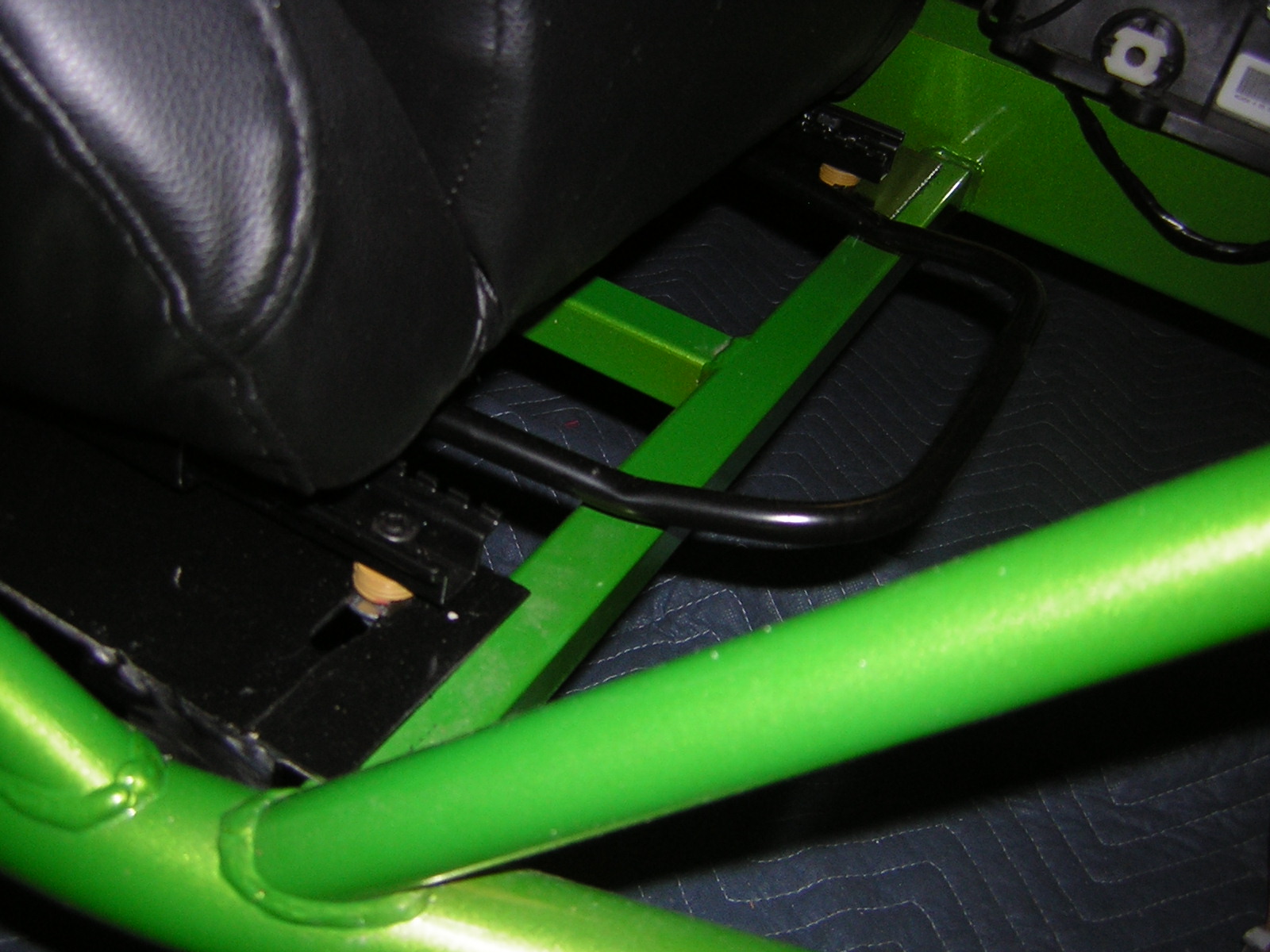

Here's how I modified the cheap seat brackets from eBay. I welded on a piece of metal on the top of the front bracket to keep the adapter from dipping down when you lean forward. I also added 5 washers between the slider and seat bracket so that the bar wasn't resting on the green brace. Seats, sliders, brackets, and 2 harnesses came to $420.
