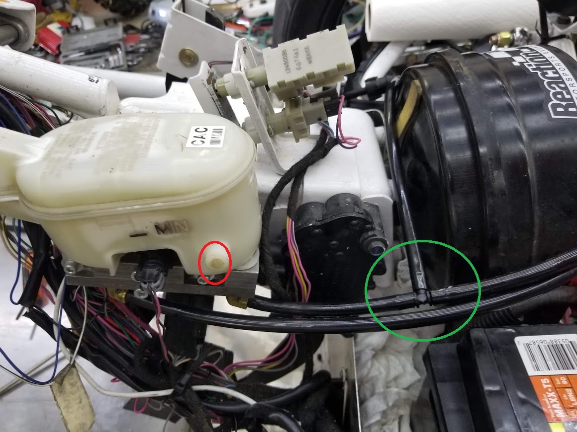

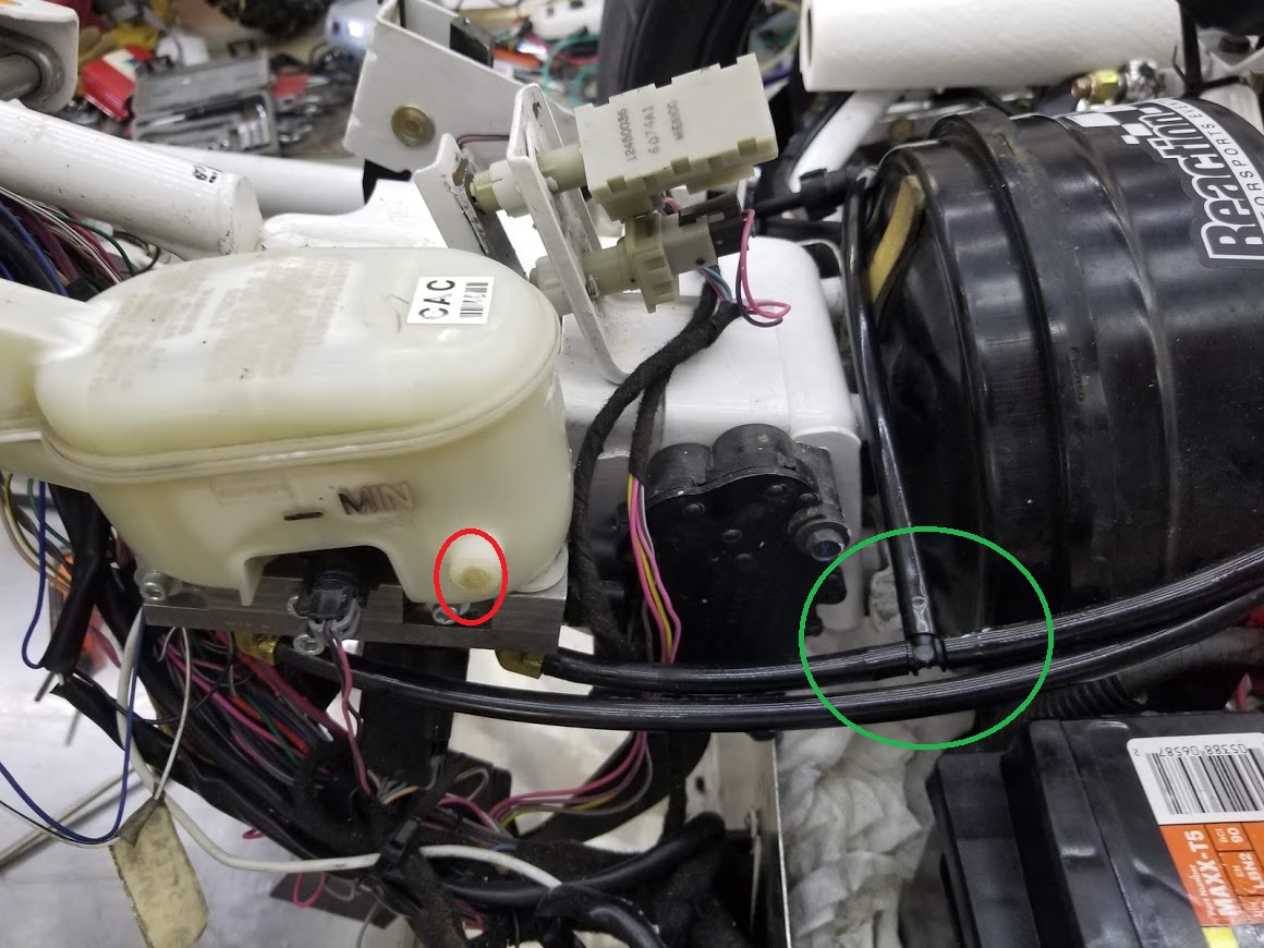

The brake/clutch reservoir suffered from a bent nipple where the clutch line attached,
so I cut it off (red circle) and plugged the hole with 5 minute epoxy,
and then tapped the clutch into the rear brake supply line. (Green circle)
This is a common problem, but I am testing whether this is an acceptible solution. update: (3 years later, this is still working well.)

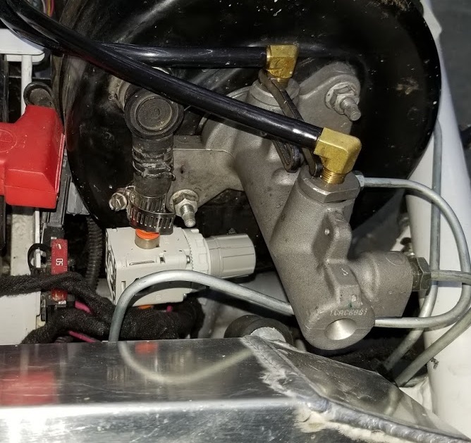

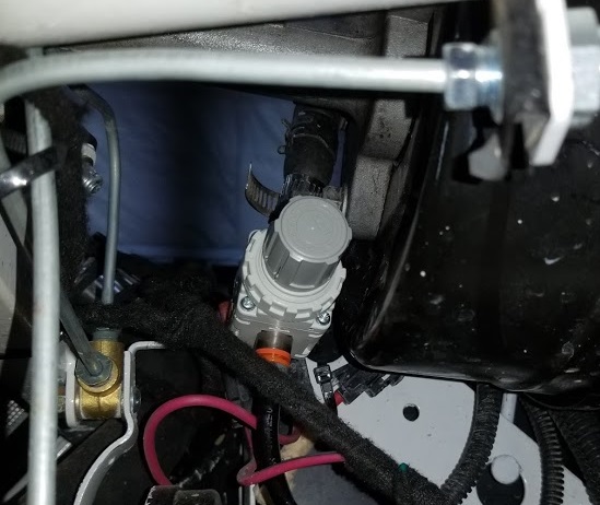

I added a vacuum regulator (SMC vacuum regulator IRV10-N09) ahead of the brake booster. Now I can use a lot more brake pedal before the tires lockup, and can adjust how much boost I want.
This is a common problem, but I am testing whether this is an acceptible solution. Opinions?
Thats a great idea. I may have to do the same because I think mine is damaged as well.
It has been ~2 weeks since the repair, seems to be working well. After emptying the brake reservoir, I cleaned it with brake cleaner, then scratched it a bit inside the hole with a round file, to give the epoxy something to bite into. I soaked a small wad of paper in epoxy, to plug the hole.

Not to speak for Ross but when I installed mine I adjusted until no assistance then added some, drove up and down the neighborhood testing the brakes, then adjusting until I liked the feeling and stopping power. I don't have a gauge on mine.
I don't have a gauge either, but I did what DCMoney did... just drive and test it, adjust it accordingly.

Today, I re-installed the seat belts, and they retract much better now. Also need to add more brake boost.

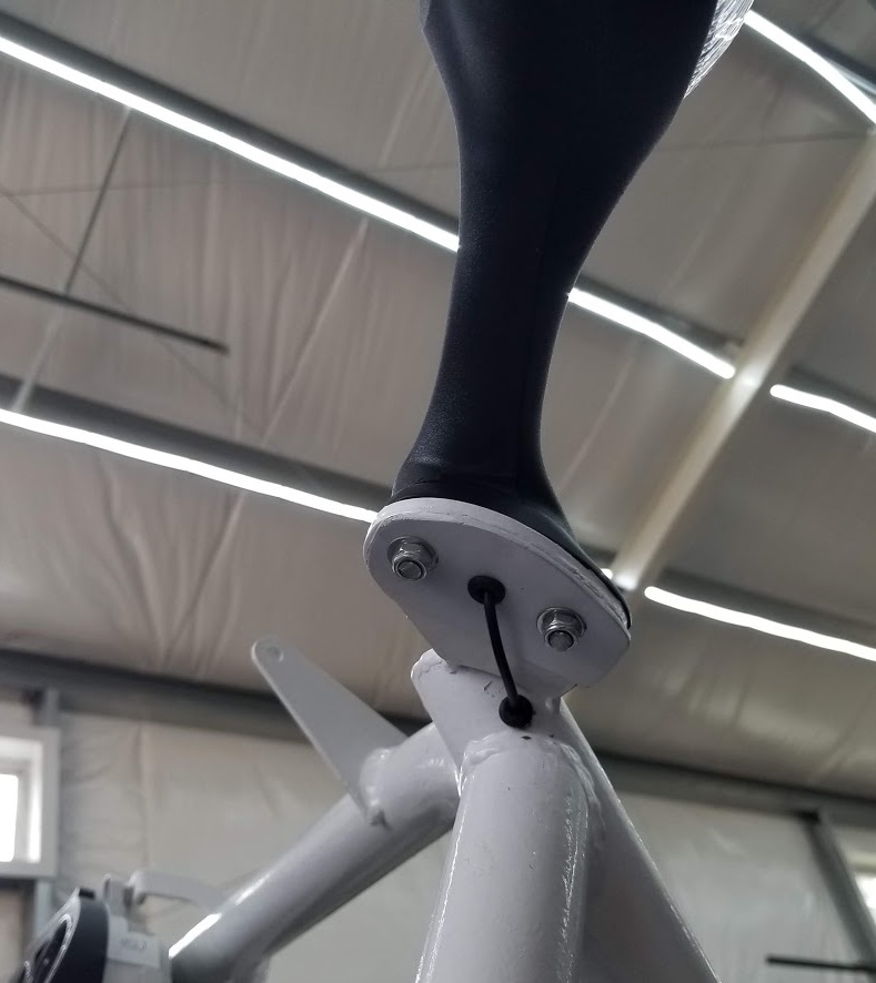

Replaced the passenger mirror/turn signal, and decided to run the wire thru the frame, and add 3 grommets.

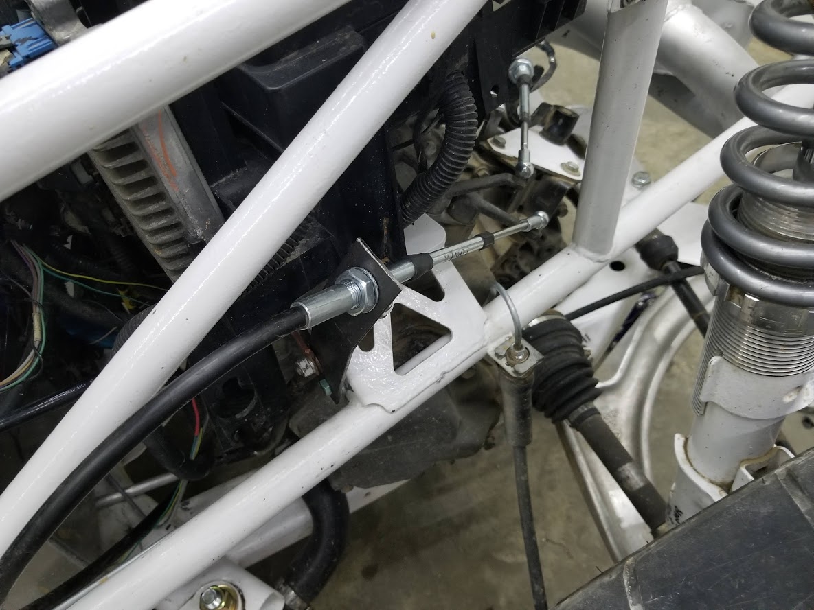

Then moved on to making a new transmission cable mount.
It has a good angle, but the mount isn't rigid enough yet, and it is outside the frame.
10762
It needs more work, but for now, it will work enough for a proof of concept for the new shifter.

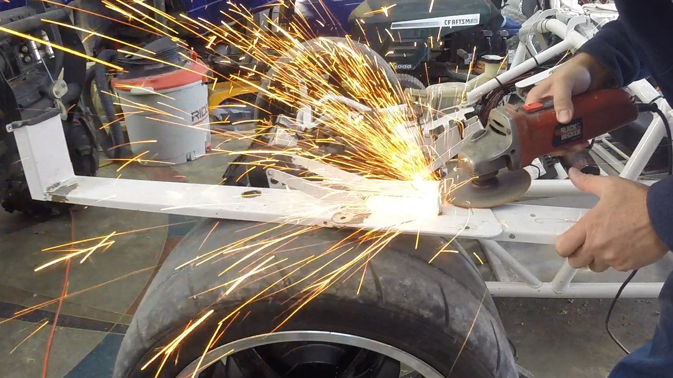

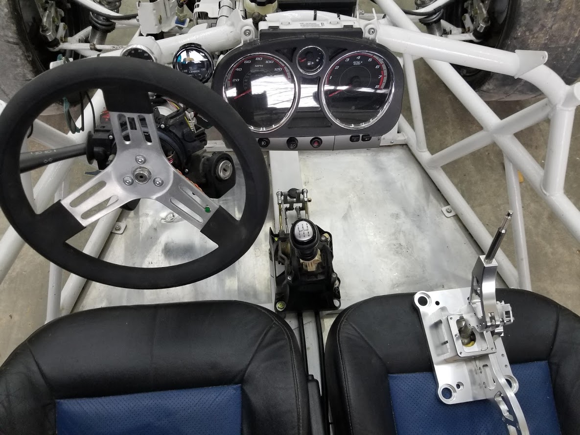

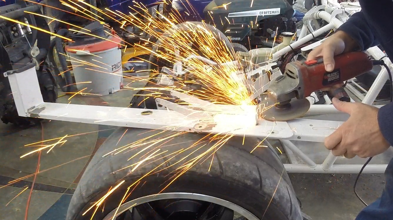

Today I took the tunnel cover off, and cut off the DF shifter cable mounts.
Guess I am committed to the new shifter now.
I am keeping build footage so I can make a video once I have completed the new RSX shifter... hopefully it will work!

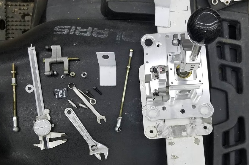

My rod ends came in to a local motorcycle store, but they aren't the correct ones, so I am ordering online myself.
Turns out that the rod ends I need are custom. The DF cables have M6x1.00 threads, and the RSX shifter is made with 8mm shoulder bolts.
So I did a bunch of measuring, and figured out a new plan. I am converting the RSX shifter over using 6mm shoulder bolts, and can get 6mm rod ends for the DF cables. I have to wait a week for these parts, :(
Female, Rod End, RH, 6mm ZORO #: G6221135 MFR #: MCFR65.43210.86
Female, Rod End, LH, 6mm Zoro #: G917107516.46
Shoulder Screw,6mmX12mm,M5 x 0.80mm, PK5 Zoro #: G083030413.49
I did get a new knob. It is buffed, and polished, it is perfectly smooth, made of carbon fiber. One of the 3 thread adapters worked for the M10x1.5 shaft on the RSX shifter.
