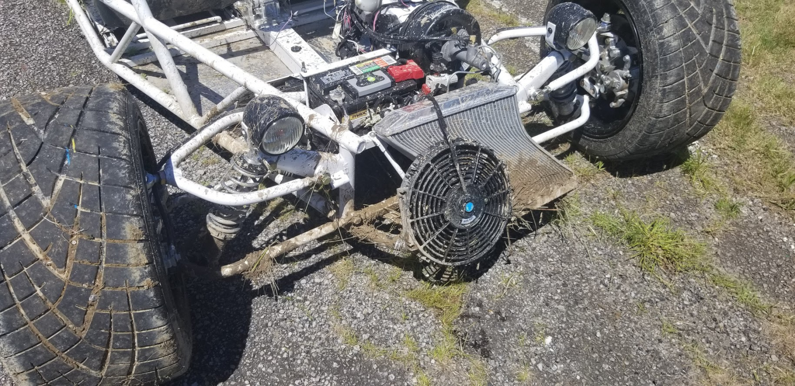

Before and after pictures. 24 hours.
The radiator got a diagonal squeeze in the press, and it holds water and pressure. The radiator support got untwisted some too.
He seems happy that it holds pressure. We took it out for a test drive to make sure there wasn't any other surprises like a wheel alignment issue.

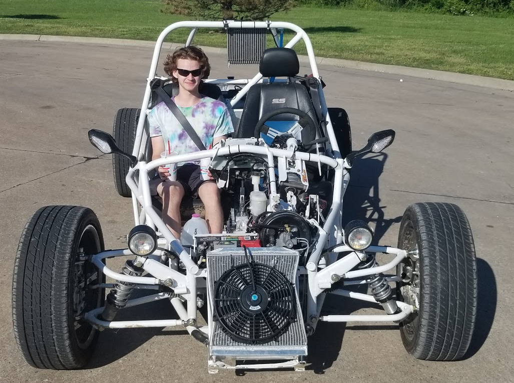

I still need new parts, but these would work in a pinch. Need to put the good tires back on. 2020 Midwest meet is on!

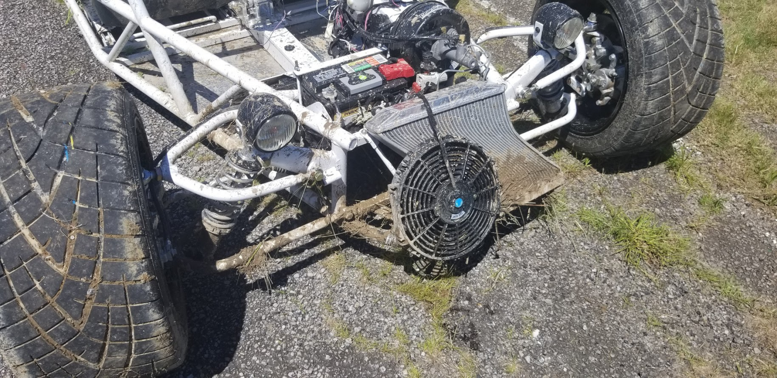

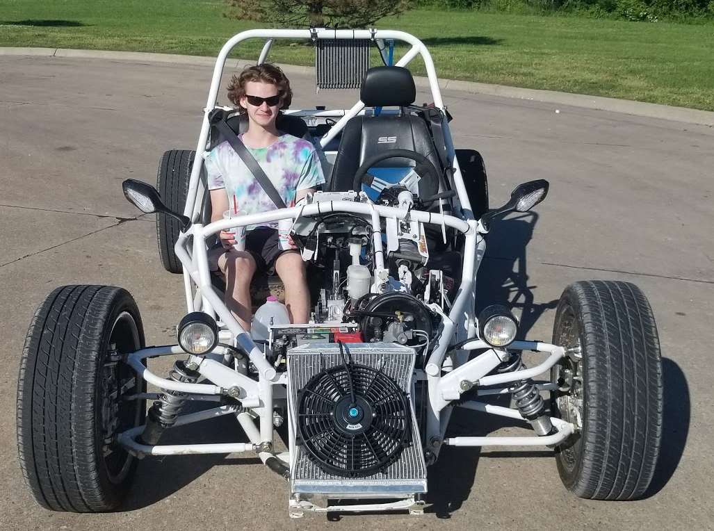

You missed some mud with the pressure washer. :D Cup holders you need cup holders for him!
Yeah, it got a long pressure wash. Ian said when he hit the mud at the bottom "There was a wall of mud in the air, then I went thru it".
I pulled 30 pounds of mud out from under the radiator, 20 more pounds from the rear wheel.
I does need another wash... lol

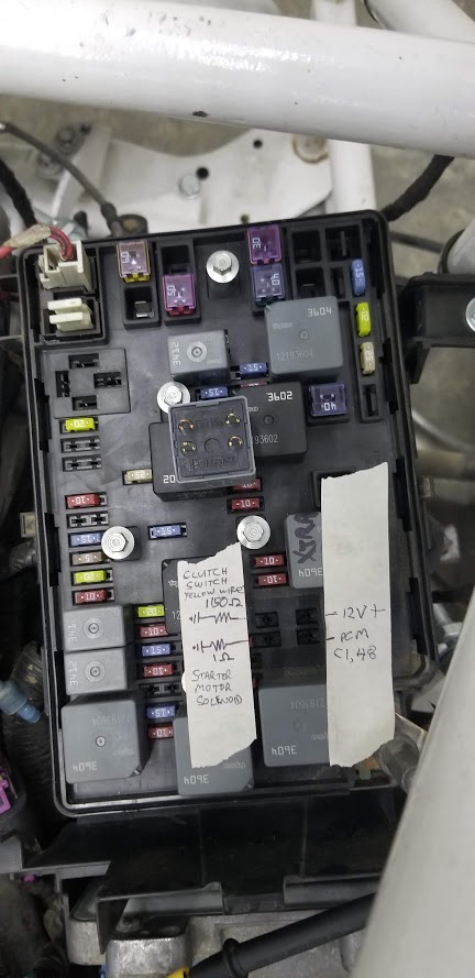

Do these things in the fuse box without any cranking:
1. Pull the crank relay.
2. There should be one pin that is connected directly to ground and should read < 5 ohms.
3. There should be another pin that probably won't be a dead short, but should maybe be like 200 ohms to ground. This would be the purple wire.
4. There should be one pin that constantly has 12V on it.
5. Once you have those three pins mapped out, check the continuity of the final pin to ECM X2/57.
Take a picture of the fuse box, label what you see, and post it here.

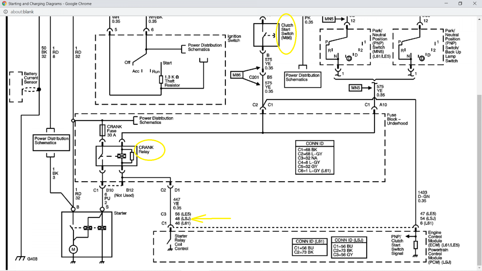

Brian, since I have a similar problem to Ark, I am following your directions for my 2006 LSJ.
15090
Here is the wiring diagram for my LSJ starter relay:
15093
I found a new clue while checking fuses and wires.
The car will start when I wiggle or pull on the key when in the crank position.
I need to take apart my ignition switch, and repair or replace it.

Ross: Why did you choose to mount the fan on the front of the radiator? I assume it is an aftermarket pusher and not the DF supplied one just swapped to the front and reversed?
