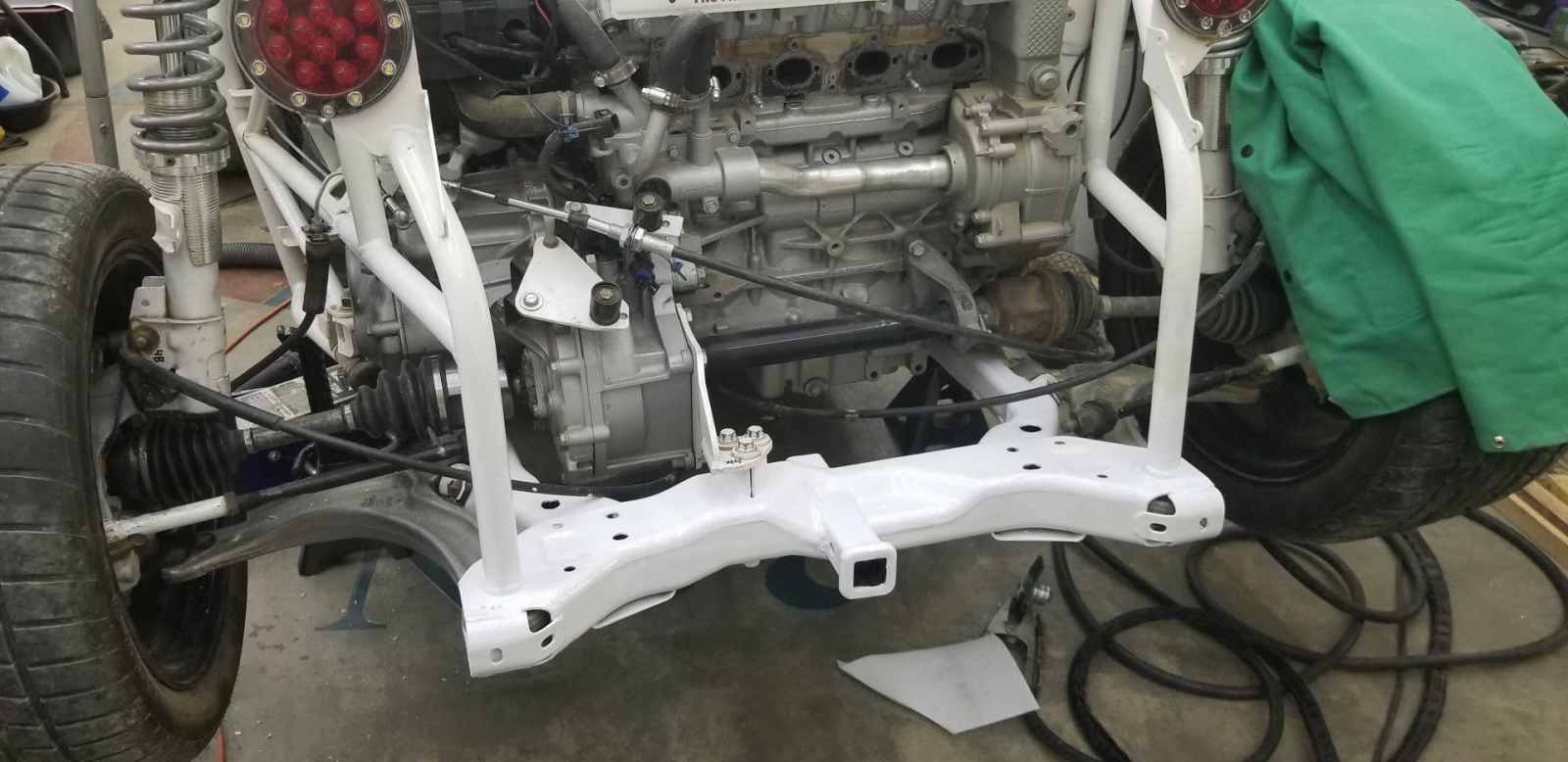

Not winning...

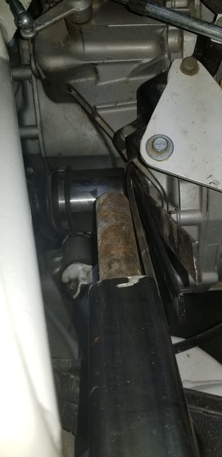

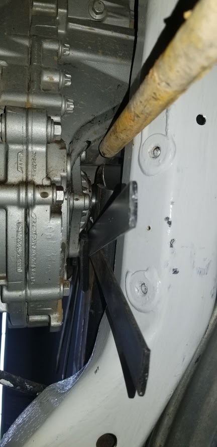

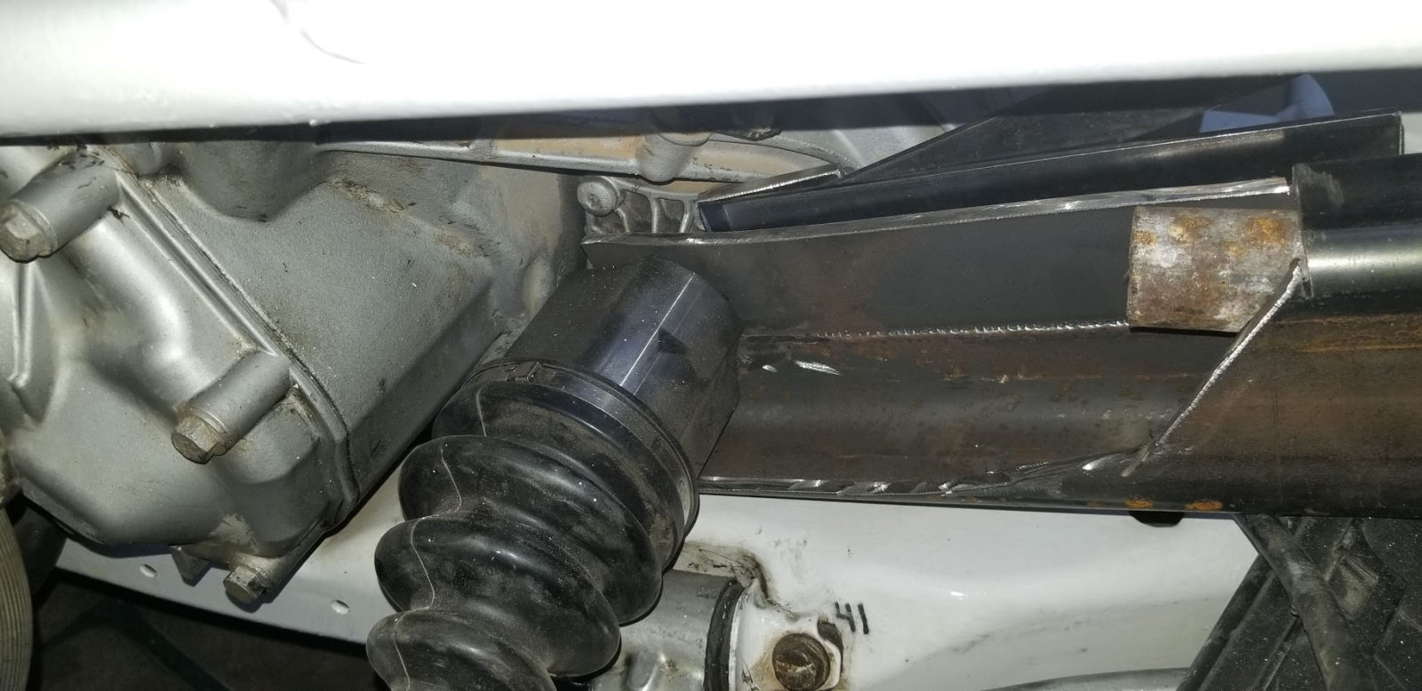

The new axle went 90% the way in. About 1/4" more to go, and then it stopped. Won't go forward, won't come back out.
I tried using a lever to pull it out. It bent the lever.
Today I made some 1/8" shims, and tried to get the axle out. Still stuck.

It's always been my limited experience that no matter how much prying you do, they don't like to release with prying. It seems the only way they go in or out is with a swift yank or push. But I'm sure you have tried that.
I haven't tried a yank to pull it out, as the axle is only connected with a rubber boot.
So I need to pull from the triangular bucket near the transmission, which has a rounded base, making it difficult to hang on to.
ncgoblin
Have you tried an axle remover tool? This is what I use and it comes out first slide tap. I believe you can rent them from autozone or advance. After using one I will never go back to a pry bar causes no damage to the exterior of transmission.
Thanks guys. No, i didn't know about this tool.
Glad to have a new direction, as I wasn't winning with my current approach.

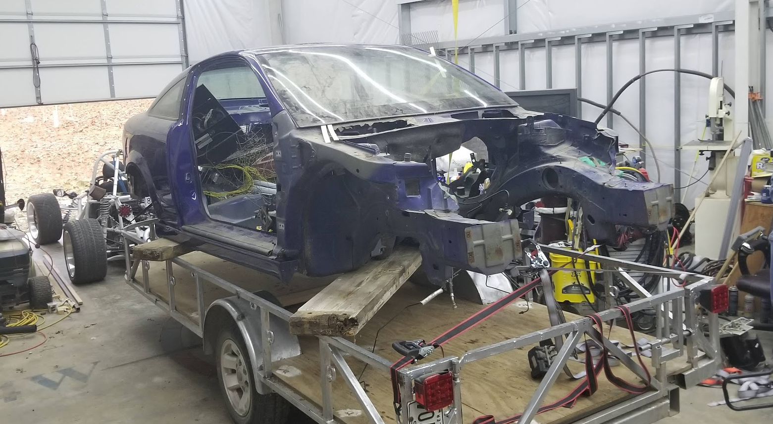

Scrap metal is selling for $100/ton, so I got $53 for the old blue shell, and a trunk full of junk metal that I have put in there for the past 2 years.

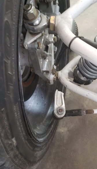

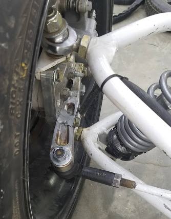

This morning I aggressively whipped the back end around, and the front tie rod mount broke. Didn't hit anything. (Of course it did survive a few off road excursions during an autocross event, so maybe it was pre-weakened)
18018
18019
A closer look at the break point, and there just isn't much metal left there after the DF milling machine lightened the part. The guy who won Matt's off road DF Goblin also broke this part, so I am not the first. He mentioned that DF makes this part extra beefy, without the extra lightening, so Adam, if you are reading this, I need two beefy ones too!
Luckily I own a TIG welder and milling machine, so I got a free ride home from the guy (Mike) who I was giving a ride to, I picked up my tow vehicle, an hour later, I welded and milled the part. Mike gets his Goblin ride at 5:30 today, so I better adjust my tow in now.

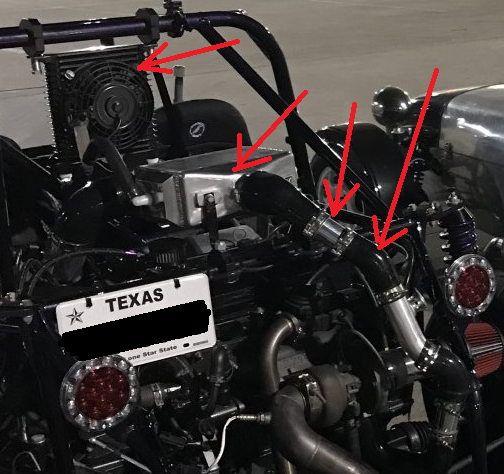

Anybody have turbo intake parts they want to part with?
I am collecting turbo parts for my LSJ, and need a A2W intercooler, radiator, intake charge aluminum pipes, silicon pipes and clamps.
Let me know if you have parts you're willing to sell me. 479-640-9941
