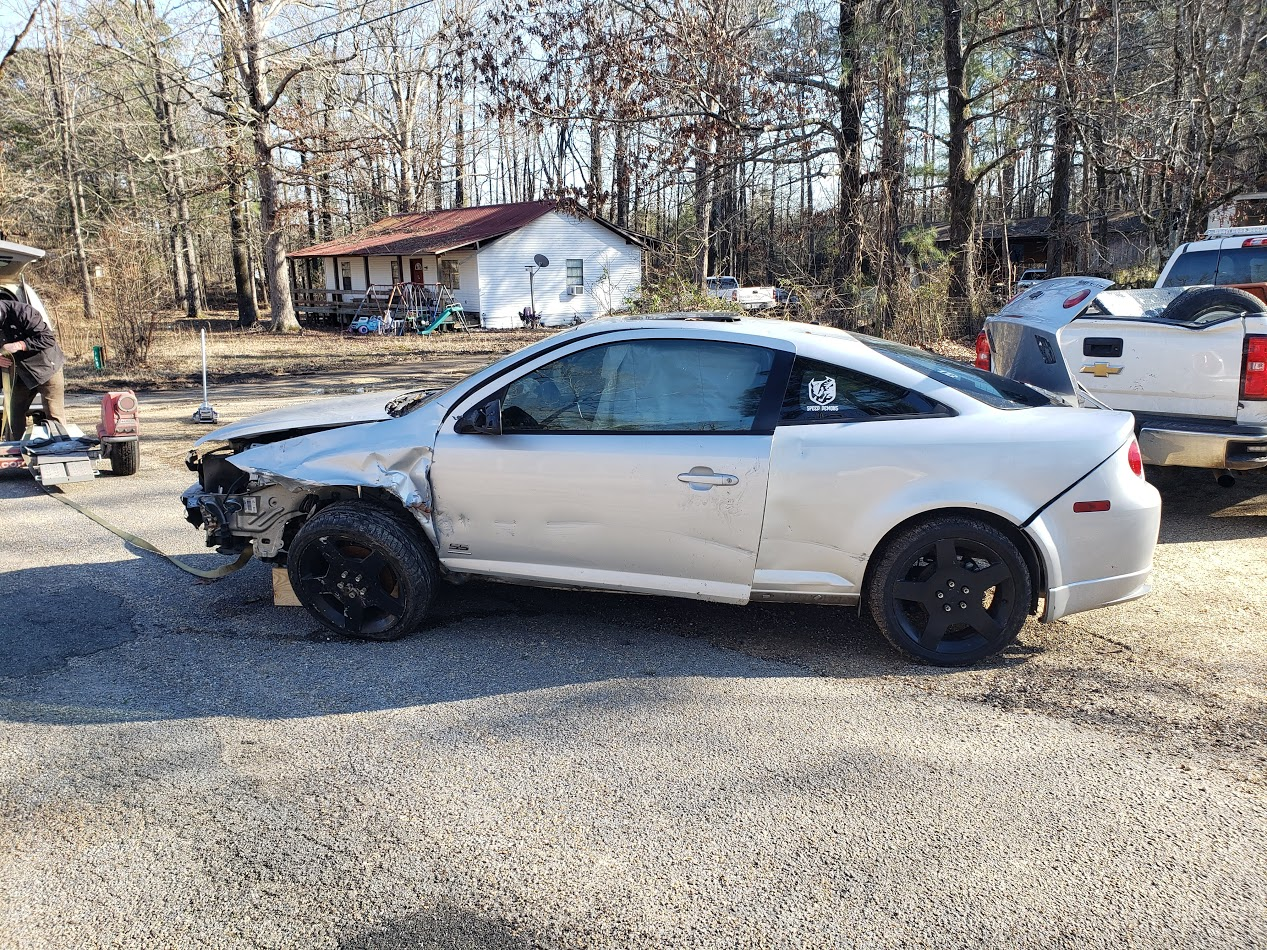

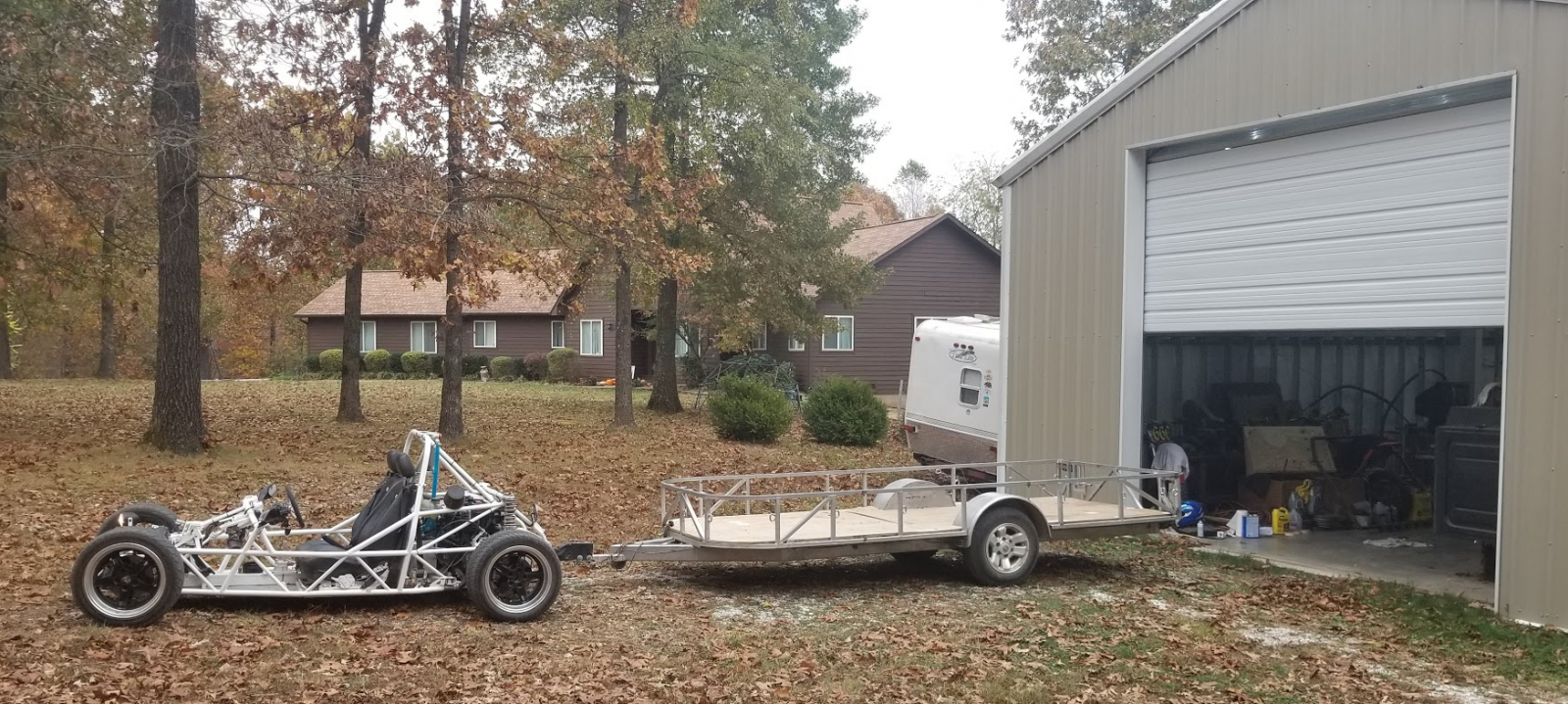

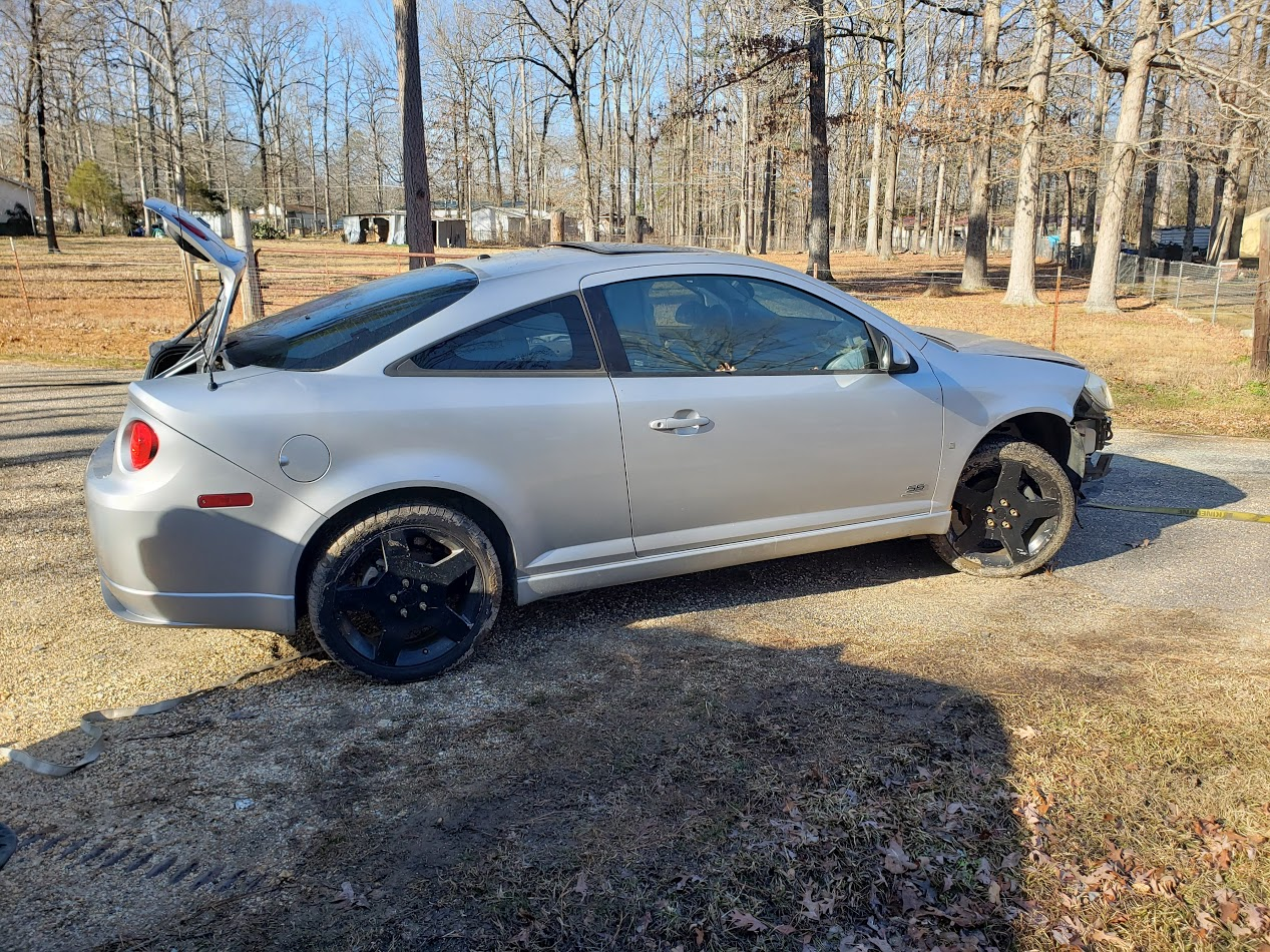

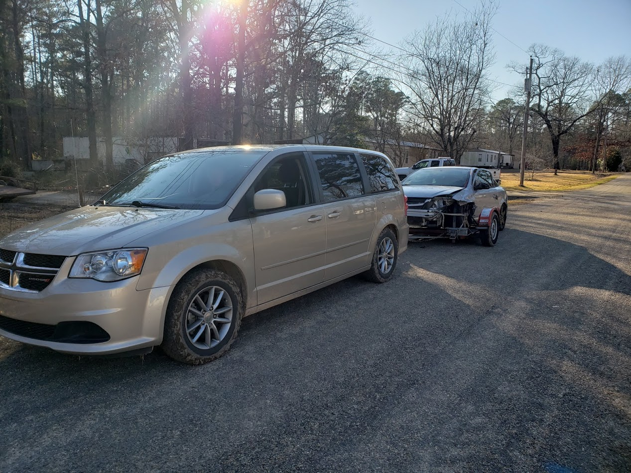

This one side swiped a boat trailer, blew the airbags, bend the steel?! front swingarm, almost tore the whole front wheel off.
It is a 2006 SS SC LSJ, 144K miles, with Recaro seats, but it shouldn't have steel swingarms. Cheap fix for worn out swingarm rubber? Accident #2 for this donor? The engine runs and the transmission shifts. It was $900, but a gamble, as I don't really know its full health yet.

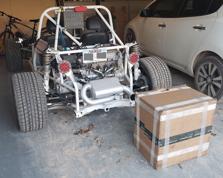

One engine in the Goblin, one engine being worked on in the shop.
Spent the day driving & loading on and off a trailer.

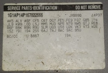

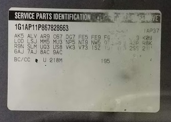

On a bright note, the G85 code is on the trunk tag, as I forgot to check before buying it. I heard that the Recaro seats don't guarantee it has a LSD differential, but this car did when it left the factory.
Here is my original donor's trunk tag:

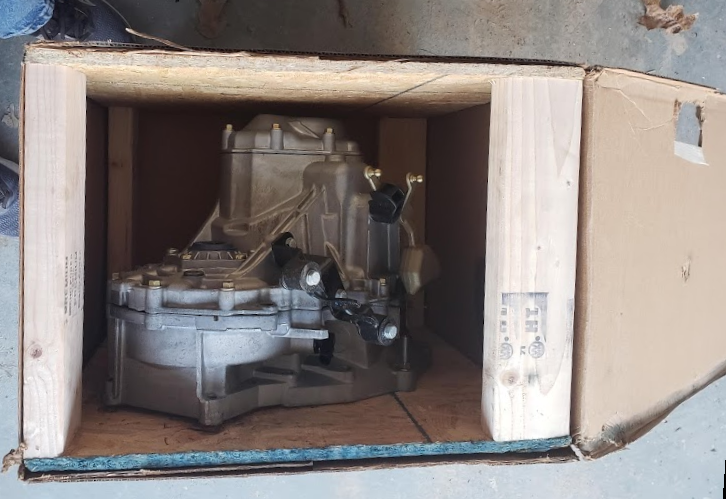

Oh, and this arrived today. Pretty heavy box. Guess my winter's work has arrived. No more leaky, stuck axle, with worn syncros, and an open diff.

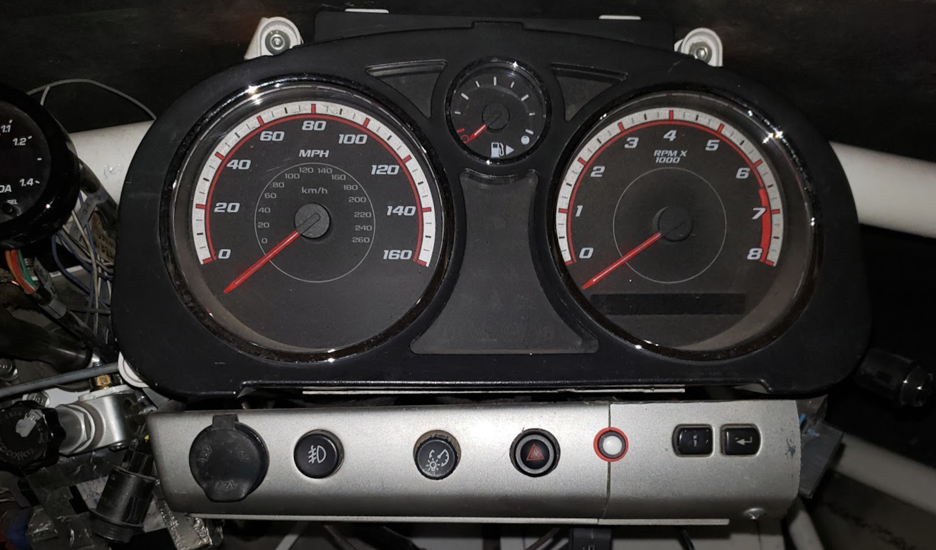

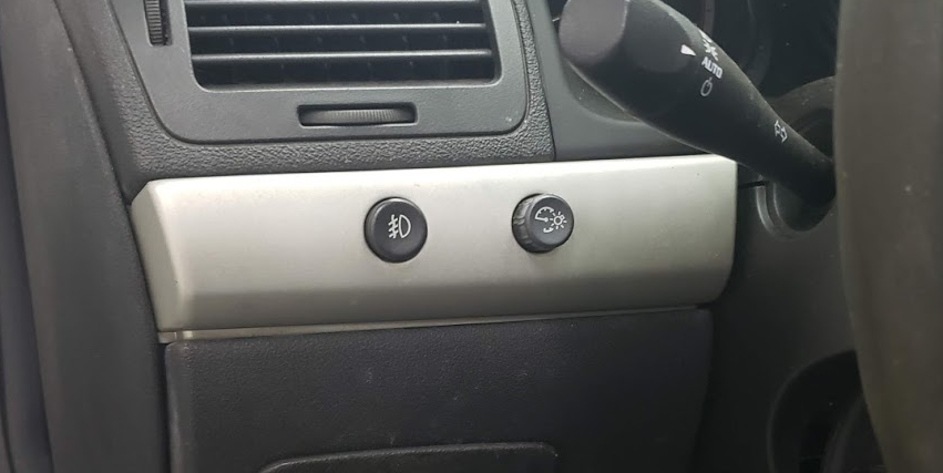

Documenting my cheap button panel, that used the stock switches from the Cobalt donor.
46751
The 7 controls are:
- 12v accessory plug
- fog lights switch on the Cobalt goes to the purple accessory wire
- dash dimmer dial
- emergency flasher switch
- horn

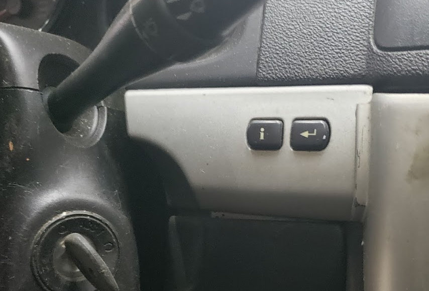

- info button
- return button

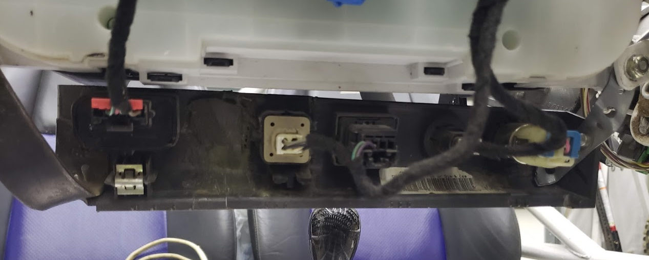

I repurposed the Cobalt button panels on the left and right of the steering wheel.
19985
19984
I cut and epoxyed the 2 panels together, adding a 1" strip of spare Cobalt plastic to the back to strengthen the joint. Then drilled 2 extra holes, for a Cobalt 12v accessory plug, and the Cobalt emergency flasher button.
19988
The strap on the left was a 1" steel flat bar that goes up to the gauge panel bolt. The right side was an attempt at a light weight steel strap, but was too wimpy, so I need to go back and use a heavier steel strap like the other side. Then I drilled thru my custom button panel and the steel flat strap, using small button head bolts to hold the plastic button panel to the steel straps. I could have used epoxy there too, but didn't want to until I had done more testing.
The right panel with the info and return buttons was a little taller than the other side, so I sanded it down to the same height as the other side.
I probably should have bondo'ed it, and painted it white, but never got that far, yet. The Cobalt buttons had custom plastic mounts, so by re-using the stock button panels, I was able to keep the stock mounts, and didn't have to connect wires to new switches.
I originally put my horn button on the clock spring and then the steering wheel, later I got the DF quick release steering wheel, I added the white momentary switch for a horn.

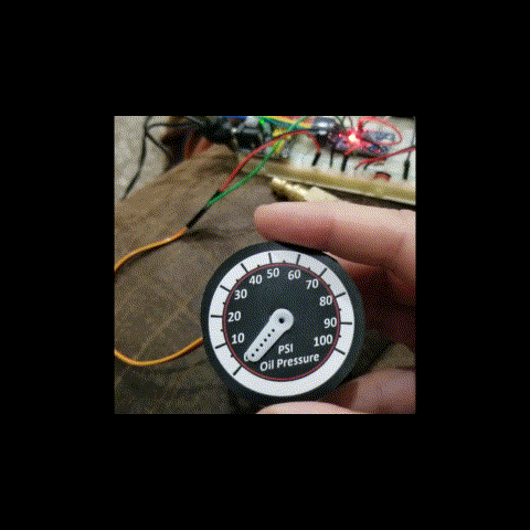

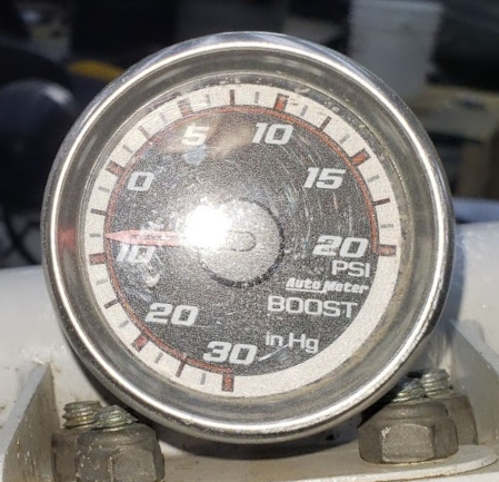

Anybody interested in making custom gauges? I would like a 3D printed part, and need that skill set. The custom oil pressure gauge is accurate to a fraction of a PSI. Amazing. Now I have ordered the parts to make a custom fuel pressure gauge. It will match the custom oil pressure gauge, and I noticed today that I should make them all match my stock boost gauge. I have 3 more 270 degree servos for more custom gauges... suggestions? I was thinking intake air temp as one of them.
20181

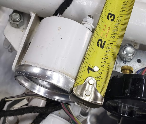

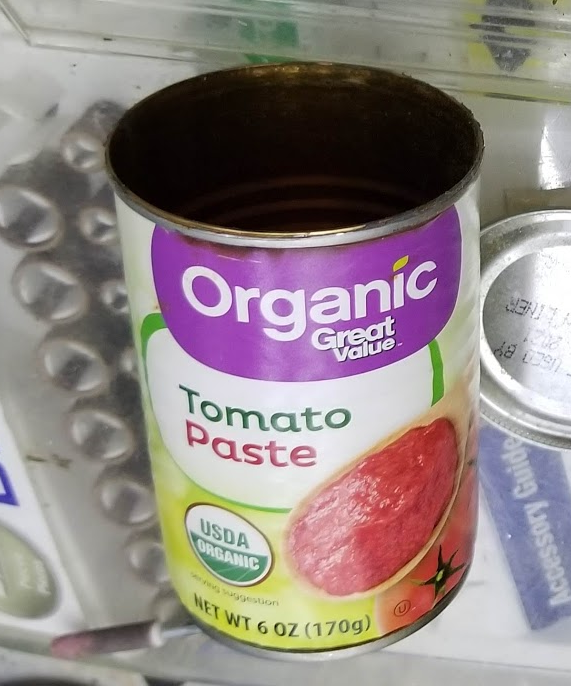

The boost gauge has an aluminum? ring around the faceplate that is 3/8" deep. The ring for the custom gauge would need to fit over a 2" tomato paste can once it is cut down to about 2" tall. I think I will glue the front ring, clear acrylic and tomato can together with some caulking adhesive. I could make the front ring on the metal lathe, but I wonder if a 3D printed black PLA ring would work just as well, but be repeatable.

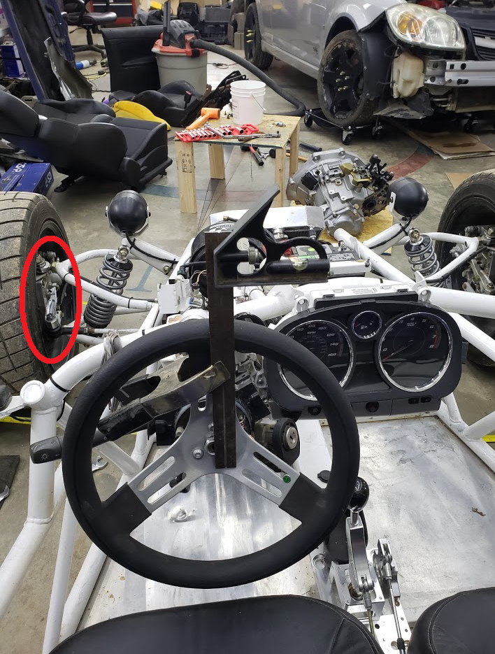

Today I replaced the steering arm with a new one (from the welded one I did a quick fix on), and adjusted the tow in. The steering wheel got centered too. It kept moving on me, so I clipped a level on it, and could easily tell when it needed to be re-centered while I adjusted the tie rods. Took it for a test drive today. Needed a Goblin therapy fix.

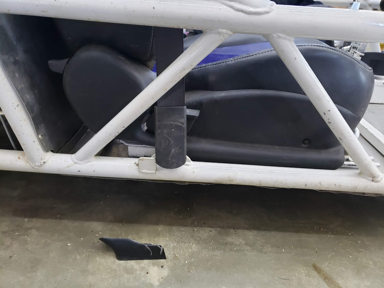

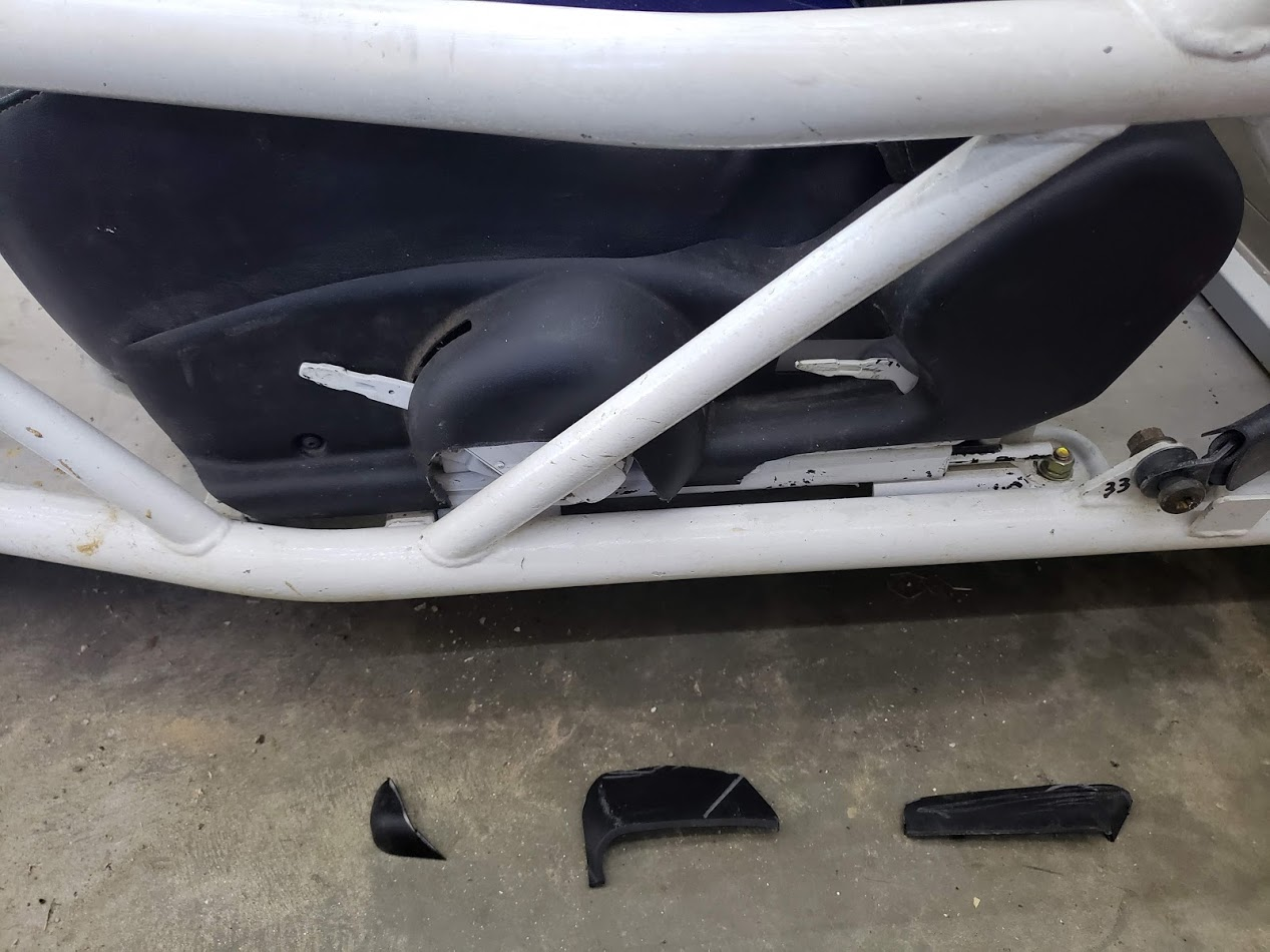

Been cleaning up the Recaro seats, cut down the plastic seat sides to fit in the Goblin. It took 3 cuts on the drivers side, but only one cut on the passenger side. Those little plastic pieces clean up the look of the seats and should reduce the gravel I get in my seat rails from the driveway.

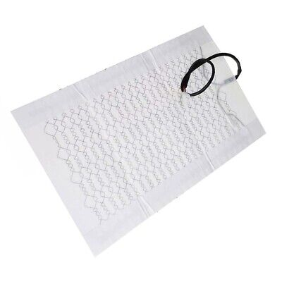

I ordered 12V seat heaters, and I want to repair the seat covers before installing them.

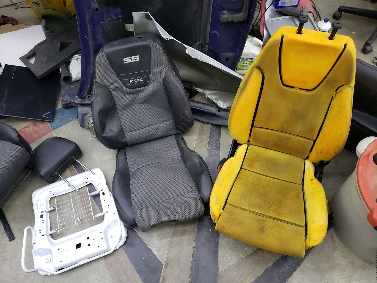

The Recaro seat base frame (I painted white) has side support metal tubes. The SS seats don't have this, and it should help keep my butt from sliding around. Kind of an unnerving feeling in an easy entry city frame with stock seatbelts.
I've never stripped a seat down this far. The black lines in the foam are velcro strips. Pretty easy to take apart.
20238
The only challenge I had was removing the 2 black headrest tubes at the top of the seat. On the seat back, you have to undo the fabric at the bottom, then pull up the fabric about 2/3 the way to the headrest, gaining access the back of the seat, you can release the black tubes from under the foam.
