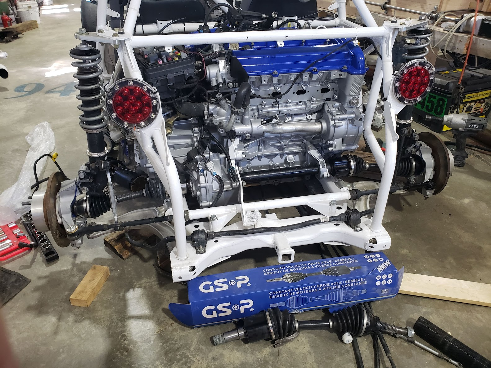

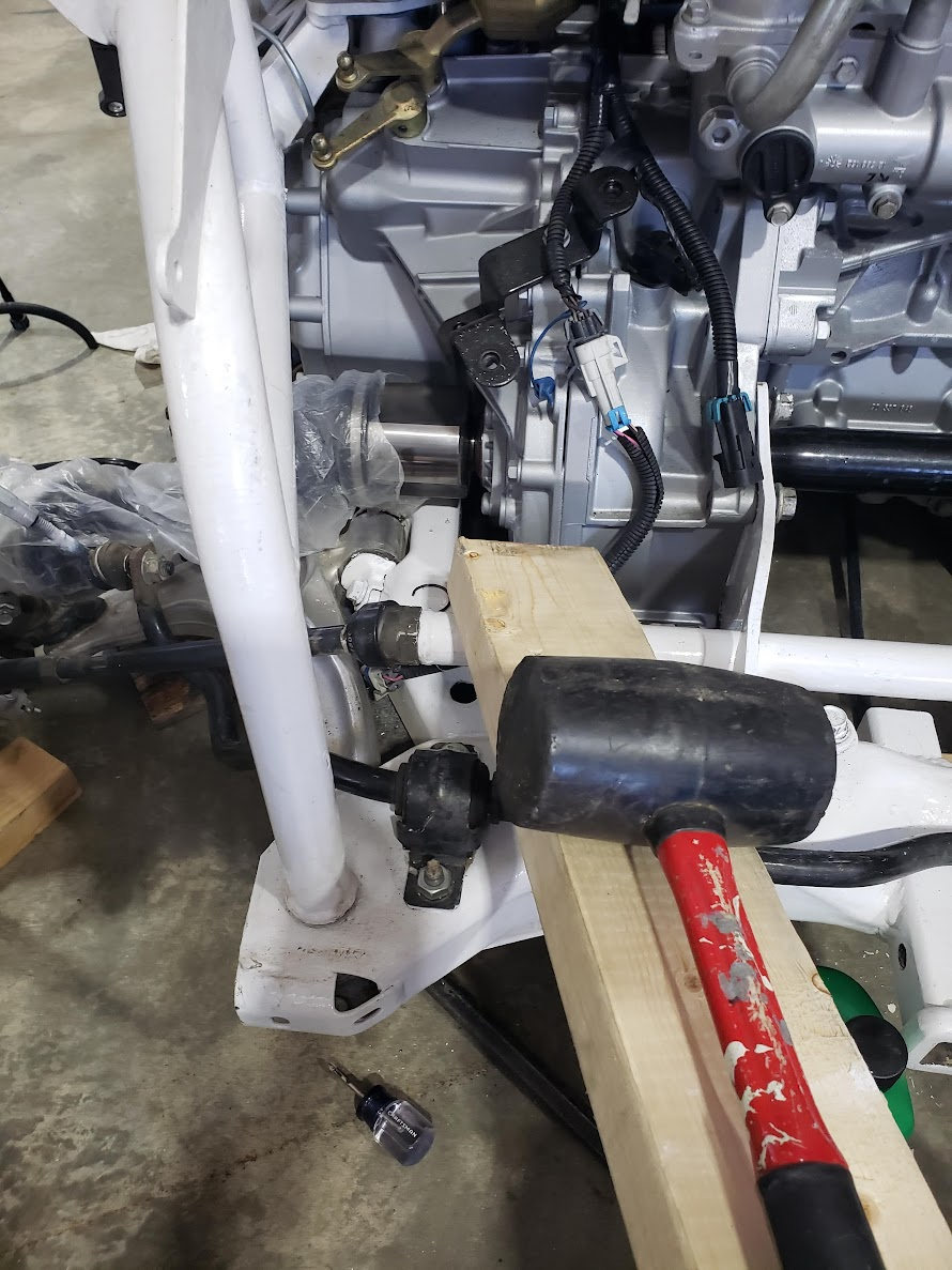

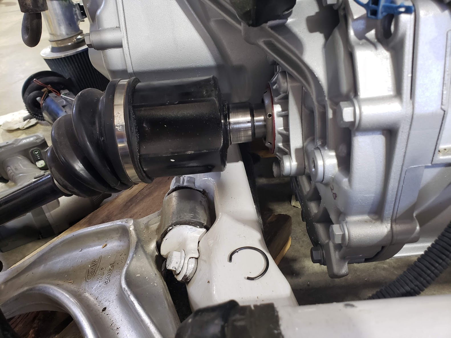

I'm struggling getting this axel in. I always struggle with this step.
Lonny showed me how it is done with a 6 foot pry bar, but my 8 foot 2x4 bar isn't winning.
I thought it was because the clip isn't centered, but even with the clip removed, it still isn't going in.
I'm not even close, and it gets stuck.
46447
So I tried the other GS-P axle, the 2x4 got it a bit farther, but the rubber hammer did the job. This axle never got painted, but I'm just happy it fits.
46448
I will have to inspect this axle's splines to see if there is a dent or something easy to fix, otherwise, it is junk.
I put my used axle back on the right side.
46449
Ross, one trick is to have the split in the C-clip up at 12:00 - at least according to all the old mechanics who share their knowledge in the how-to videos. I haven't checked this myself, but it can't hurt to try this. :D

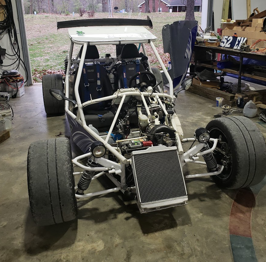

Took the goblin for a good shake down run today.
Before that run, I
- changed the oil in the transaxle. Added crush washers, that I had to lathe to the correct size.
- installed the braided brake lines on the rear
- painted and installed the DF brake proportioning valve in the front of the car (was under the hood before DF made their mount kit)
- vacuum bled the brakes
- topped up the engine coolant
- noticed oil dripping under the car, tightened the oil plug, as it was finger tight. Oops I missed one bolt when torquing.
During the test run:
- put some fresh fuel in it. The newly-bent-float had the gas gauge reading 1/4 tank. The fill up took 7.5 gallons. Maybe I got it bent right :)
- had brake fluid leaking from the proportioning valve. Retightened. Pressure bled the front brakes.
- Adjusted the proportioning valve.
. - It is 10.5 turns in total.
. - All the way out (counter clockwise) is maximum rear brakes.
. - All the way in (clockwise) is max front brakes.
. - After testing, I have it set at 6 turns clockwise from the max counter clockwise.
After the run, I have some things to follow up on:

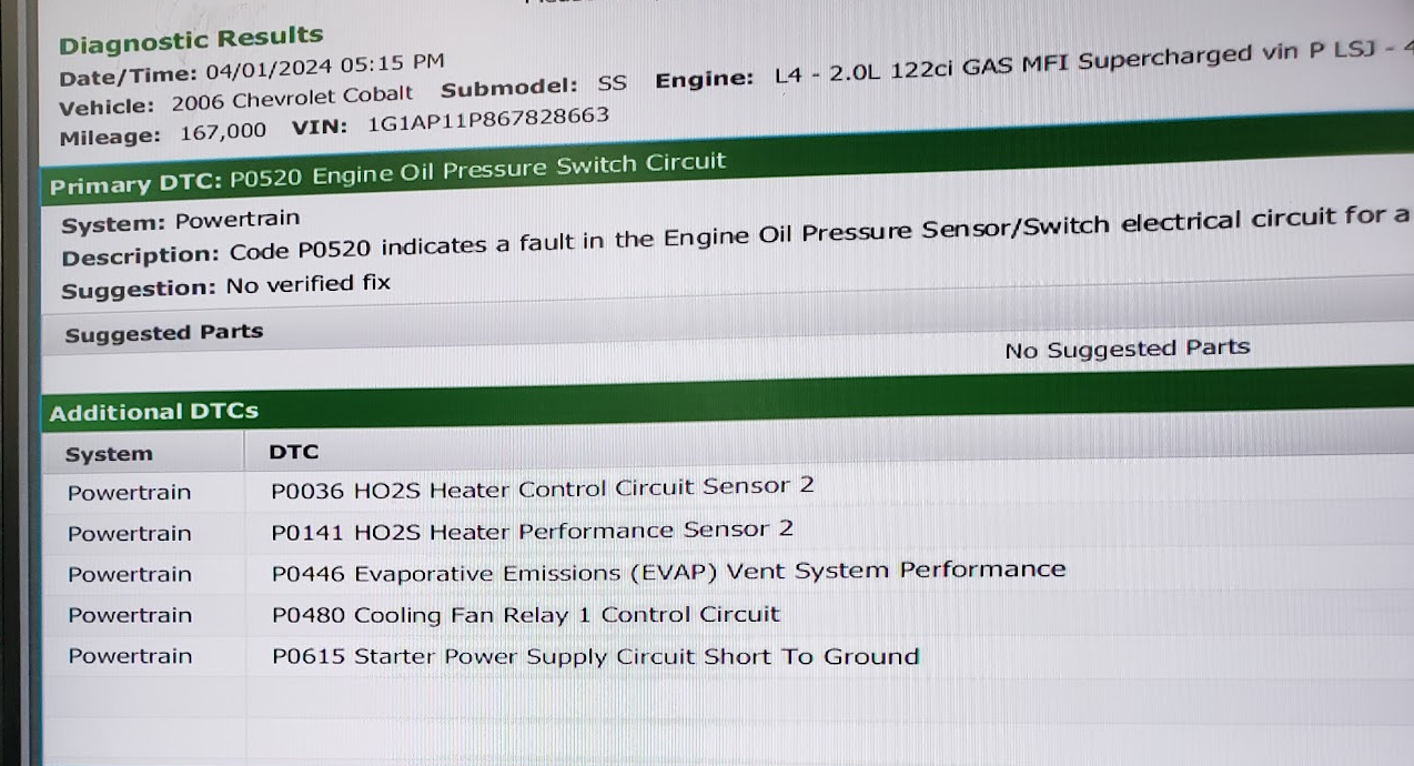

- The check engine light turned on. Pulled the OBDii codes (below)
- Engine oil pressure switch has a broken connector. Need a new one.
- Charge the battery? Maybe that will fix the P0615 Starter Circuit Short., as the battery hasn't been used all winter.
- Cooling fan works if I jump the relay, but the ECU signal isn't throwing the relay when I turn it on in HP Tuners. Need to debug.
- The battery tray has some corrosion. Need to neutralize and repaint.
- install the hood.
- Buy new tail lights as one of them is down to 3 LEDs, the other still has all ~12 LEDs.
- The clutch is slipping if I abuse it. I think I will move the GMPP clutch from the other engine to here, and buy a puck clutch for that engine.
- The fuel system isn't holding pressure after the key is turned off. I don't see any fuel leaks, so it is either leaking past an injector, or leaking into the fuel return line.

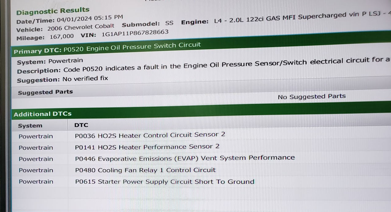

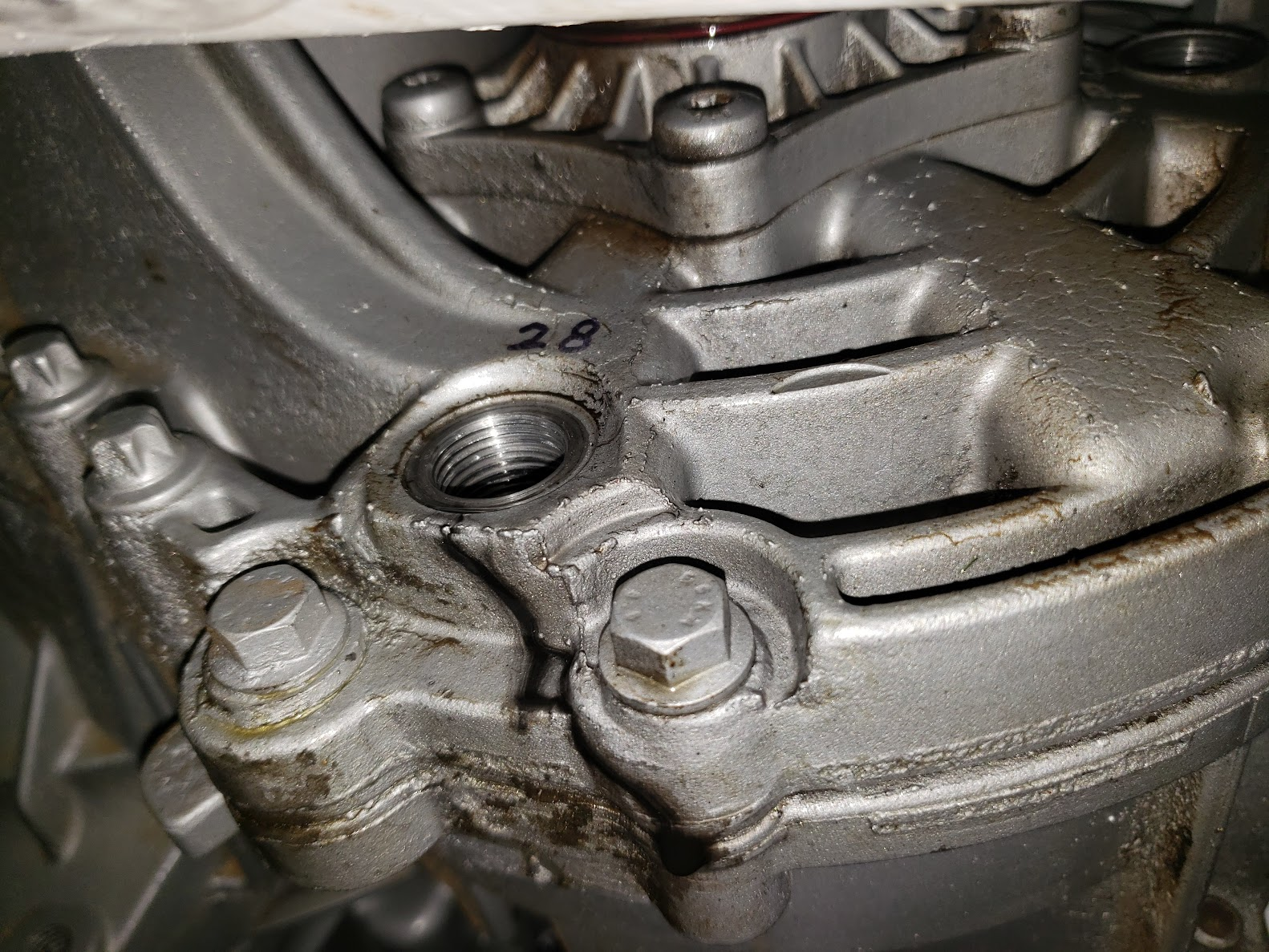

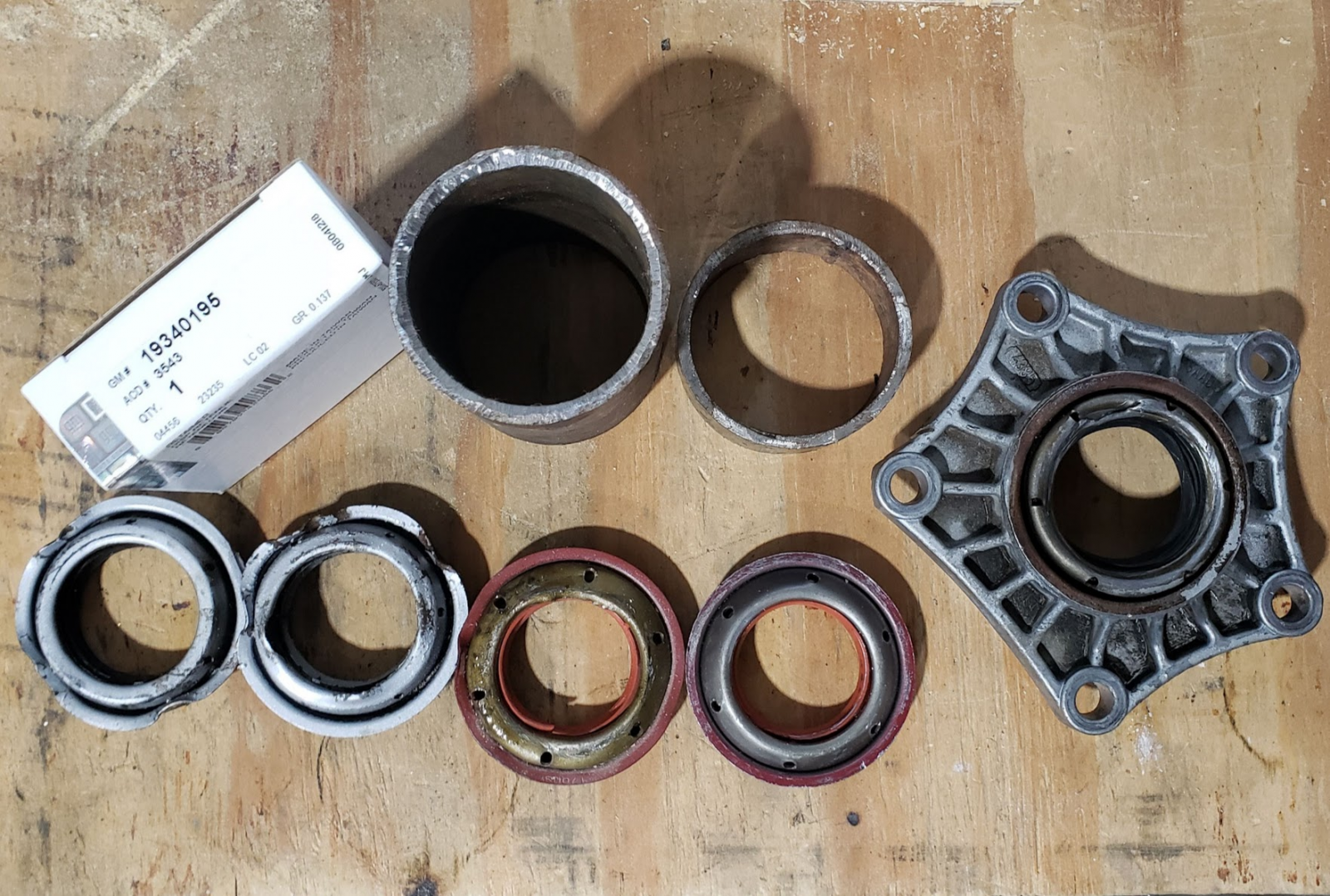

Leak is from above the drain plug, so I drained the transmission.
46710

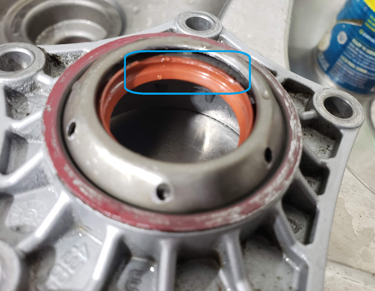

This new seal is missing some of it's sealing edge.
46712
So far I have used 4 seals, and made 2 seal installer tools. I hope I got it sealed this time.
46713
On the bright side, I am getting better at installing the axle. Still a pain in the butt, especially if it tears the seal.

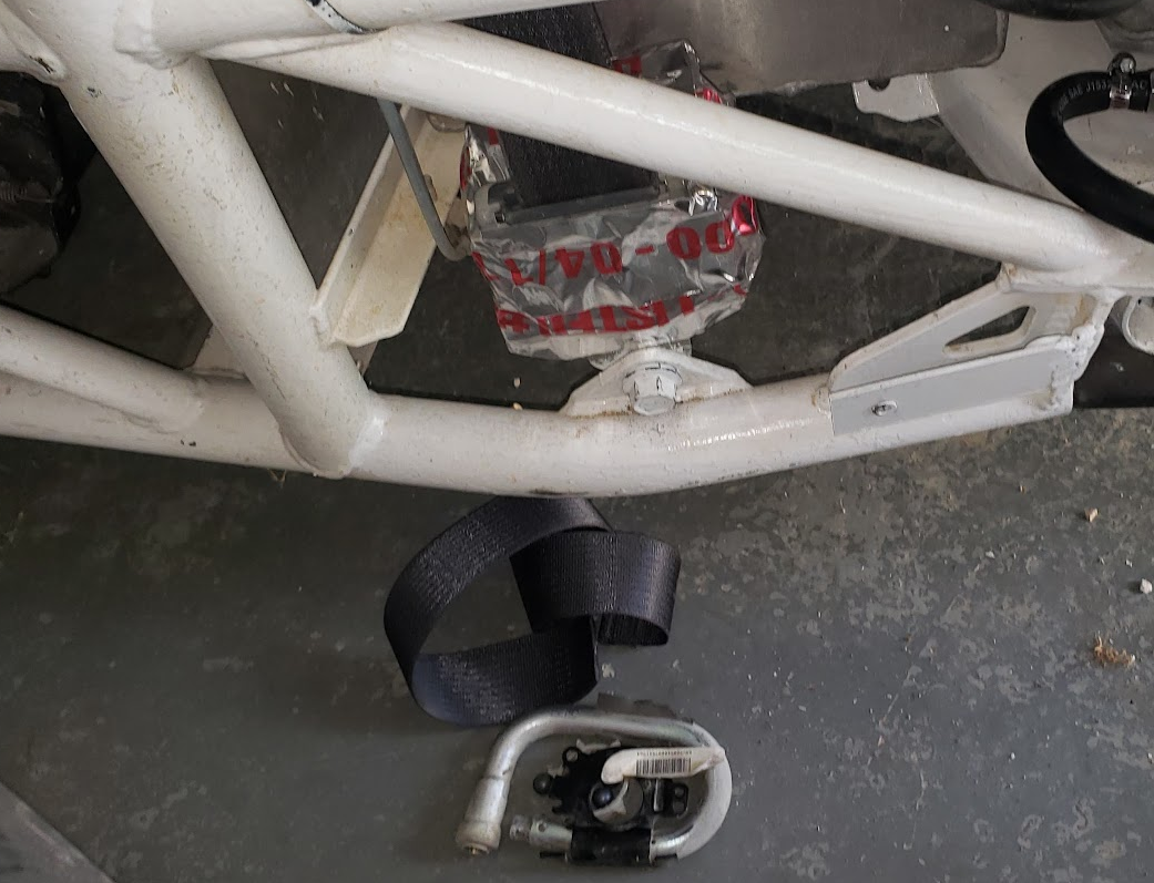

The Cobalt 3 point seat belt retractor only takes a small rock to prevent it from working.
So I took it apart again, and this time I wrapped it with HVAC aluminum tape, to keep the rocks out.

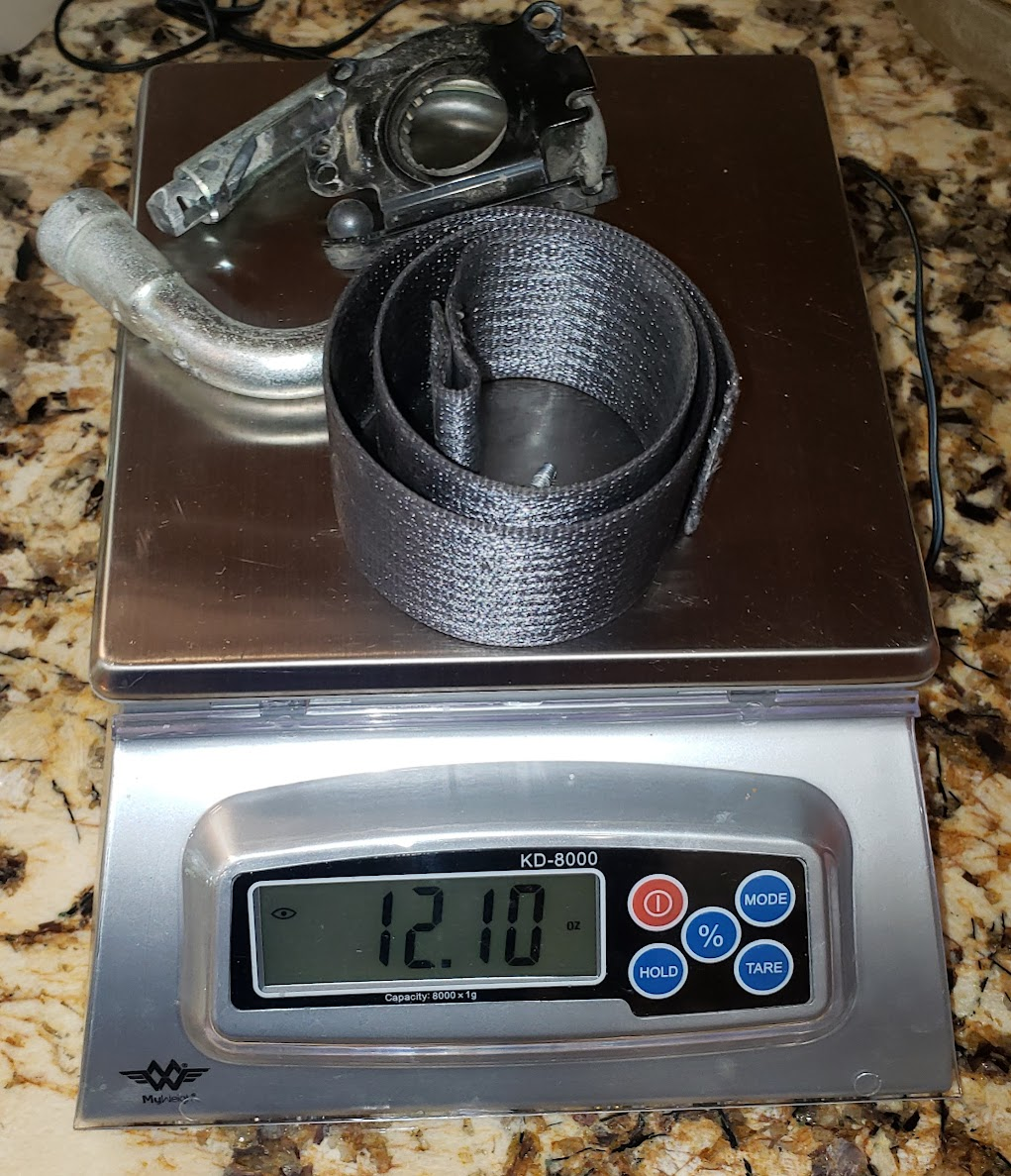

While I was in there... I removed the SRS explosive belt retractor, and 2 feet of seat belt, as it was too long.
Then wound up the spring retraction with a bit more tension than before.
Saved 12.1 ounces, but probably added 2 ounces of HVAC tape.

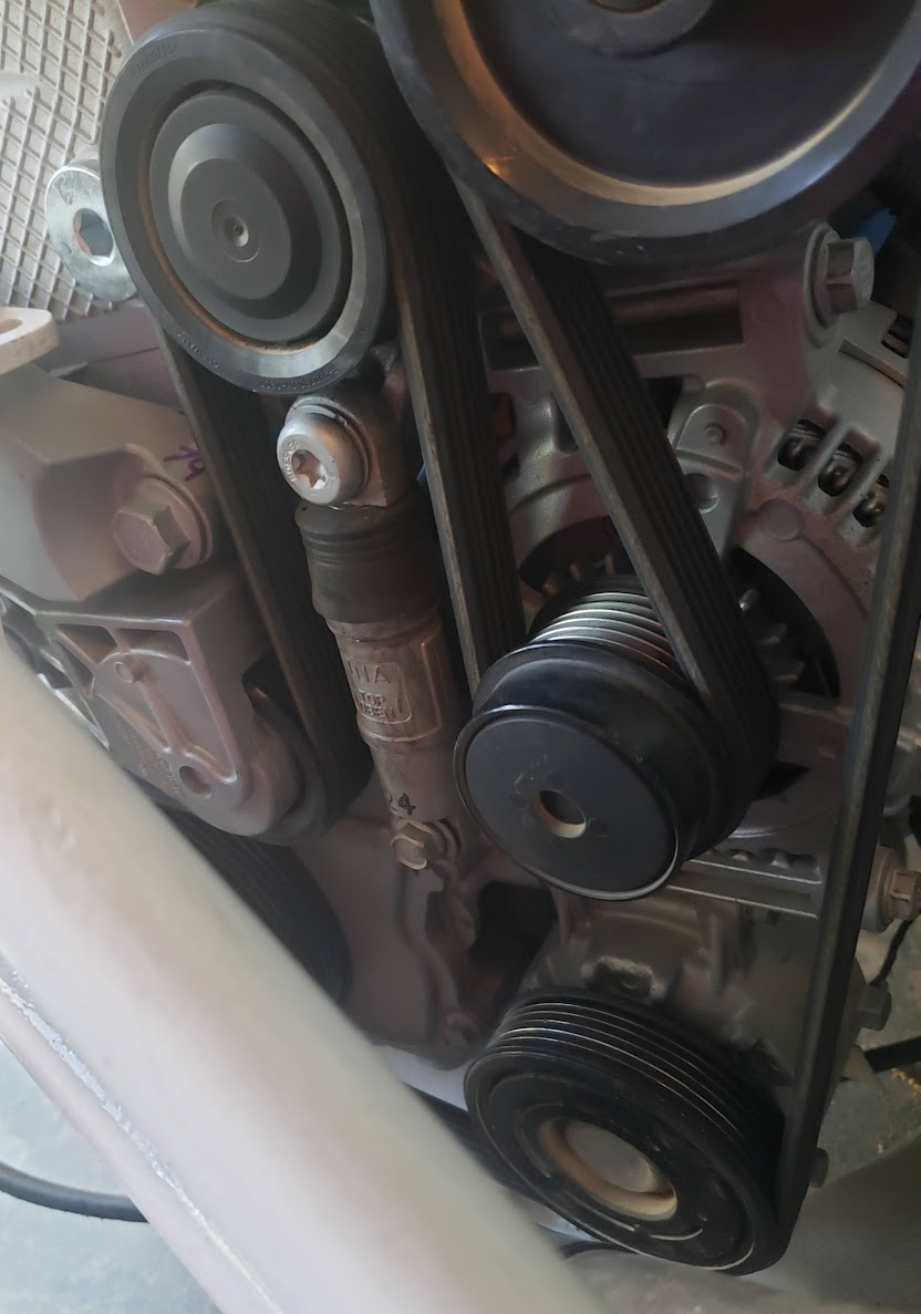

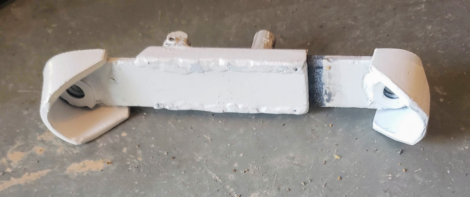

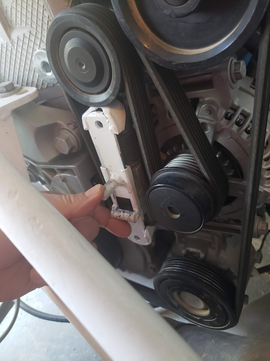

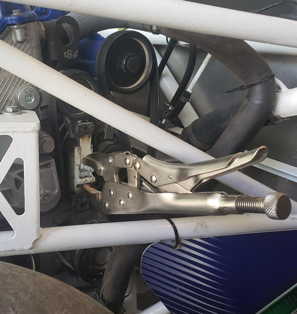

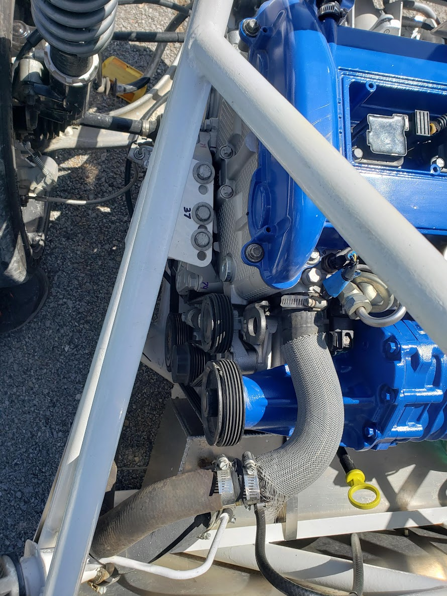

My 6 rib belt reduced itself to a 5 rib, and I was not looking forward to fighting with the Cobalt tensioner.

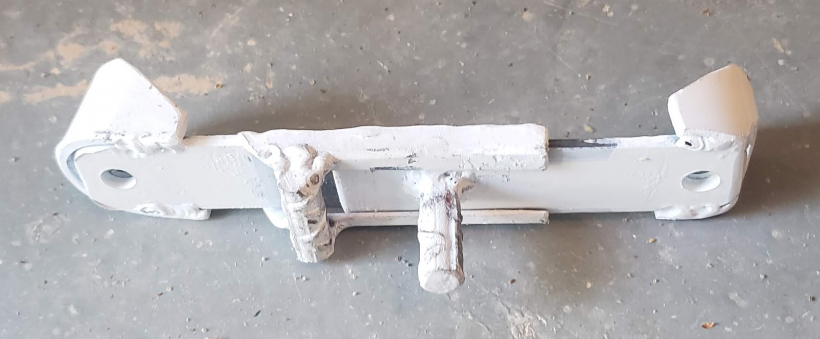

So I did a little welding to make a custom tool that slips over the tensioner.
46904
46905
With the help of some vice grips, I compressed the tensioner, and swapped out my belt.
This was my test of the tool, so it wasn't fully painted yet.
