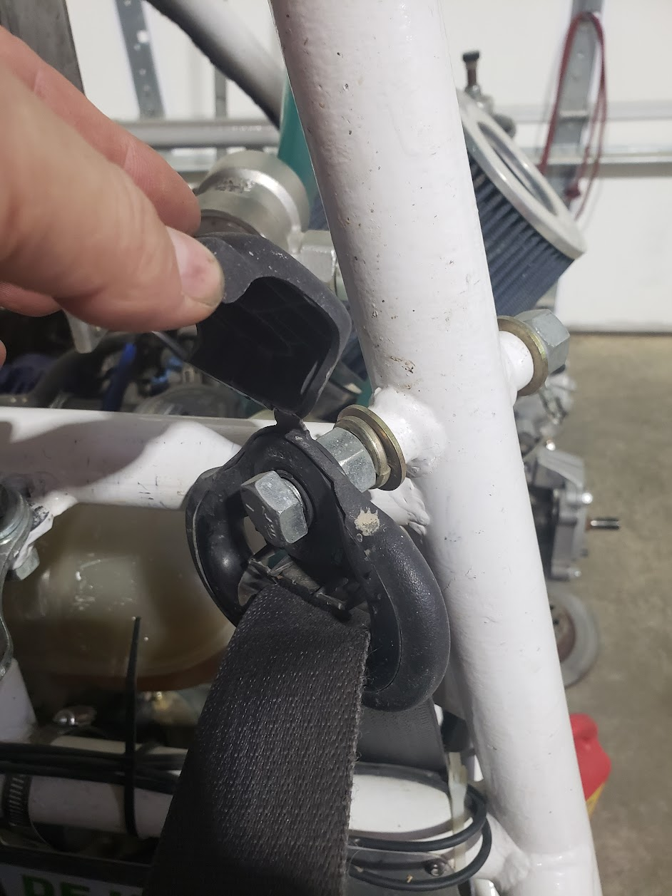

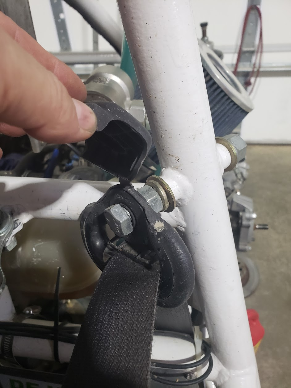

What do you have in the top of the donor seat belt? Is it a bolt, an interior nut and an exterior nut?
Is this to keep a gap at the bolt head to allow the seat belt to move freely?
on the buckle side you removed the donor seat buckle and ran it through your harness? Why not use the threads on the tunnel?
These pictures help a lot. I really appreciate it!
I like the seat belts bolted to the seat, so when you adjust the seat position, you don't have to re-adjust the seat belt.
The tunnel bolt is nice if your seats don't have a mounting point.
The top of the donor seat belt is a 4.5" bolt that is all threads with 2 nuts that pinch the goblin frame, and leave a space for the seat belt to freely move.
Perfect! Thanks again!

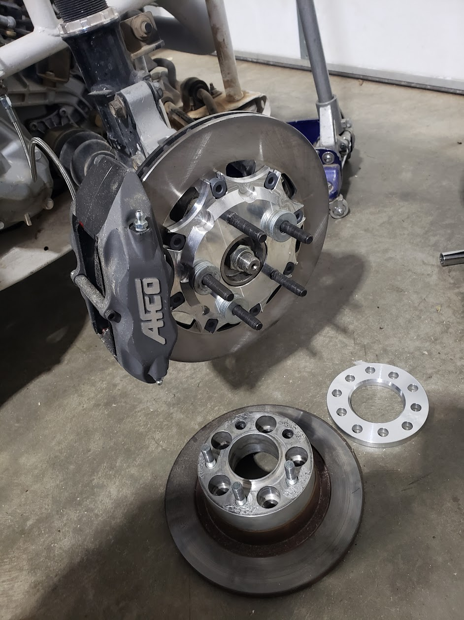

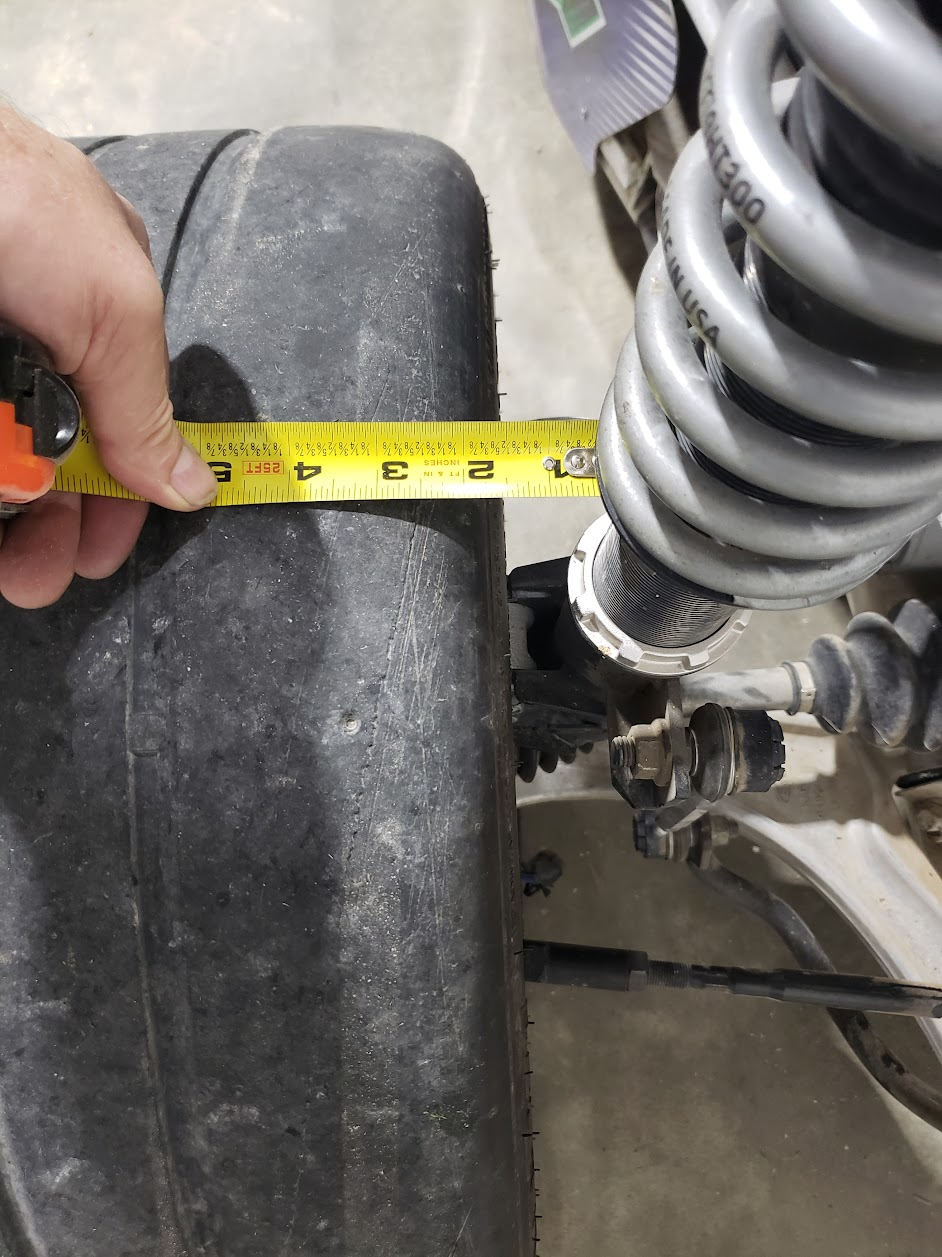

I used washers to space out the wheel, and I need an extra 11mm of space for the rear calipers to clear my 17" mustang wheels.
The new spacers arrived, off with the old 6mm brake rotor, 39mm adapter, and on with the 20mm brake rotor (extra thick as Justin Reed needed this much room for his wheels) and a 12.7mm spacer.
48372
The rear wheels were spaced out 45mm, now they are 33mm. Overall, that is 12mm inboard.

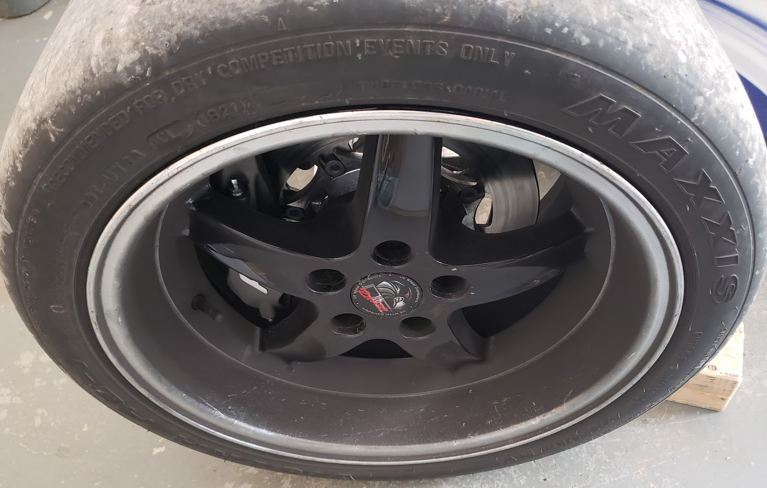

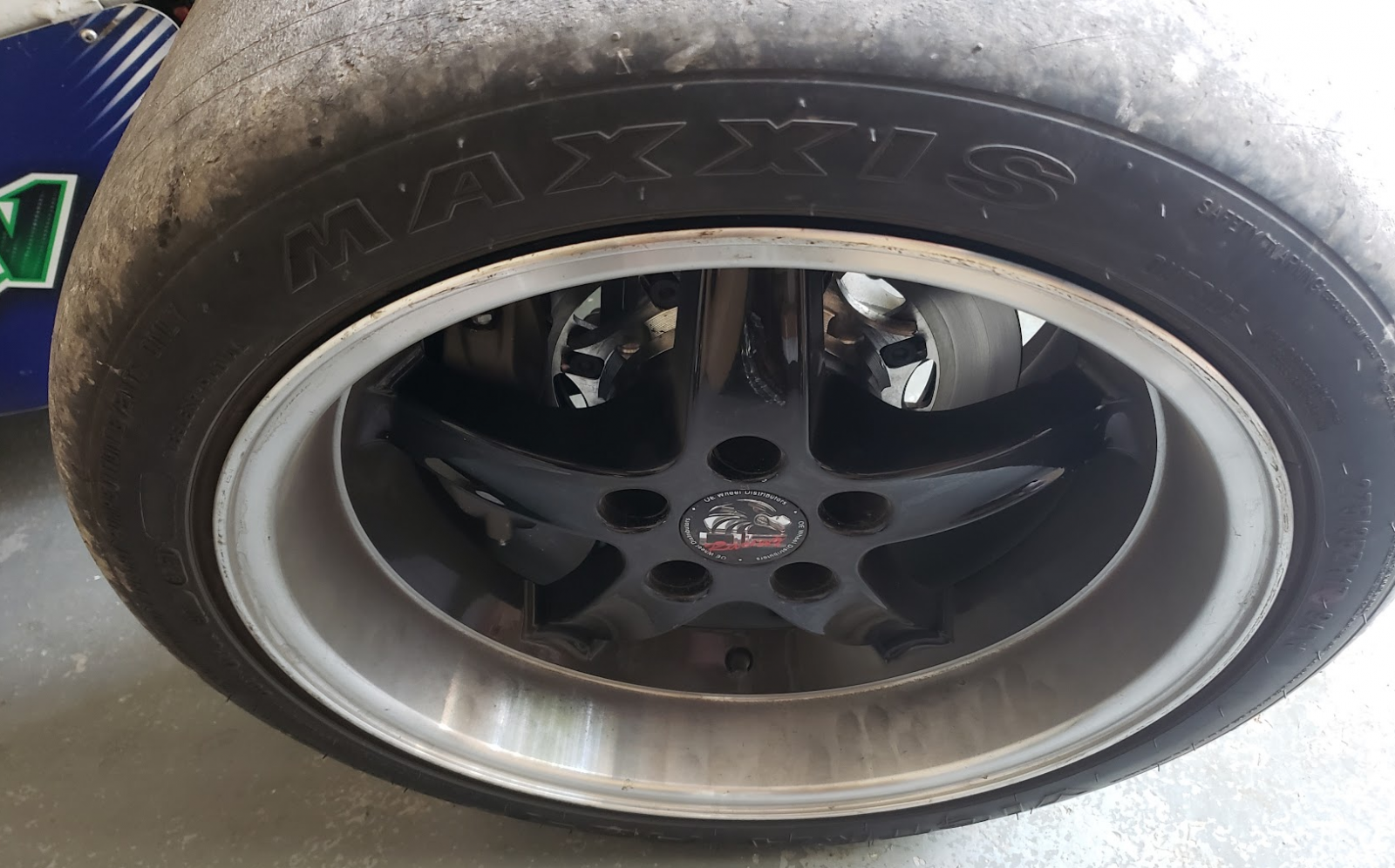

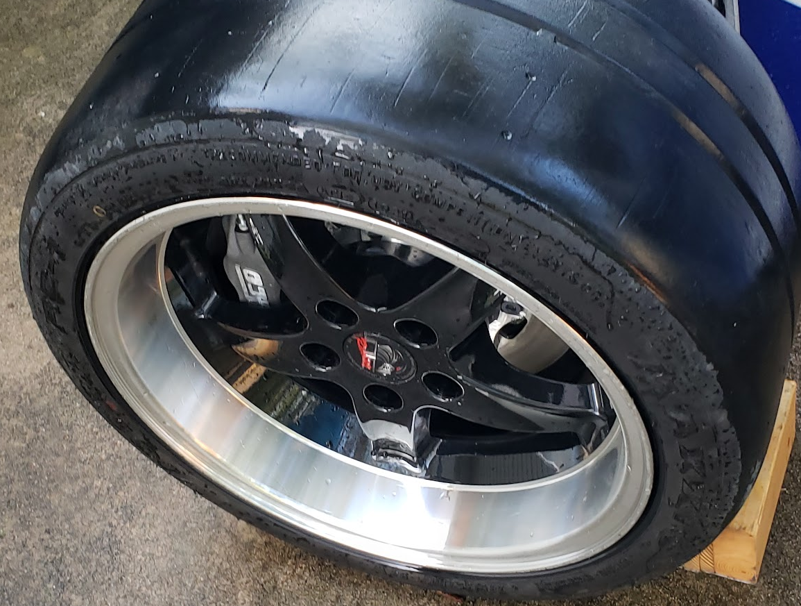

The wheels were clean before the test drive.
48403
These are the brake pads that I was bedding in:
48404
This is what the front and rear wheels looked like after bedding in:
48405
48406

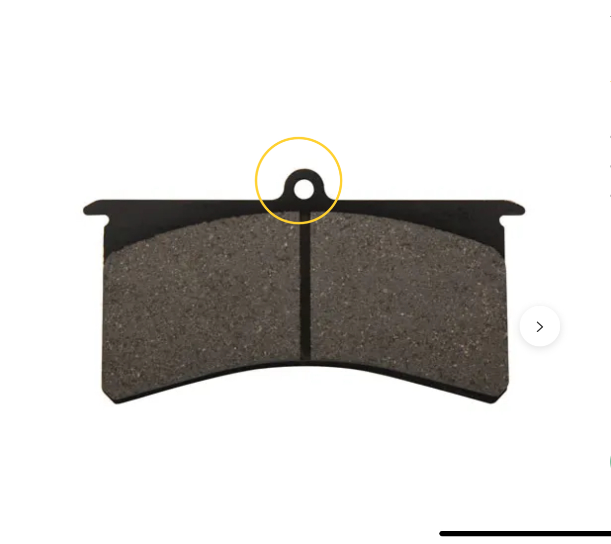

Yikes! Those pads are softer than I thought!

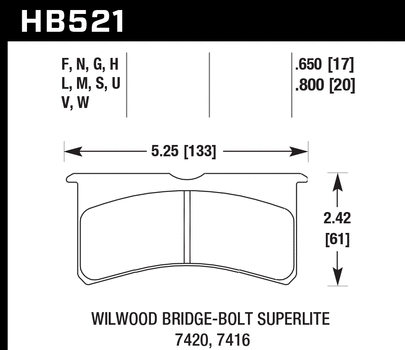

After reading this, I think it is safe to say that AFCO F88 caliper uses the same pads as a Wilwood Superlite or Ultra Lite 300 Series calipers
This opens up the brake pad selection from 2 AFCO compounds, to a wide selection.

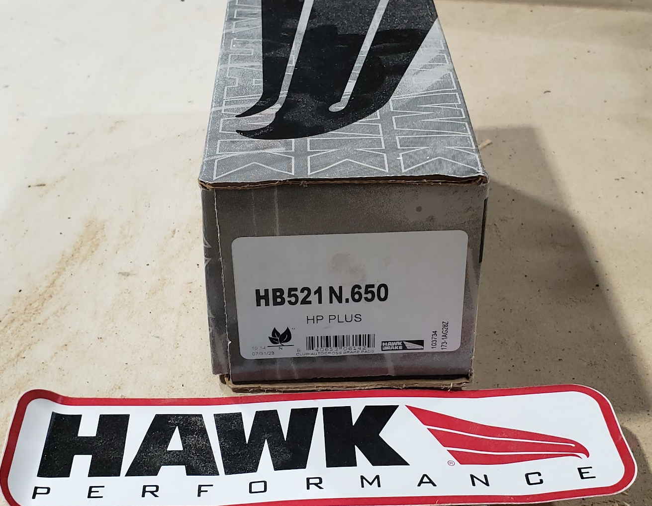

Here is the Hawk HB521N.650 pads $156 (4 pads for 2 rotors)
I ordered less sticky pads for the rear of my car: Speedway 338 Medium Superlite Brake Pad $80 (4 pads for 2 rotors)

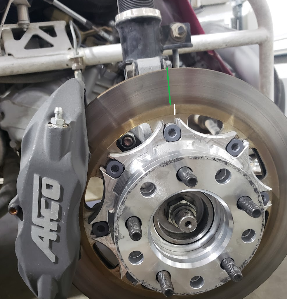

Taking a closer look today to learn what needs to be done to fit my 15" race wheels with the new Justin Reed brake package.
On the front, I need to buy longer wheel studs (Jegs M12-1.5 Thread x 3-1/4" Long x .509" Knurl), and I need a 16mm spacer. The green line shows the brake pad contact zone on the front rotor.
49334

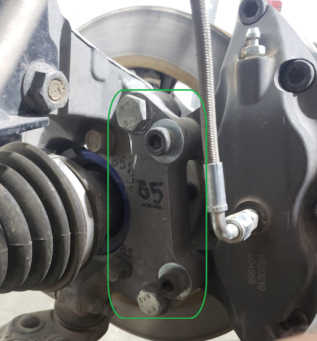

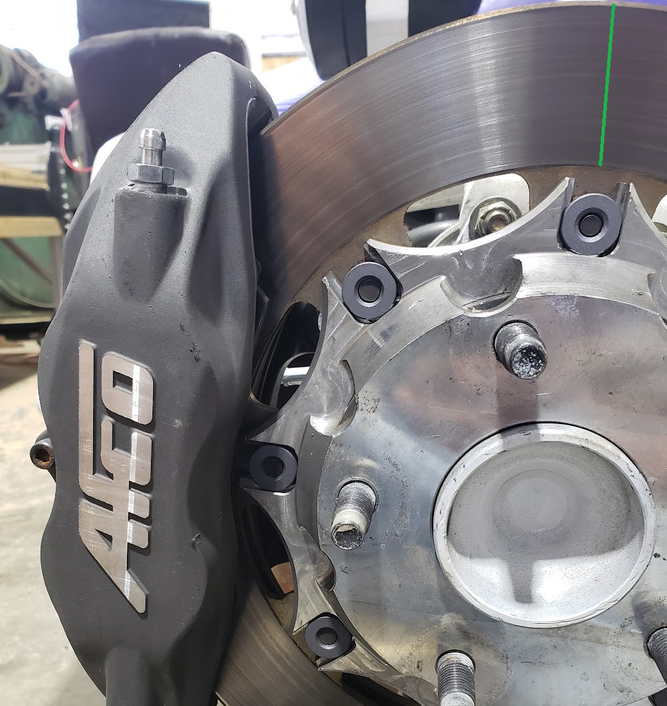

On the rear, Justin's brake kit was never designed for the stock rear uprights, but rather for the new DF tubular subframe and rear suspension.
I knew this when I bought his kit, so now I have the challenge of modifying my car to make it work.
I can't fit the 15" wheel, because I have the AFCO caliper mounted 8mm father away from the rotor.
The green line shows the brake pad contact zone, while the white lines shows the extra 8mm I need to fit the race wheels.
49335
I need to design and make a new caliper adapter that will move the caliper inward 8mm.
Flat aluminum stock, drill 4 holes, and make 2 spacers.
49336
