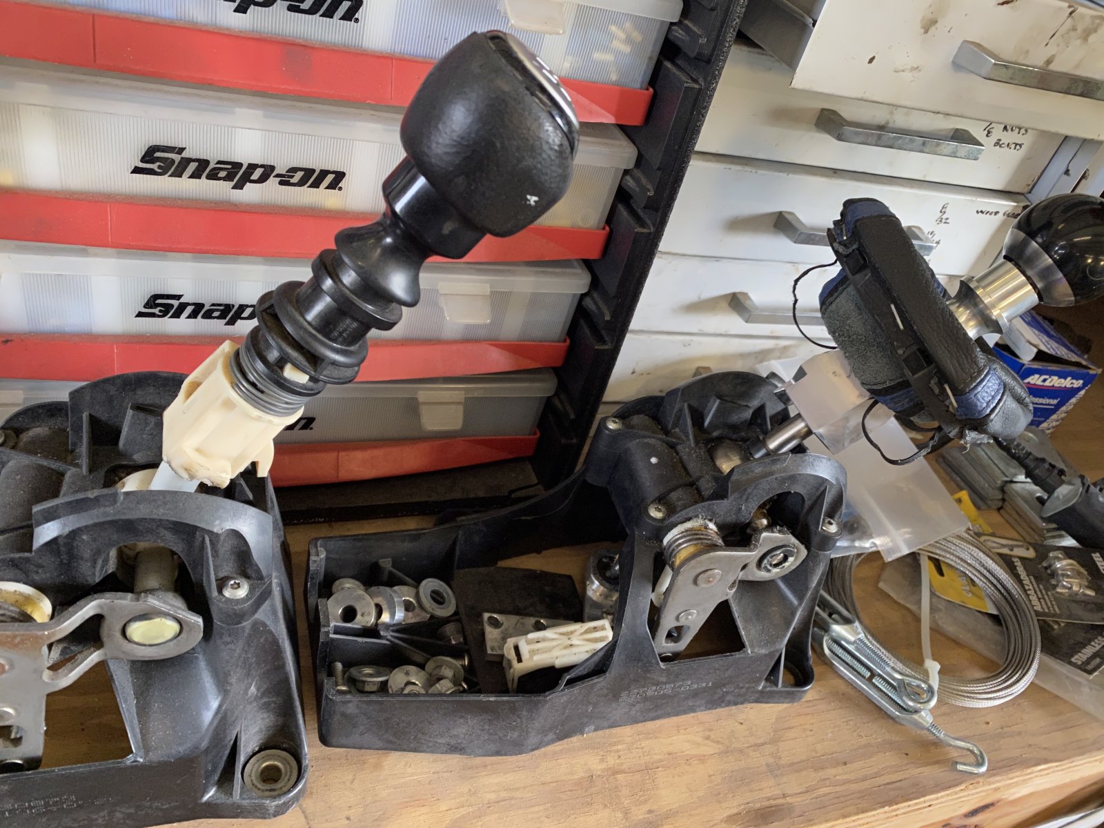

Looking to the future, it looks like my shifter (on the right) has a bit of goodies in it. :cool: The shifter on the left is Jason’s that he let me have in case I needed something. Comparing the 2, short throw and everything metal, looks mighty nice.

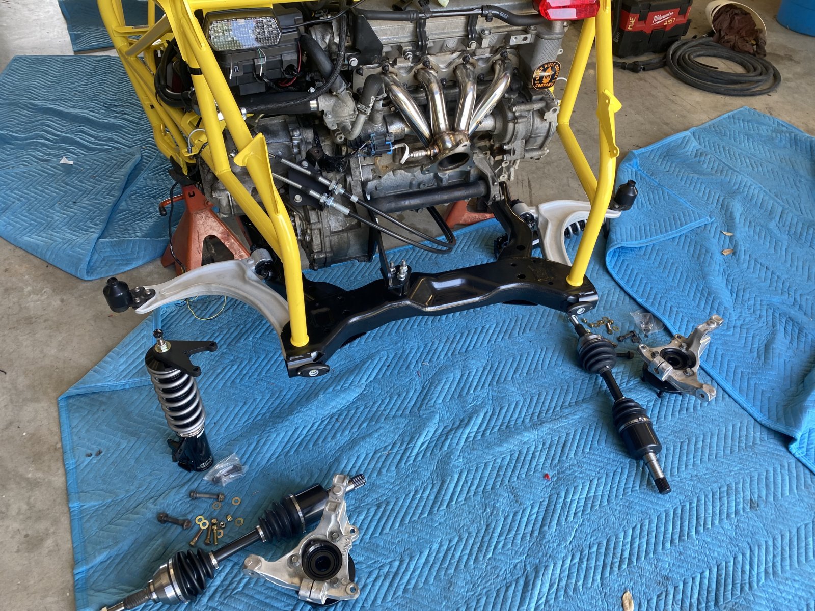

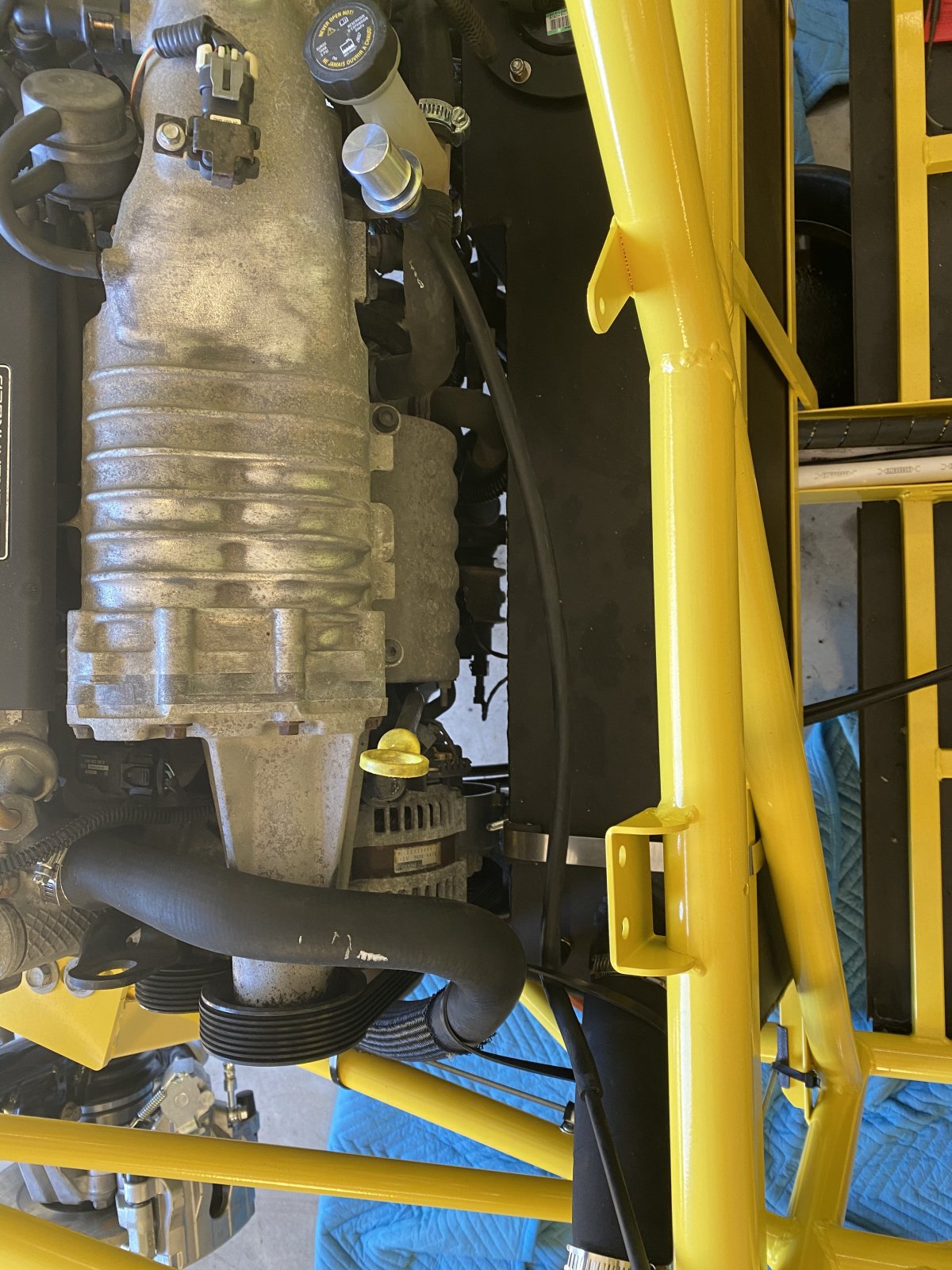

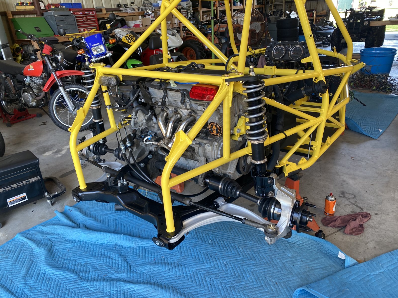

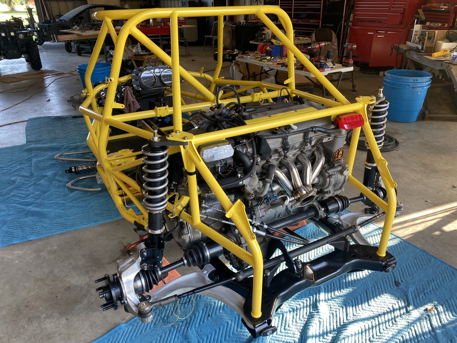

With the help of my lovely assistant, we have the rear suspension mounted. I kind of freaked out over the odd driveline angle, but realized I needed to extend the strut. Didn’t take long to find a thread on it here on the forum.
Tomorrow we hope to work on the front suspension and brakes all the way around. Now it’s getting into the fine details, where I get very meticulous.
JeffsGoblin
Do you have the donor tie rods on the rear or the DFG supplied ones back there?

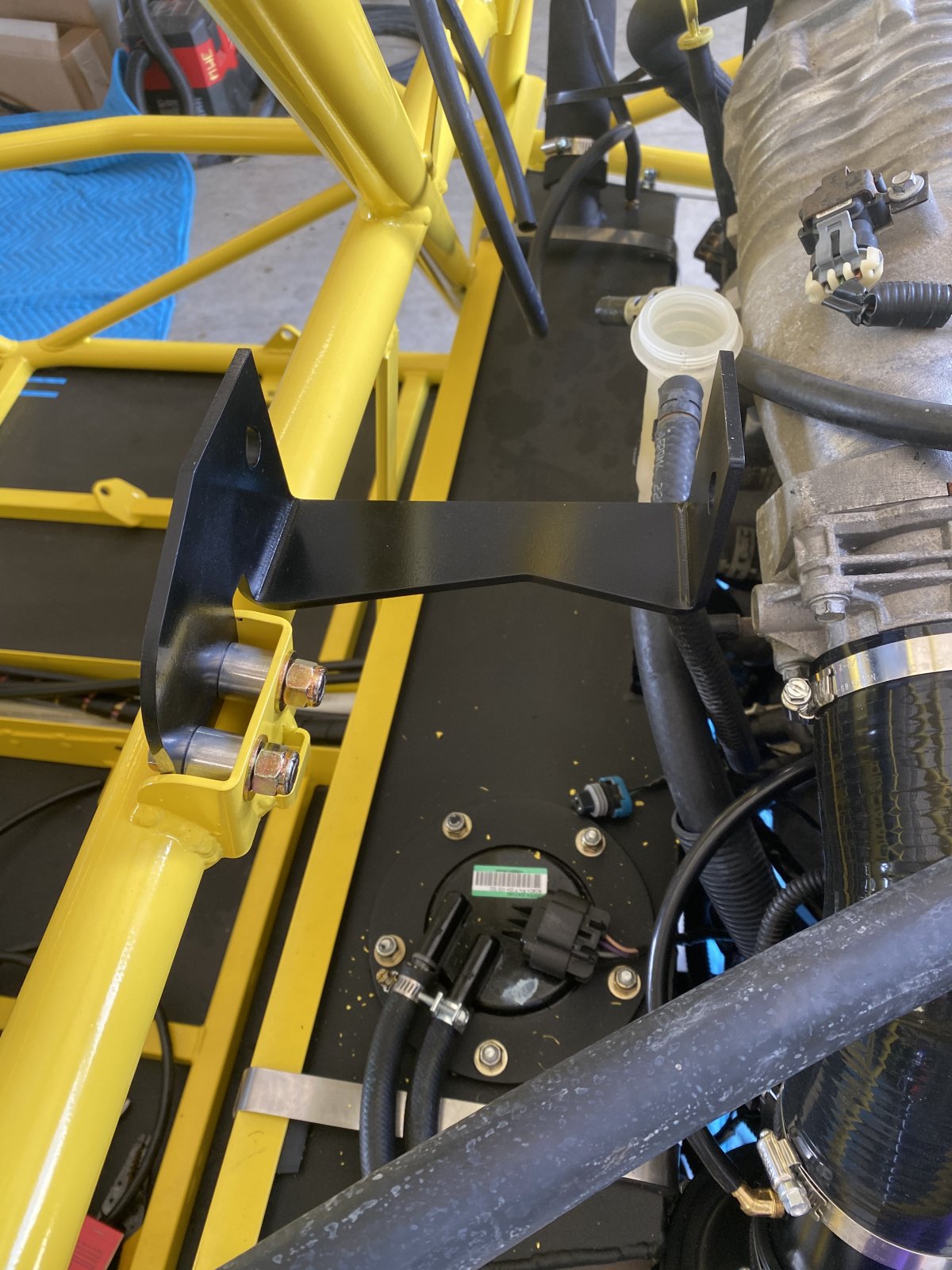

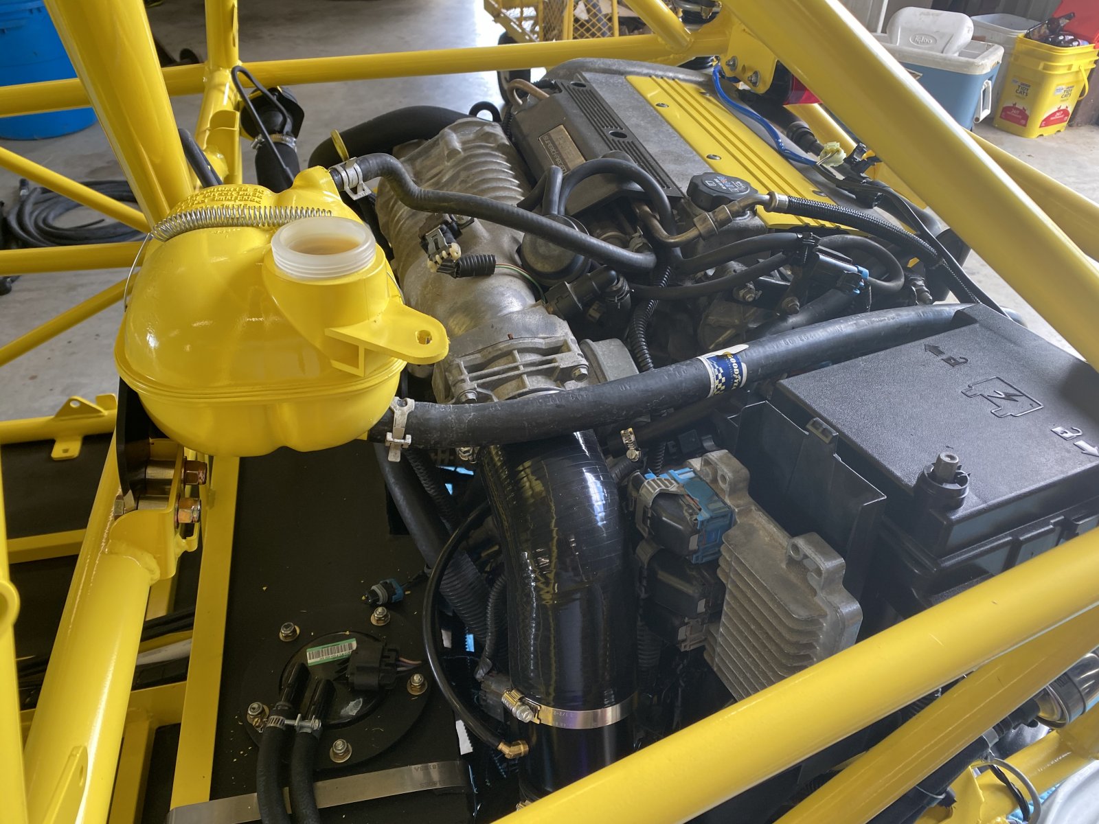

it took a little bit to figure out DF’s method to their madness on the new coolant tank reservoir mount, but I think I have it right. In any other position, the hose would interfere with the intake plumbing.

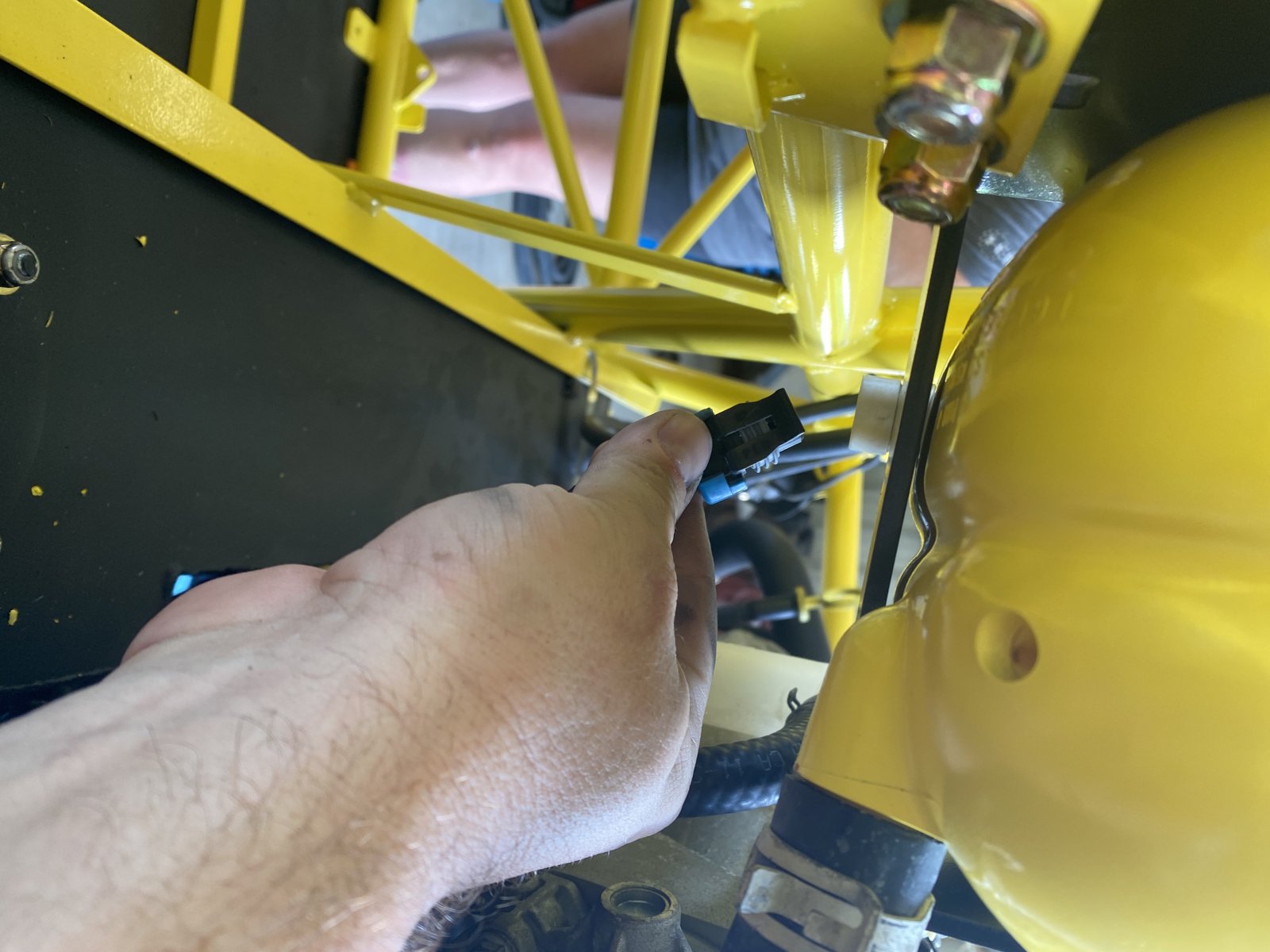

I love the mount and location........but, now I have to extend the low coolant sensor wiring. :confused:

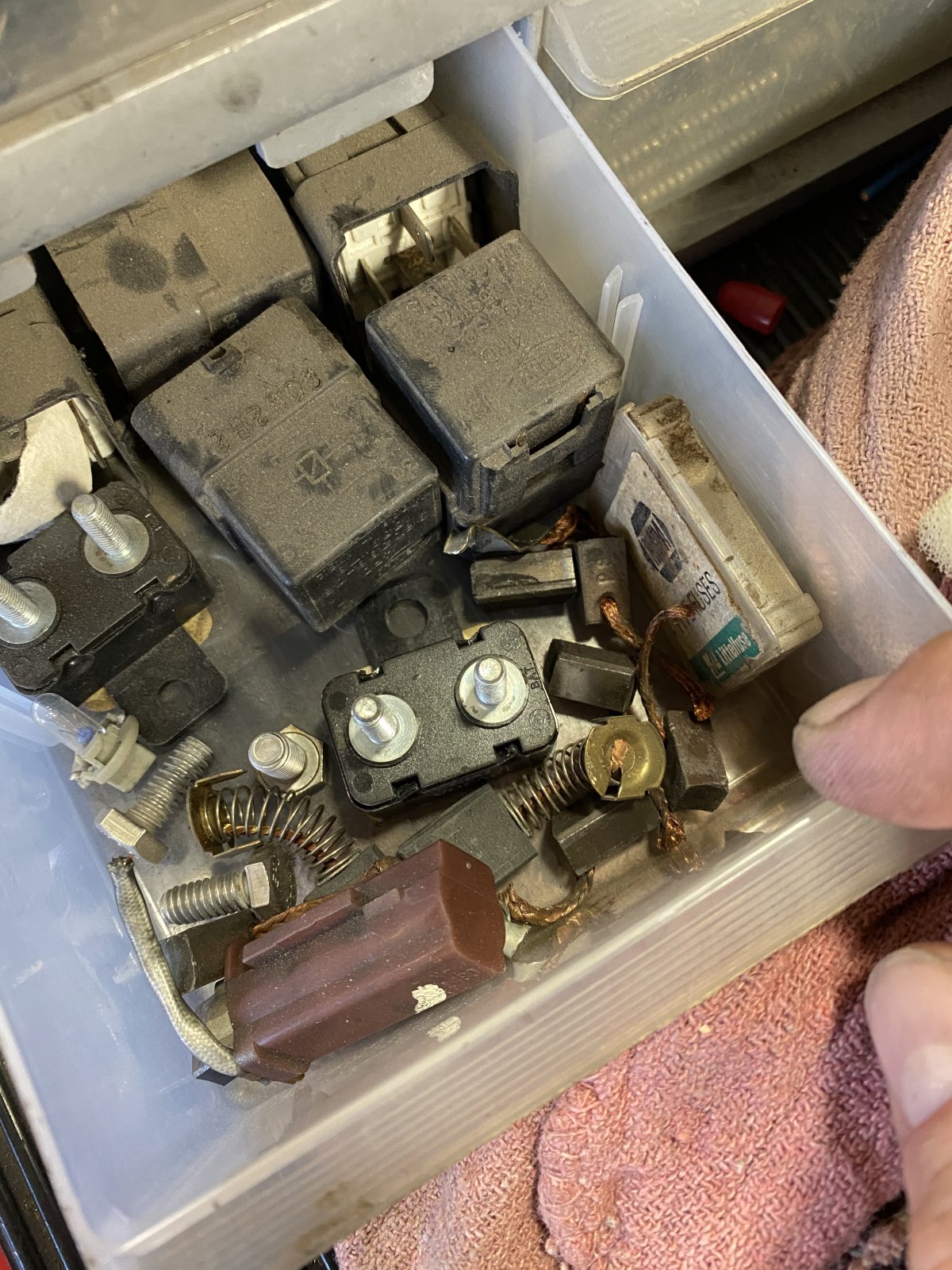

Work has been hectic, so just doing odds and ends when I get home. I noticed when purging the cooling system That the IC coolant never really moved. I brought home my Tech2 and commanded on the ic water pump. Just as I suspected, the ic pump is not working. I check power and ground, then the old school “tap test”. Yep. It’s toast. Woohoo
I also checked my fan wiring and for some reason, there’s no power. Long story short, I went to the secondary fan wiring and it’s good to go. I’ll probably add an override switch so I can turn it on whenever I want, which with Texas heat, will be a constant on from startup.
hopefully this weekend I/we can complete the front suspension and brakes, so I can start bleeding everything.
I could send you some brushes if you want to replace them...
Otherwise, I am willing to pay for shipping if you are going to throw the old one away.
Ya. I thought about rebuilding it. I have an alternator shop near work I use all the time for odds and ends. I may hit them up on some brushes, if my stash doesn’t come up with anything.

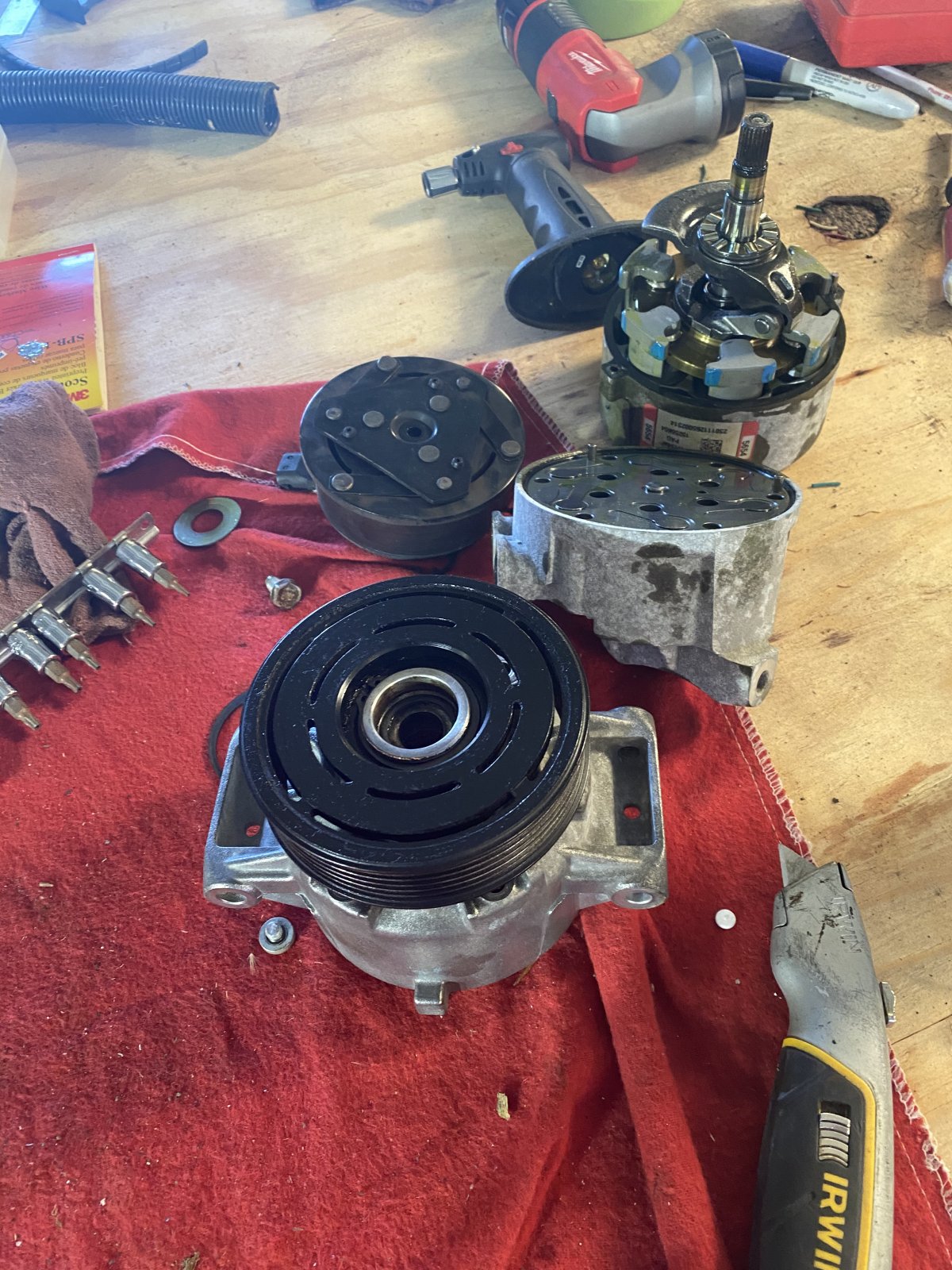

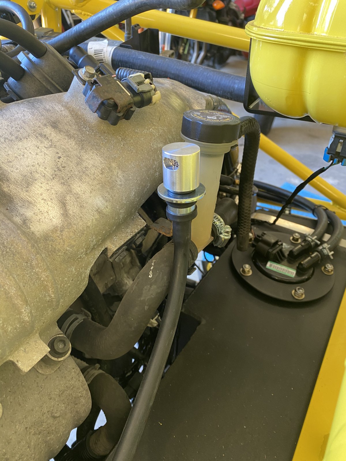

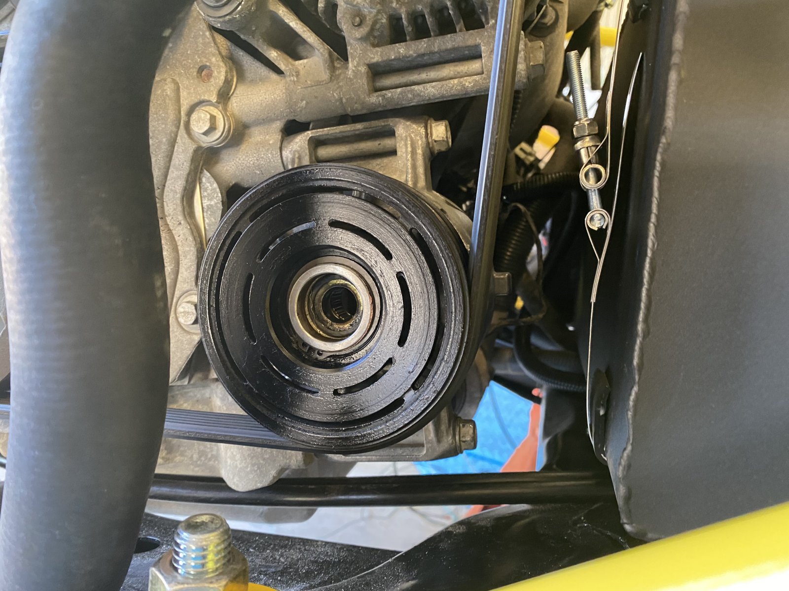

I got a rollover vent valve from summit, for the gas tank and mounted it to the intercooler filler neck.
and gutted the ac compressor.

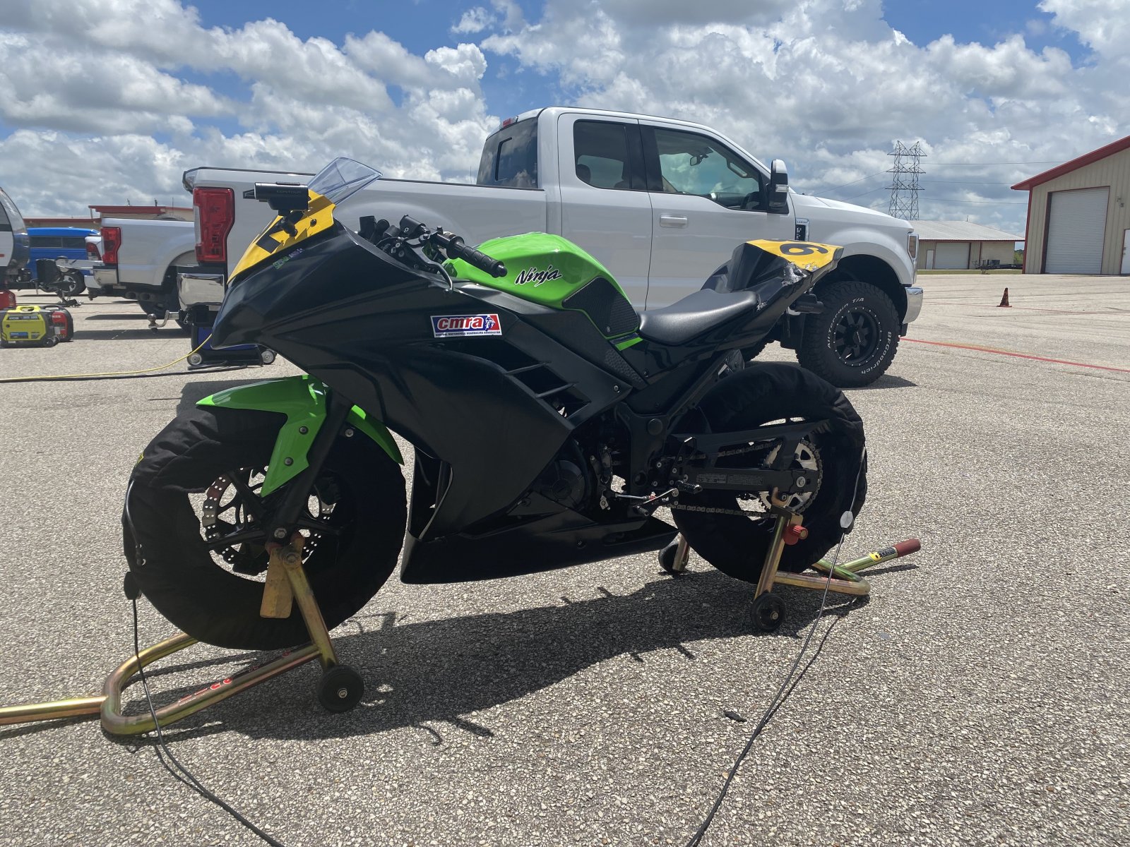

Then prepped the race bike for a track day on Friday. I don’t feel like racing the weekend, but gotta get my track fix in. It’s been a while. :cool:

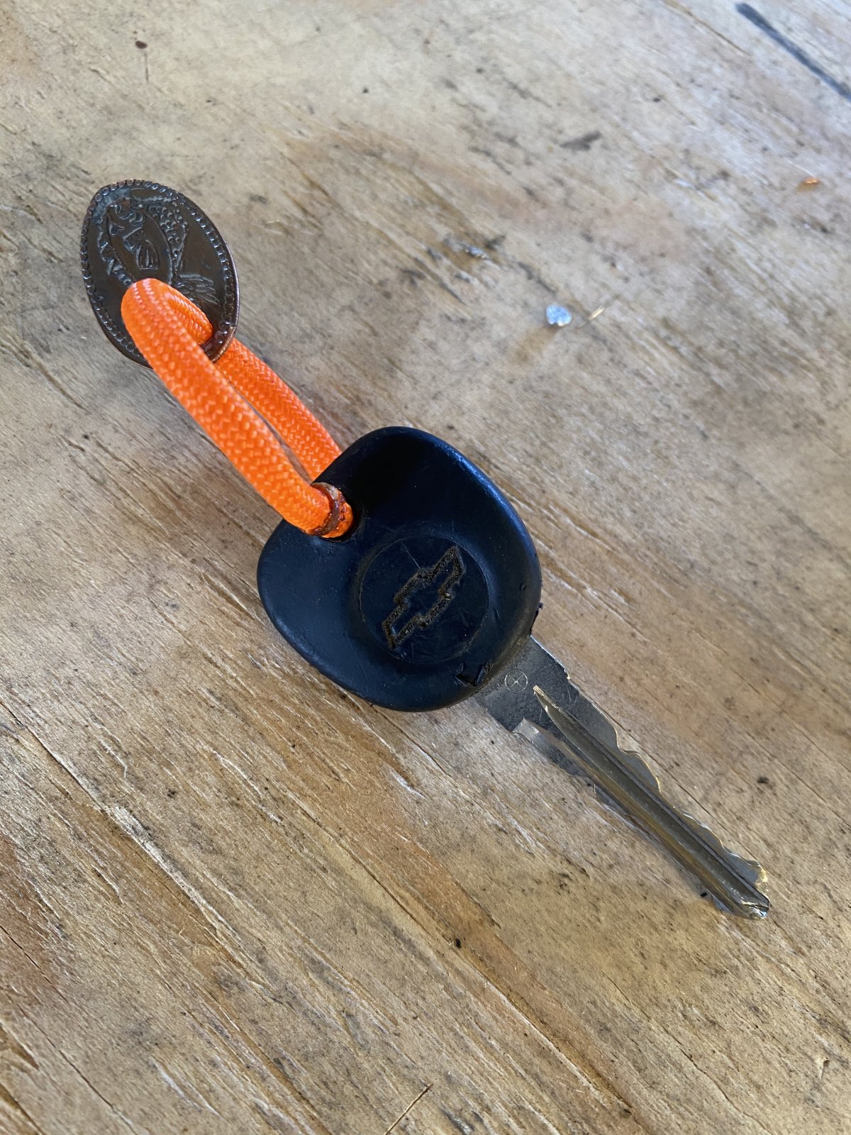

Ok. Most importantly, I made a keychain. This is the same keychain I have made for my race bikes. This is a smashed penny with the art from a friend of mine’s son, that passed away. It’s attached by an orange para cord that represents another friend of mines daughter that past away from cancer. Orange was her favorite color.
I don’t know what spirits or gods you believe in, but I like to think they are with me in spirit, doing things they didn’t get to do in their short lives.
