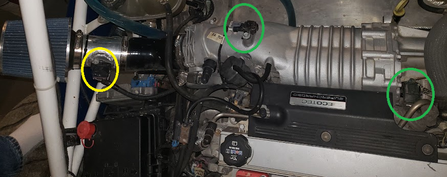

I should have been more specific, do I need to move the MAF sensor wires on the engine. I’m mostly talking about the one before the SC inlet in the intake arm. Do I need to cut the wire out of the loom and re-tape?
I think you are talking about the MAF sensor. It moves to a new location but I don't remember having to cut the electrical on it.
The yellow circle is the MAF sensor, the green circles are the MAP sensors.

To Ross' point about the MAF sensor - when I did my wiring last year, I followed Lonny's wiring videos and I had plenty of slack to plug the MAF connector up. If you find you can add a couple inches just to be safe, not going to hurt. You can always tie slack down.
