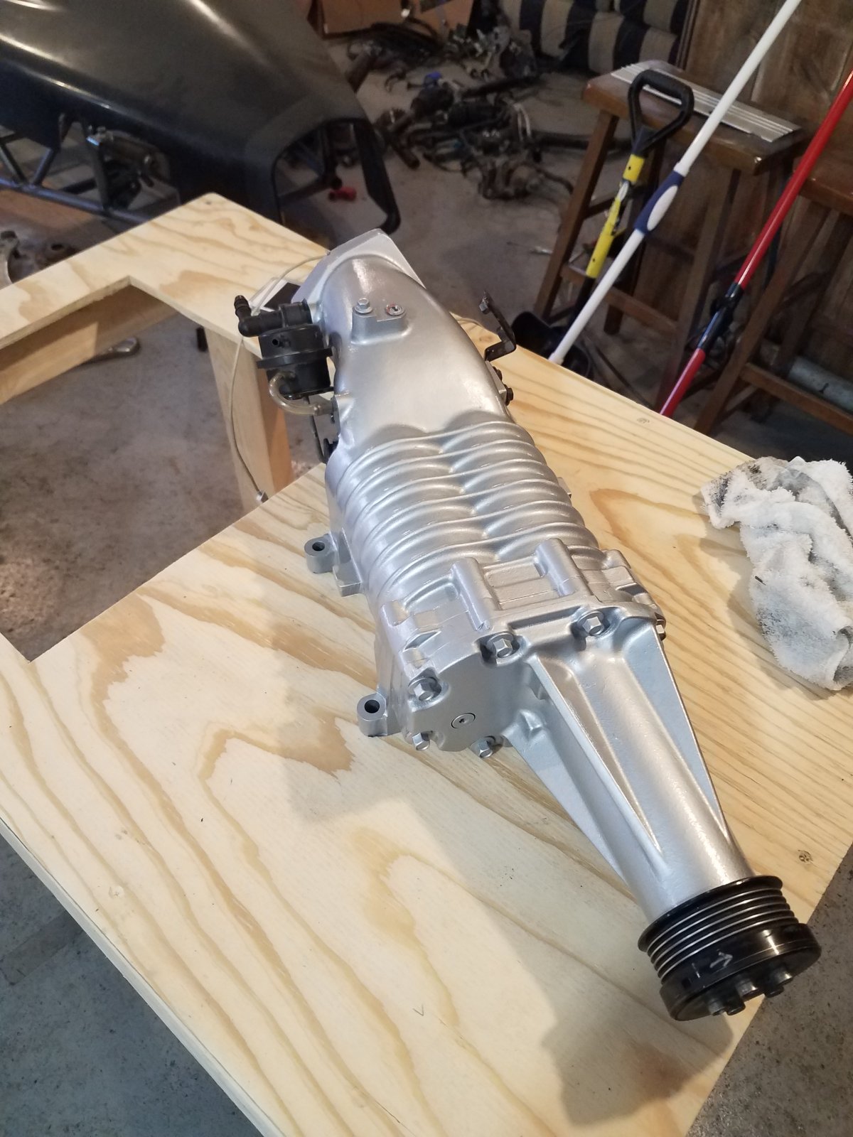

I got my SC painted this weekend. I think it looks very good. Just engine duplicolor with engine clear coat over it. I went with aluminum color.
7687

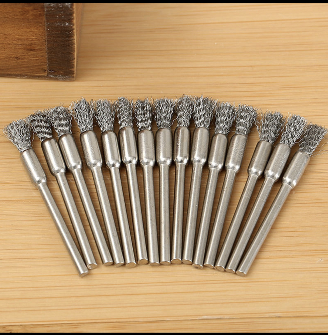

The most work for me was cleaning off the small layer of oxidation. Is there a better way than using a wire wheel/brush? Some crevices just can't be reached like that.
