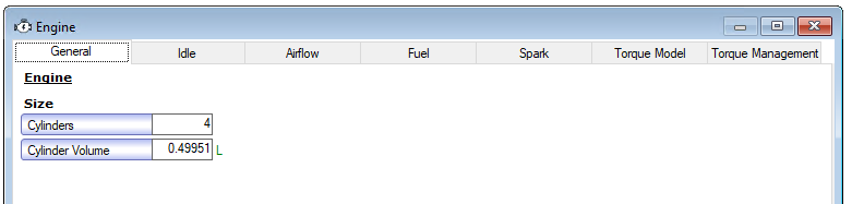

Starting off with the General tab. Don't change anything here, ever (unless you have severely modified your engine and it's no longer a 2.0). That was easy, we are off to a great start!

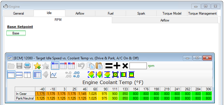

Idle - RPM
Here you can adjust your idle speed. Sometimes it helps to raise them just a bit if you have larger injectors that don't flow well at low RPM (extremely low duty cycles or short pulses). It's better to leave the cooler temps a bit higher until the engine warms up. This is how I have mine set, 50 RPMs higher than stock.

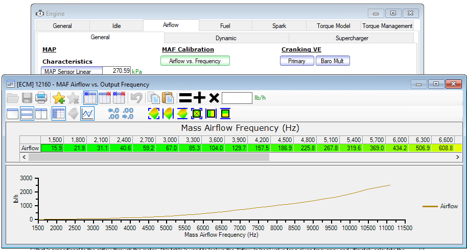

Airflow - General - MAF Calibration
Later when I cover tuning, the MAF calibration table will be modified during the MAF tuning. This is the primary table used to calibrate the MAF (Mass Airflow - the sensoring of the amount of air entering the engine). DO NOT make your table match mine. Everyone's will be different. Do not just change numbers unless you are actually tuning or know what you are doing. A little change here makes huge differences! At the low end of the table it basically looks flat and no different, but just a decimal point can make big differences in the AFR. That's why is so important to get this spot on. Any changes in your intake from stock can throw this tuning out of adjustment.

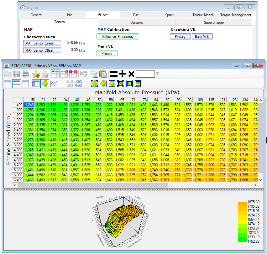

Airflow - General - Main VE
Again this table will be used for the Speed Density or otherwise known at VE tuning. DO NOT make your table match mine, they all will be very different. This table is used to figure how much air is in each cylinder in case the MAF should fail and also to provide a base to check the MAF. So at each engine RPM and manifold pressure, it knows about how much airmass is in the cylinder to calculate the proper amount of fuel to add during each injector cycle. You get this right, the car can run fine off of this table alone and not even use the MAF! As part of the tuning process, you dial this table in and you will know when you are getting it right as the car will run just fine while the MAF is disabled.

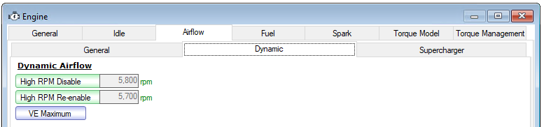

Airflow - Dynamic - Dynamic Airflow
These will be used during the tuning process to force it into running only off of the MAF or off of the VE tables above. DO NOT change yours to this setting until you are in the process of tuning. You will lower these for MAF tuning and raise them for VE tuning. Otherwise leave them as they are.

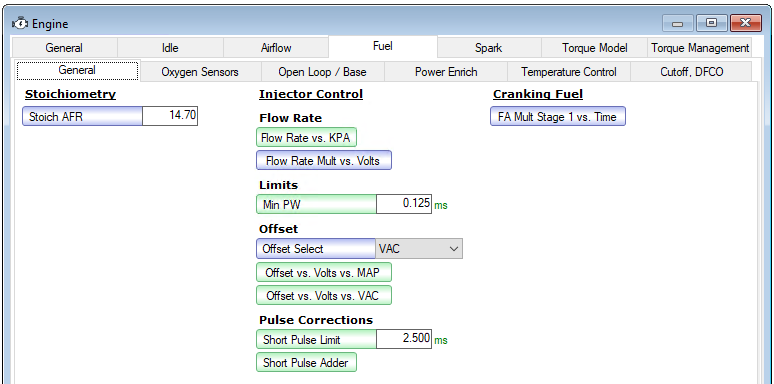

Fuel - General
If you change your injectors, one of the first things you will do is to input new values in the Flow Rate vs. KPA. This is telling the ECM how much fuel it can expect to inject into the engine at a give manifold pressure. Stock injectors are 38lbs/hour (I believe). Many times the first thing to change on these engines is the injectors to pump more fuel in and it's not uncommon to see 60lbs/hr or even 80lbs/hr for E85. There is a lot of talk about the limits of this table hard set at 63lbs/hr and how to get around that, but I'm not going to go into that now, that's an entire thread in of itself.
The Min PW is the shortest amount of time the injector can open properly. Larger injectors can't open for short period as well as many smaller injectors can. You would only change this to the specs of your new injectors. The same goes for the Short Pulse Limit and Adders, these are all setting to help with the short pulses the injectors have to make at low RPM. Some changes here can help with idle issues such as surging, but should be addressed with proper fuel tuning first.

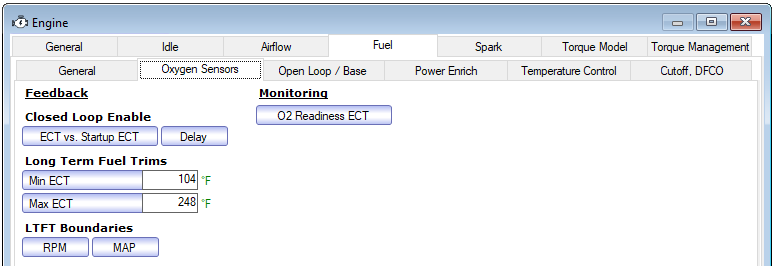

Fuel - Oxygen Sensors
The O2 Readiness ECT will be changed during tuning to force the ECM not to go into closed loop. Closed loop is when the ECM uses the O2 sensor readings of the AFR to correct fueling and trims to keep the engine running as close as possible to the commanded AFR (typically 14.7). During tuning, you don't want the system making changes and trying to correct things while you are trying to determine how far off your tune it. You need everything to stay stable and the same while you are making adjustments. The same goes for the Closed Loop Enable and the Long Term Fuel Trims, all of these will have to be set properly during tuning, otherwise leave them alone. The Closed Loop Enable just allows it to go into closed loop after the engine warms up a bit. The Long Term Fuel Trims are semi-permanent (for a long time) trims or adjustments your ECM is making. A good example of this is if you live ocean-side, your trims will be adjusted for the lower altitude and then when you drive to the mountains, the trims will change for the higher altitude. There are short term trims which are very short, milliseconds, and are used to fine-tune the fuel delivery constantly.

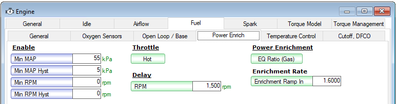

Fuel - Power Enrich

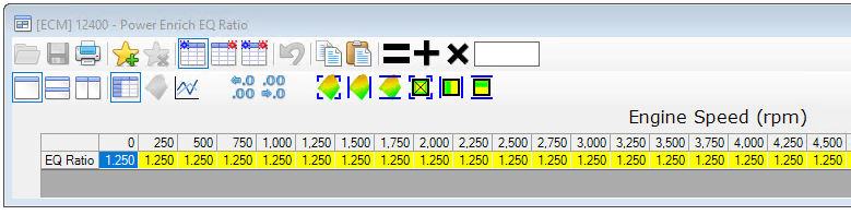

Power enrichment is basically to help protect your engine and help achieve maximum power during WOT (Wide Open Throttle). I have mine available to come in when the TPS (Throttle Positions Sensor) is at 40 and the ramp in (Enrichment Rate) is faster that stock. There is a bit of delay and it does ramp in. I have watched this on the scanner. It's not nitrous! So don't think that you can change these values to get a hit by dumping fuel, it will only make it run worse. At WOT, the exhaust gas temps start to climb and this is to help keep things from melting down.
To continue on this, the Power Enrichment EQ Ratio is a value that modifies the target AFR. Typically the target AFR is going to be 14.7 (stoich for gasoline). When the PE ramps in all the way, the target AFR will be 14.7 / 1.250 = 11.76. So during full PE, the AFR will be 11.76 during WOT. Mine, as shown here, was changed by my tuner to be one value all the way through the table while stock has more of a ramp, lower on the bottom and higher on the top. I haven't decided if I want to go back to stock yet. I may just leave it as is.

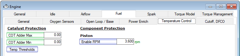

I have removed the Catalyst Protection as most of us don't have a cat anymore, so there is no reason for it. Also I would leave the Piston protection alone at stock. I've seen some tunes where this is set too high or off. That's just my opinion.

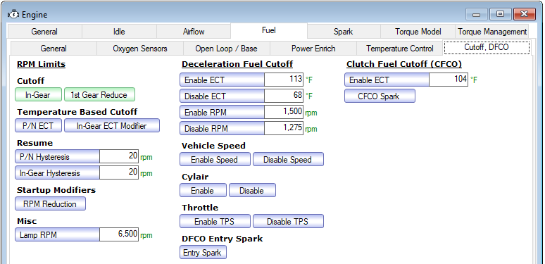

Fuel - Cutoff, DFCO
Here is another area that you will need to modify during tuning. I'm not going to cover everything here because you don't need to change much of it other than during tuning. Some will leave DFCO disabled (more on that later). First, if you want, you can change your RPM limits for in gear or 1st gear. I don't know if these cars actually know if it's in gear or which gear. Don't go crazy with raising your limits.
DFCO (Deceleration Fuel CutOff) is basically cutting fuel when you let off of the gas pedal in order to save gas. This can really mess up the tuning process during data logging when it just goes incredibly lean during shifting or braking. For this reason, many values in here are changed during the tuning process to ensure DFCO is not active. All of this will be covered later in the tuning threads. Some people like this permanently disabled because it can cause popping during decel, but I personally would rather just leave it on. Sometimes the popping just sounds like a small backfire and bad tuning.

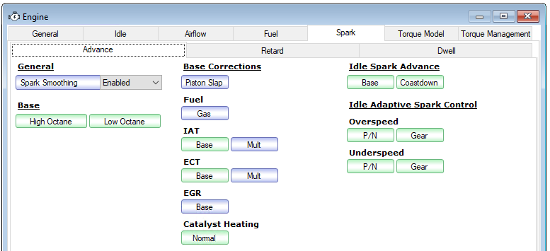

Spark
I'm going to skip over most of the spark tab. I don't recommend changing anything here until you have mastered AFR tuning and HP tuners. It's not hard to tune the spark advance, but it's a whole other topic unto itself.

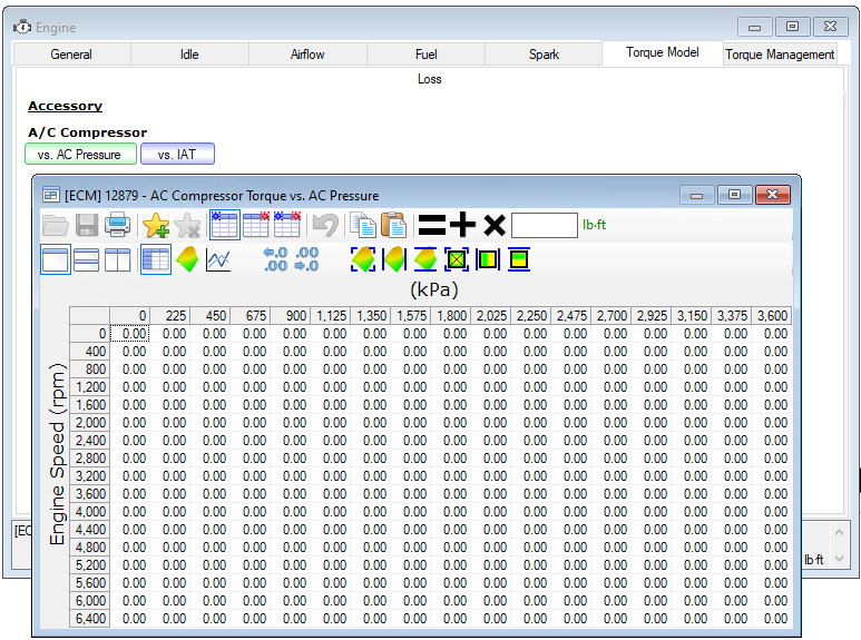

I have zeroed out all of the tables here for the A/C compressor since we no longer have A/C and there is no loss. Nice, an easy one!

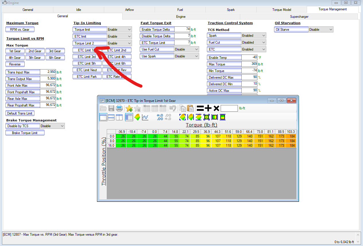

Torque Management - General

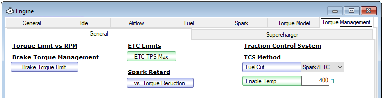

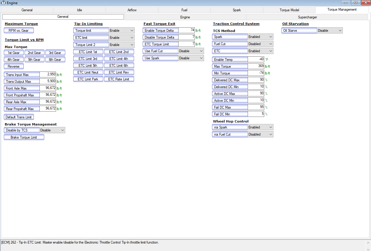

First, change the Traction Control System and disable it by raising the Enable Temp to a point that it won't work, such as 400 degrees here, unless you want the car to help control traction under high throttle.

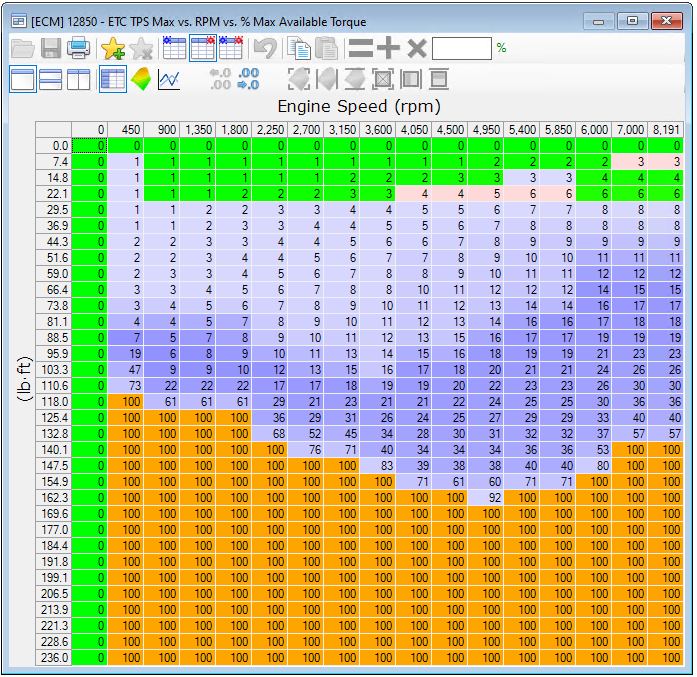

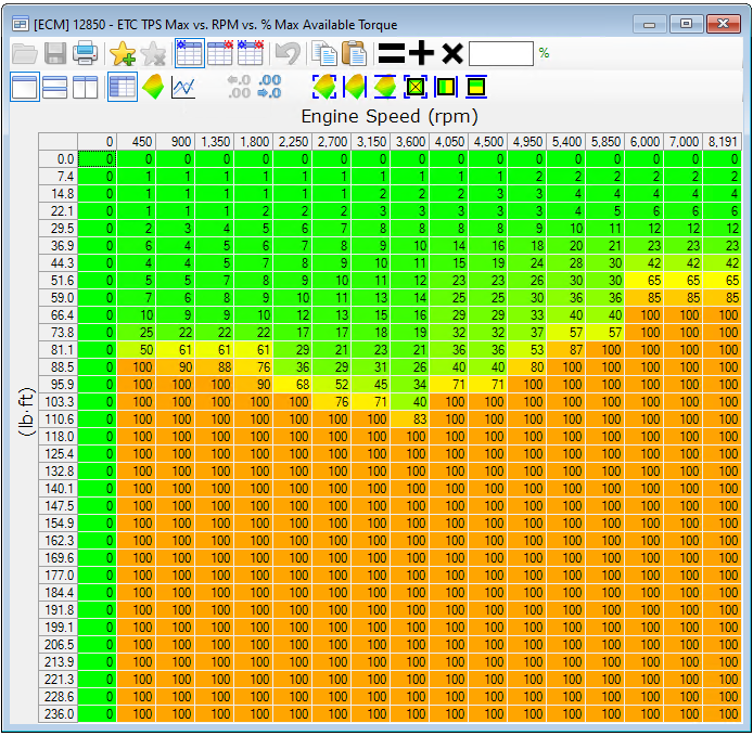

Here is where you can modify the toque delivery and possibly help some with the jerkyness of the throttle. You can modify the ETC Limits -ETC TPS Max table to change how the car reacts to the driver throttle input. This table works with the Spark Retard table to "slow" the response to the throttle. ZZP LOVES to zero all of this out and remove it so you "feel" like your car is a lot faster because it's so much more responsive. Now you take that and multiply it with a vehicle that weights half of what it used to and it becomes unbearable to drive! Maybe you like it zeroed out, but I hated it! Mine is somewhere between stock and zeroed, so I split the difference. Some days I think I would like to change it to stock or even softer. Plenty of time for that playing around later.
So this is the stock table. The engine speed is along the top and the desired torque is down the left side. So if you are cruising at 1800 RPM and you are just wanting to stay the same speed and only require 100lbs of torque, looking at the chart the percentage is 10. This is the maximum allowed throttle position based upon the current torque being delivered. Obviously as you stab the throttle, you are requiring more torque, so the it's going to go down the table to the point where you reach 100% you have all the torque available. Lowering the numbers in this table is going to make the throttle less responsive and raising them or making them all 100% is just going to make it super touchy and very responsive.
This is my current table. I'm not suggesting you need this too, this is where I left it after playing with it. In the future I want to really dive in to it and see what it does with drastic changes of lowering values.

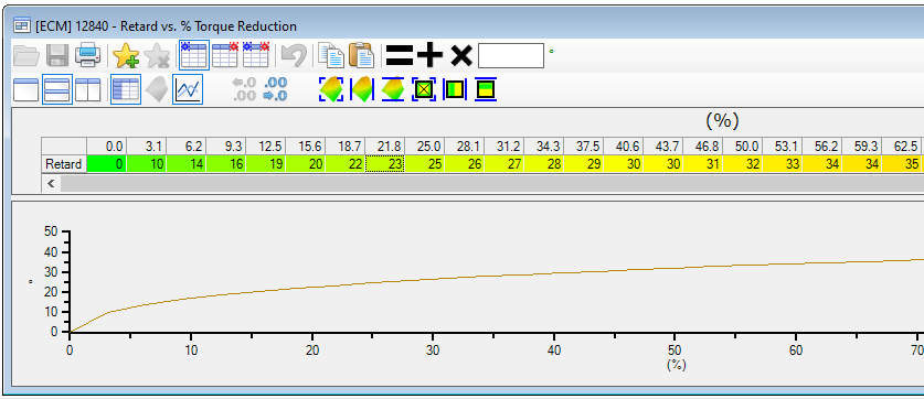

And the Spark Retard table is used in conjunction with the ETC TPS Max table to affect the amount of spark retard to achieve the desired percentage of torque reduction. Again ZZP likes to zero out this table and I don't believe it's a good idea in the Goblin.

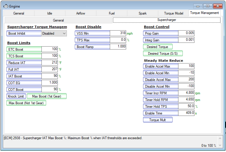

This entire tab is all about controlling and limiting boost. I'm not going to go into everyone of them, I'm getting tired. This is one of those areas that you can copy what I have and it should not be a problem. Basically boost is not limited. Actually on my car, the vacuum line to the solenoid has been removed so there is no way to limit it anyways, so for me, much of this doesn't even come in to play. Again the blue is stock and the green is not.

Fuel - General
