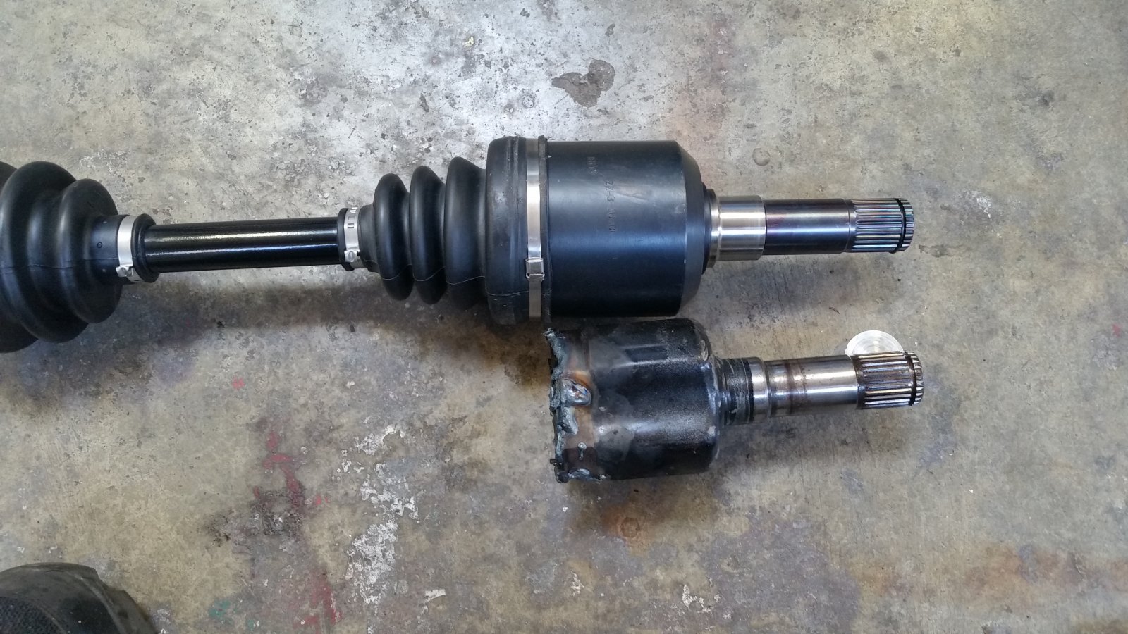

So in both cases, the axle popped out with the suspension bottomed out. From the picture the axle looks level without a load, so as the suspension collapses the axle needs to grow. I wonder if you can reduce the rear track width by remaking a new adapter that moves the rear hub inward the 1/2 inch on each side. I think you will either need a bit longer axle or reduce the track width. The track width can then be re-extended with wheel spacers.
George
Will be contacting Driveshaft Services to see lead time to make stage 2 axle for the left that is 0.400" longer. As will get the right axle stage 2 for the right. A spacer can be made b to move the engine,transmission to the left to make it be centered, left and center mounts will need to be modified and then make a 0.100 spacer for each outer cv joint.

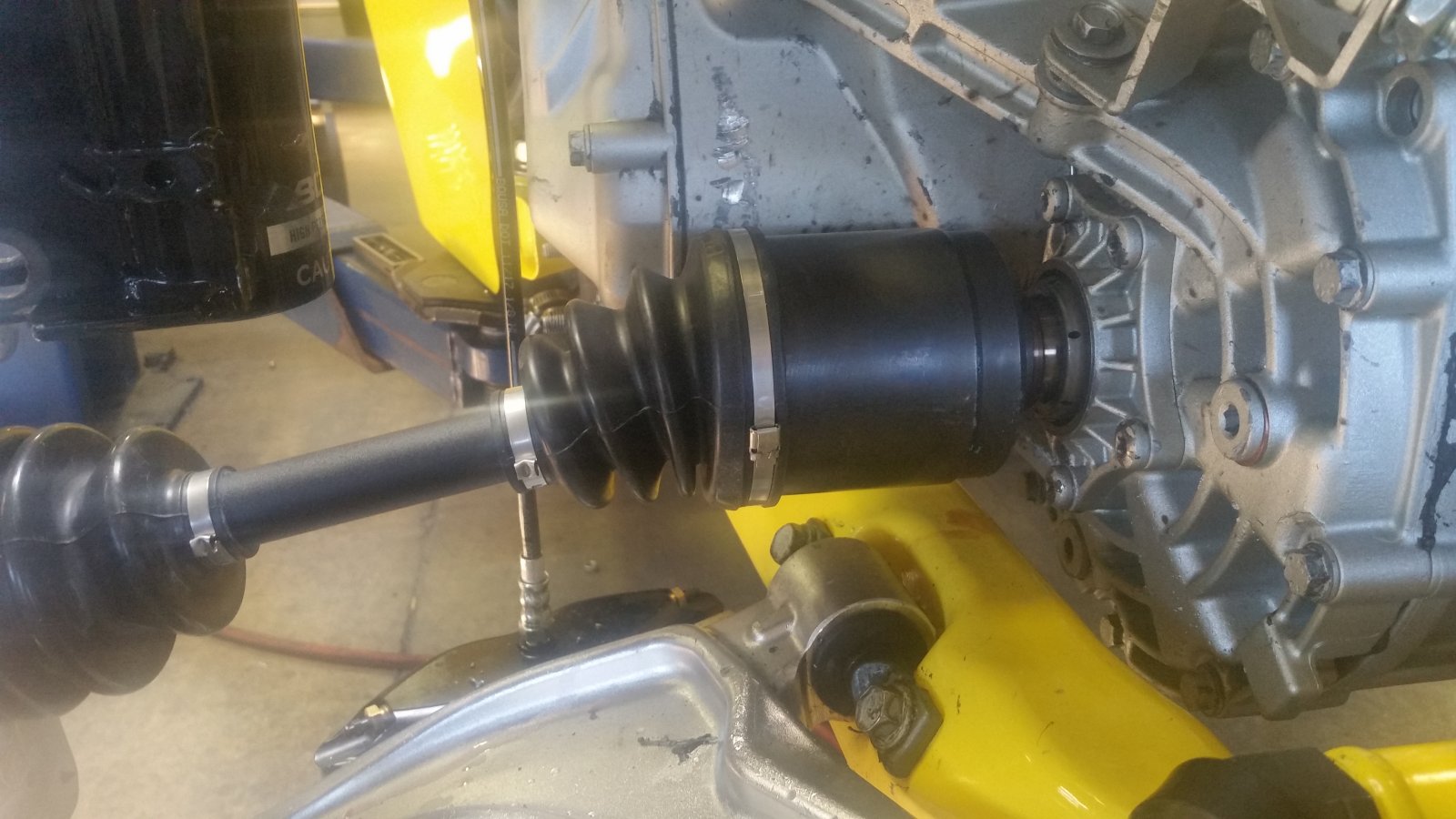

Moved the engine left 0.200. Now the inner drivers now are centered with the subframe.

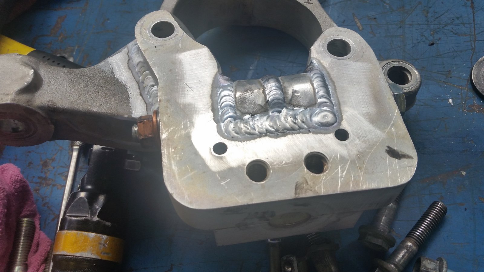

Welded balljoint extenders to steering knuckles then machined to accept The Driveshaft Shop level 2 axles. The axles have inner cv joints that allow for more misalignment.

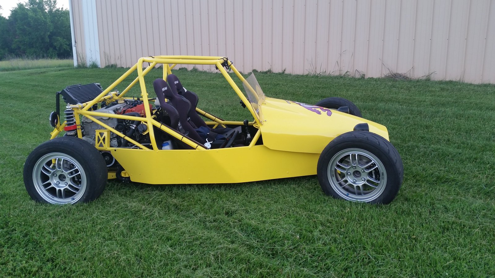

George
Put the windscreen as delivered and found the windscreen was at a 90 angle to horizontal. Since I had drilled the mountil holes. The tabs were bent 60 degrees from the horizontal. I feel the tabs need to be 25 to 30 degrees from the horizontal. If the center is at 30 degrees then the outer most tabs a 20 to 25 and the other two about half way between the center and outer. Modify
As needed to make it lay flat.
When I installed drilled the center hole 3.5 inches from rear edge the pulled the outers back to the edge of the body.
Currently at 70 degrees

George
Air flow. After driving around the city interstates today (82F) I have need to make some changes to the windscreen and air flow from the radiator. First need to make a front firewall above the front panel to fill up to hood. Next the windshield needs to be sloped more to the back. Currently at 70degrees need to be at 55degrees byt would have to repair the hood. The air is being pushed up 12" above my head and creating a back draft drawing heat from the engine
into the seating area, also the air flow over my heat exchanger is back words so I will shorten the windscreen by 3" to start with.

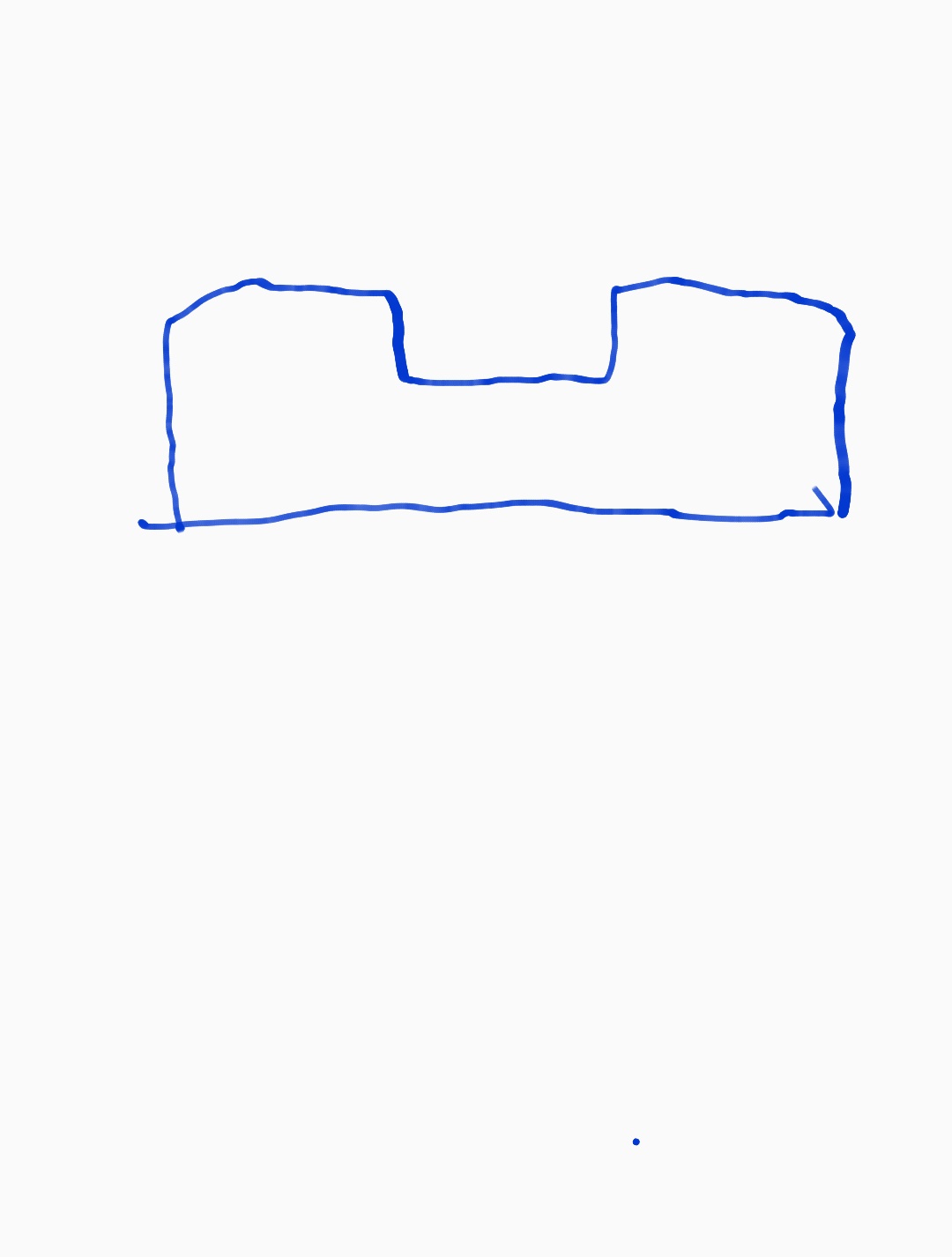

Waterdriver
It would be more work, but you could cut the center of the windscreen lower, letting the air flowing from the center of the hood, more or leass straight through the center of the passenger compartment, to the HE and rearward.
This is a crude representation, but what I could manage on my phone.

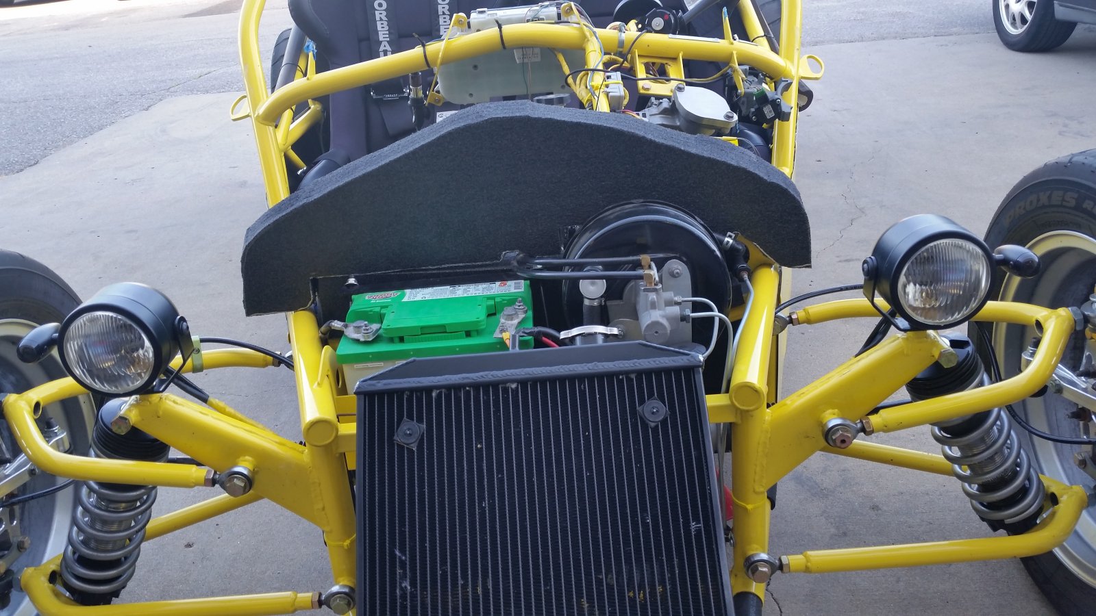

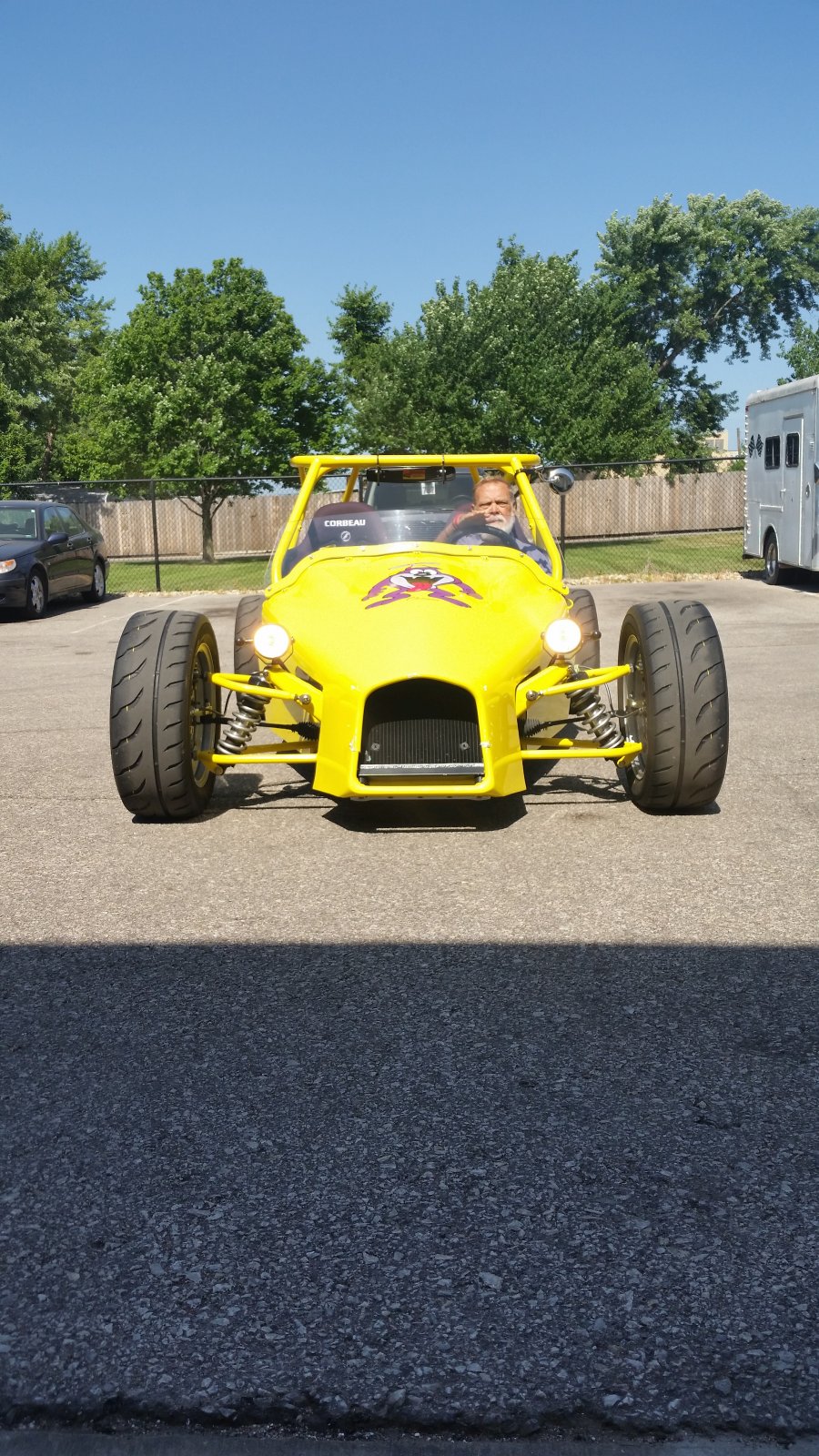

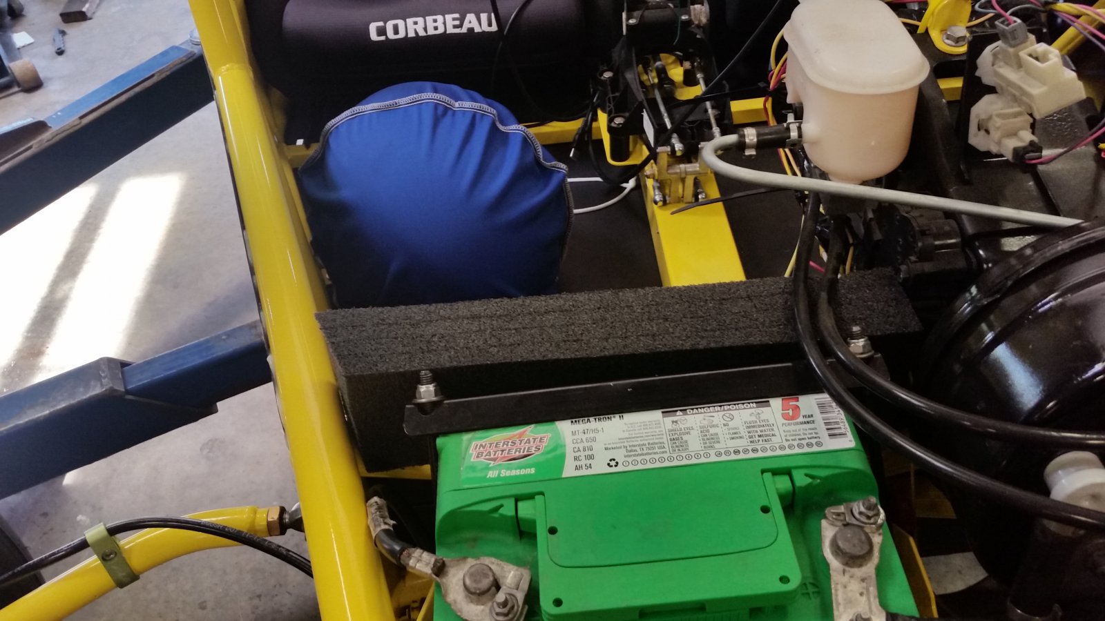

George

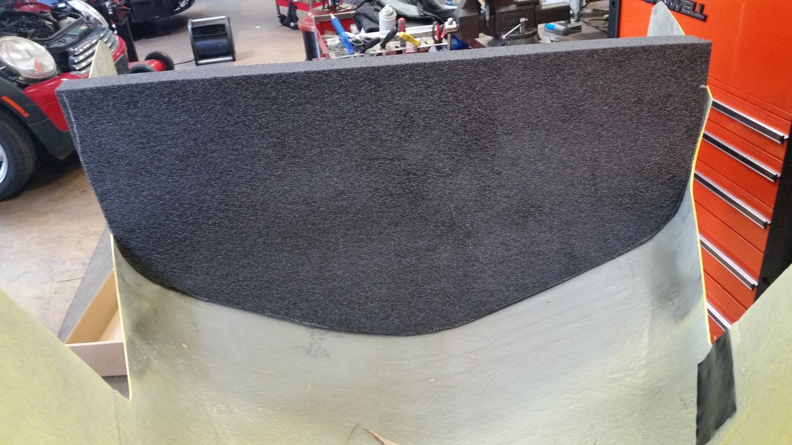

Air flow blocker is complete and install and test driven. This created a new problem. With out the air coming from the radiator the windscreen is now too short. The wind is hitting right in my face. Still no backdraft from the engine . Will have to get a new screen and start over.

George
Polyethylene foam plank Got it off amazon. It is for gun case. Does not absorb water and is ridged. I still have the cardboard pattern.
