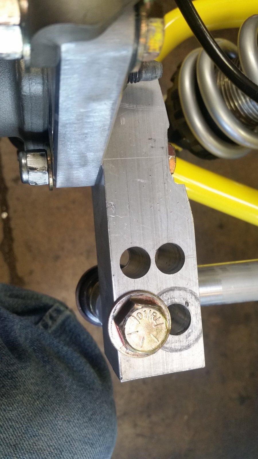

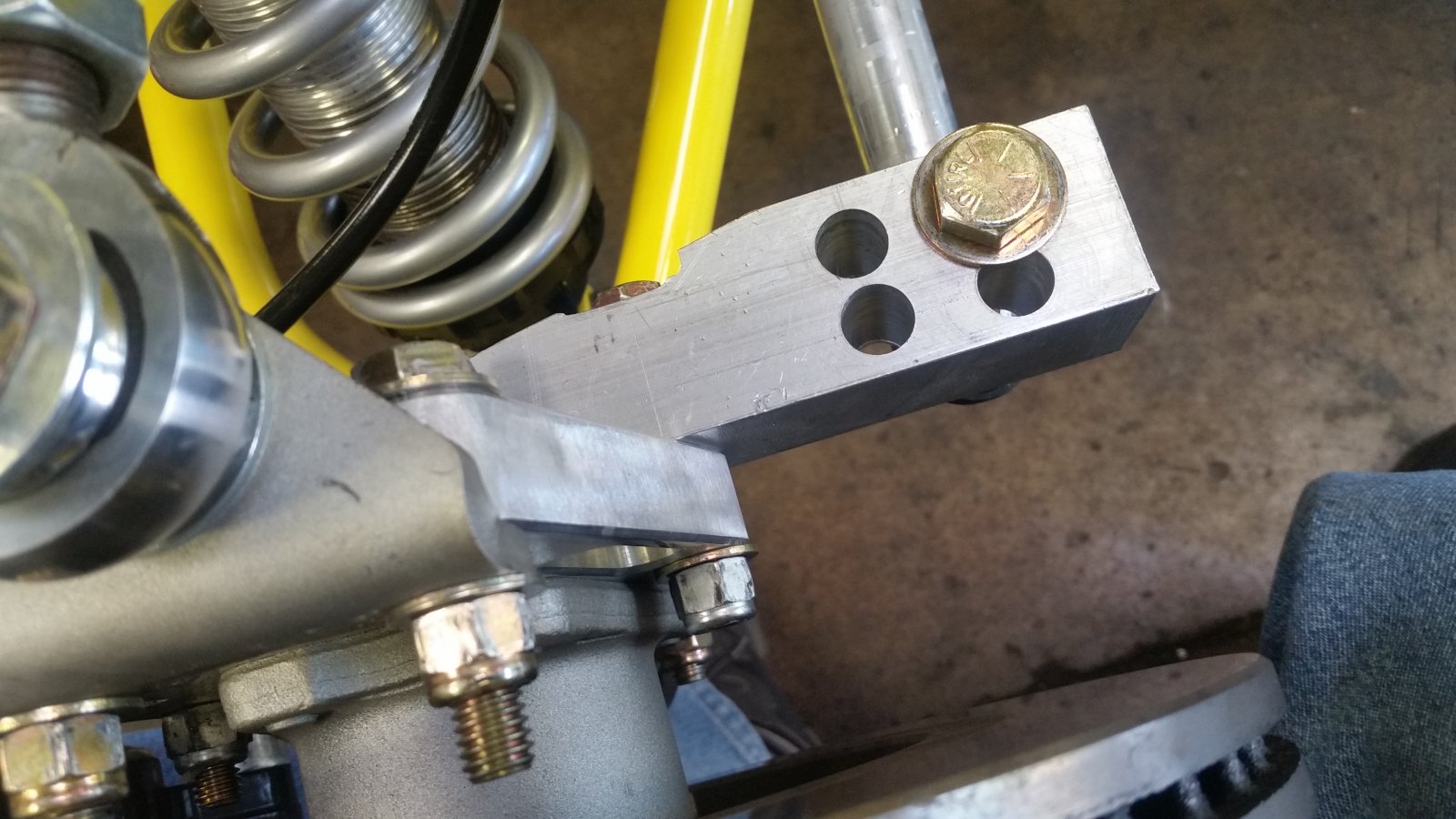

Changed front end settings. Reduced bump steer to almost 0. Reduced caster to 4.0 from 7.0. Thsee adjustments lighted the steering effort, improved frontend ride quality. Car does not dart left and right during rise and fall as before. It did create an issue in the turn. That being a small steering correction mid turn. Tomorrow will reduce Ackerman and see what effect happens.
I am happy with the changes so far.

Changed the Ackerman to almost 0. Car feels better in the turn. No correcton in input needed. Need to play with different toe setting to smooth out the feel when turning from driving straight. No other side effects.
May have to raise rear tire pressure. waiting for my test driver to check it out.

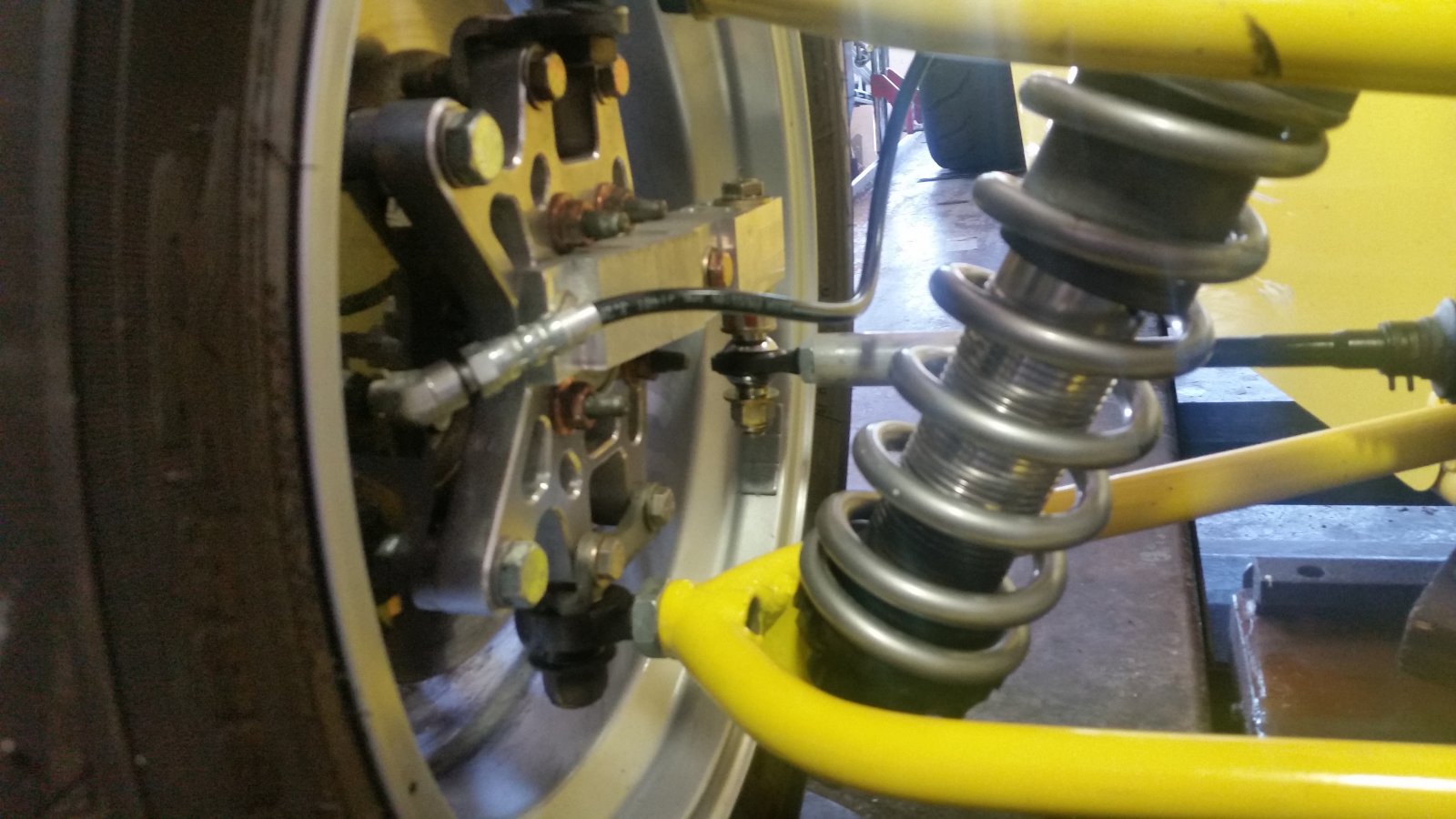

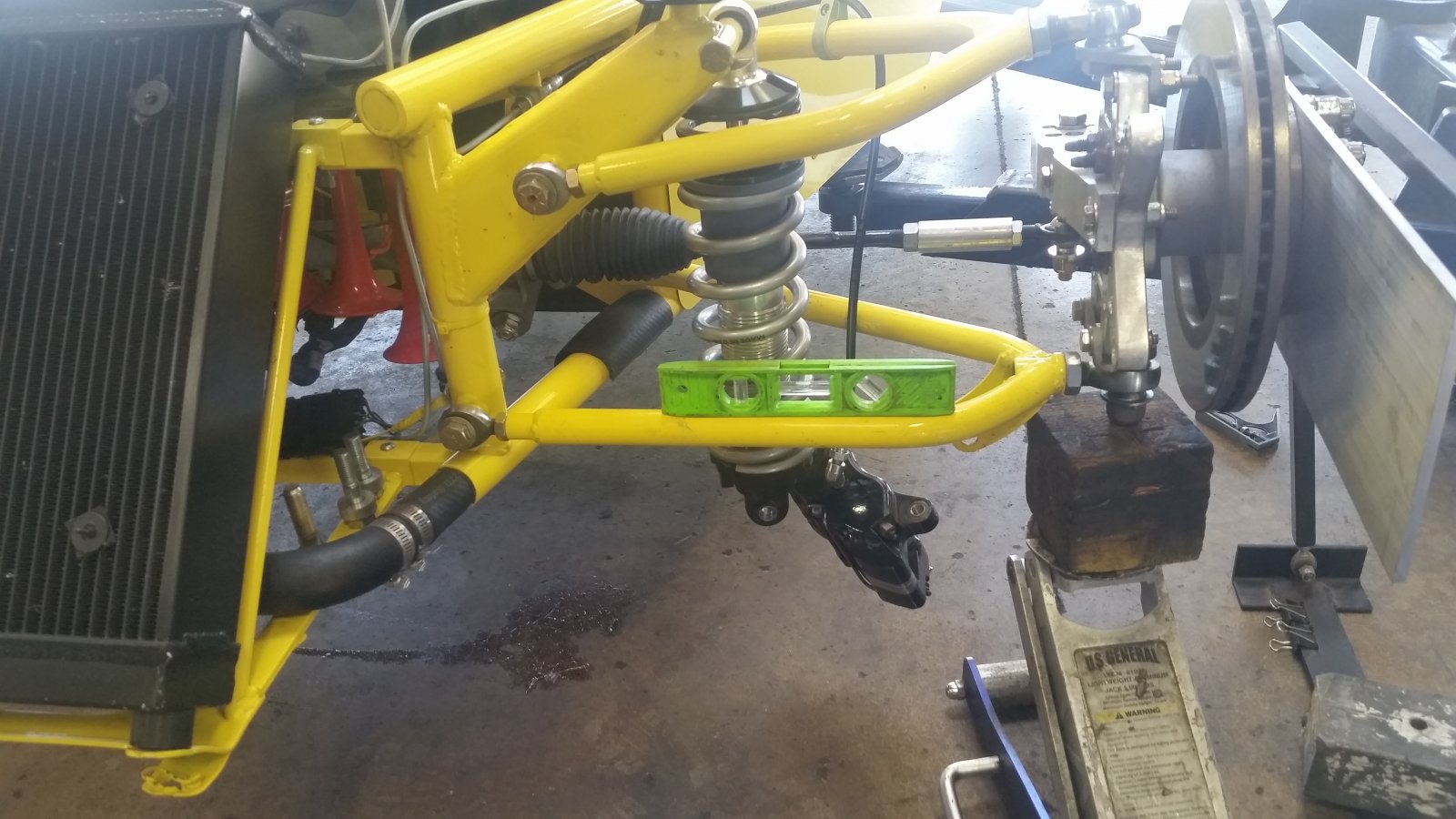

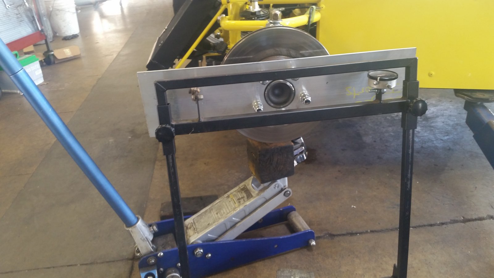

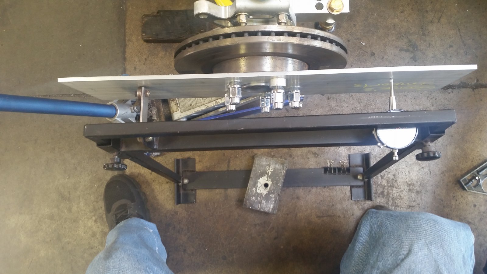

Borrowed a bump steer gauge to do a more accurate adjustment. From ride heigth to 2" of bump 0.010 and from ride heigth to 2" droop 0.010. Before adjustent it was over 0.100".

While I had the bump steer gauge took the opportunity to adjust the rear also. Adjust corner weights and realigned.
Test drove, car is steady over uneven surfaces and bumps and very precise with steering input. The toe does not change when getting in and out of car as before, before had to set the toe with driver in car to get it close. With the removal of bump steering that is not the case. Steering does not self center as well with the reduced caster but is fine for me.
A recap of why the changes were made. Elected not to install power steering when building car, with only 600 pounds on the front end seemed unnecessary. On the rear suspension install ball joint extenders so that the car could be lowered and keep the geometry correct in the rear. Was also able increase the rear roll center height to reduce body roll. Install spherical bearing outer tie rod ends front and rear to make the bump steering adjustable. Hopefully someone that has put some miles on a as designed car will come by and test drive it for comparison.

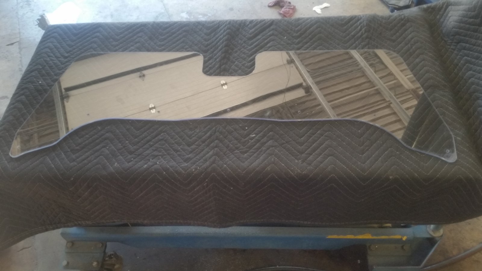

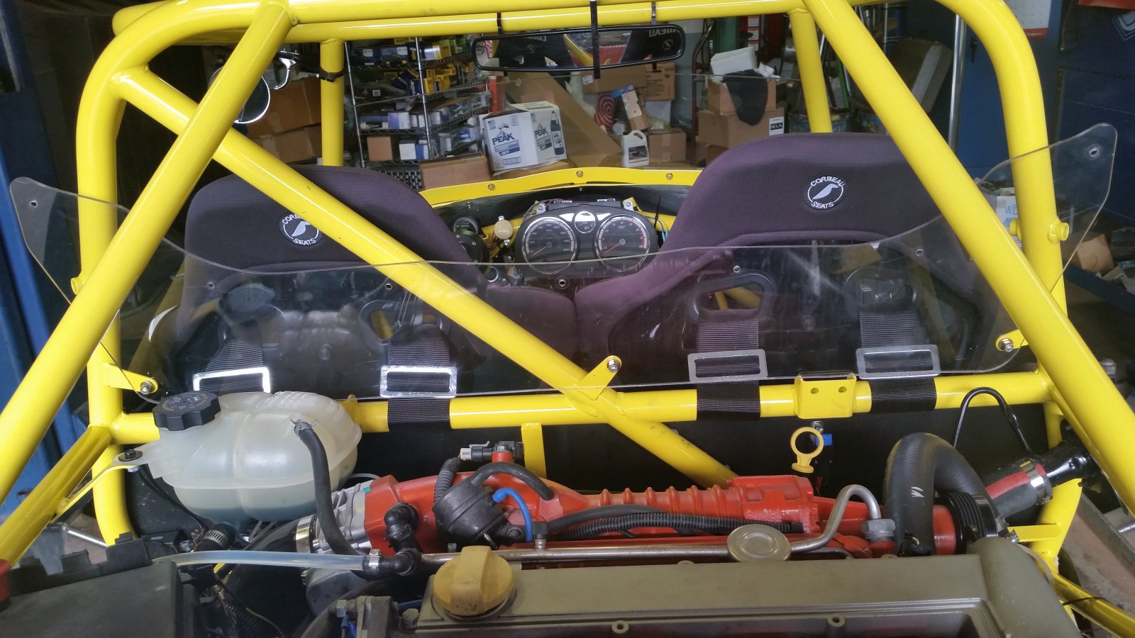

The air flow from over the top of the windshield comes back over the engine and dumps hot air at the back of my head.
I blocked of air flow from the radiator to the cockpit, the windshield has been tilted back to about 70 degrees from 90.
Took a windscreen that as been shortened installed it upside down and mounted with three screws. It rained so will have to test tomorrow

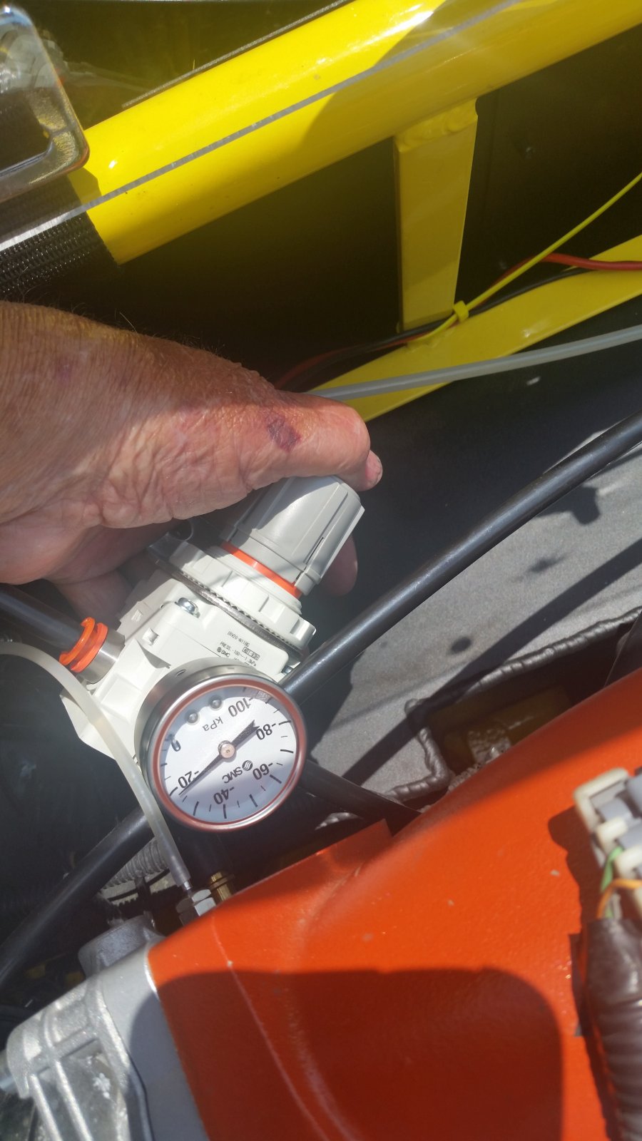

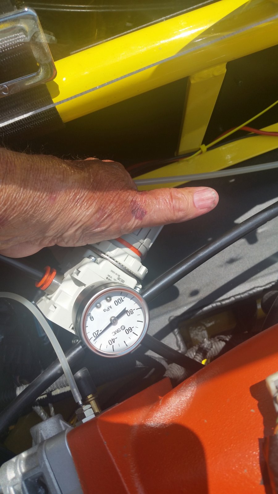

Added a vacuum regulator to the brake booster line, idle was -40kpa adjusted down to -25kpa. Brakes are more manageable, can still lock them up but feels is 100% better. Since it has a vacuum regulator even on hard deceleration the amount of pedal feel does not change. I like this so far.

Received my scratched windscreen cut a 4" deep 6" wide slot. The air hits the mirror (track frame) and dumps in to the passanger area. Going to increase to 6" deep by 8" wide.
Brad
Im going to look into this. Is there a model you prefer or just any sort of vac regulator will work?
I wonder if I could turn a small barbed fitting with a small hole in it to do the same thing.
George
http://www.smcpneumatics.com/irv-series.html The one I used had 3/8" tube fitting which is the size of the as the brake booster hose that came with the DF kit.
Mine came with a gauge. The regulator does not create a vacuum leak and maintains vacuum even during decelleration.
The bleed off method method will creat a vacuum leak and vacuum will vary a lot as manifold vaccum changes
