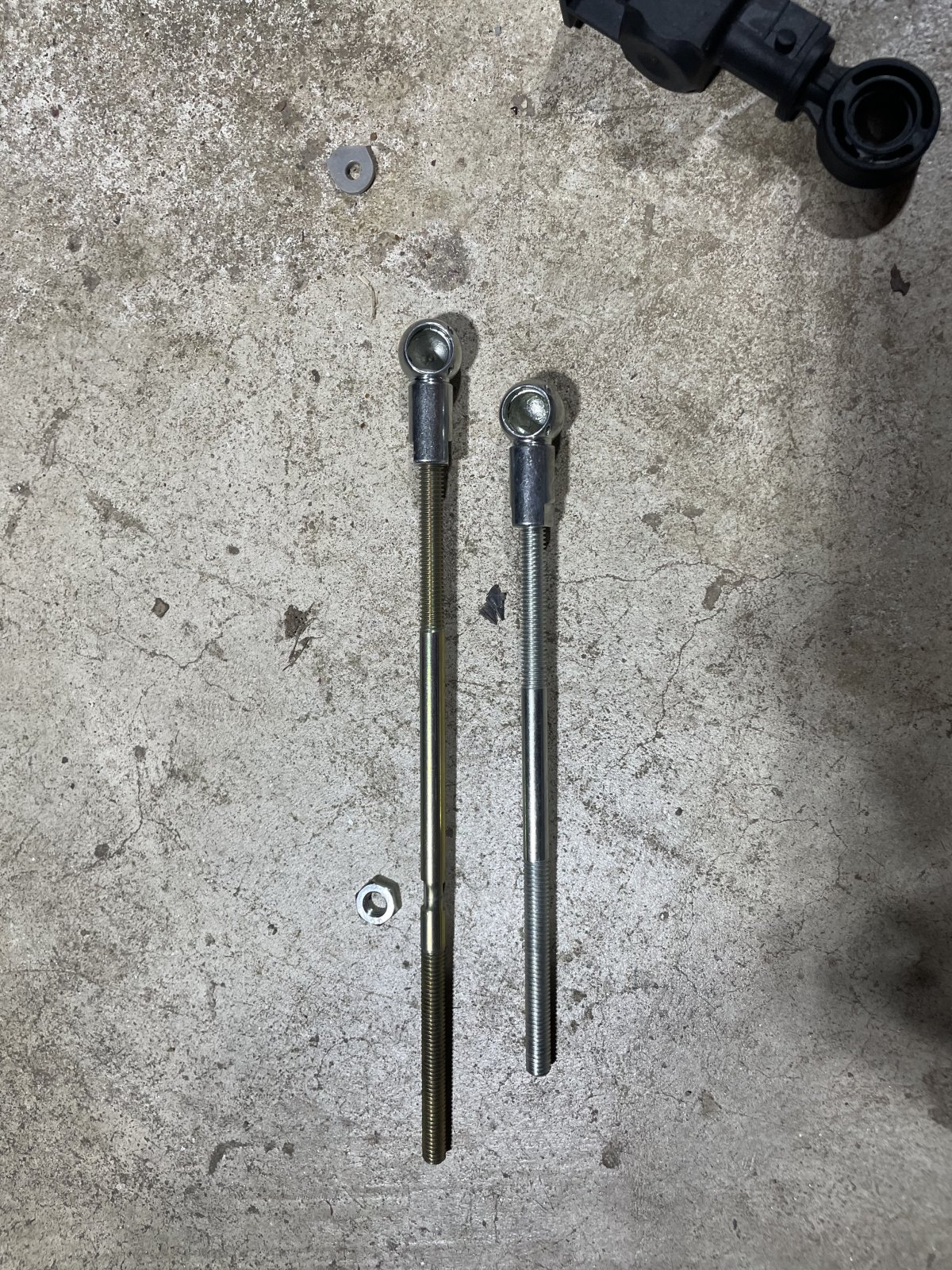

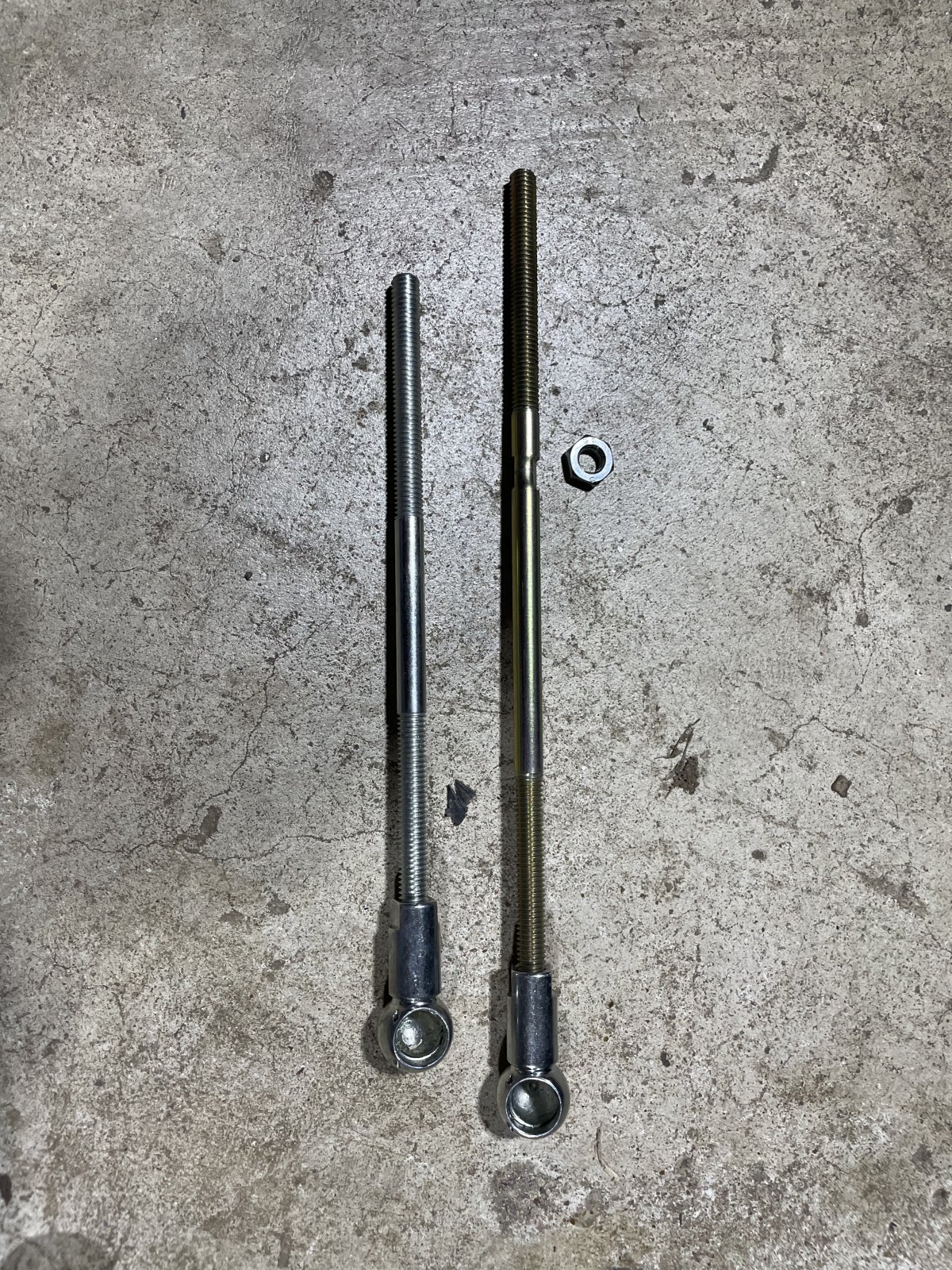

Robinjo Goblin Guru Robinjo Goblin Guru Sep 15, 2022 #1 I’m on my third set of the pictured rods. One end threads with no issue, the other end won’t start for anything. Is there something I’m missing? Attachments 274DA84A-6AB3-4AE1-B16C-C82F093620A8.jpeg 705.5 KB · Views: 344
Ross Goblin Professor Ross Goblin Professor Sep 15, 2022 #3 They sell rod ends that are left handed and right handed. Female, Rod End, LH, 6mm Zoro #: G9171075
Robinjo Goblin Guru Robinjo Goblin Guru Sep 15, 2022 #4 Thanks guys. Dang it I could have been done 2 weeks ago!
