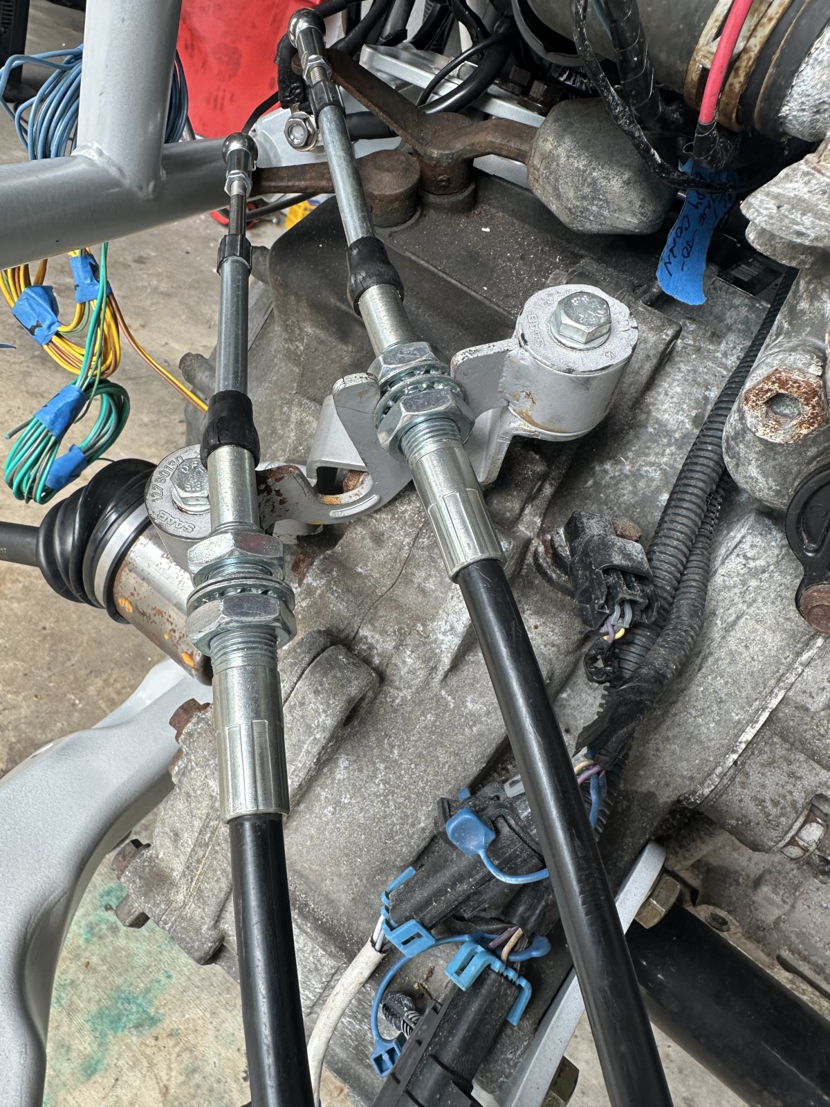

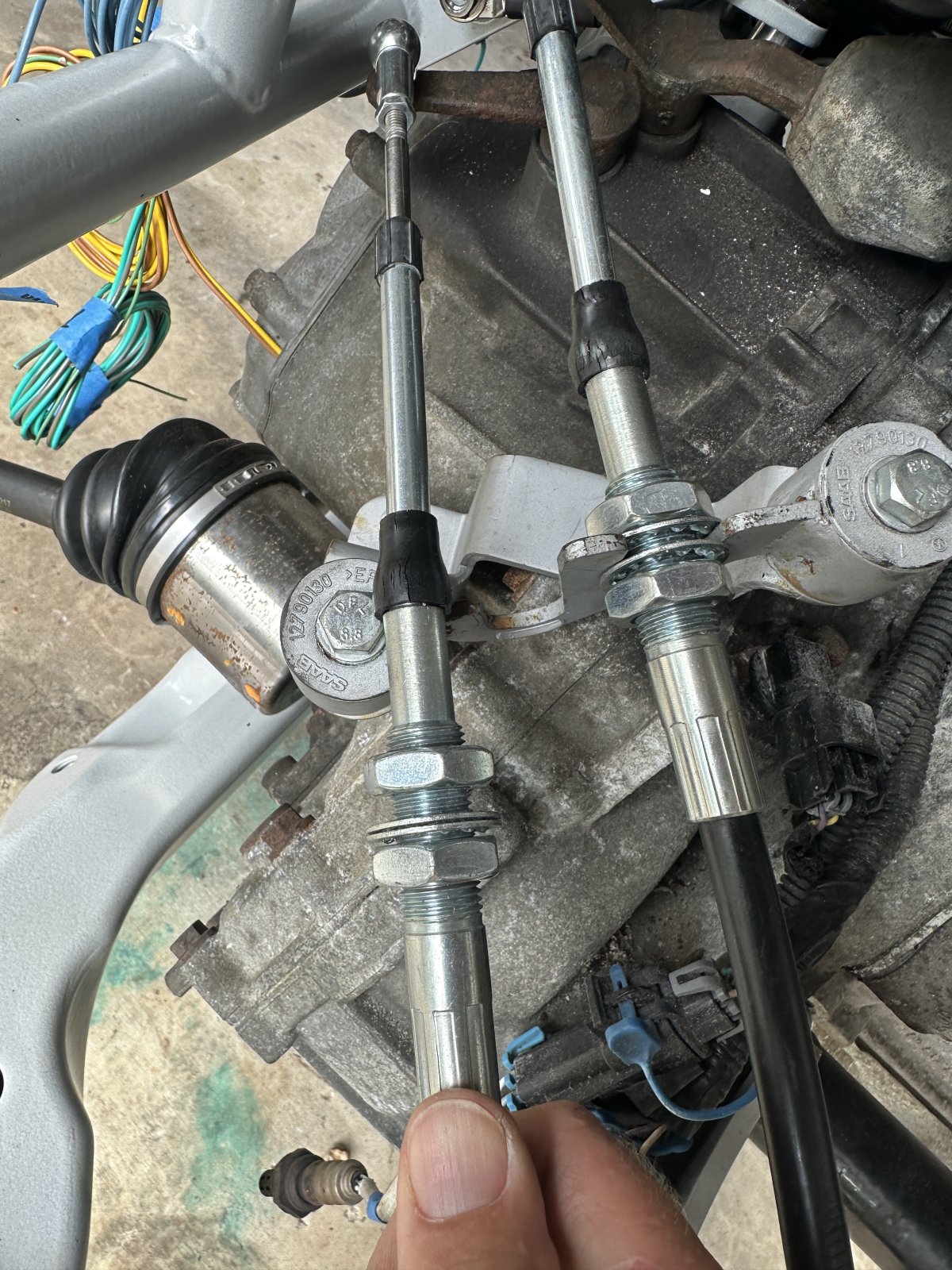

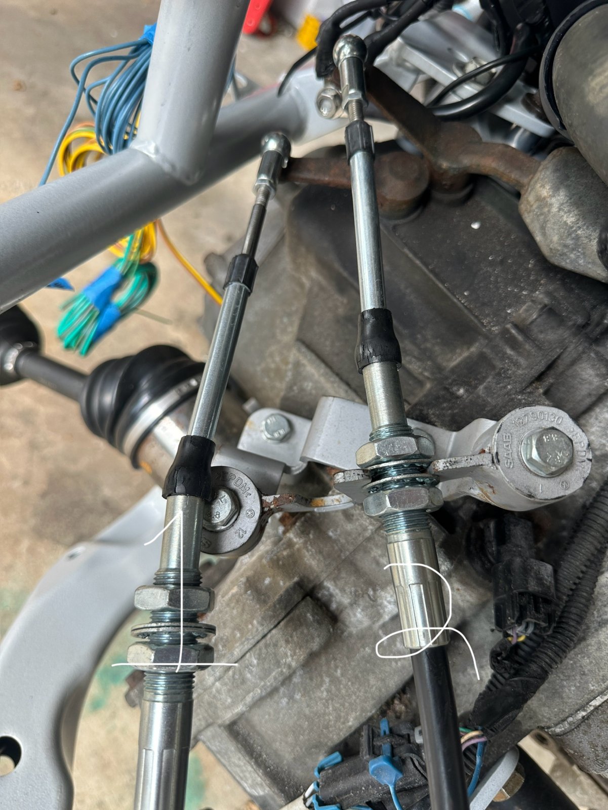

One of my shifter cables will not seem to fit into the bracket when hooked up to the transmission. Are my cables hooked up correctly? If so how can I adjust them so that they fit into the bracket?
comegetjoe
One of my shifter cables will not seem to fit into the bracket when hooked up to the transmission. Are my cables hooked up correctly? If so how can I adjust them so that they fit into the bracket? View attachment 53447View attachment 53448View attachment 53449View attachment 53450

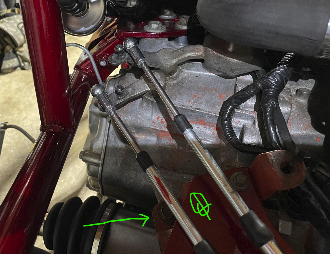

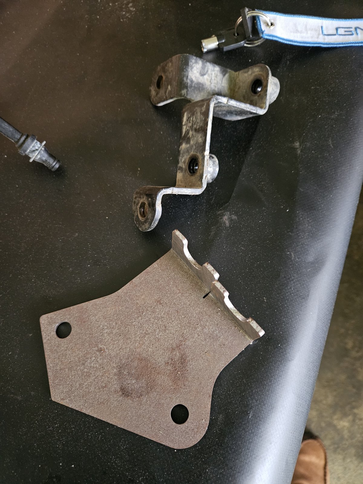

The F35s have a plate that you're missing in your picture.

Thank you. I found the shifter plate in the baggie for the shifter hardware that I am not using. I am using the anodized shifter kit.
