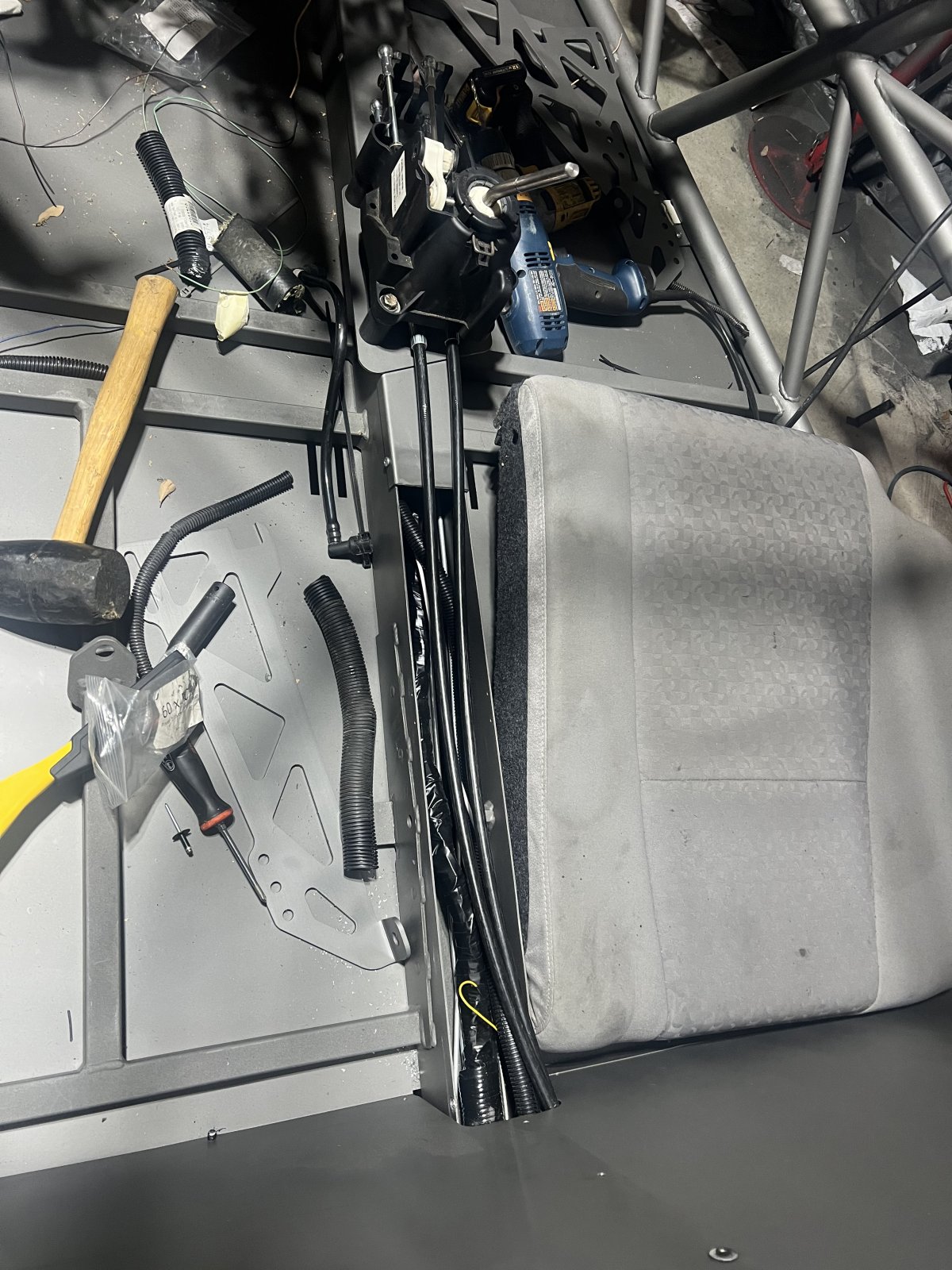

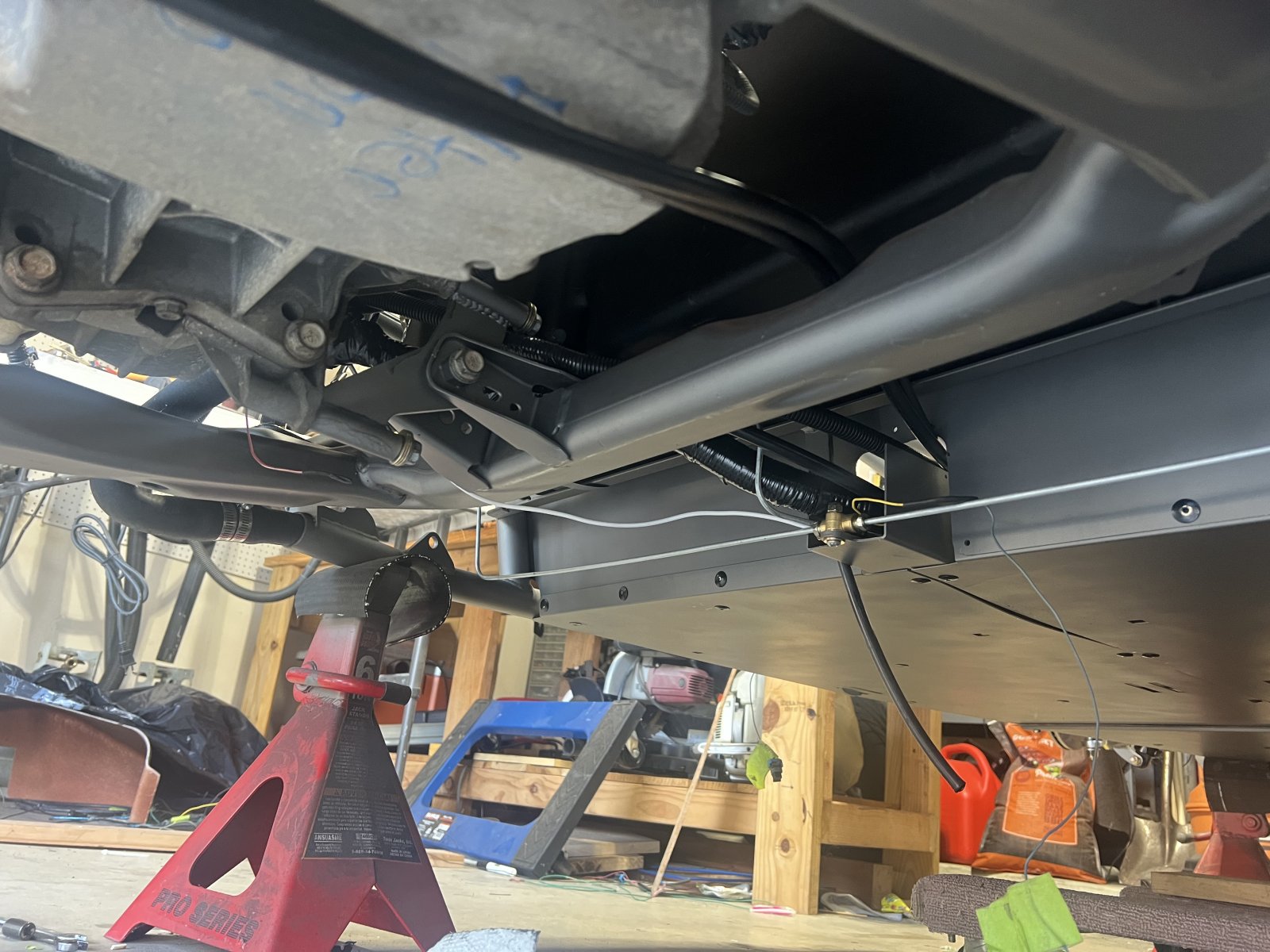

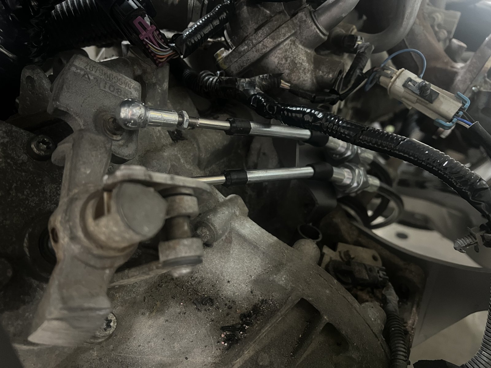

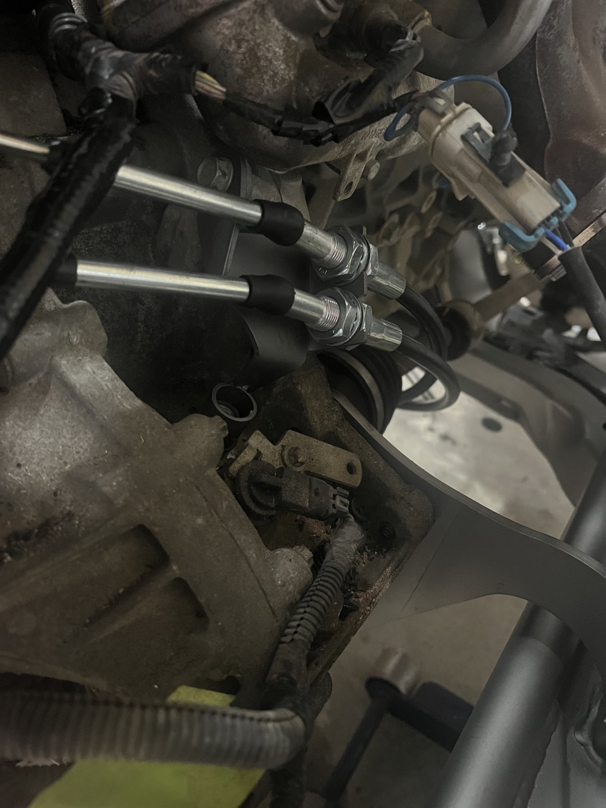

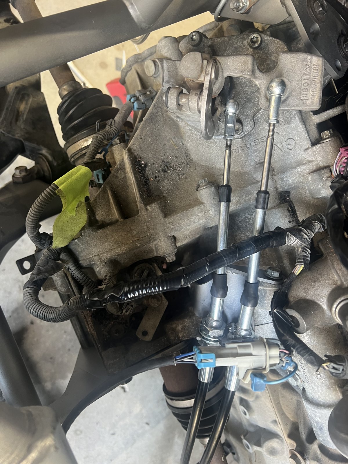

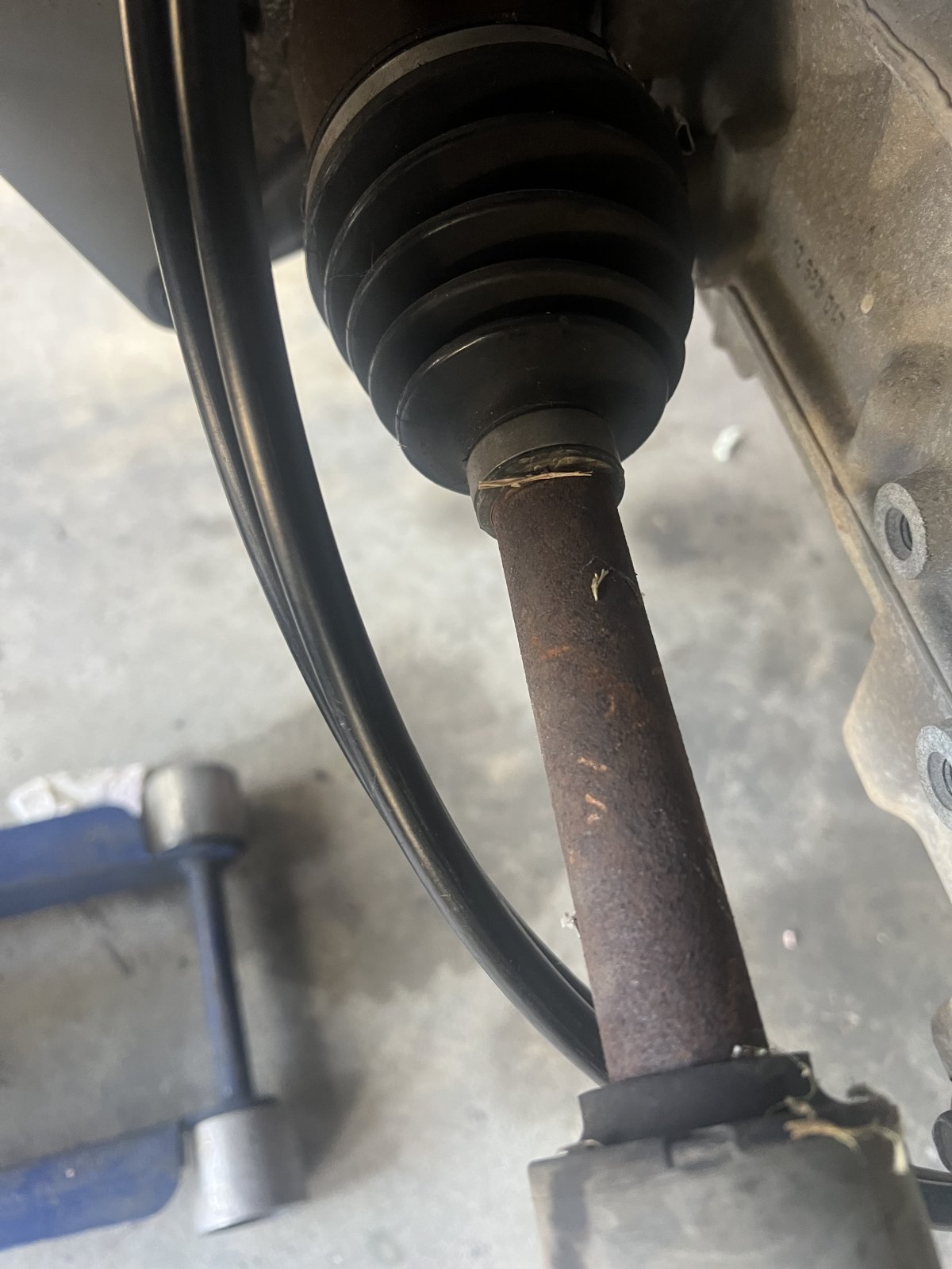

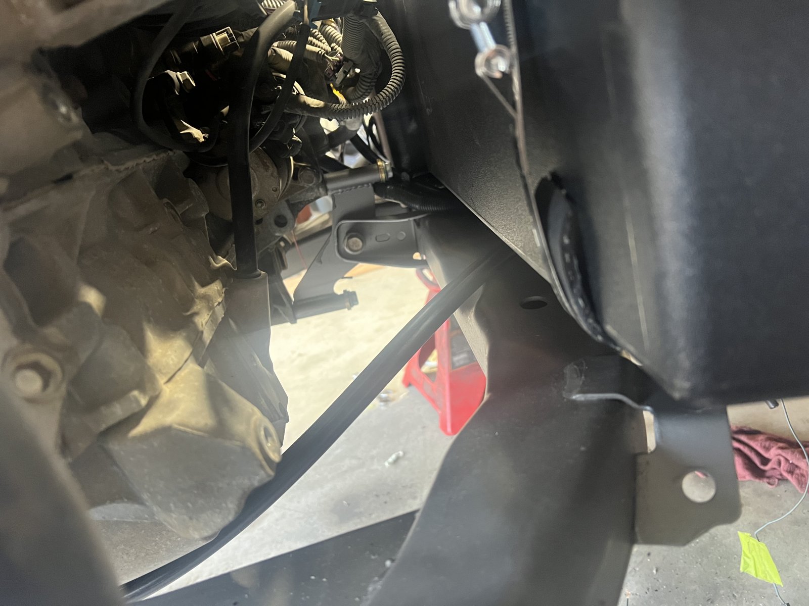

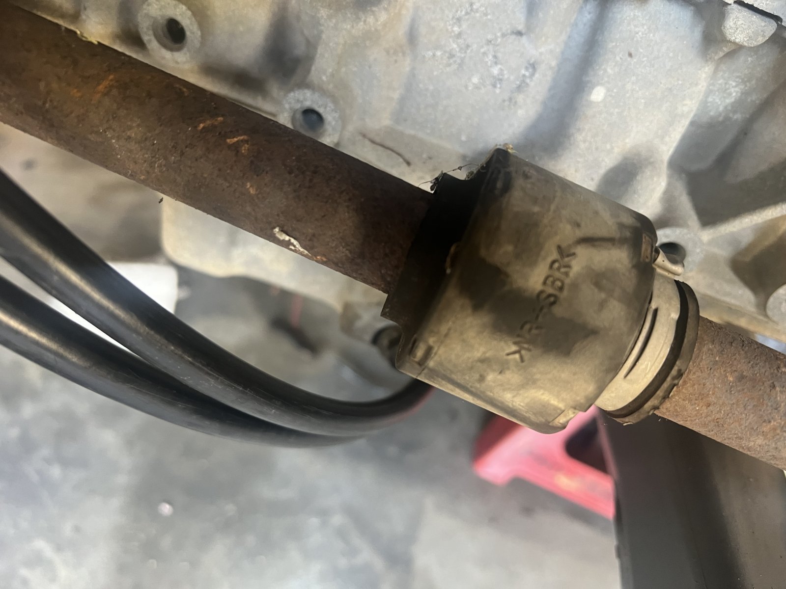

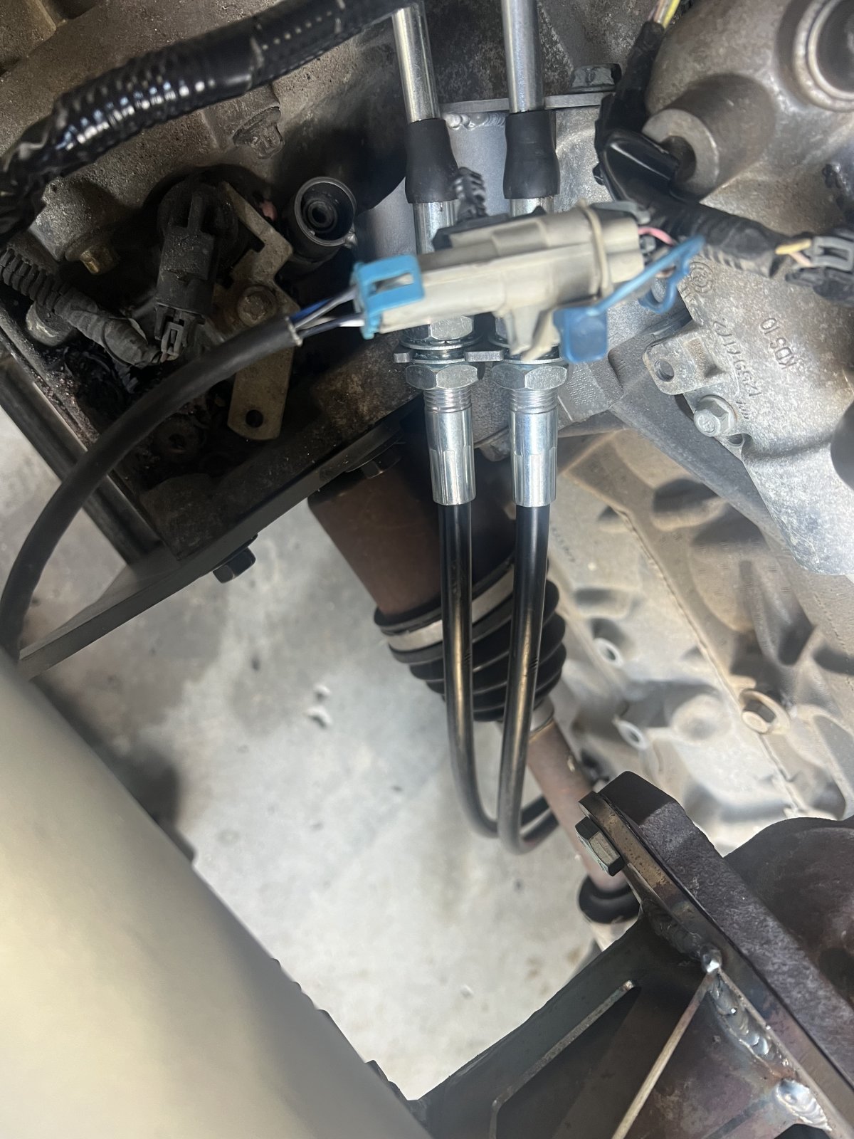

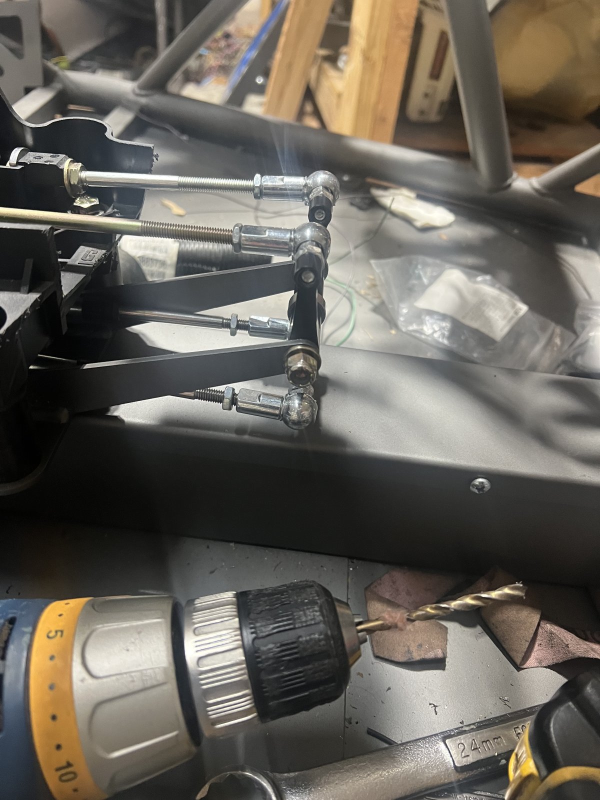

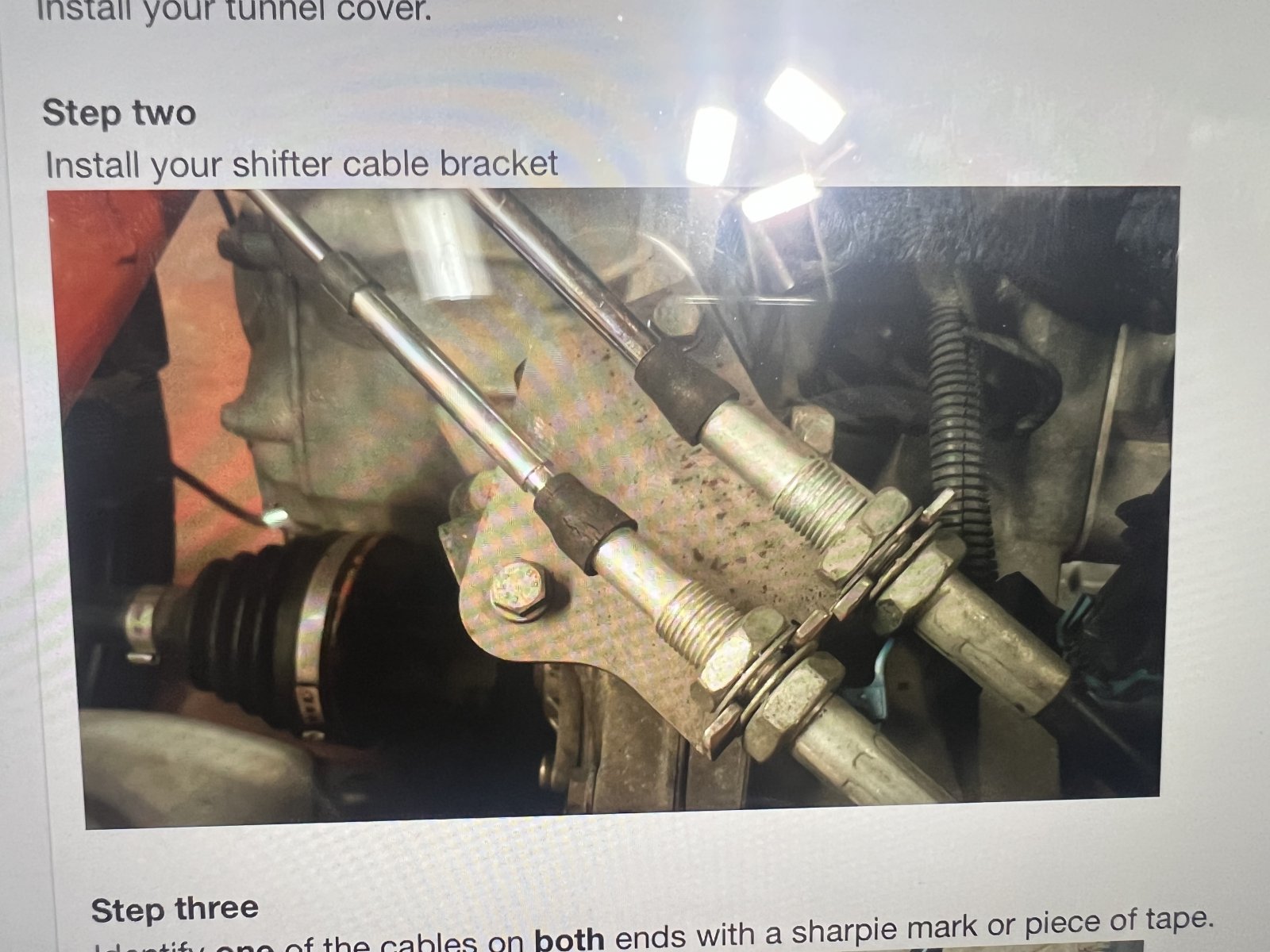

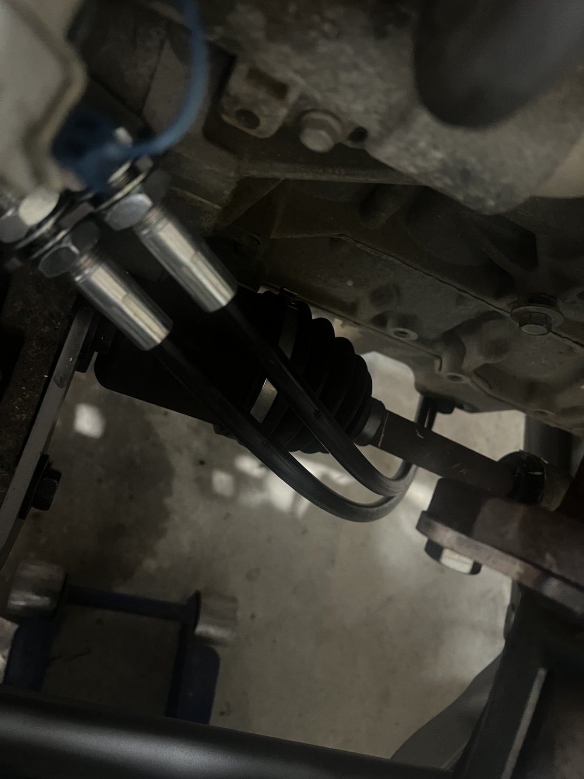

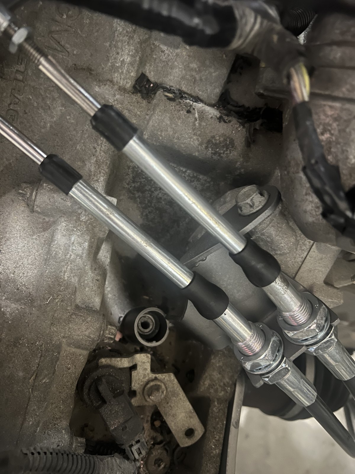

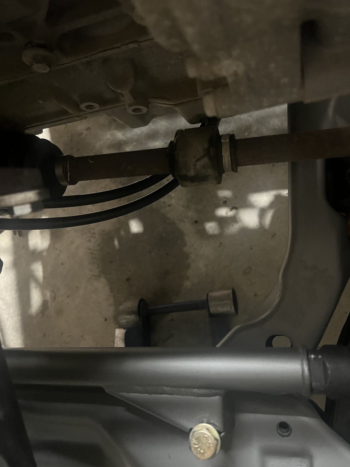

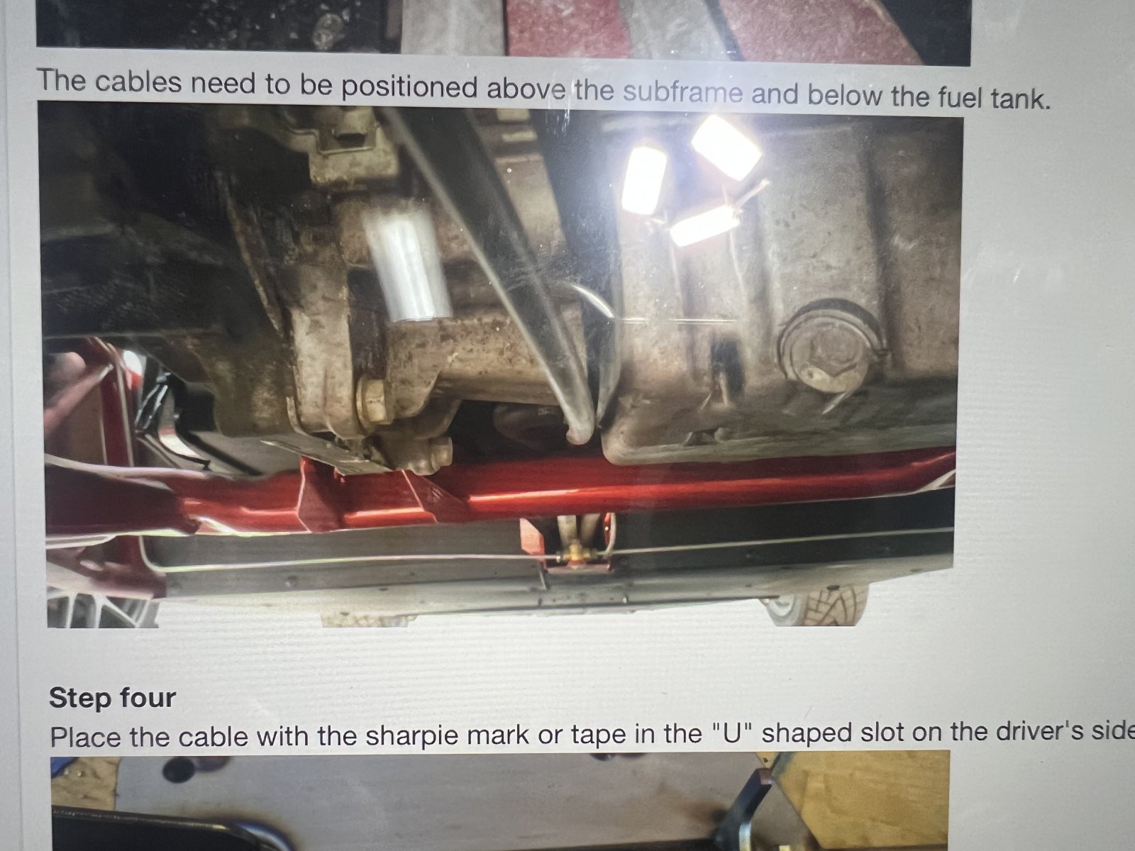

So Iam uncertain if the shifter cables route closer to the oil pan or around the passenger axle. I followed Lonny’s pics but don’t see what Iam looking for and I have a different transmission cable bracket then what Lonny’s cable install shows.

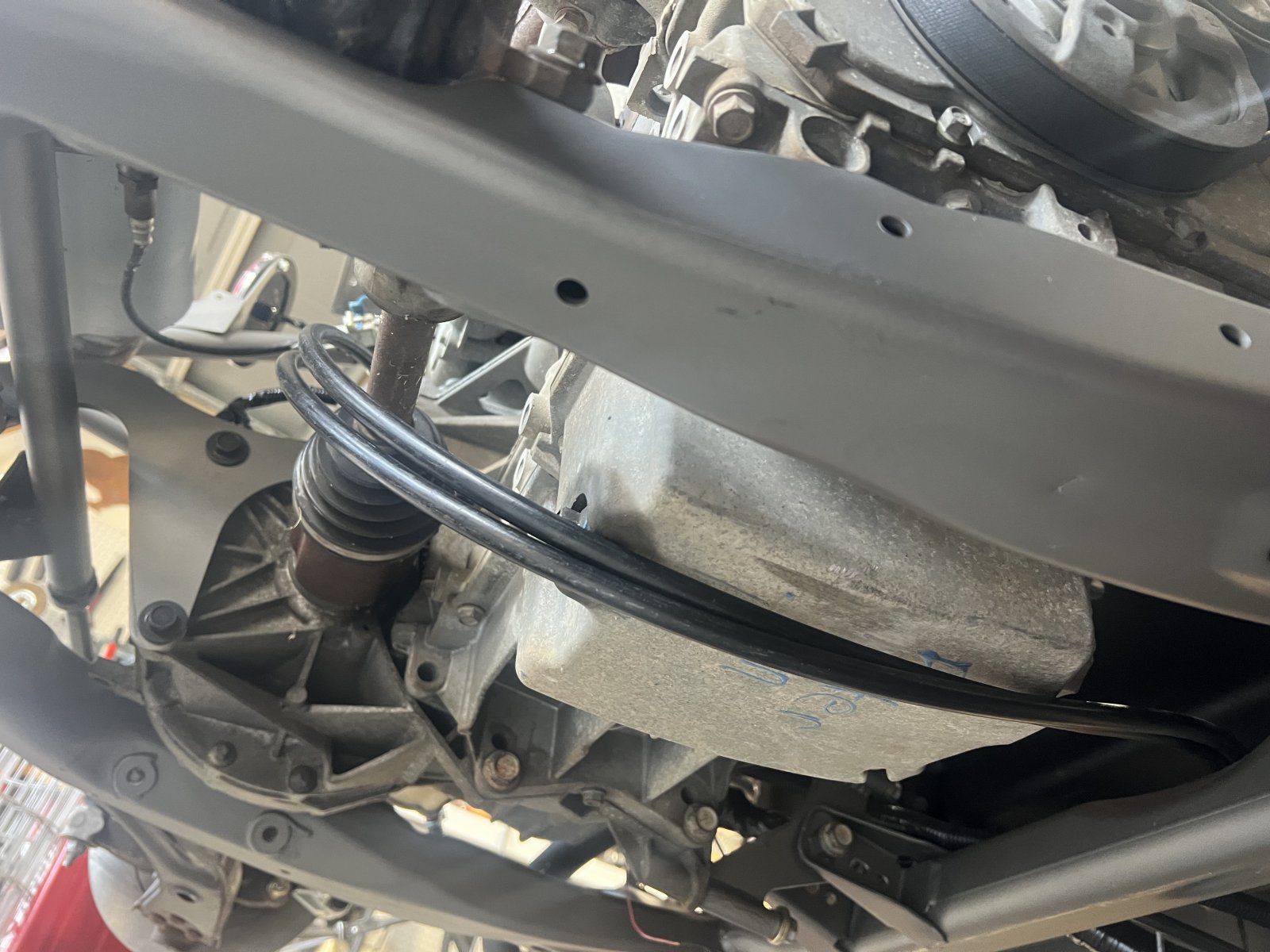

D&dgoblin69
Completely different setup on this f23
And not too close to any exhaust pipes, otherwise pit some insulation around the cables to prevent overheating. Several builders have found this out the hard way unfortunately. Always better to be safe and avoid another case of gummed up cables making for hard or no shifting. :D
D&dgoblin69
2009 colbalt 2.2 lap base model shifter cable routing. At this point I have 5 gears and reverse. Yet to drive it but I can put them in position so it’s 90% there’s no problems. Somewhere on this form there’s a 12 step process to install but the brackets on mine are different. Maybe this will help someone one day
