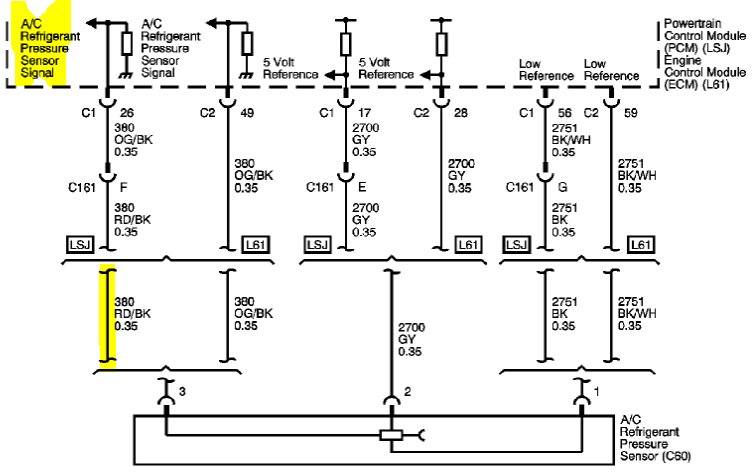

I have a feeling it will need to be tweaked to match the gauge, whether it's a difference in formula or voltage interpretation by the ECU. If the exercise is to log what the gauge is showing, it will need something to make it work. I'm just not sure what that tweak is at the moment.
Wouldn't the tweak be a simple math offset? Like when we changed from .58 to .5 offset.
Add a correction offset, drive the car, and see if the gauge lambda is reading the same as the HP Tuners math calculated lambda.
As far as the formula is concerned this a linear y=Mx+b equation where m is the slope and b is the offset. Their formula matches the data table they gave you. If their data isn’t right then you will have to get the voltage and lambda at two points far enough apart to be able to calculate a new offset and slope. With only a single point of comparison you don’t know of the slope or offset or both are wrong. I would confirm that your wiring has pretty much 0 ohms resistance and if that checks good check with your WB manufacturer. How do you that the gauge is correct and the voltage signal is incorrect?
another thought, you did tie the sensor reference ground to the low reference wire from the ECM?
Sluggonaut
I have not confirmed, it was merely an assumption especially since everything I've read suggests some sort of adjustment to the offset is normal.
I have not logged anything besides the few minutes idling in the garage. I need to get a camera set up to record the gauge so I am not just comparing occasional glimpses to a recorded log file, as that will be hard to match up.
I connected the white analog wire from my AEM WB to the red/black AC Pressure Sensor Signal wire. I am not sure if anything I have done so far is correct and hoping to get some sort of result to see if I've stumbled across a usable solution. Once we get through this next stretch of rain, I plan to get some actual driving data logged and gauge readings recorded.
I would swap the brown to the ecm low reference for the AC pressure switch (Assuming your's is like this 30-0300 X-Series UEGO Gauge (aemelectronics.com) ). "the BROWN wire must be connected to the negative of the analog input of the logging device or ECU. "
I think this is for the 2006 but yours is probably the same. I hope you are soldering you connections also. All of the connections need to be as low resistance as possible.

Mine is the 0300 X-Series UEGO. I read that and made it down to the last section of the paragraph you referenced that said to use the power ground as a last resort, as I wasn't sure if the low reference wire was the same as the 'negative of the logging device'.
I'll try to fish a wire through the tunnel and switch the ground over to the low reference wire and see what it does. It'll check the resistance while I am in there.
My wire colors were the same as the 2006 reference from Alldatadiy.
Just an update for others searching this topic, Al from ZZP states that the low reference line can be used, but he has had the best results using the same exact ground as the gauge. Either way is fine as long as it works.
