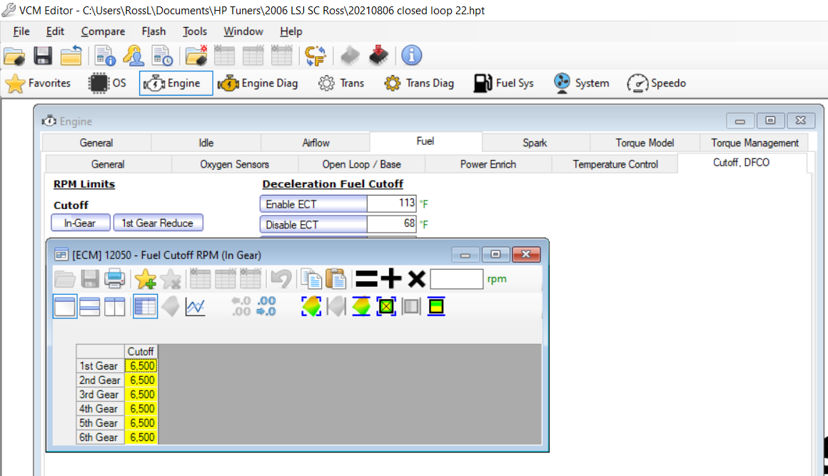

So I'm in the same boat.... can a tune raise when the rev limiter kicks in... not like a 1000rpms but it seems like 250-500 would help. Getting used to about where its going to hit but it would be nice to have a cushion.
Sure can. Pick any RPM you want to limit.
Maybe the Fuel Cutoff RPM by Gear works for the automatic, but my standard never shifts thru the gears in this table. I think it all 1st gear according to the PCM. But that becomes the RPM limit for the engine.
Yea... looks like a tune or a tuner will be in order this winter... for first I thing 250 rpm would be good and 150 for second would make a world of difference. You ears can only do so much and trying to watch the tach on a launch is less than ideal.

If you have the standard transmission, you don't get to pick RPM by Gear. That only works for the automatic transmission.

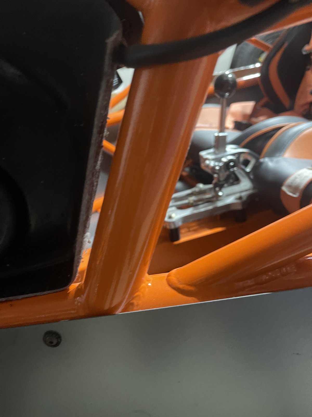

Does anyone have pictures of theirs footwell cover installed. I’ve been fighting with mine to get it all the way back to upright bars. I even took the power steering motor per Lonny’s suggestion to see if it would help. Any close up pictures from the front and side would be much appreciated.

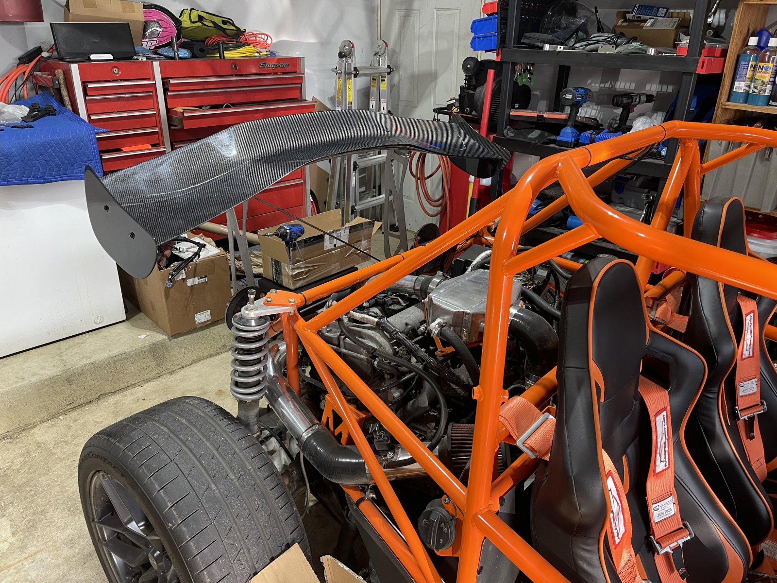

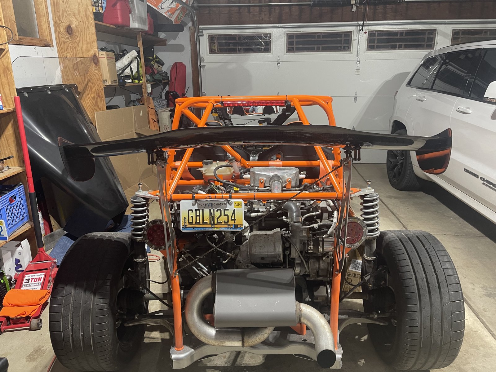

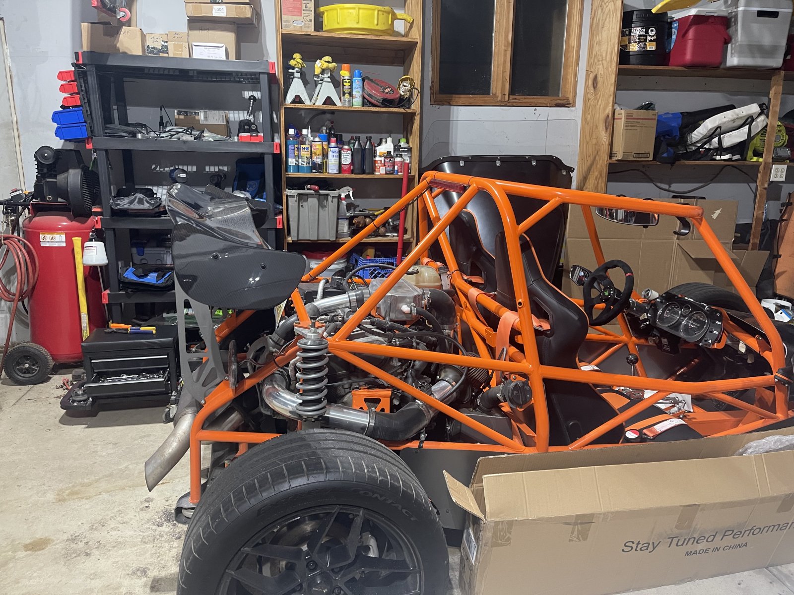

Got my cheap wing from eBay installed. It does finish up the rearend but I think it won’t last long so hopefully get a year or two out of it then get a NRG or Sibring
You could try it this way as well:

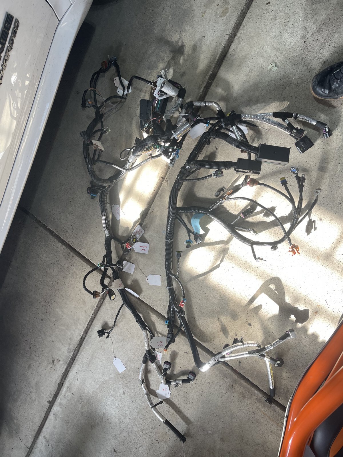

Well I decided I’m to lazy to drop engine so I just pulled the harness while in the car. So out with the old in with the new.

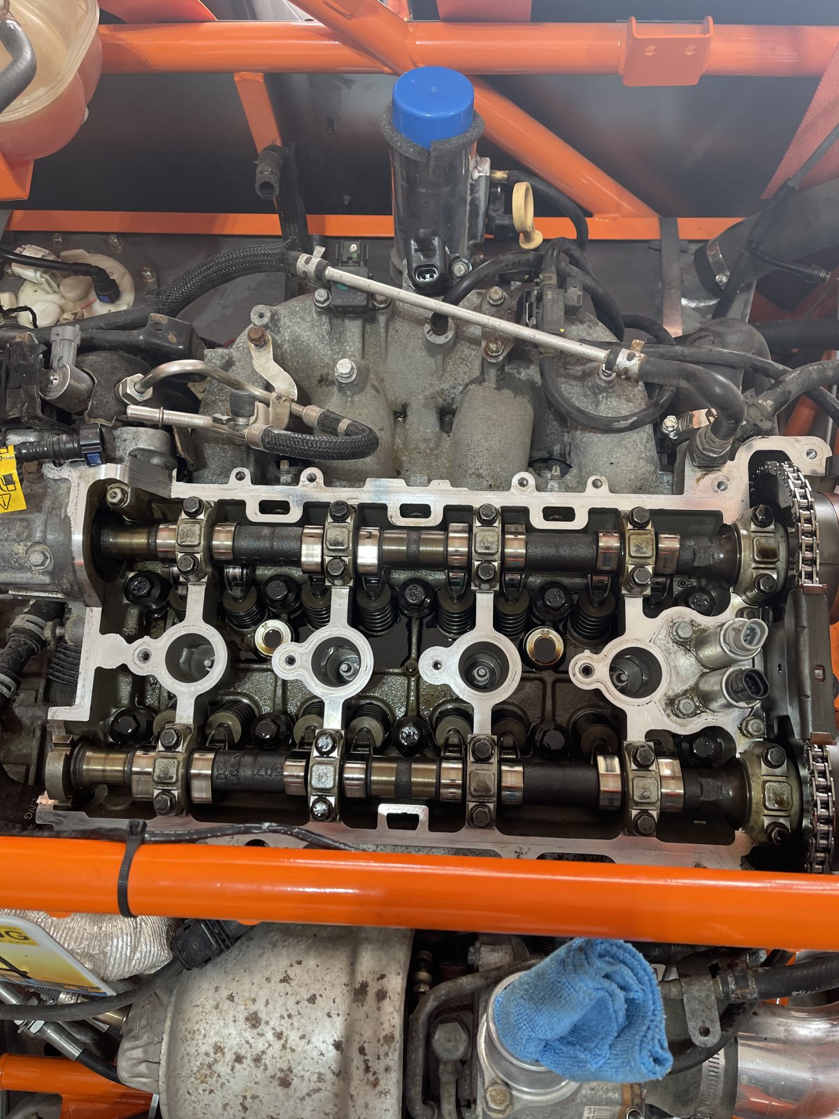

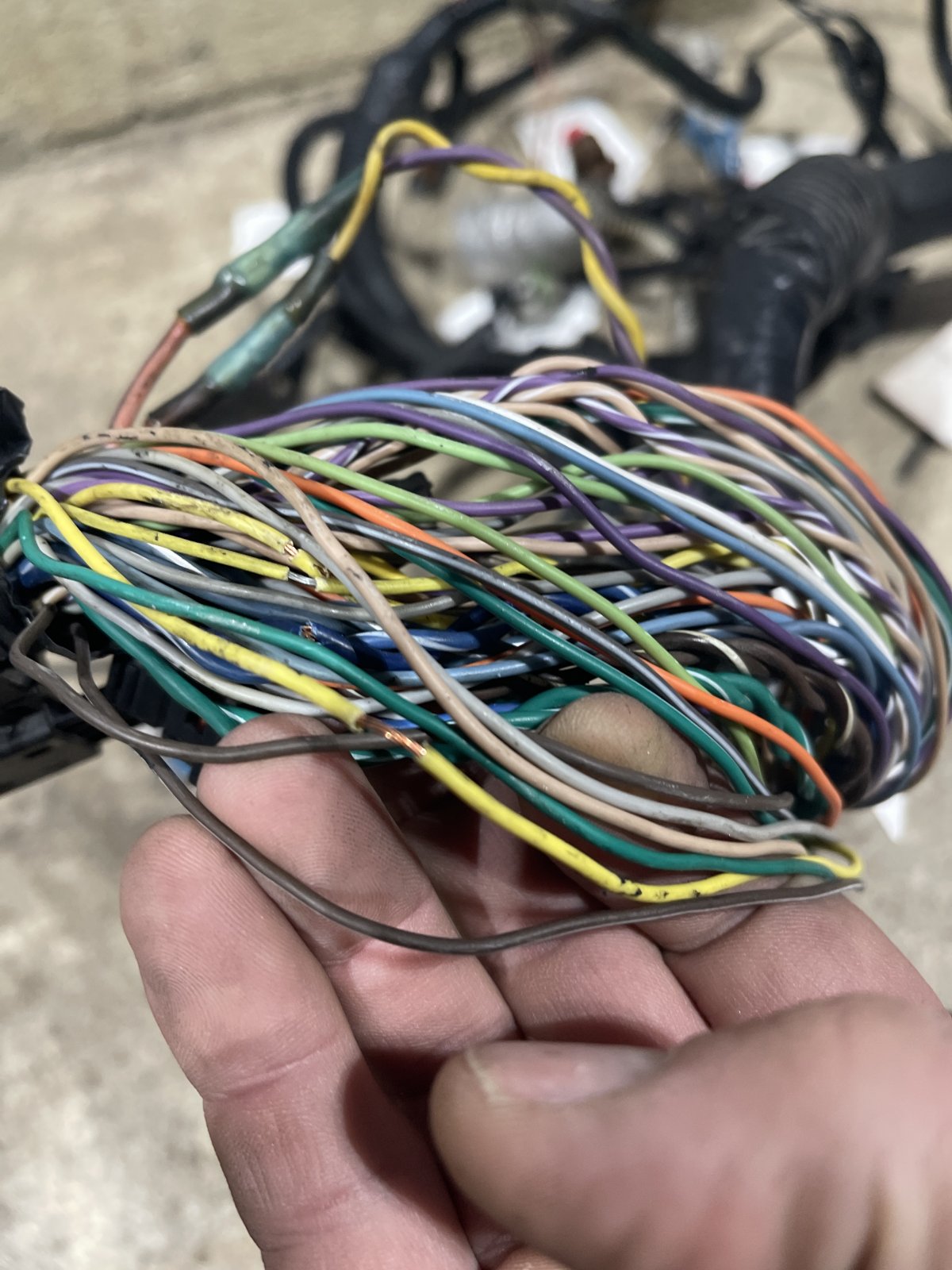

Not a bad days worth of work. Completely replaced the engine harness with a brand new one from GM. Also replaced the valve cover gasket while I was at it. Looked pretty clean inside. Not sure if you can see it but there is at least 15 wires in there missing insulation. Also found the MAF wire had been spliced 6 times plus several other sensor connectors replaced. Though it would be best just to replace it all with new.

So you have reworked 2 harnesses now, I'll be dropping mine off friday! ;) lol
