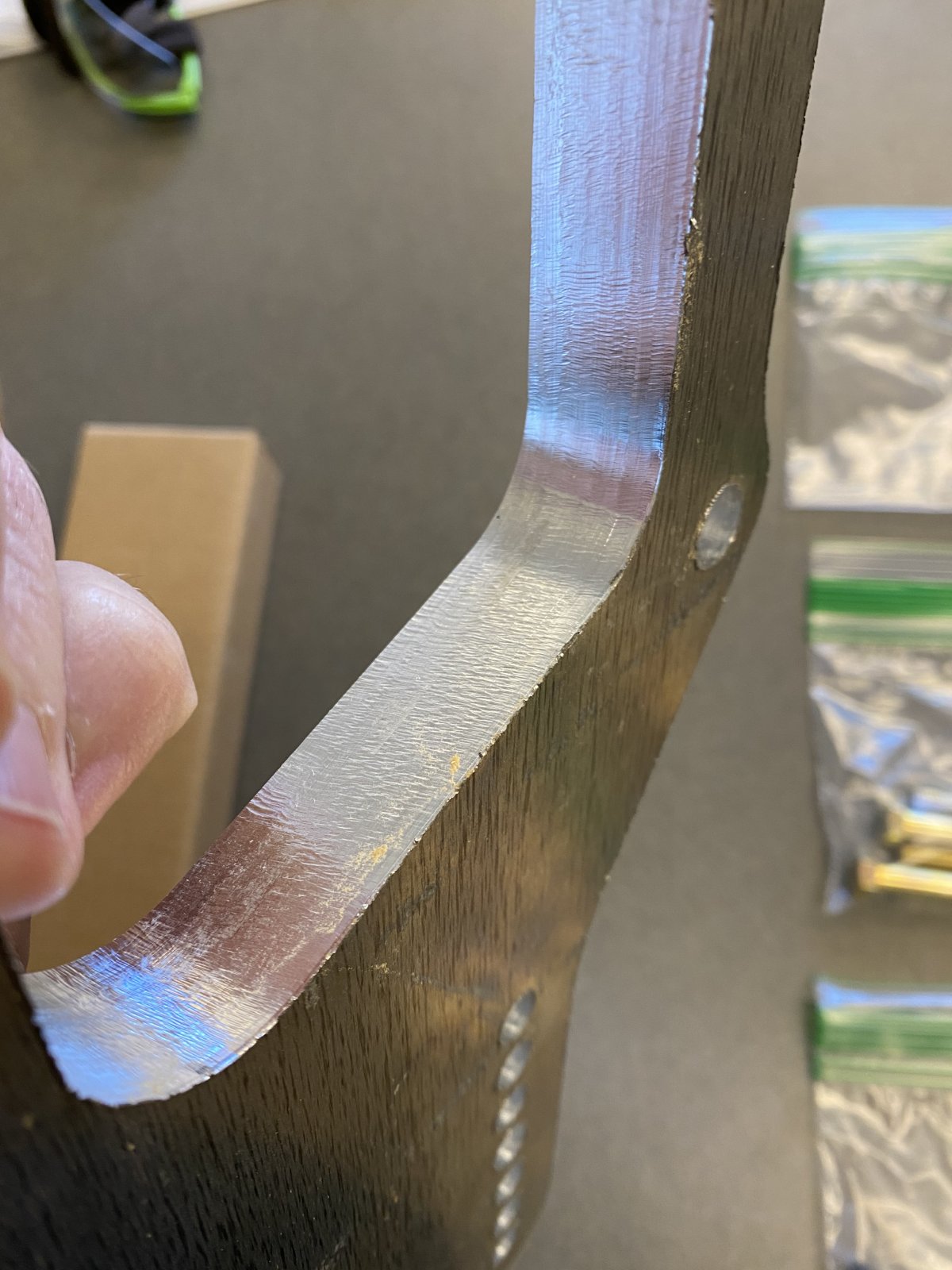

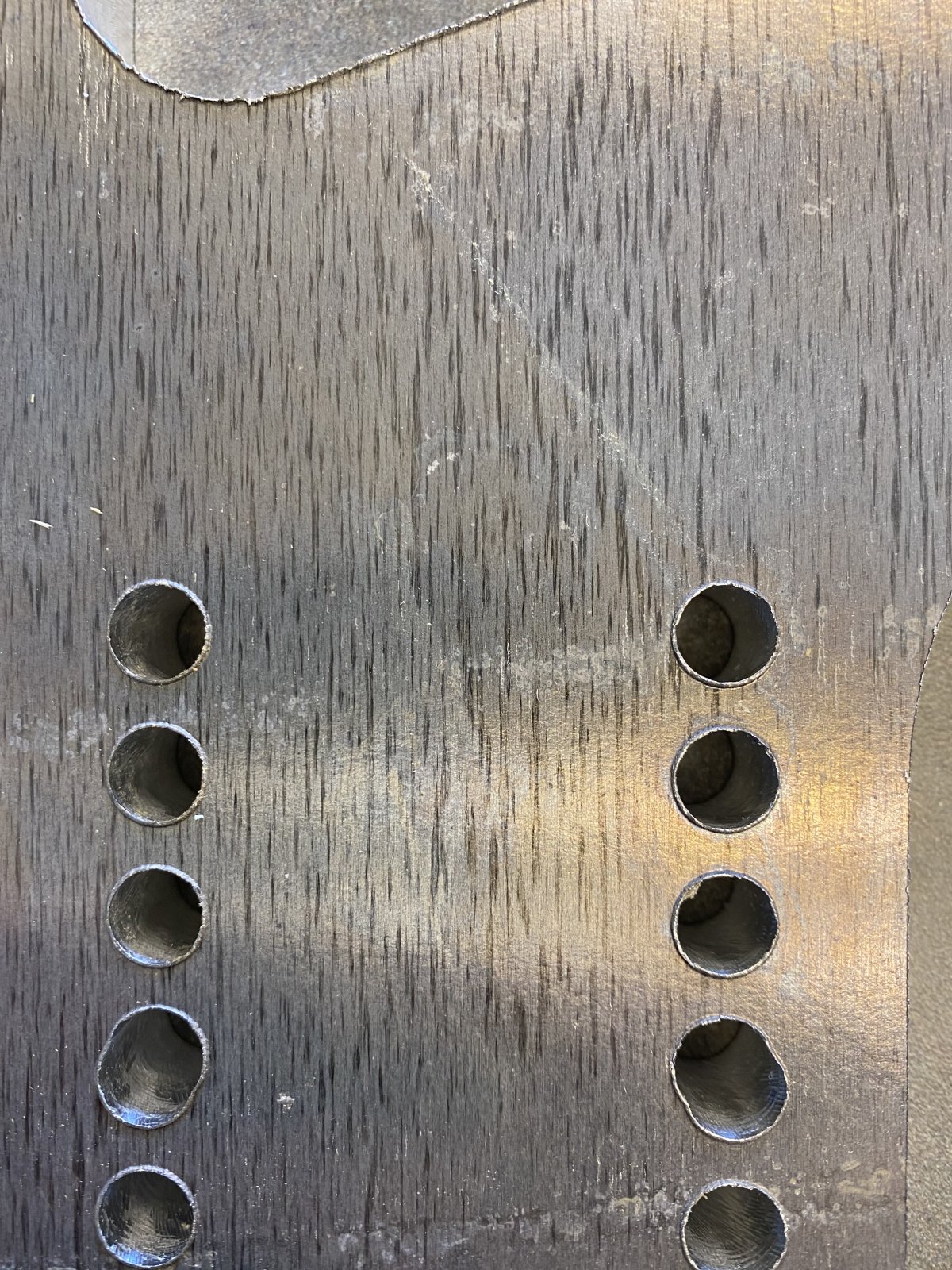

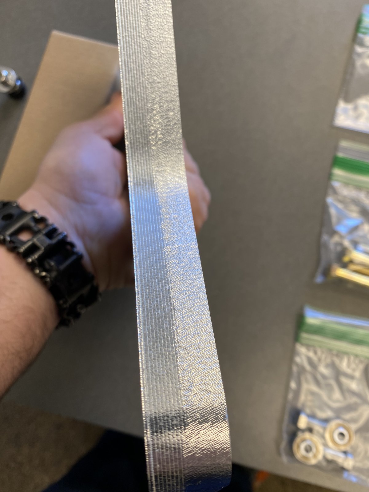

Before install, remember that the bases are straight off of the CNC. There are still mill marks, edges that need work, and the corners are sharp. They are aluminum and easy to work. A little bit of time with a Bastard Cut File and some 80 grit sandpaper will provide a finish similar to the one that I showed in the other thread. I used the file to hit the top and bottom corners quickly and then spent about 10 minutes with an oscillating sander to give it a brush finish and clean up the sides. Don't worry about the bottom (you can't see it.....)

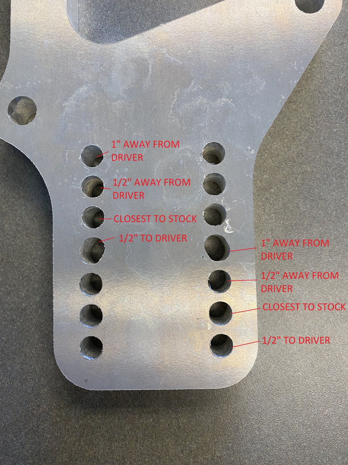

5. Use the 5/16-18 x 1 1/2" long bolts with flat and lock washers to attach the shifter to the shifter base. A word on the holes. The rearward set of holes is about 1/2" to 3/8" closer to the driver than stock. Each set of holes forward moves the shifter 1/2" forward. The second set of holes will be the closets to the stock position. For each set of holes forward that you move the shifter, you'll be cutting 1/2" off off both of the all-thread. You can do that now or wait until the shifter is sitting in the car to confirm the amount to cut.

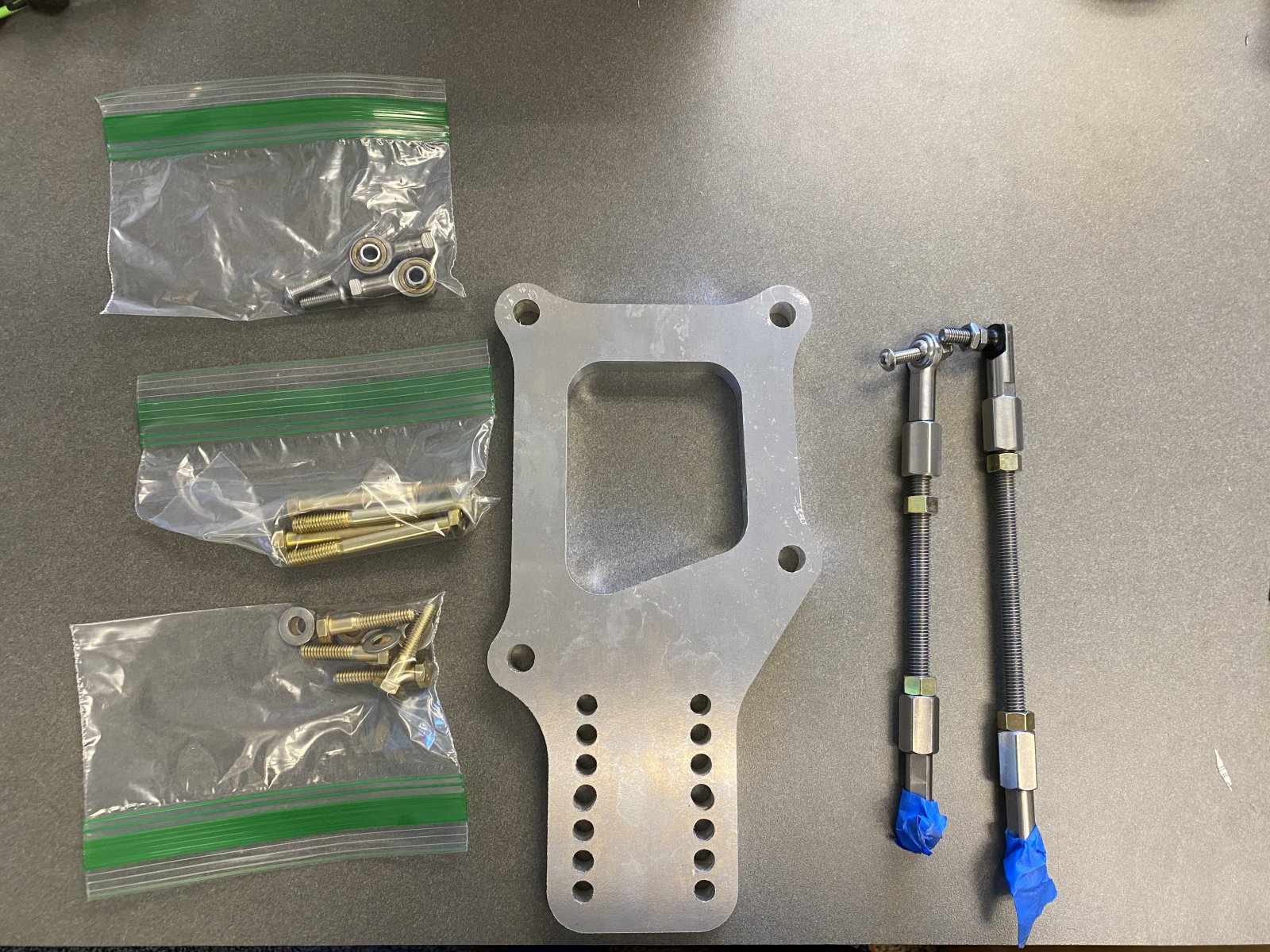

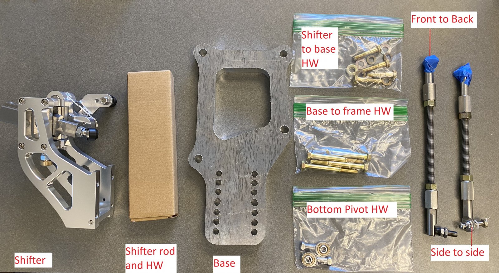

The full kit includes everything in picture 0506

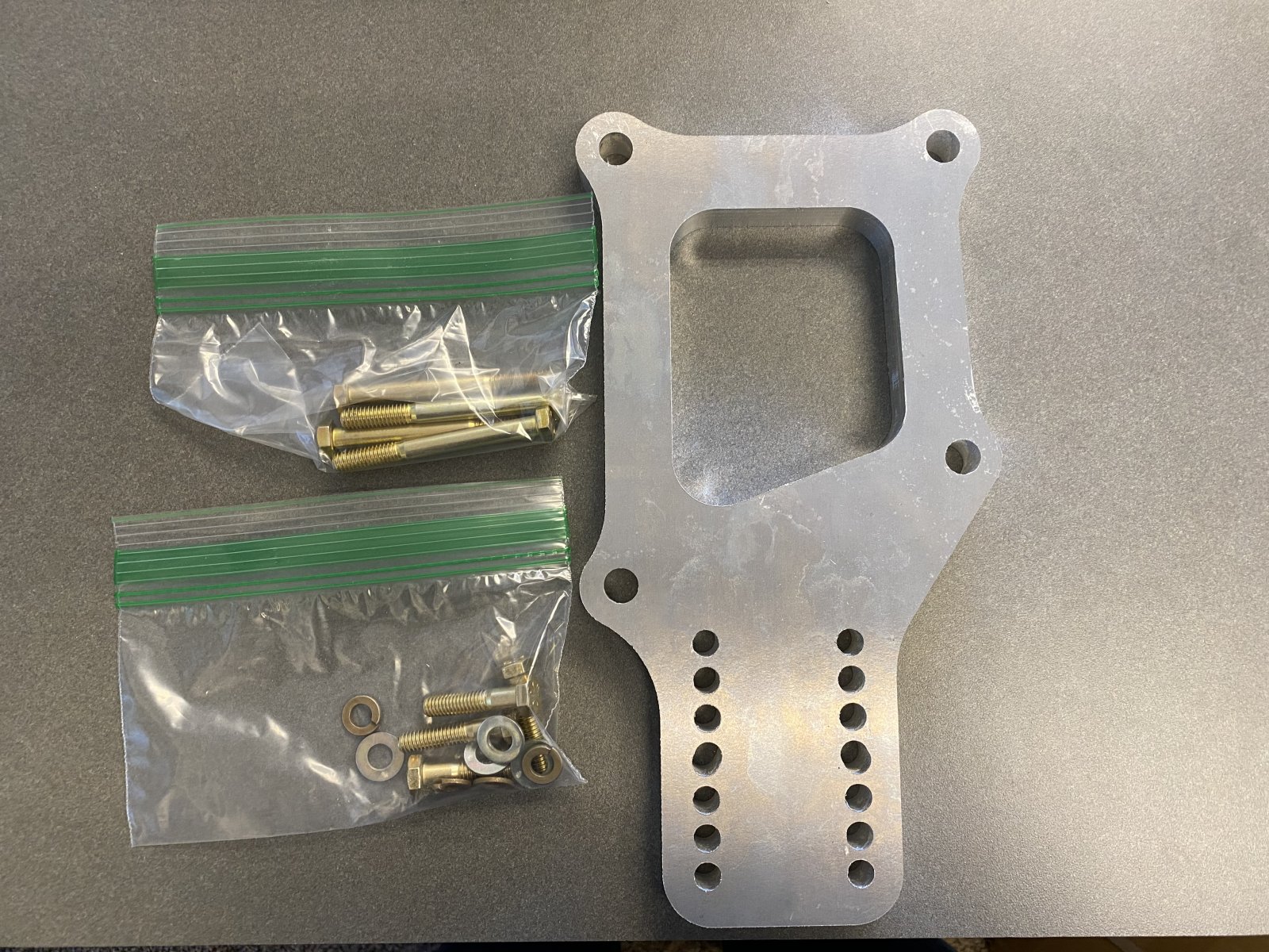

Pictures 0507, 0508, 0509 show what to expect with the bases but it does vary throughout the run

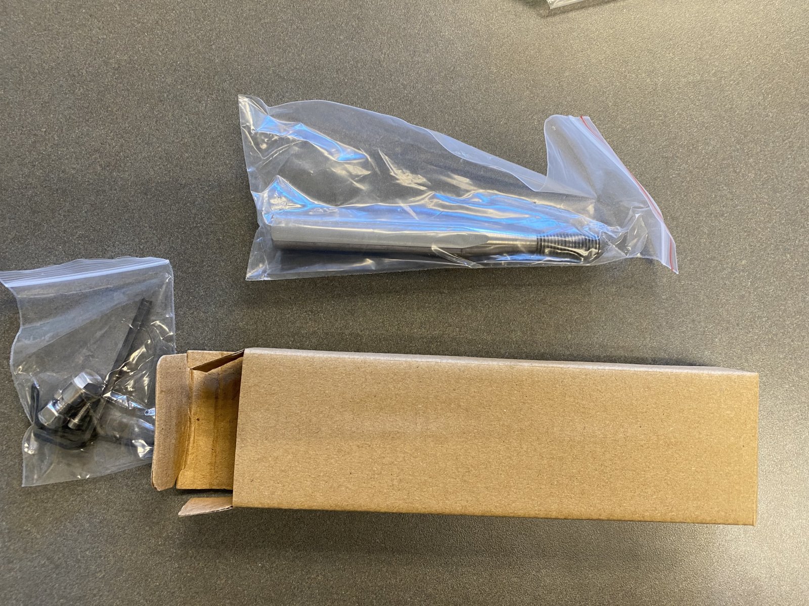

Picture 0510 shows the contents of the box with the knob rod and extra hardware for the shifter
The Base with the pivot hardware is picture 0511
The Base only kit is picture 0512
Picture 0513 shows the different holes. The "double drilled" set of holes is correct.
