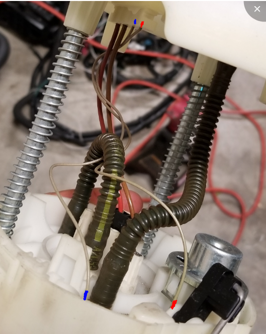

Need some assistance from someone with an SS/TC fuel pump that isn't installed in their Goblin yet.
On the fuel pump, there's a pair of small thin wires that run from the fuel level sensor up to a plug on the white top of the fuel pump. I need to know which one of the thin wires goes to which side of the level sensor. A pic would help greatly.

I diagnosed a bad fuel sending unit today. Ordered one on Rock Auto. If you can give me a day, I will remove the pump and get you some pics of the grey wires.

Hope this helps!
