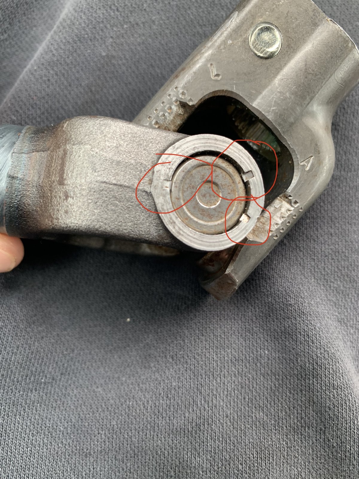

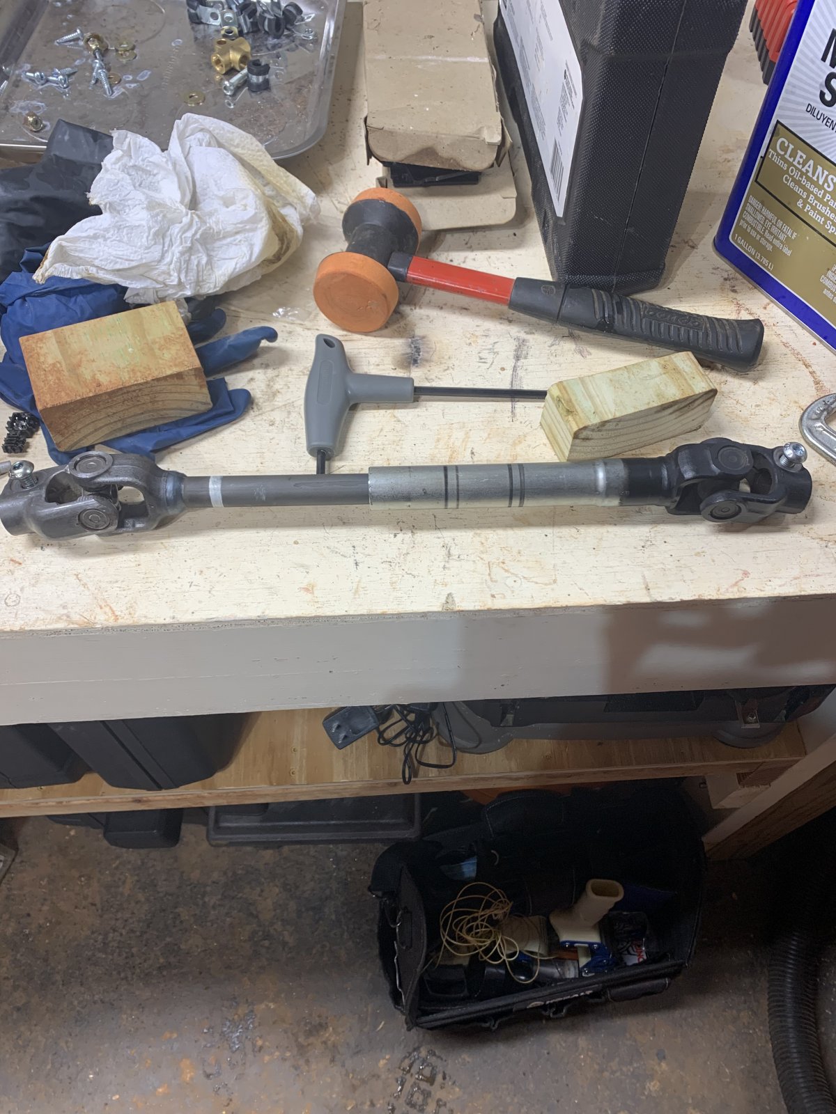

Has anyone every pulled apart the U joints on the Cobalt steering shaft? I’d like to powder coat it, but don’t want to heat those cross bearings up when I go to cure it
Ive never seen this type of cross bearing retaining methodology (without retaining clips). Any thoughts?

Never heard of anyone disassembling those joints. It looks like the caps are "staked" in. You might be able to grind the stake points out and then re-stake with a chisel.
My steering shaft was seized to the point that I drilled out the staked portion of the slip yolk to separate it (required beating it nearly to death) and clean it out. I just painted it black lubed and reinstalled it now moves freely. I figured if I destroyed it taking it apart I was in no worse place than where I started as it was unusable as removed from the Cobalt.
