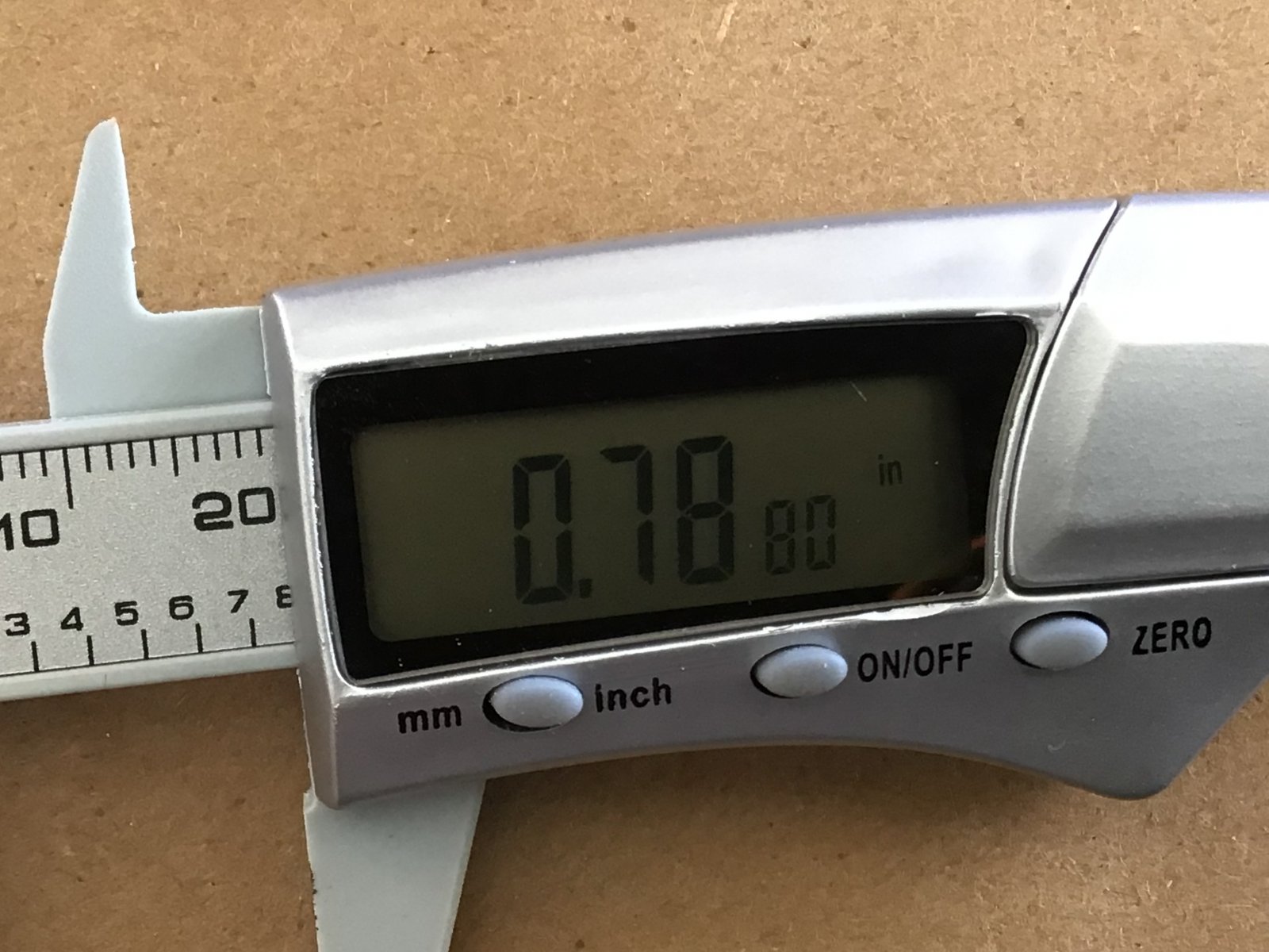

This might help, The ones you get at Harbor Freight want work there completely different

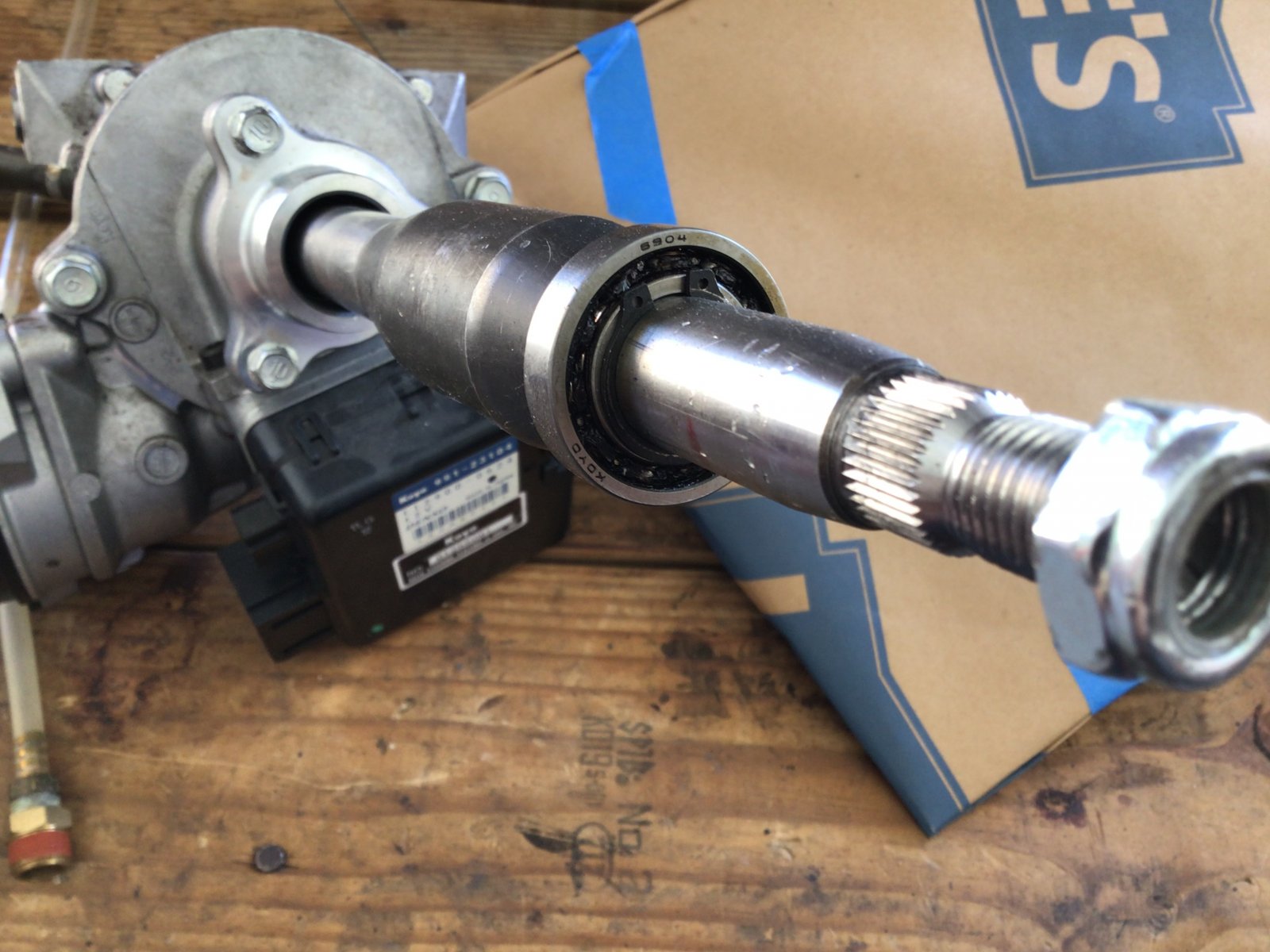

Thanks, that's what I needed. I've ordered 50 for 20mm shaft and 50 for 25/32"(.7813") shafts for Monday. Hopefully between the 2, I'll have something that will work. If so, I'll have plenty to share.

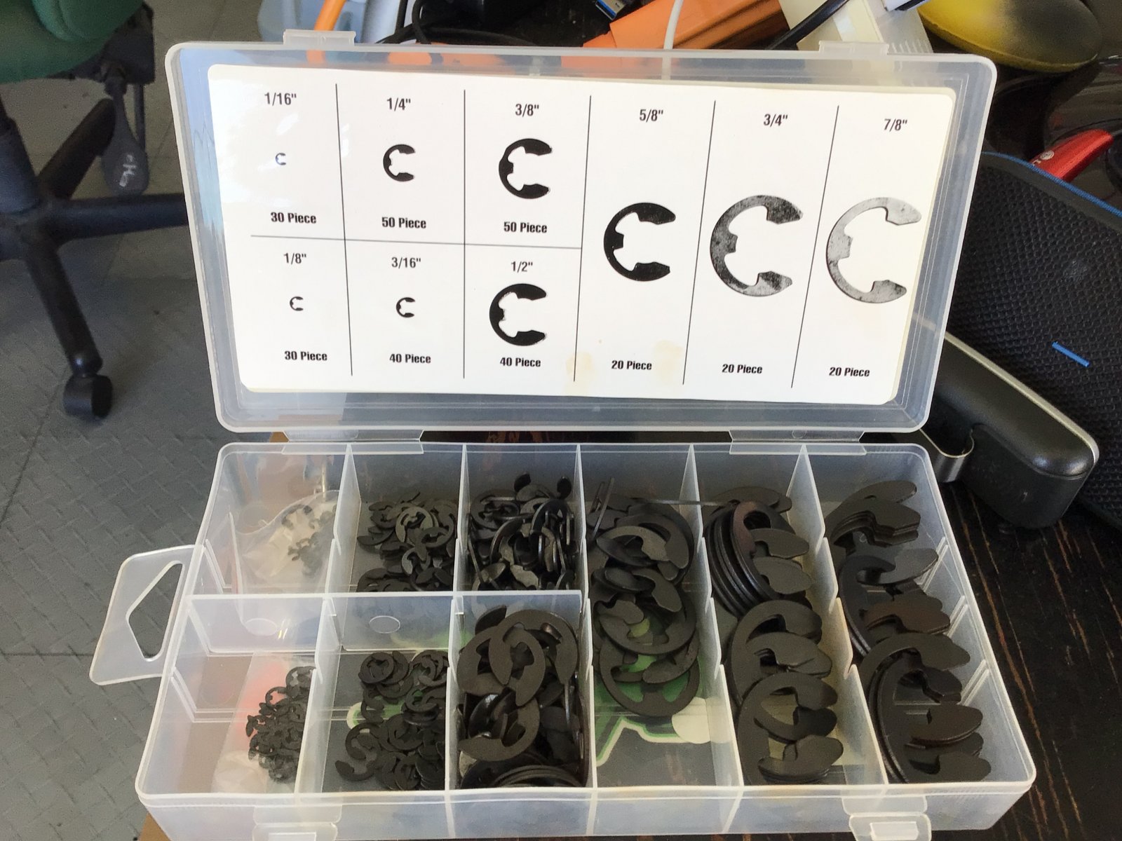

Your picture is of an E clip, which is not the right type. Idk if Harbor Freight carries external retaining clips like the one installed, but even if they do I'm not sure what size that measurement would take - 20mm? Something between a 3/4" and 13/16"?
So both the 20mm and 25/32 retaining rings work. If I had to choose I would say the 20mm was a better fit but not enough that I will swap back since I tried the 25/32 second.

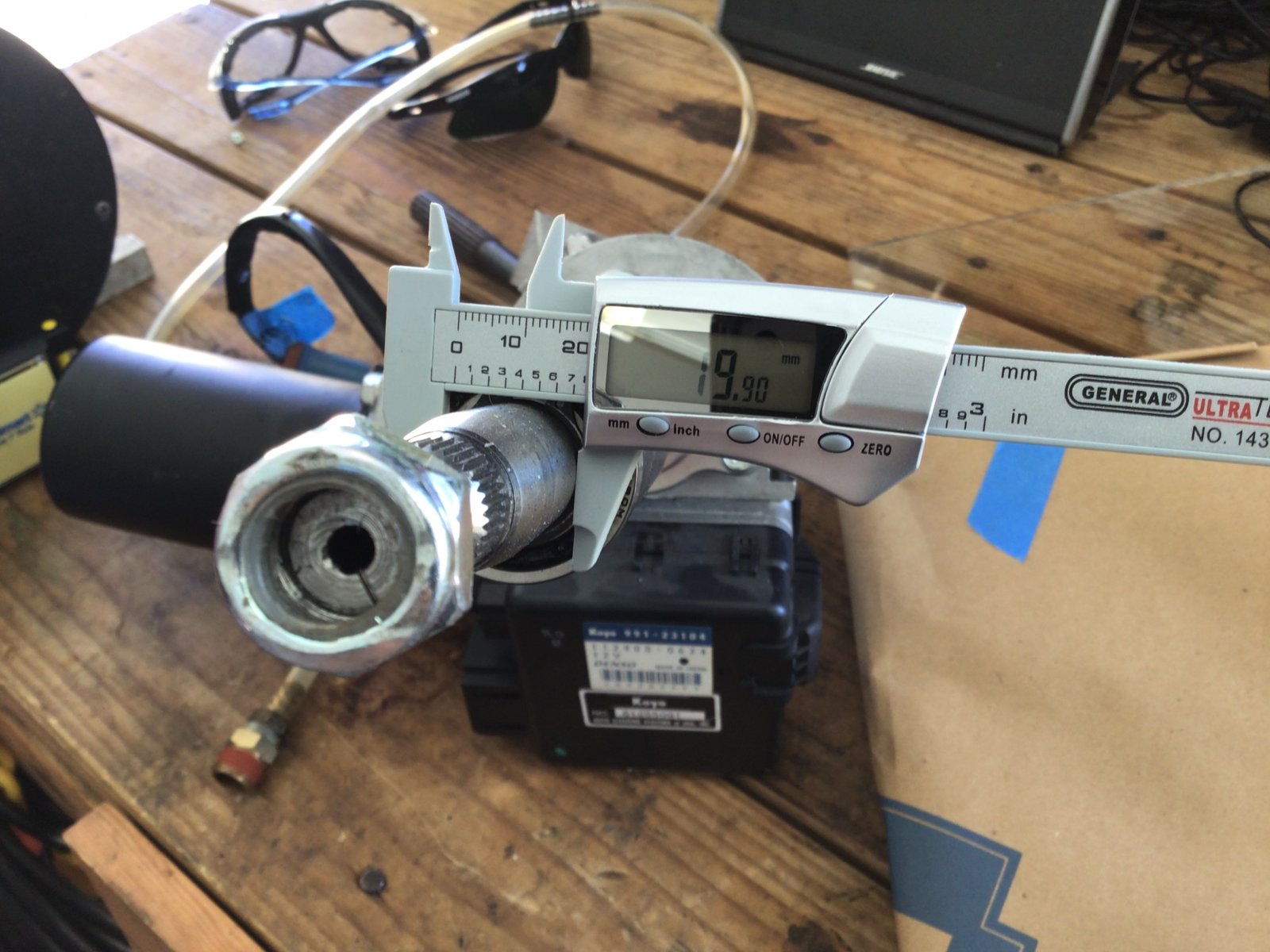

Yep that’s what I measured was 19.90 mm
