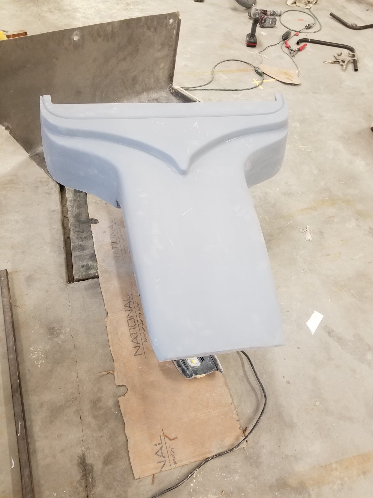

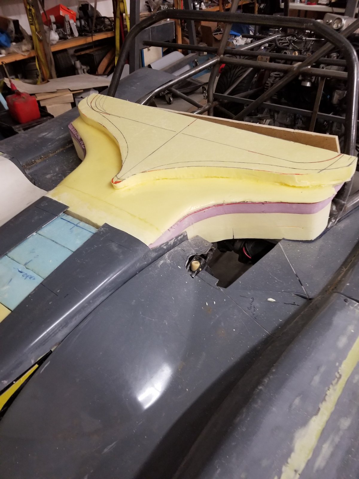

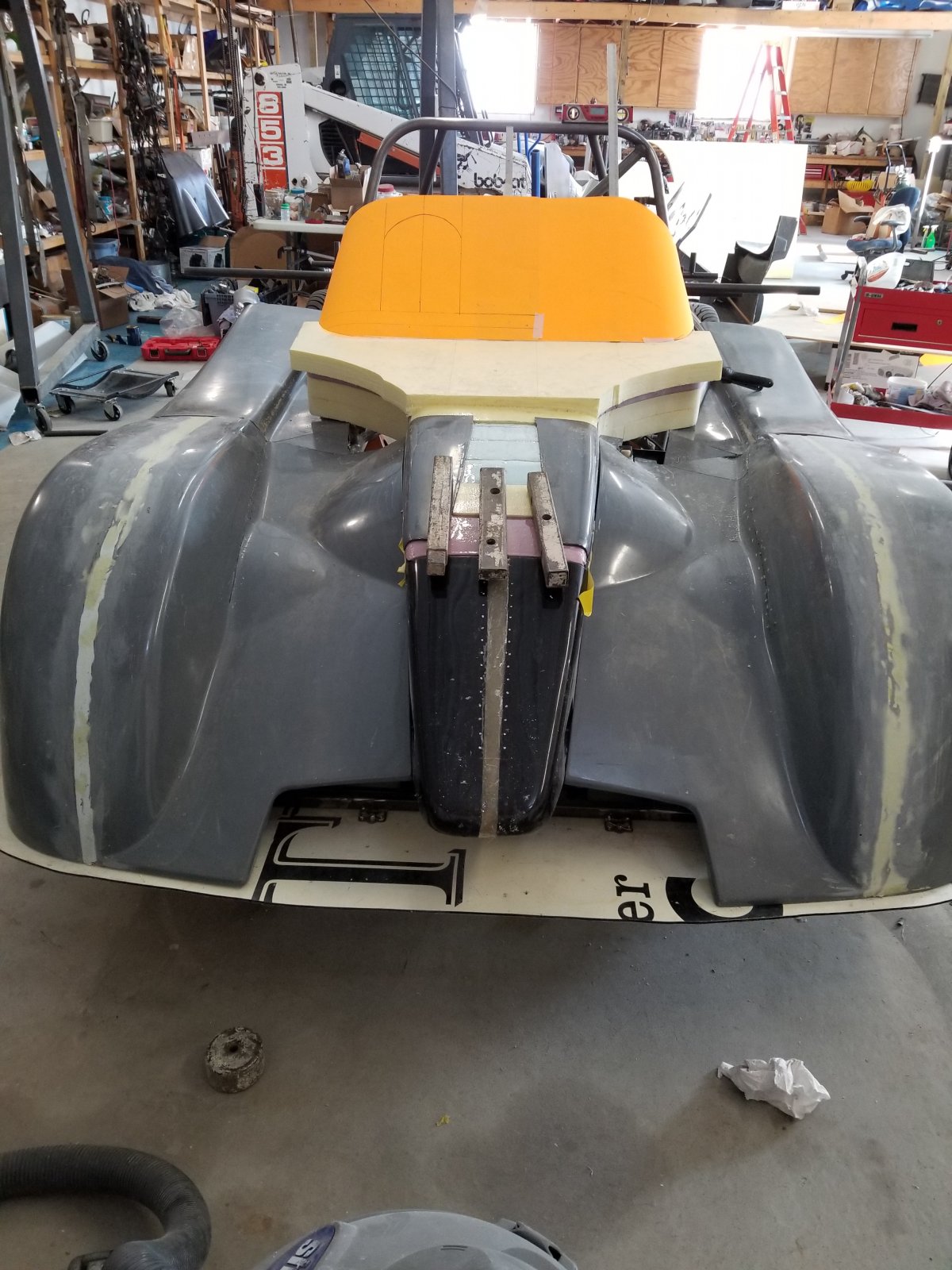

Finally making some small progress on my body. Here are a few pics. I been using foam insulation to shape body parts. Once I get the general shape then I cover it with resign, then sand, then body filler. You have to use a certain kind of resign (will post picture of it for reference later) otherwise everything else melts the foam... fiberglass resign, body filler and paint all melt it. I know there is another kind of foam that will tolerate fiberglass resign, but what I am using works ok. I think I got the windshield figured out by using some heavier weight paper to make the shape. I will use mar-resistant Lexan. I think i screwed up trying to post the pictures, not use to Windows 10. Hopefully its ok now.

Thanks guys, I'm wanting to get this done ASAP but unfortunately it always takes more time then you want. Here is another photo of the nose section that I am making a little design into but still I still have a lot of work to do. I am thinking about incorporating some lights around where it curves but not sure yet. Here is a picture of the resin that I'm using that doesn't destroy the foam.

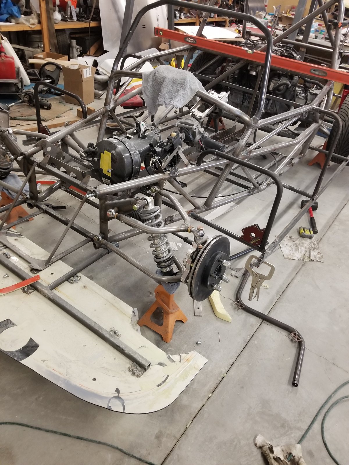

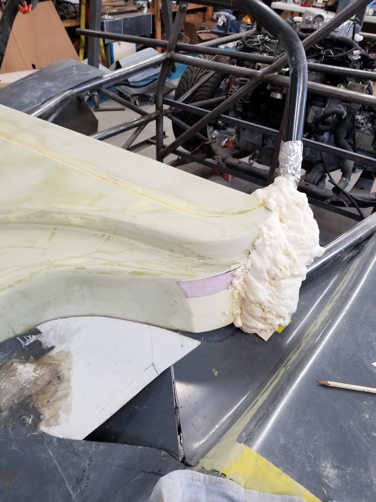

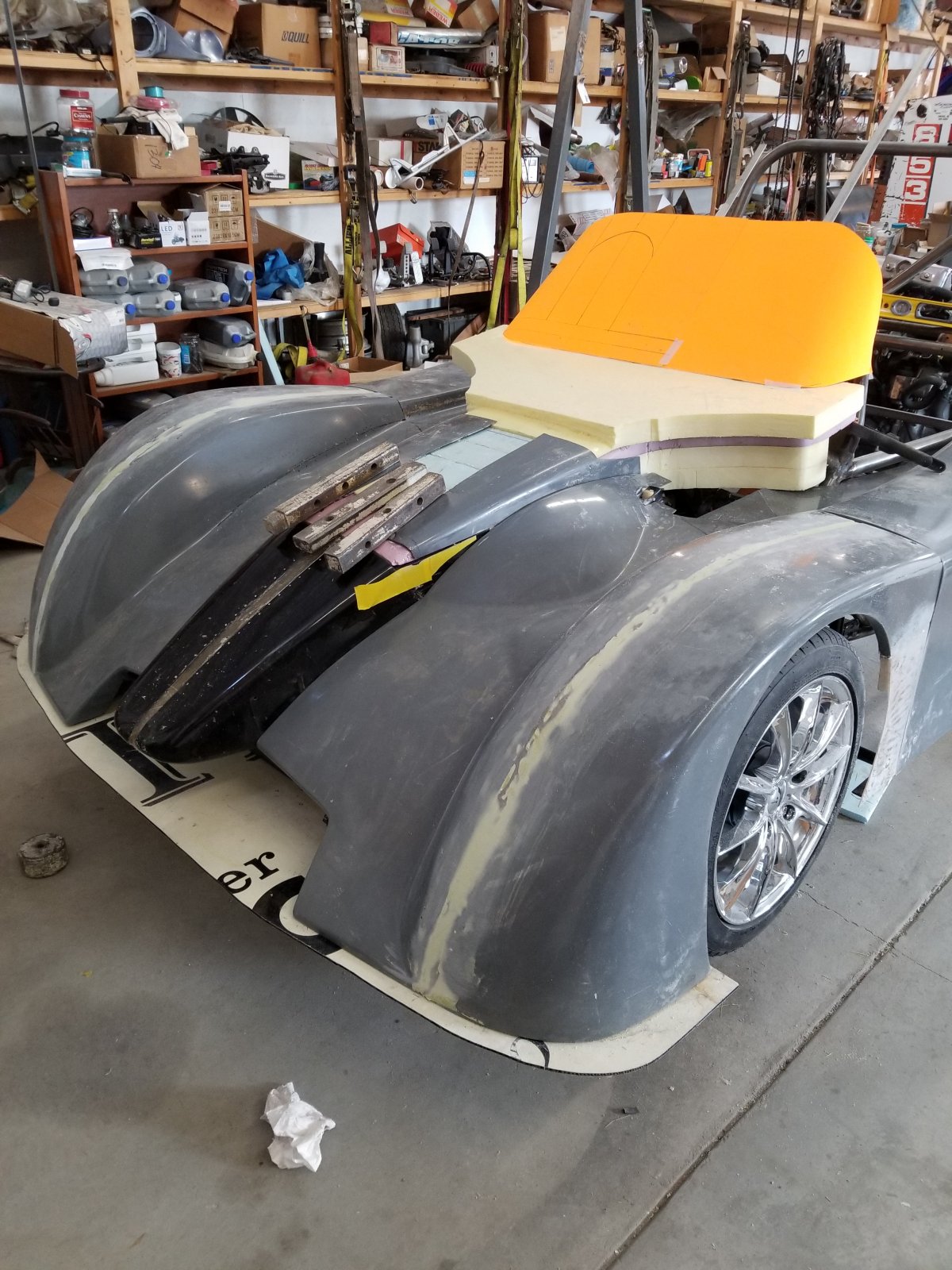

Yes, I have been working on it, not as much as I would like to. Here are a few pictures. First pic is adding on to the front noise piece using some foam insulation that you sand, shape and the apply body filler. Finally got the front fenders shaped like I wanted to closely conform to the front tires. The third pic is some additional pieces added to the chassis so I can mount my body. Part of the front noise piece is pretty much done except a few minor flaws I have to fix.

I got my shocks modified to fit a coil over kit. I mentioned earlier that I cut-off the big spring perch with a cut-off wheel then ground down the sharp edges. I put the whole shock in a 4 chuck lathe, it worked really well, my neighbor did most of the work on his lathe, I have a cheap harbor freight lathe, his is a little nicer. I left the part where the spring perch was welded to the shock which left a nice substitute for the retaining ring that you would normally use to hold the adjustable sleeve in place. Since my donor had low miles, I wasn't worried about the shocks being bad. This turned out to be a pretty cheap upgrade, it costs me approx $85 for the coil kits. All I have to do now is buy springs for the rear. I used one of the front springs for the pictures.

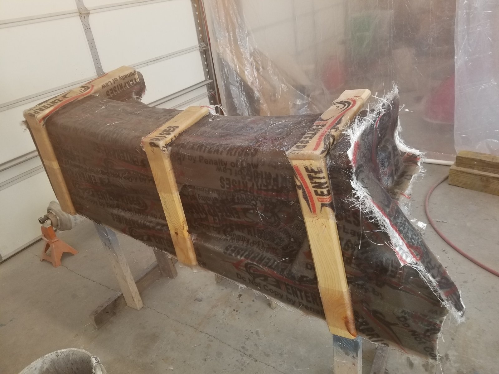

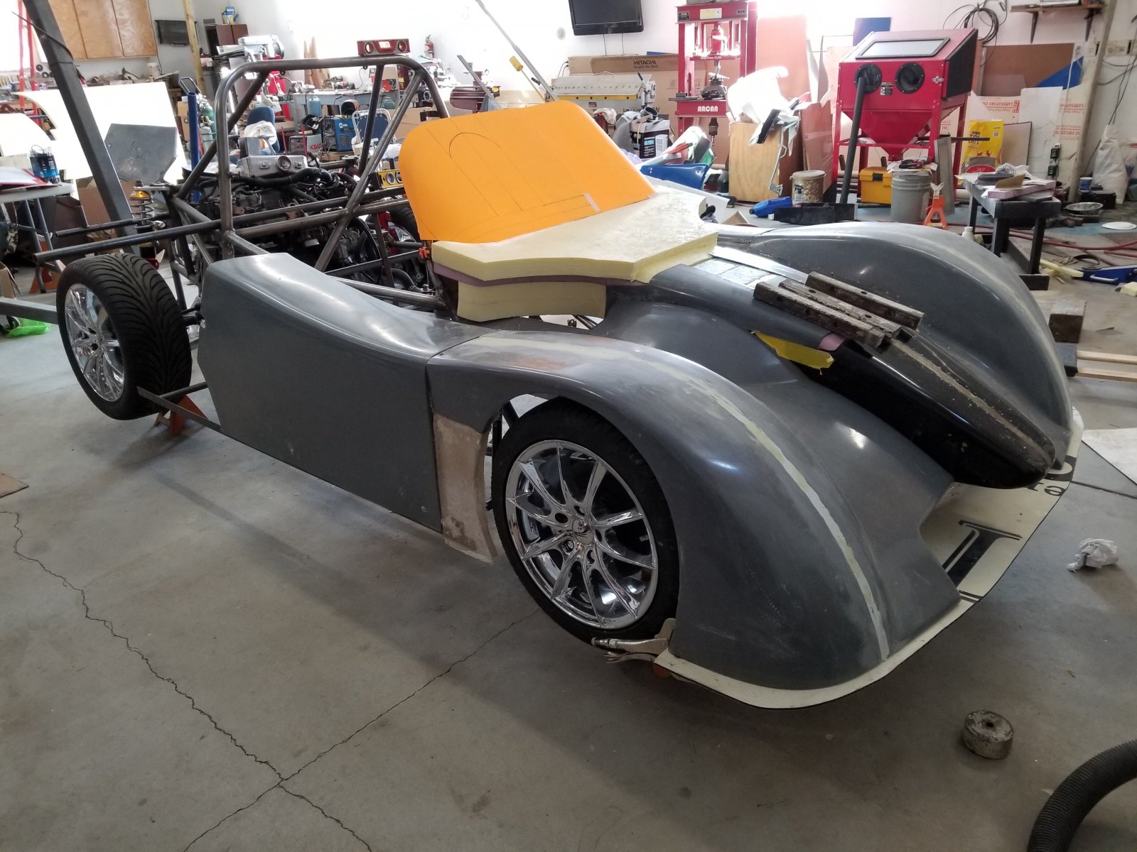

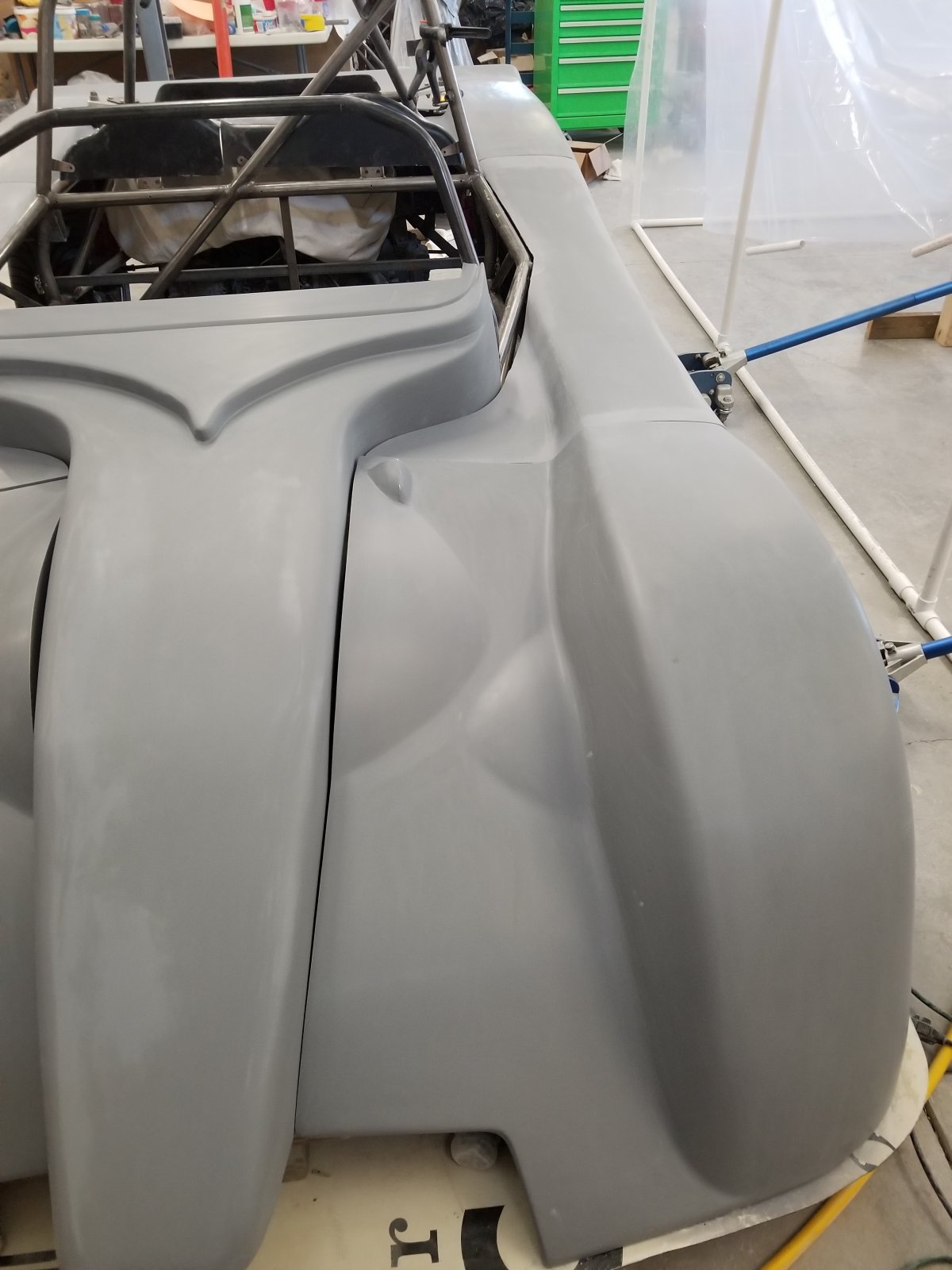

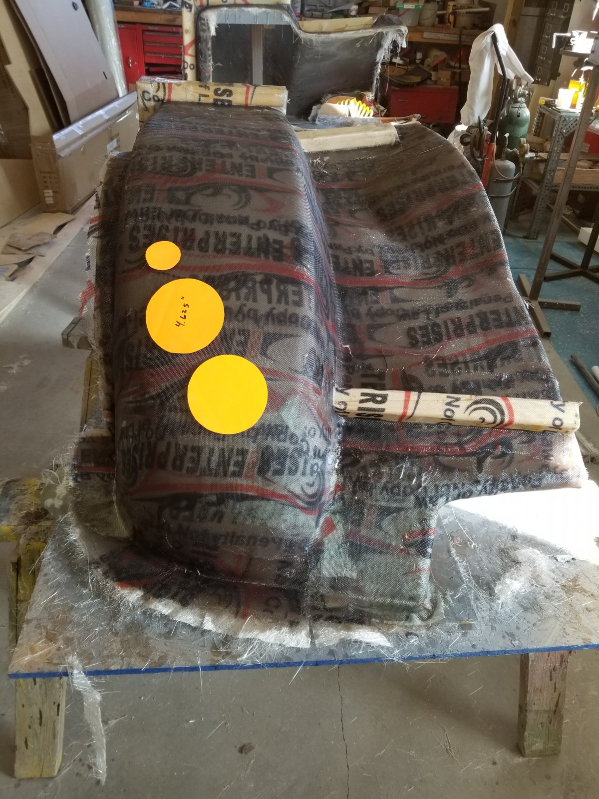

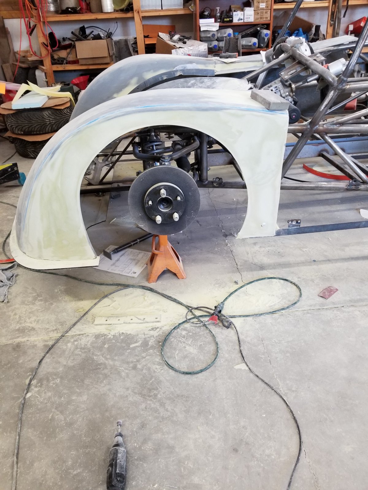

First pic is the left front fender mold with where I'm going to install the headlights and turn signal. Second Picture is the left side body mold. Third picture is the pieces I used to make the two molds above. I've made and pulled the front and side pieces from the molds, now I'm working on getting the pieces to fit. One thing you can count on, fiberglass always likes to change it's shape a little, so you have to train it to bend how you want it, at least to a point where you don't cause it to crack. I have the headlight buckets made and the holes cut out in the front fenders. I'm finishing up the mold of the tail section. I have to glass the areas where there were parting lines. I hate parting lines, they are a PIA!! Once that's done, then I wait a few days for the glass to cure a little, then I will pull the original piece from the mold, then I can start to make the tail section and then more body work. There is always....always body work to do on something like this. I have a lot more pictures I could post, but don't want to overload the site and once you've seen one or two then....
